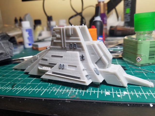

Looking at Darph Bobo's thread, I decided to pick up a 1/700 WWII ship kit for greeblies. Found this one at my local hobby shop, and it had a lot of great parts! I greeblied up the bridge, adding in some detail that was missing from the base kit.
I got my photoetch panels in! Using my photoetch snips, I cut out a few rows of windows and attached them to the bridge. I used the 1/12 for the long parts at the bottom, and 1/20 for the others.
Here's what the bridge assembly looks like now-

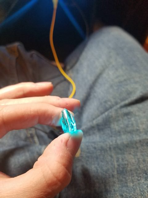

For the actual bridge pieces, instead of trying to paint the tiny windows and hoping the LED doesn't bleed through, I'm going to use the 1/24 photoetch as the windows. Here's a quick test-

They weren't that hard to cut, but I used a brand new pair of these photoetch snips from Amazon. They weren't cheap, but they cut really well.

That is the bridges from Shapeways printed in frosted extreme detail. I had planned to meticulously paint the tiny window frames that were printed in the model, but as I was brushing on primer, I realized the 1/24 photoetch would work well. The only issue is it won't be "inset" into the bridge, it will wrap around the outside, but for the scale it should look fine. And sorry for the bad pic, I was trying to get the camera to see the windows without making them a giant glare!

That's looking great so far! Your window instal is cleaner than mine was!
Thanks! It was a huge pain to do, but I ended up figuring out a system. Use a thin piece of metal (or a toothpick) to apply CA glue around the edge of the window frame, drop the photoetch in with tweezers, then hold it down and hope the glue cures :lol

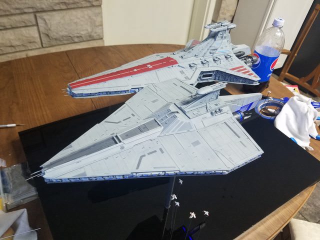

I did get most of it done in time for WonderFest. Ended up working all night the night before to get the electronics all situated, and then ended up with a short that caused my RGB LEDs to only shine blue (instead of the blue-green I wanted). The Odyssey Slipways Light Cruisers had to shelved, I wasn't able to get everything worked out in time for those.
Anyway, here are final night pics and competition pics. These are all from my phone, I do need to do a little photoshoot with this dio, but haven't yet.
(I think the blue is "correct" in this picture)

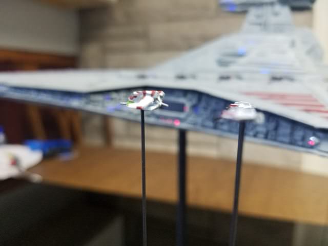

My very talented brother painted the tiny ships. He's much better with the small stuff than I am, and I was running out of time doing all the other stuff! For the guns on the gunships, I used a thin wire I found at my hobby shop (I think it may have been guitar wire). I think it was around .3mm.
We ended up not placing, which was a bit discouraging, but there was so much good stuff in the contest. I've learned a great deal from this project- namely not to rush a project for a competition!
Thanks to all who have responded here, and given me inspiration! Especially you, Darph Bobo :)
I may come back to this project in the future, at least to fix some light bleed issues, the RGB LED wiring, and add the Light Cruisers. For now, thanks for looking, and I hope someone is able to get some inspiration from my build!
