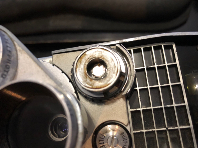

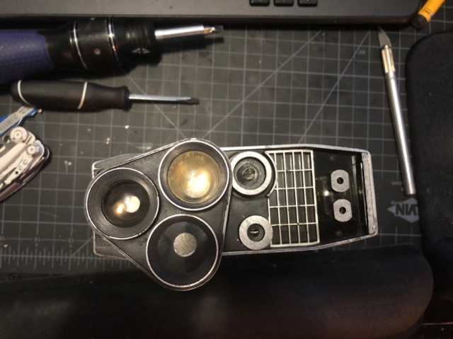

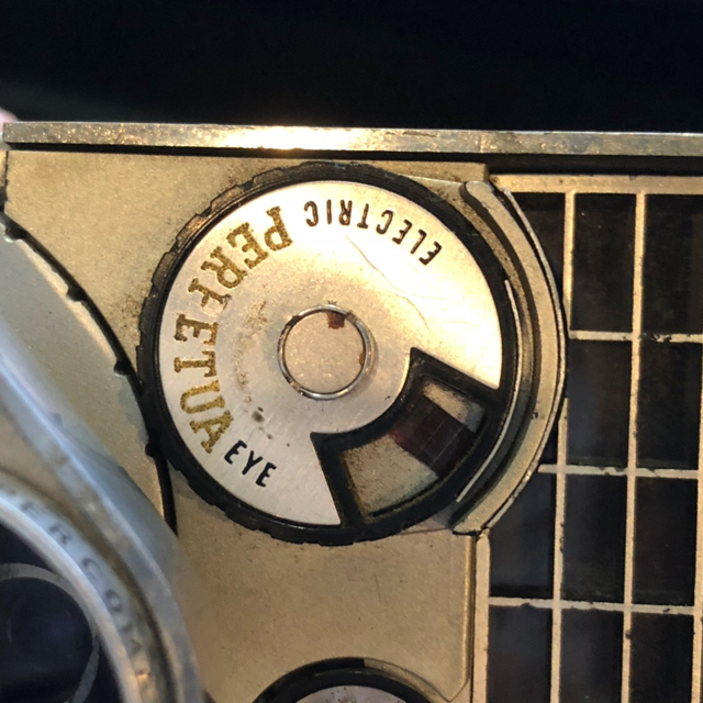

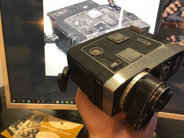

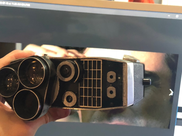

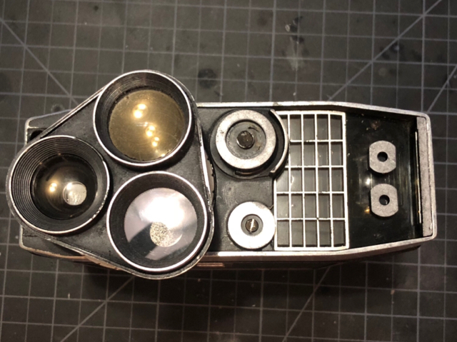

I'm still not 100%. Maybe I'll take a photograph of the prop with donut added in the same perspective, overlay them in PSD to see if they are the same proportion. I also experimented with removing the black dial completely before adding the greeblie. Doing this, created more space for the "donut" to drop down into the gap and clear the edge of the camera, which you can clearly see is underneath the greeblie.
Here's a thought. Notice that the other knob (film speed) has been completely replaced by something smaller. Compare the outer diameter of the original knob to what's used on screen. No light meter window, also a donut, thicker border, smaller outer diameter (note the difference in space between the knob and the curved "fender" where the film speed needle is). There's a much bigger gap between them, meaning the replaced knob is quite a bit smaller.
I'm not saying your'e wrong at all. I think you are exactly right. But just playing around with it, check out that same winder knob in place of the larger one instead of the filter selector and check out the gap between it and the fender. I think for this one what we're looking for is something just slightly bigger than the winder knob here, with a slightly bigger Inner diameter.

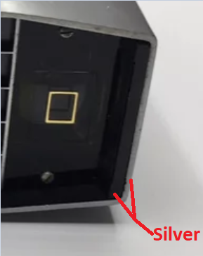

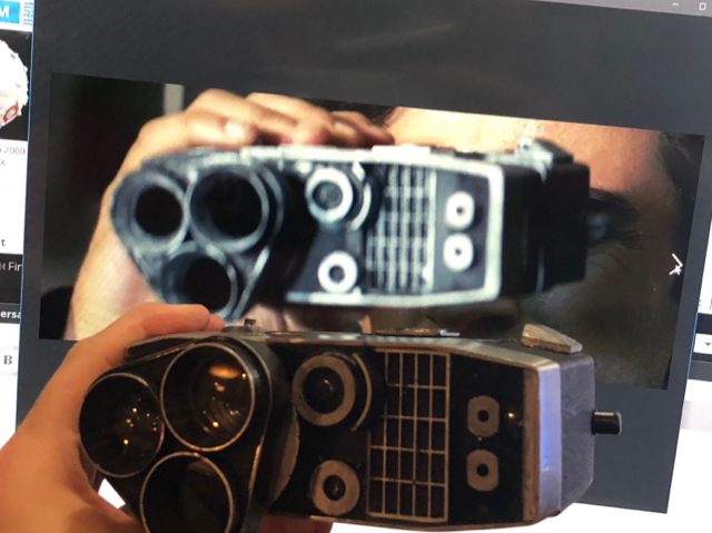

Does the outer rim of the bino prop look thicker than the actual B&H camera.
At first I thought it was focal blurring making the edge look thicker, but Poe's pinky finger is 1/4 inch away from the edge so his finger would be blurry too. Optical illusion?

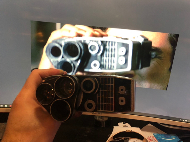

You're not crazy. Yes it actually is. This prop is either a resin cast of the camera or it has been painted. But what you're seeing, on the right edge specifically is the metal edge PLUS the black plastic trip, which was either painted silver to match, or the whole thing is a resin cast and both parts were painted silver.
Not to steal xwingercrash 's photo but his shot shows what I mean

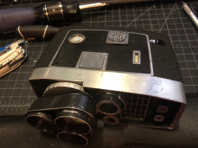

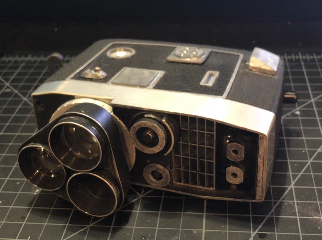

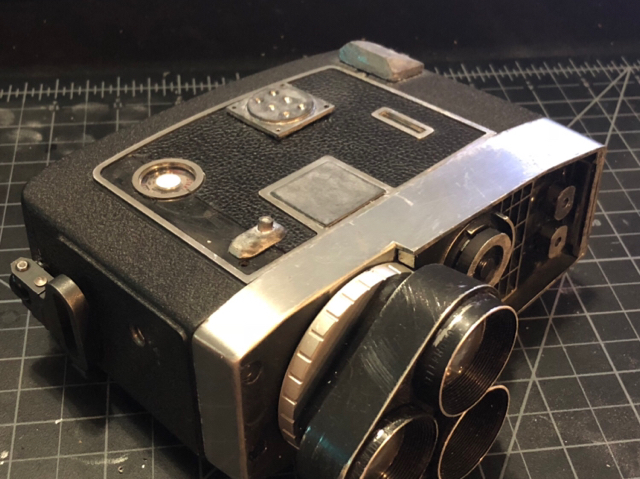

Looks great.

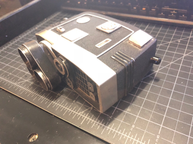

What did you use for the square greeblie with the six dents (or whatever they are)?
It looks like a one piece metal object.

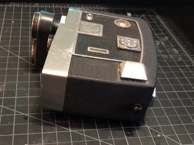

I modeled and 3D printed them in resin on my DLP machine in high resolution. then painted and weathered to match.
I can throw a greeblie kit up on my etsy if anyone is interested in them.

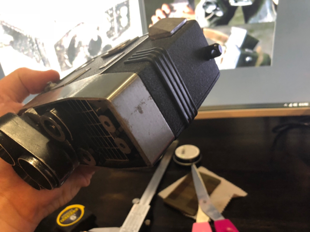

I was lining up the shot angles to compare parts and thought this was kind of funny lol

Yes, I agree. it is a cast. notice no reflection in two of the lens and they are rough around edges. not as clean as the real camera.
Not to steal @xwingercrash 's photo but his shot shows what I mean

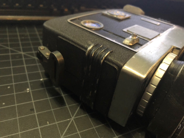

I'm working on the grips now.
They were in the junkyard a couple of months back. Aluminium set with the little button cast and painted. I don't think there were many sets up for grabs.
Added grips.

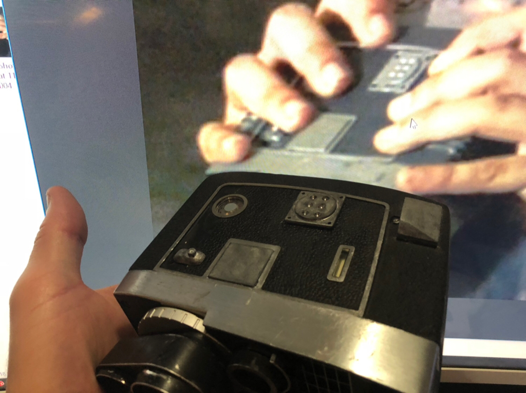

After staring at it so long I’m starting to go back to the idea that it's ribbed rubber rather than separate ribs. Specifically in this shot (I know it’s the visual dictionary version but it’s probably the same on the screen used)
The top edge of the camera has a groove across it that is not visible between the ribs
