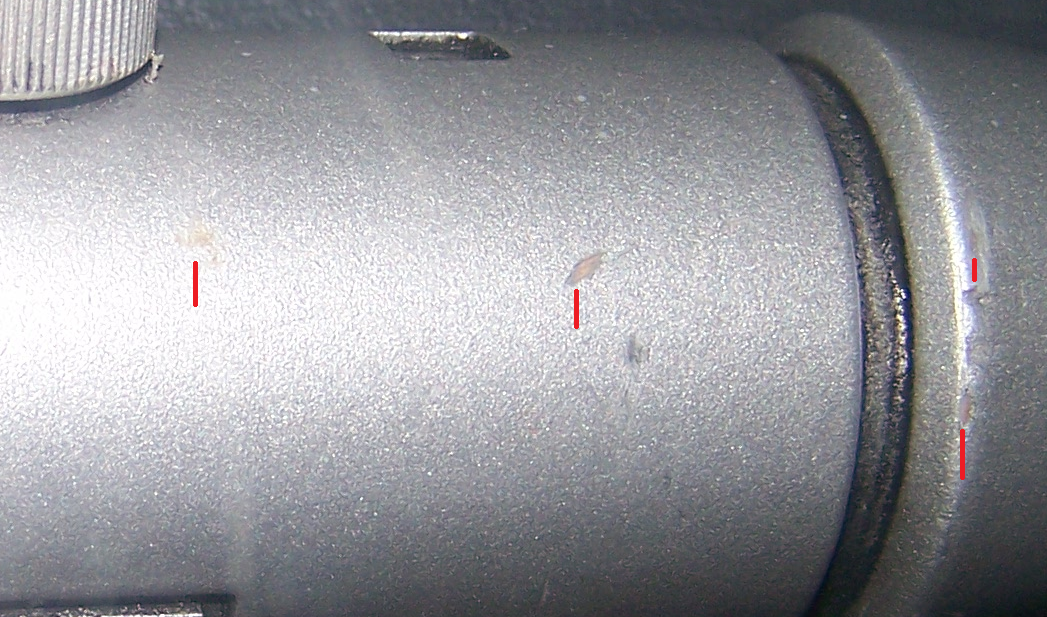

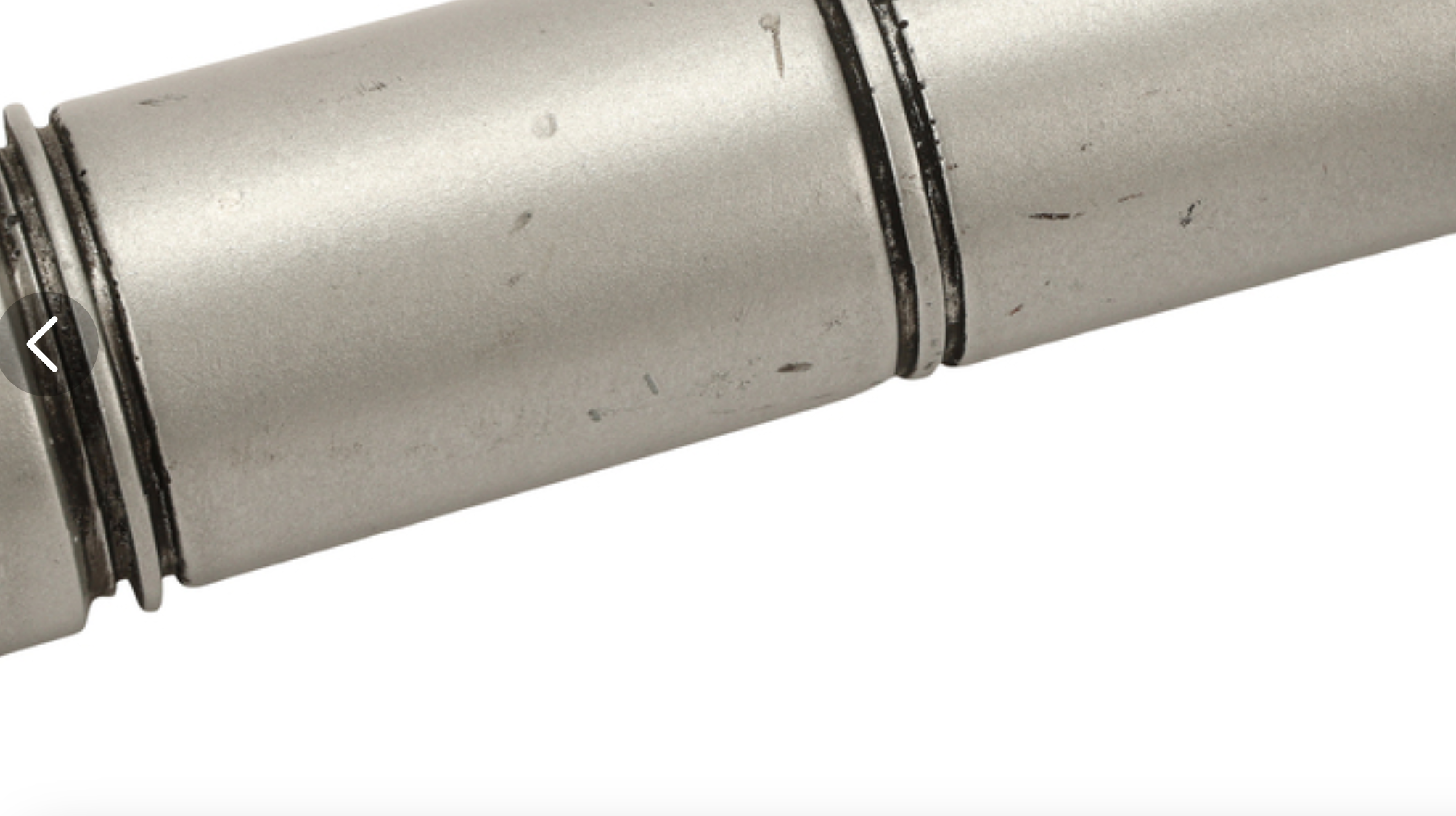

was that Hero lightsaber machined brass entirely?? or is the body resin? there are some scratches in the paint and it looks like oxidized brass, not the light tan resin they used for all the cast. It also looks pretty clean, so is this completely machined, and possibly out of brass? The knurled buttons also look like brass.
I think the emitter piece is mixed aluminium and brass, the knurled buttons and bottom piece on the pommel are metal but the rest is resin, thats how the hero versions of the clan sabers were made except for Revenge of The Sith when they experimented with metal ones but those were essentially the emitters and pommels attatched to plain metal tubes.
so, you think that this is resin under those scratches?:
I'm not sure either, but it looks dark for the resin they usually used and looks like oxidized brass to me.
Since they seem to have machined the neck part out of brass as well, it would make some kind of sense.

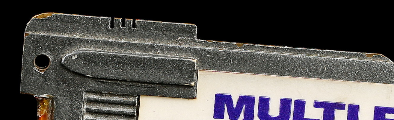

No real proof there, but it got me thinking about the Fifth element props from the same time period, the multipass was also machined brass painted with the same kind of flaky silver paint. I don't know, maybe prop makers/machinist at the time enjoyed machining brass?
It could be that tan resin, gray primer, etc.

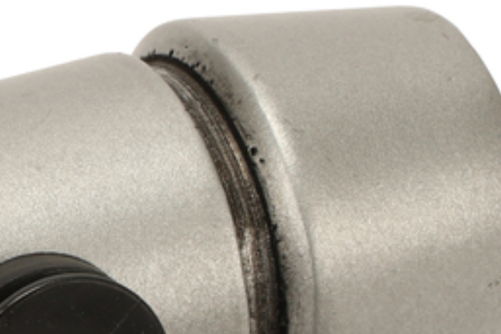

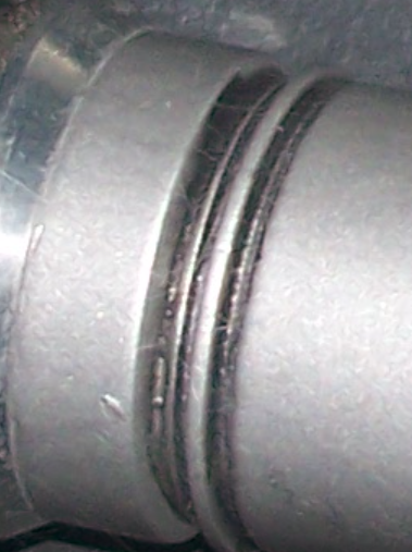

The clan saber bodies have a notably squashed appearance... rounded corners and edges, it's weird. There are definitely lathing marks but I believe the material.. whatever it was... was too easy to round off, compared to the brass neck.
This cast is good enough to see the original lathing marks, check out the edges (ignore the bubbles)

that is so weird if this is resin! I'm so confused!
So they did a lathed master from a material that we don't know. Then they cast it to create this hero with a possibly resin body and all metal greeblies. Then they cast that resin/metal hero to do other sabers with resin bodies/buttons/end cap but metal emiters.
that is so weird!
I would assume that this Hero here with metal buttons and end cap would also have the original lathed body since they cast it (clay residue)

Sorry, I'm going to go back to my multipass comparison just to post pics for people to check if they think this could be similar.
The photo for the multipass is of better quality, but I think it looks kind of similar.
edit: I mean, i'm also going in the brass direction because although I'm not sure of it myself, I have heard people say that the Anakin episode 3 skinnyflex was also machined brass. all curious!
edit2, sorry! BTW, the rectangle leds used on the prequel sabers were also used on a lot of 5th element props, including the multipass. Just a fun fact I guess but it also goes to show that this was a similar period and there was similarities in the props.

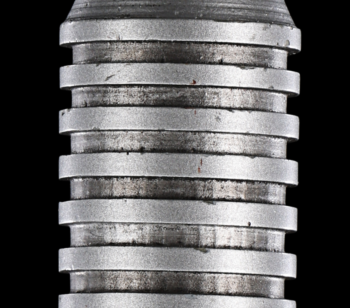

but those faceted artifacts at the bottom of the grooves on the luminara are something that happens with metal on a lathe when you go too far too quickly and the lathe vibrates:
and brass is particulartly prone to that lol. But yeah, I have no idea what metal they actually used!
good information on the lathing artifacts! I've only seen that on the old Obi Wan stunts and that was from the vertical lines in the walnut wood grain or whatever
It can happen when machining plastic as well. It has to do with how the tool hits the material and produces a vibration. If the tool is too low to the piece, it can skip.
