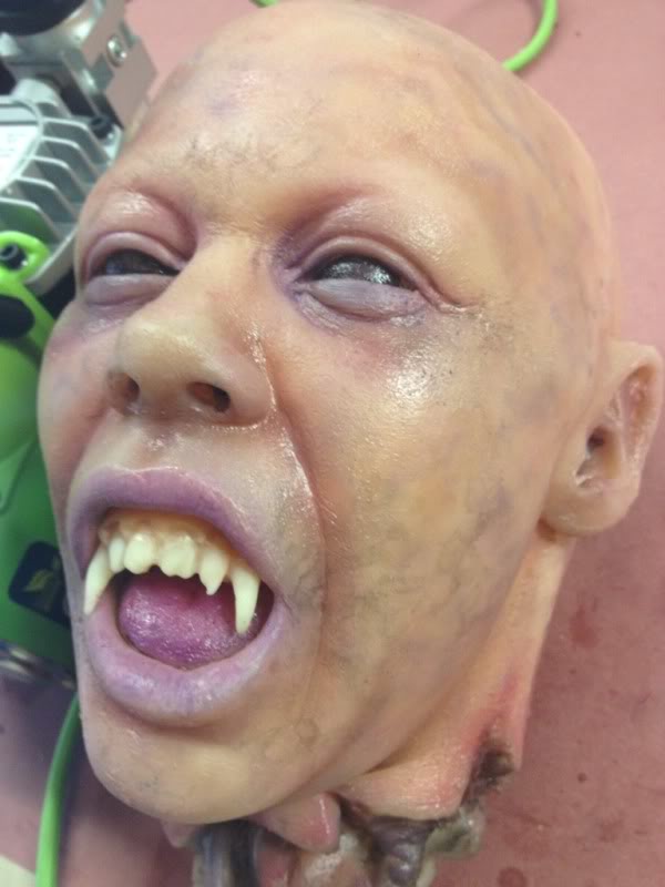

Thanks Clay ..i knew you'd understand what i meant. And yes ..your friend has skills ..its a whole different deal painting a mask, especially when the sky is the limit regarding texture, design, etc. The colors were too bold initially ..like each was a single pass ..the highlights and lowlights where extremely deliberate, where in nature there needs to be variance . The style works well in graphic design ..graffiti images.. pop art., etc. It falls a bit short when entering the realm of realism.
Again he did a good job for a first run at a mask.
on skin its about building subtle layers to achieve those interesting pattens that  nature yields.
heres an example ..this was an early pass on a severed Vampire head i did for fun last month ..this was about 90% done ( eventually hair will get punched)
i slowly built up layers and then went for some blacks and purples to get the necrosis down ..still needs a rice paper wash ..this was tin silicone with homemade silicone paint. Excuse the shininess i think i just gave it a naphtha wash :)
Ha ..I should add ..i hate painting skin ..it scares the **** out of me ..im so much more comfortable painting metallic. And I have so many talented painters at the shop  ..but now and again its fun to test yourself a bit

Thanks again for thehelp and the paint job is stunning-- love the depth. You are right-- subtle and layering!!!!
ha ..well thanks ..im more of an amateur when painting flesh ..i just get work with so many talented guys ..BUT ..i do have to oversee all their work .. so i guess that makes me a paid critic at times.  And Im happy to help. its honestly how i learned ..this place was really my school when it came to the early days of my art. ..My film school didnt have a makeup program back when i attended ..all the guys here were my teachers ..honestly ..they still are
