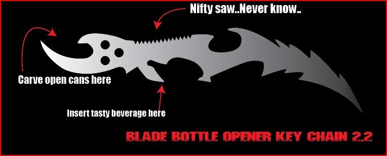

hmm....don't know, Reyals. With a fine looking blade like that, thereI would totally purchase one of these.
may be a greater chance of having the above play out in real life
waking hours than you may think. Count me in for one as well!

Damn. I want one![]()
lasercutting is the other technology that I forgot to mention that would be able to cut these.
Were you getting quotes from just your local places or were you looking at mail order too?

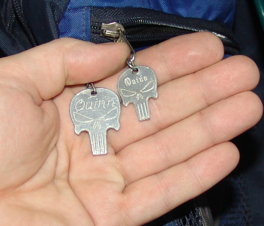

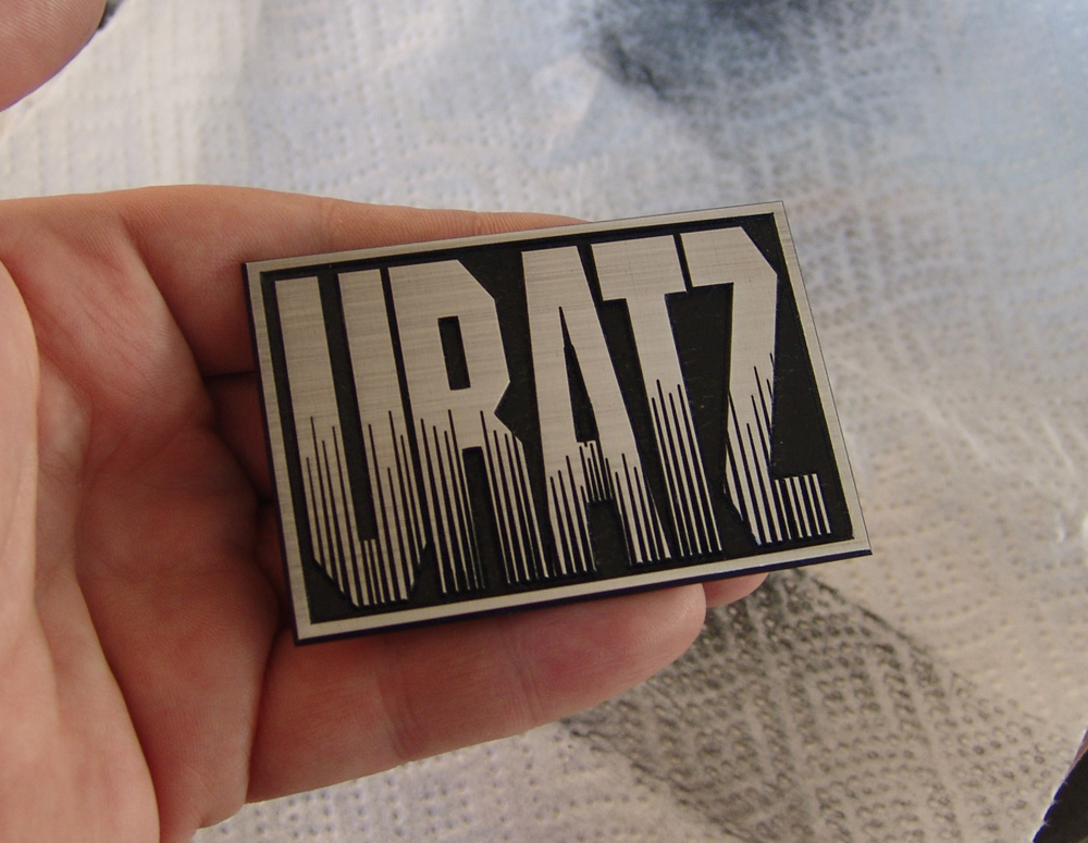

Yes, that was aluminum. I could come really close to making this how it's drawn but I don't think milling is the best way to make these. Part of the limiting issue is bit diameter; it can only cut inside corners as small as the cutting bit (effectively, the kerf). The V-bits give it an allusion of an inside corner by ramping out of the corner. The laser, waterjet and even plasma cut virtually straight through the material and minimal kerf. This will reproduce good inside corners of this design. With a mill there is a trade off of end mill size and detail. With the URATZ plaque I used three end mills, a V-bit a 1/16” end mill and a 1/8” end mill. The steps add up and sometimes it's also better to do hand finishing like the holes in the zipper pulls were drill by a drill press but the center hole was done within the skull design. Needless to say there are man way to come up with similar results, you just have to be aware of your choices.
