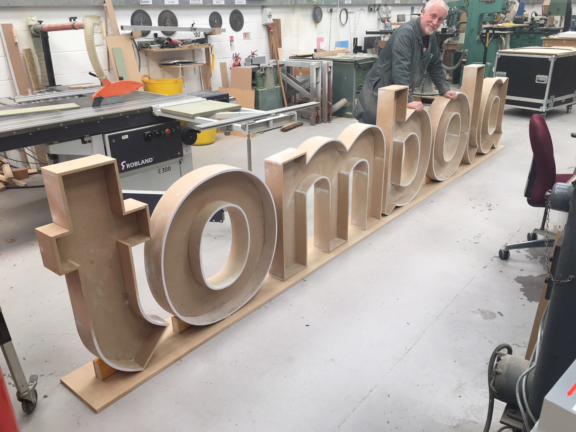

It may be quicker / less messy to fabricate the letters from Sintra PVC sheet which is weather proof, flame retardent (it is in the UK) and lightweight, or water resistant MDF.
Out of interest how large and deep are the letters?
This is an example of letters we made from MDF.
Pro-Mod...great sign btw (y) (y) How did you achieve the rounded parts of those fonts and how thick is the MDF?
Thanks joberg. The Mdf was 12mm and for the curves we used 2 pieces of 6mm Flexi Mdf with the grooves facing inwards. Once the glue had dried we filled the open grooves with car filler. It was used in a TV commercial and then thrown in the skip!
