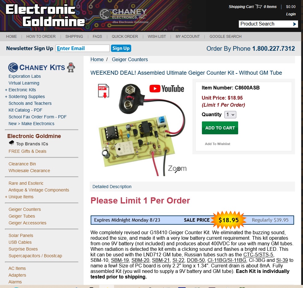

If you don't want to build it, Electronic Goldmine has about the cheapest "built" Geiger Counter at $40.00, but if you are on their mailing list sometimes it gets put on sale.
C8600ASB - Assembled Ultimate Geiger Counter Kit - Without GM Tube

Here comes the "helpful info", Electronic Goldmine has their small Geiger Counter on sale for $18.95, now you are limited to one per order, but......:unsure:. At that price it would be hard to build one from scratch and have it be cheaper......;)
I'm sorry for not sharing, I just find it better to give helpful info and pass on the personal stuff, I hope you understand.....:)
Thanks!
However, it seems that this unit does not come with a tube (which may cost up to $20) - and they want >$6.- for shipping. So, it seems that aliexpress has the better deal. In any case, I still have a few other projects on my list. Anyway, this is not a short-term thing, but something I will keep in mind. Possibly as an add-on for a future project, maybe some hand-held "SciFi" device (whatever that may be...), just like your pipboy which is so cool. Thanks again for the inspiration!
