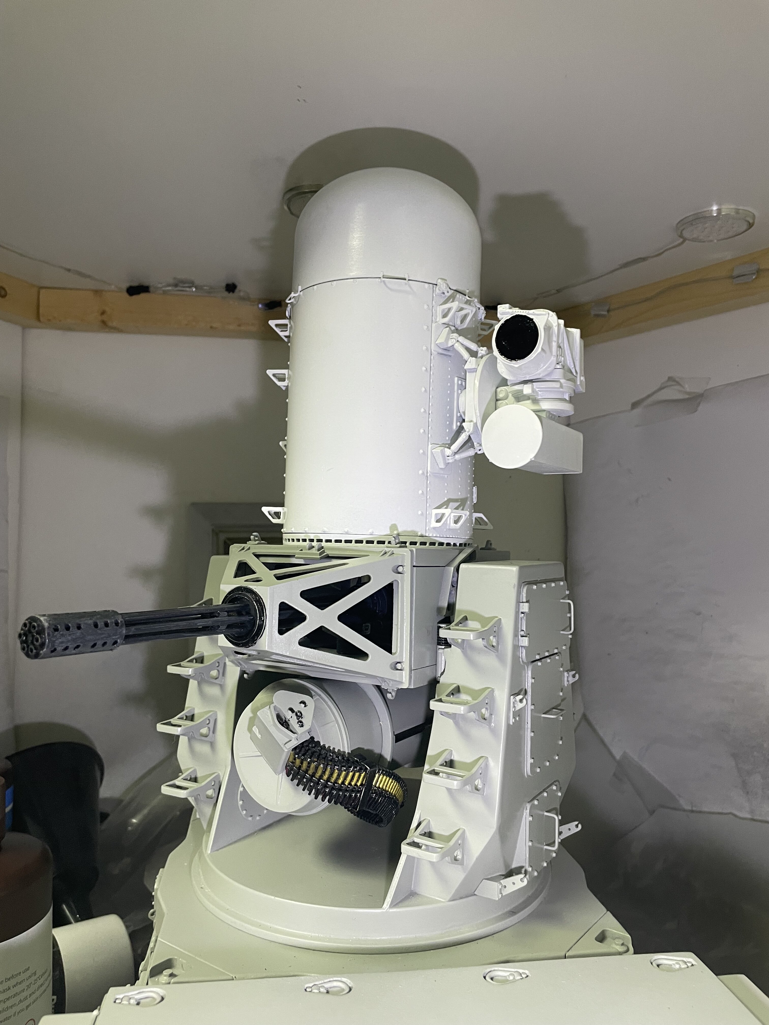

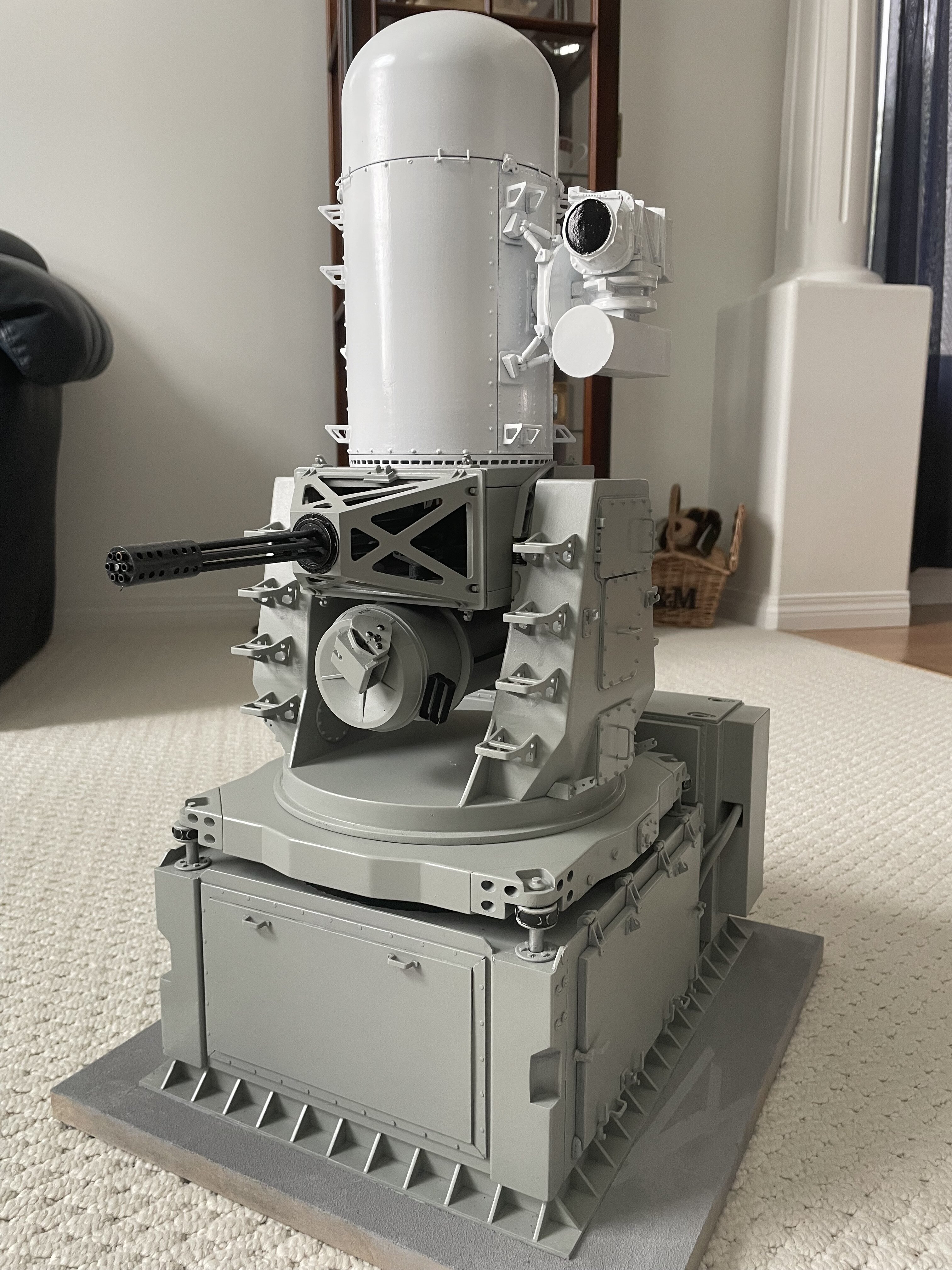

Finally I have started painting this. I printed out the ammo chutes using Anycubic resin, but noticed it was really translucent and was easily broken. I have some Elegoo resin on order which I've had better luck with. There is really no spray paint equivalent to modern HMCS colours, unless I mix. I wanted to complete this faster, so I just used Tamiya AS-2 Light Gray (Imperial Japanese Navy) which is a pretty close substitute.
The base will be painted flat black and I will slightly weather the white radome with a light wash to accentuate the detail if necessary. The M61 cannon needs a bit of work too. I have warning stickers and placards made as well.

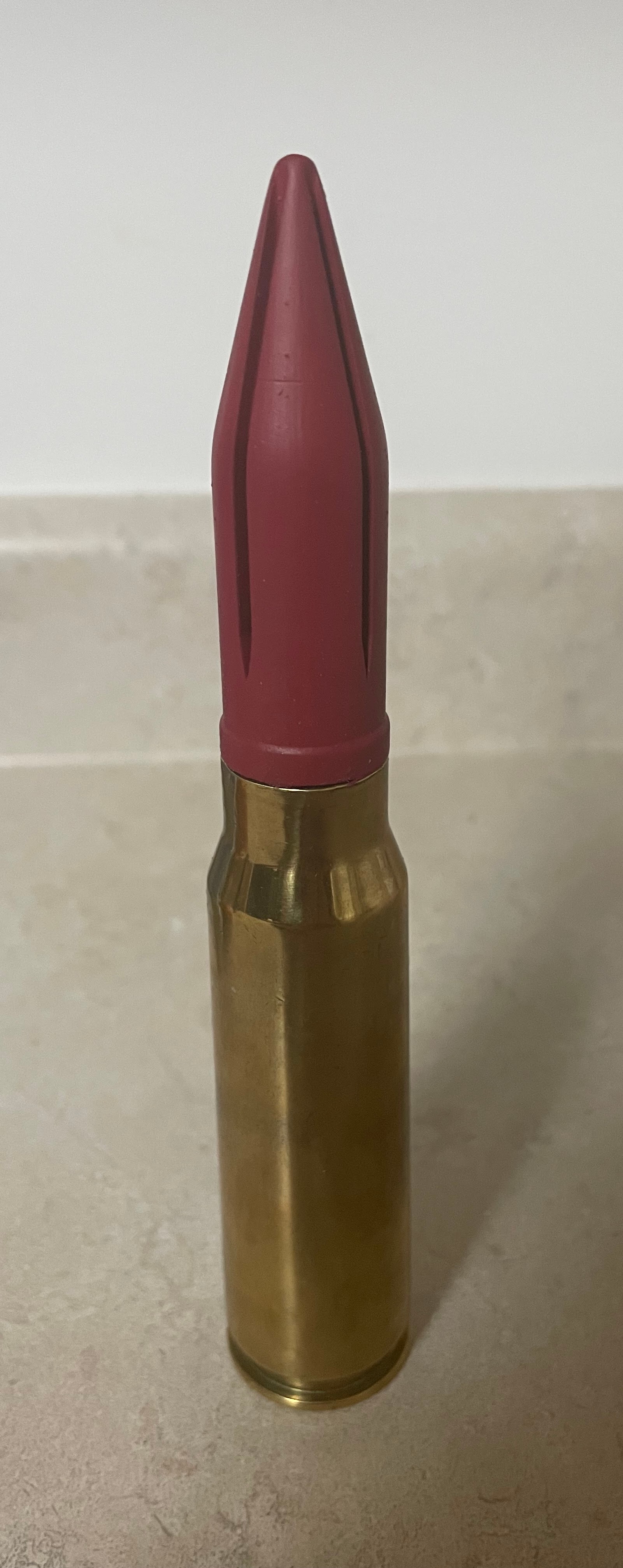

I have madea 20mm APDS (Armour Piercing Discarding Sabot) bullets for a polished 20mm casing, to display with the CIWS when I finally get it finished.
