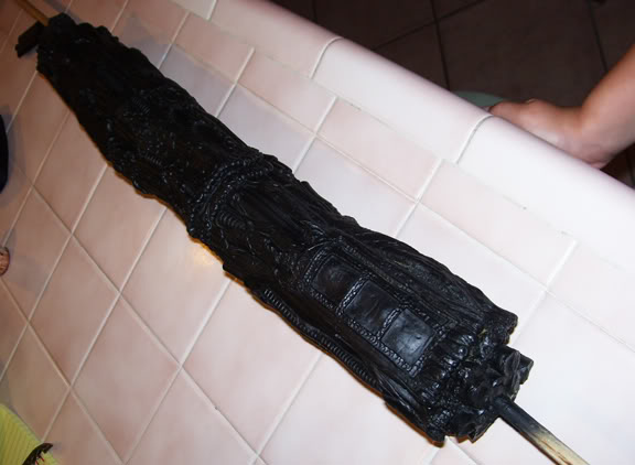

pumped the whole can into the mold ...came back the next day and check it out
painted with flat black enamel paint

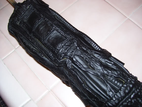

Close up of detail( pretty good)

best part of the whole thing is the weight on it...not even a 1/4 ounce on the piece

Very cunning. Foam looks as though its picked up detail pretty well and it must be great having it so light.
