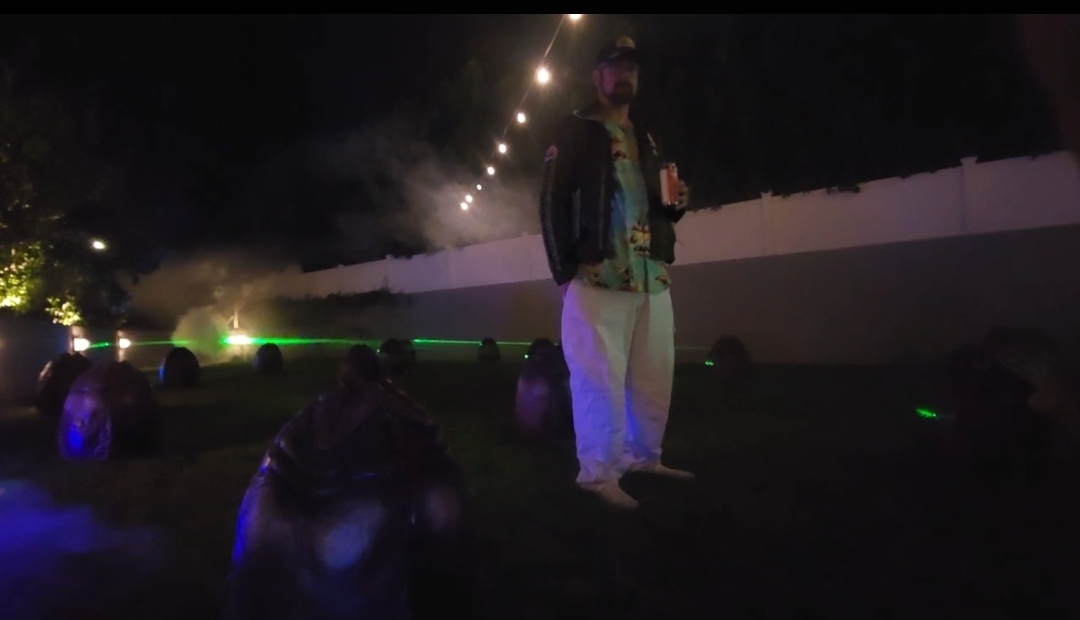

Looks like a great party! The eggs look superb. That lazer is the cherry on top. Looks like you guys had a lot of fun.
