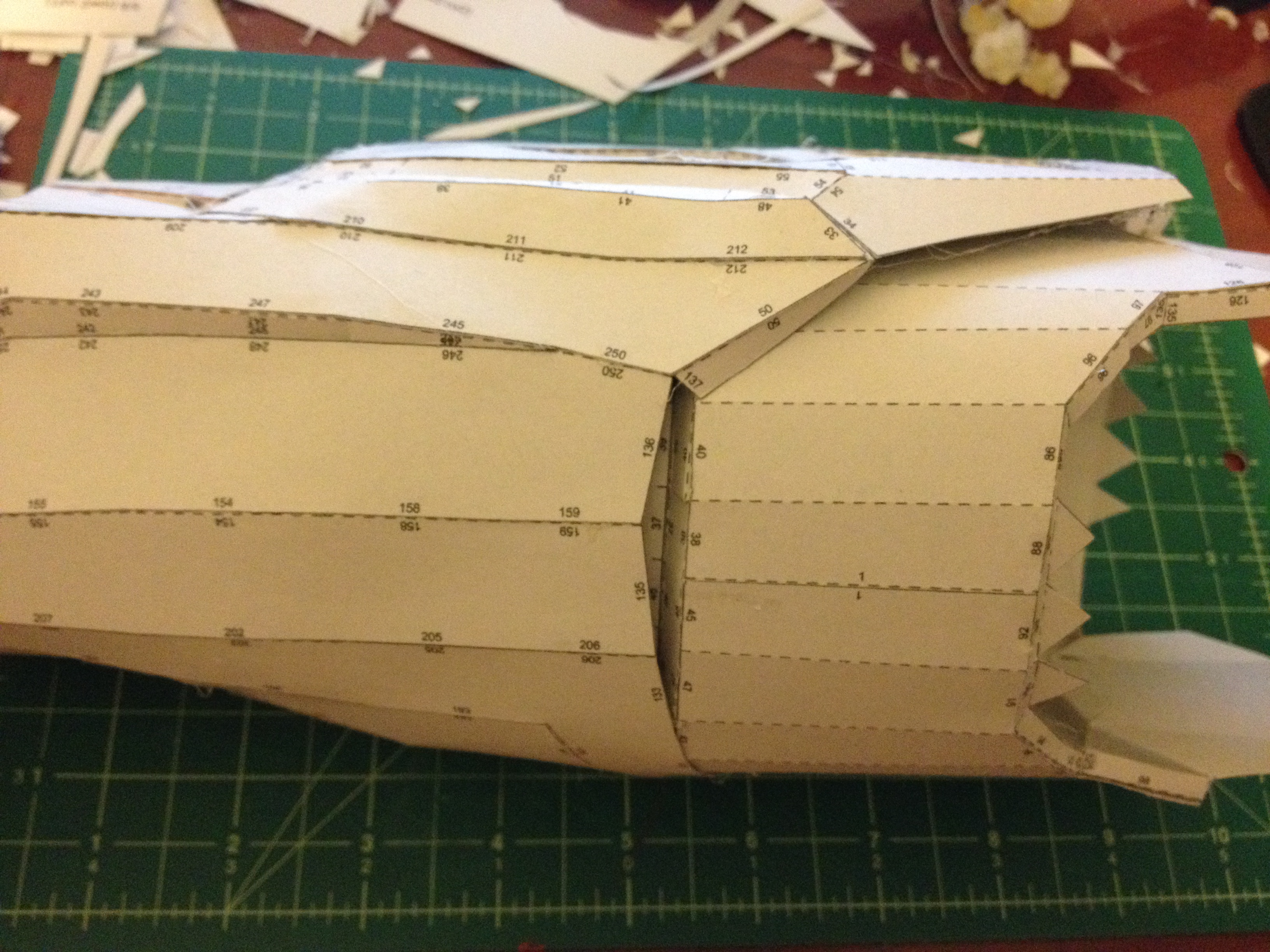

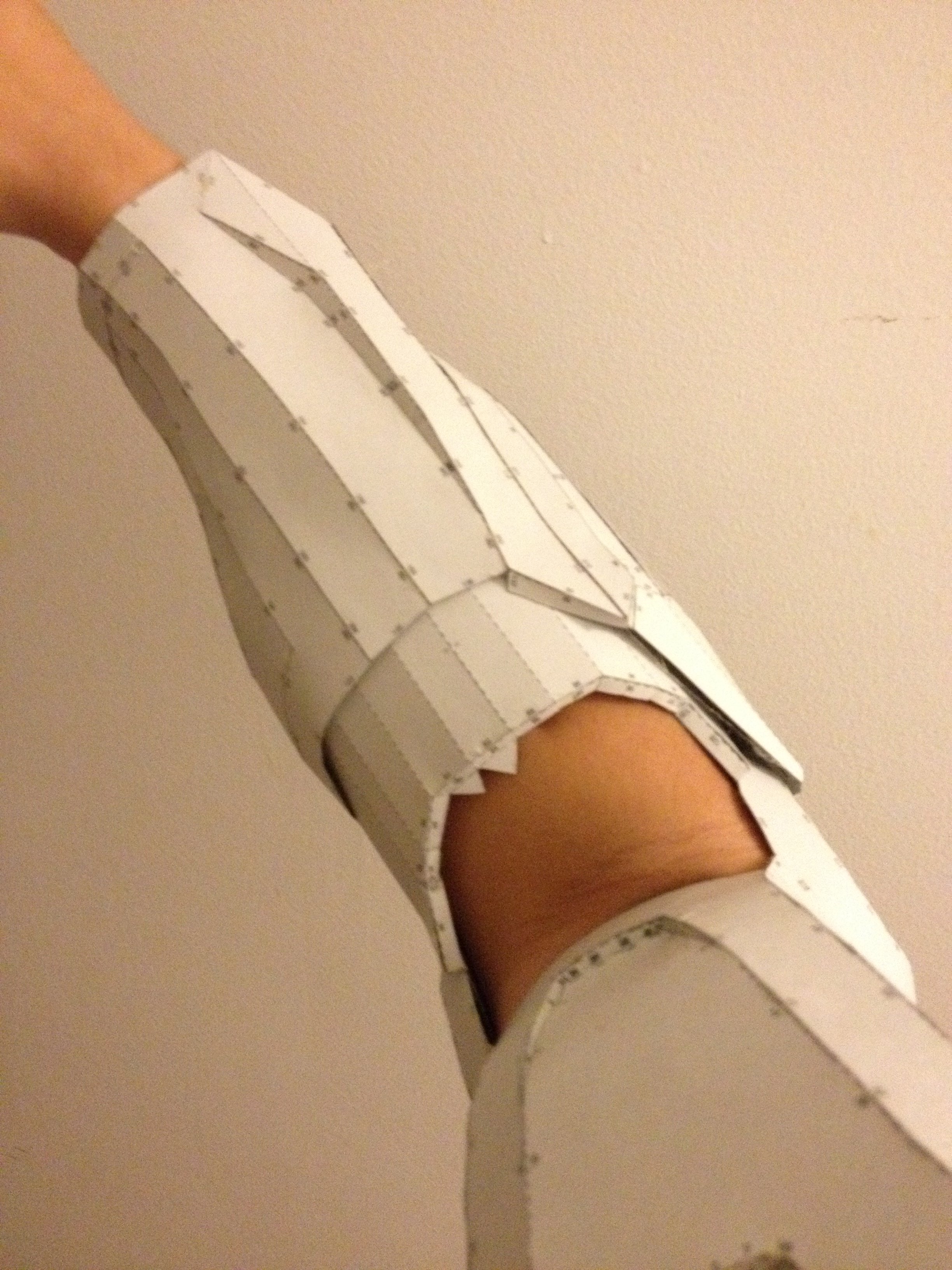

I'm having a little trouble scaling the bicep; for some of the distances, the scale seems appropriate, for example the distance of the back bicep area (from near shoulder to bottom of tricep) is correctly scaled to my arm, same with the length of the bicep, except the distance between the elbow joints are quite small. If I enlarge the scale to increase that distance, then the other places will be out of scale. What should I do?
I was running into the same problem this weekend. I made three biceps before I was happy with what I got. It might be a little snug in the elbow. Guess we'll see come fiberglassing.
Yeah, I ended up using another member's suggestion of scaling up 10% twice. Seems to fit rather nicely, just have to make sure the elbow and forearm will work with this. Good luck to you
Thanks. I ended up having an epiphany Subday night after making 3 different sized biceps. I was on my computer looking at an image on google of the concept Mk 7 from the front, back, and sides and realized that I can use the helmet as a base for all my proportions. My helmet fits me perfectly and it's actually from Darkside501st. So scale is not the same in Pepakura. I took the helmet in the side view from the image and figured out that the bicep is 3/4 the width of the helmet, front to back.
I plan on doing this to all my files and hopefully everything pans out all right!
Nice! Yeah, if only Omarbou1 was able to use the same scale for all the pieces, that would've made things that much easier, but I'm sure he has his own reasons for doing so.
I'm trying to get it to a very similar look as Legacy's picture http://img1.wikia.nocookie.net/__cb...ored_suit_3d_model_by_scarlighter-d55p5u9.jpg . As long as everything looks decent in person I don't mind the scale being off by millimeters.
Think I messed up the scale for the lower forearm. Almost impossible to fit over the upper forearm, Someone said they used a scale of 286 and 237 and I have no idea how in hell they got it to fit together. :unsure If only the entire arm came in one file to scale easily.
