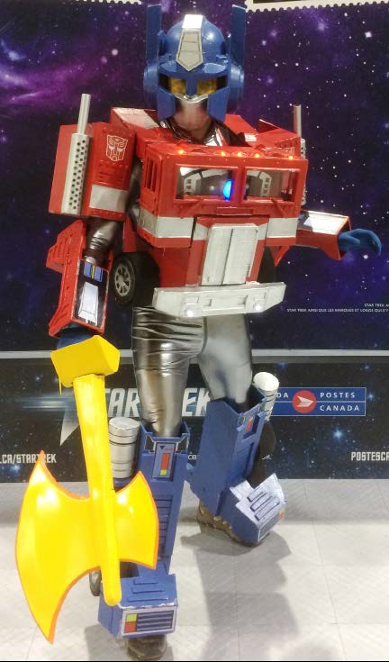

Thanks George! It also had original cartoon cannon sound with button hidden in the pivot control grip. Since you've said so, here are my other Transformers:
9.1 scale (except head) Optimus Prime, cardboard but with EVA axe. This is the 3rd upgrade of my 1st 'hard' costume and launch into cosplay.
Multi-scale as needed 8.5' Devastator. Aluminium frame, hard insulation foam & EVA. Rigged so that without head & lower legs it passes sideways through a standard bathroom door - That's why the upper arms are lower than the toy's. Idea thanks to a poor ******* in a fiberglass Warhammer suit a year before that was too wide & deep to enter the venue!

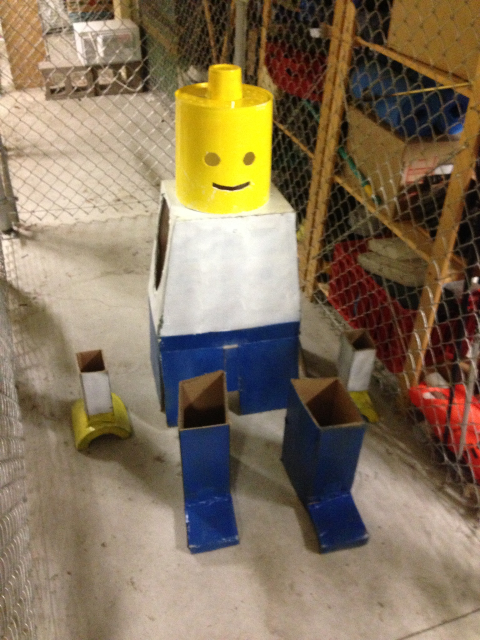

I go with what mode of costume design I want to try, and then a character that I connect with. I'm not as much for current movies as I haven't had so much time to connect with them. Thus far they've been fairly mainstream still, but we'll see with the next one. Since getting into cosplay with a last-minute idea of original Lego Man, I've had a thing for shell costumes as you can lose yourself in the character when you are mostly covered. (Lego Man-Optimus-Megatron-Devastator-I.G.-I.M.)

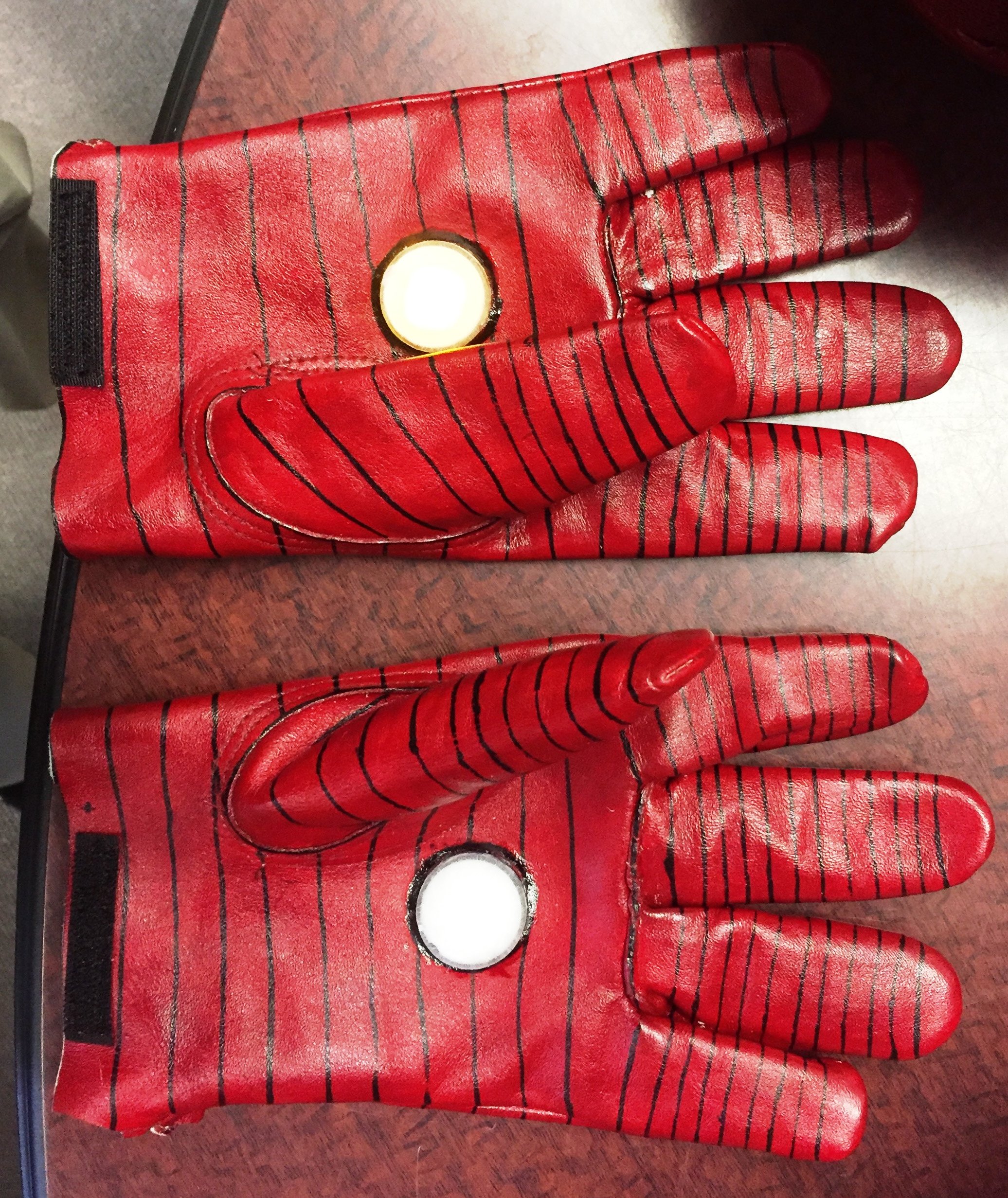

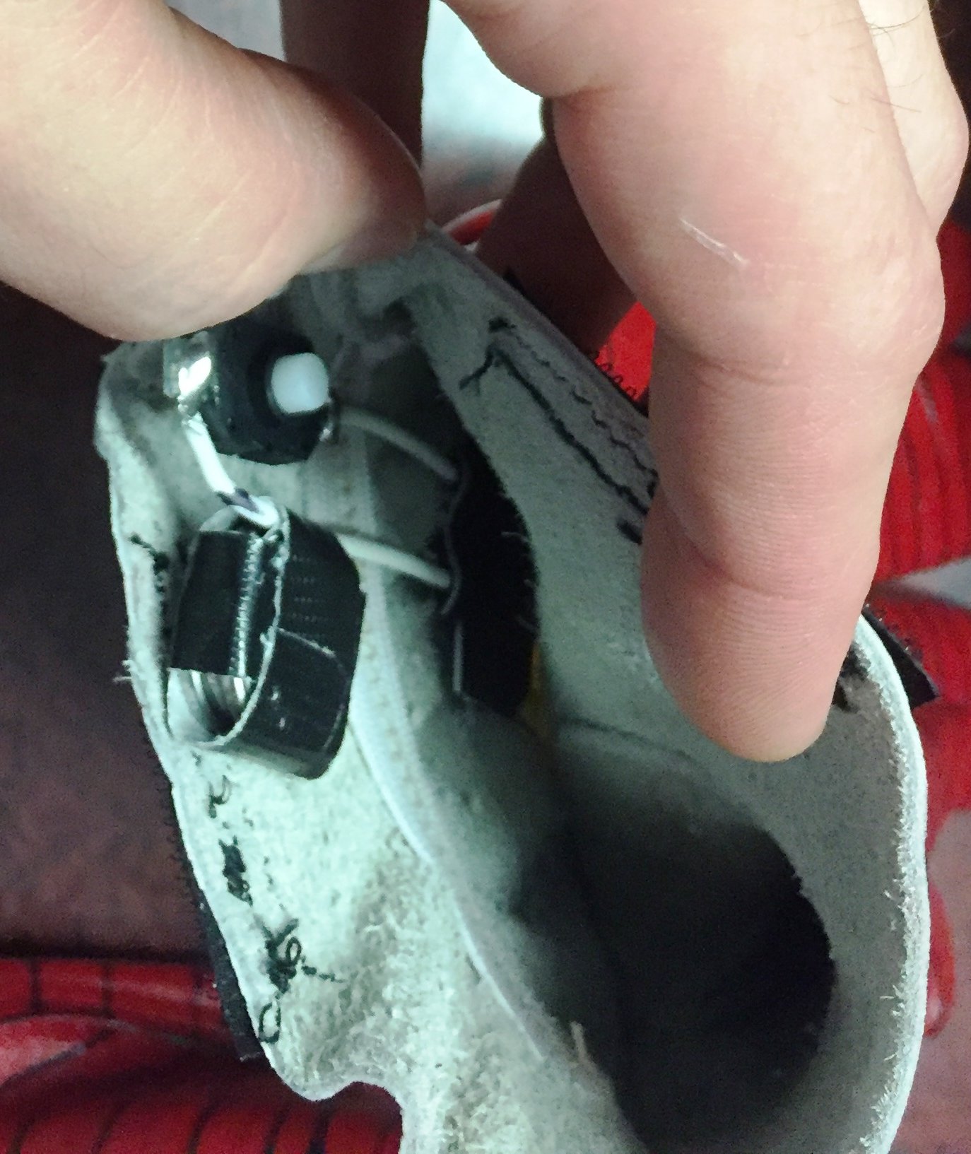

This is my first time using a breadboard, but it worked out fairly well. Identifying short-circuit is pretty quick with the parallel lines so clear (vs. home-made loose wiring set). A bit tight quarters but very workable as the solder doesn't easily run across the breaks.
Would have taken more photos to detail the process, but was running late..! From the breadboard shots my process was:
- Solder on pair of thin metal leads to breadboard, as my stock wire is too thick
- Solder on pair of wires
- Check layout to glove, with battery set & switch within glove just before the cuff
- Trim wires, solder on button-switches taken from 24 LED puck lights. Button pressable from outside of glove
- Tape 3x 3V button batteries together, then positive & negative wires to that
- Mark & trim down to desired height the pair of plastic (superglue container) tubes, to cover the LED's plus contain 1/8" of magic eraser material as a diffuser
- Sand off the bottom edges & markings, and then go to 120 grit to make the plastic a diffuser as well
- Place & mark off where the covers sit on the breadboards
- Use Carpet scissors (you'd want heavier) to trim down the breadboards, then sand with 60 grit sanding sticks
- Trim magic eraser wafers to fit into covers over LED"s, as test showed the 4 points of light too clearly without
- Superglue covers to breadboards
- Use spare tube to mark location on palm of glove where to place, using black permanent marker - same as used for lines on gloves
- Use snips to trim away circle within black layout marks, leaving black circle
- Place assembly within, and press leather down flat against ridge left outside/around LED cover
- Superglue around cover. Follow up with 2nd application after initial drying for any bits that don't appear well glued
I'll have to be careful when taking the gloves on & off, but the lack of flexibility of the superglue is nullified here as it is on a hard object; the leather around can flex for all movements.
These repulsors are not as bright as I'd like, but for my first run at such a thing and as they don't interfere with my grip at all I'm calling them good. Can easily turn on & off to conserve power. Will look great in the bars and not mess up photos, though my unibeam might. =)

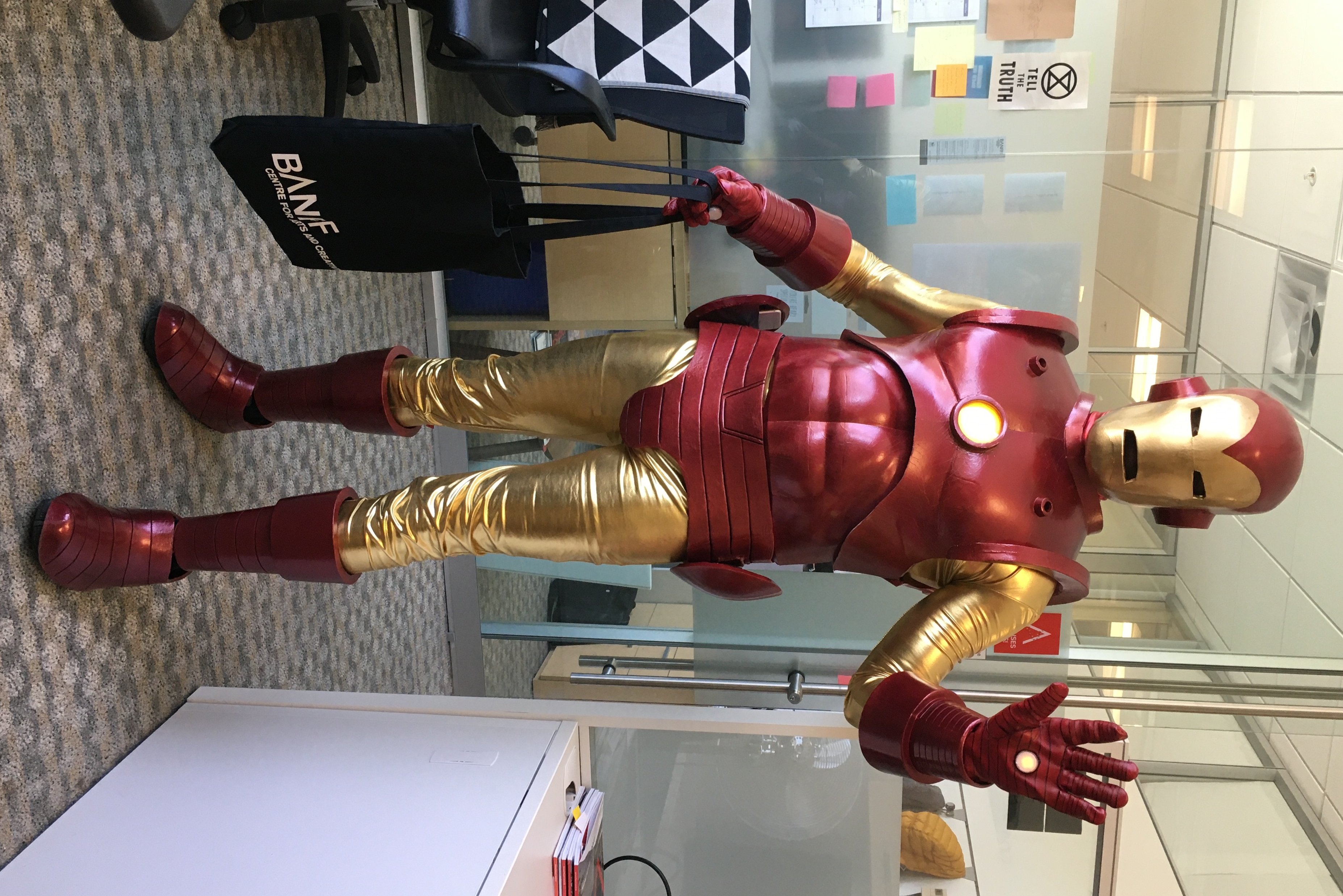

2 hours to first of 3 adventures today wearing it! Will wear layer of thermal underwear under the bodysuit for the fireworks show.
Hope to post pics of the afternoon run! Happy with the proportion of the new side pods.

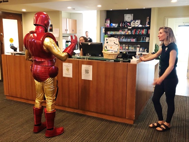

Campus tour a win!
The hip pods tilt out a bit, but not a big issue? Got dressed without a mirror so will be able to snug up the stomach wrap to codpiece better for next event. Also, the repulsors will look better in the dark. Was happy with how easily I was able to switch my repulsors on & off; with the button batteries being so small I don't dare leave them on long. I can't toggle my unibeam once dressed, but will just change AAA batteries between events. I'll get more button batteries, but it is a process to switch them out. Mobility/range of motion was good.
Pretty warm indoors; might bring a small hand fan with me once more as I did at a prior event wearing my less ventilated Megatron helmet. Regardless, will need to drink heavily to maintain hydration. =) This time perhaps I'll try vodka, water and lime and see if that's doable.
Just have to brace for paint job damage at the bar, but at least prototyping tells me that 5x fresh coats of wax mostly covers up wrinkled paint 'damage'. Wax should enable wiping off stains.
