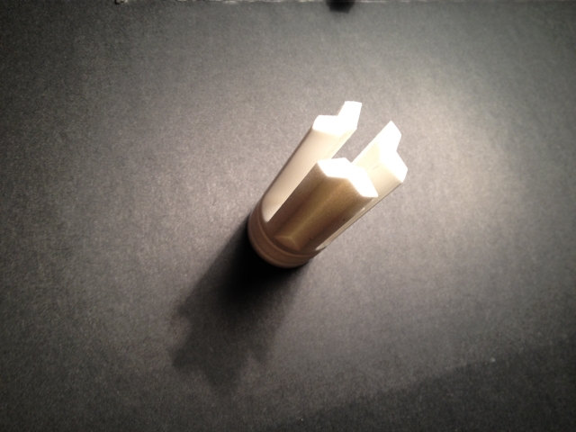

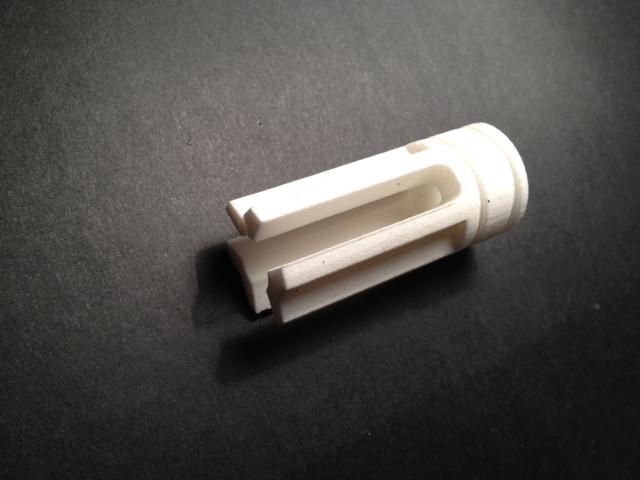

Heya WS- this is probably too late for you but I just got this in. I was printing up a bunch of kits and threw in some parts for my own rifle build. I can't say that it's 100% accurate but if it's of any use to you, let me know and I'll get you a link to order one (at-cost) for molding.
//Joe
Re: Oblivion Movie Rifle - Taking Deposits!
That's cool sir! But I was sent one that I cast off of and combined with another part to get the most accurate look. ( I hope) but thanks for thinking of me! How's the pistol coming along?
