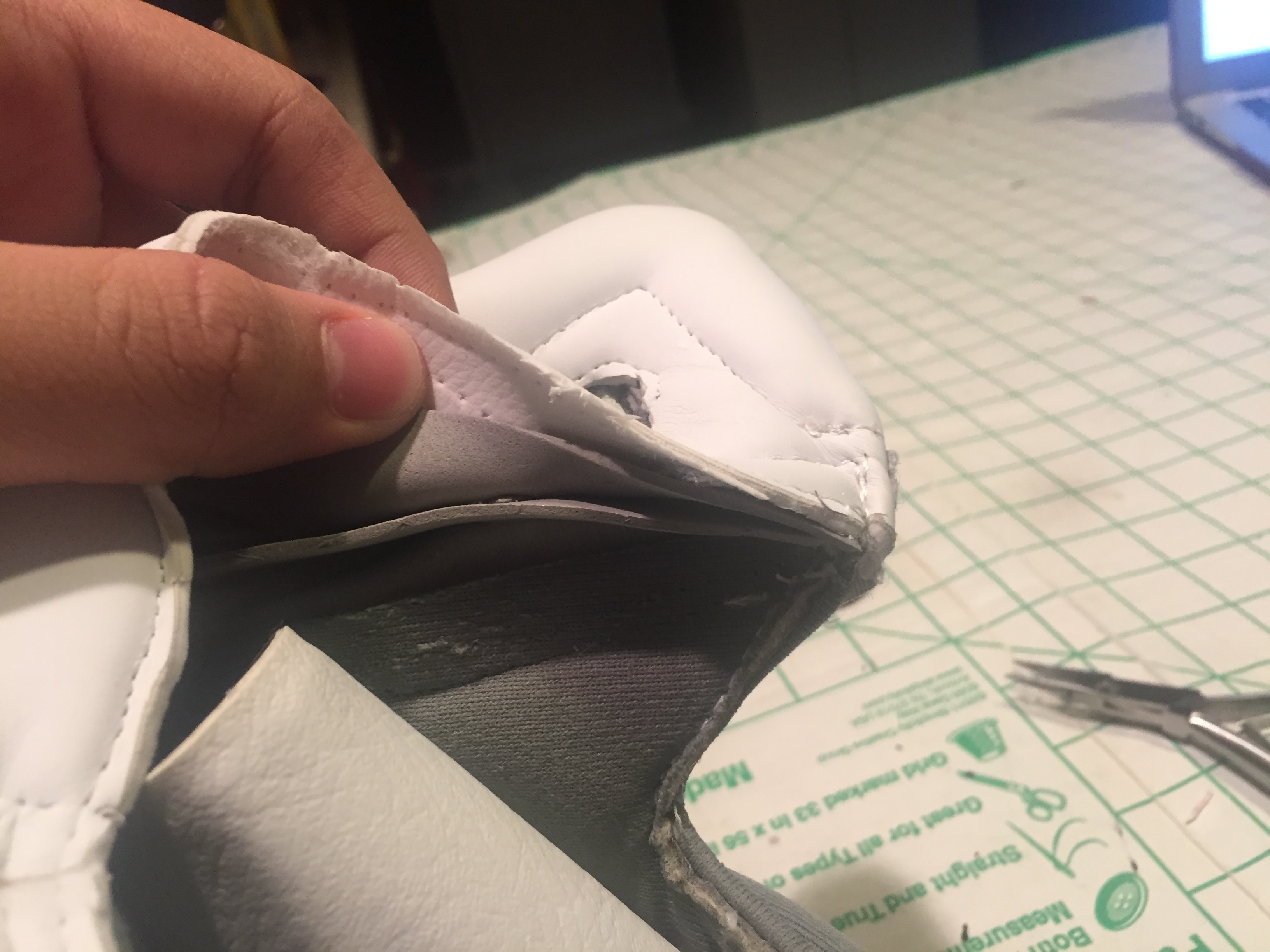

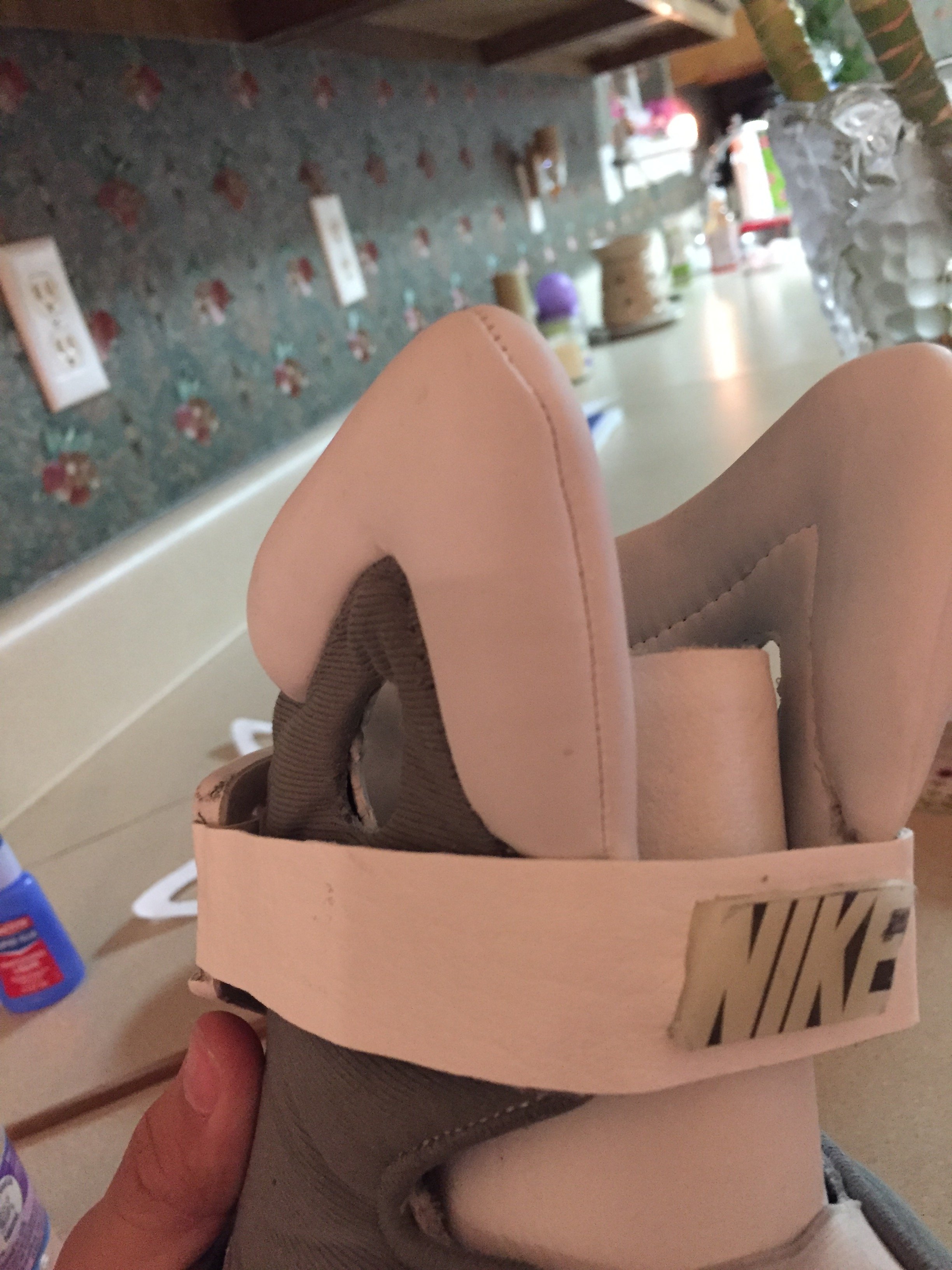

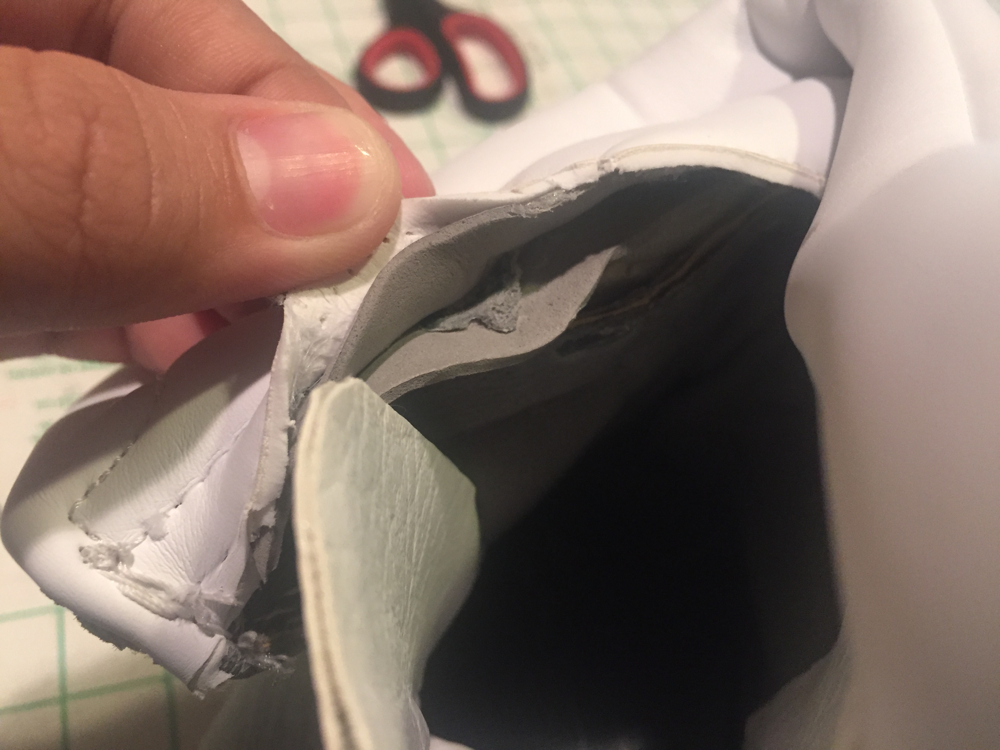

I'll take some pics now I haven't glued them back yet

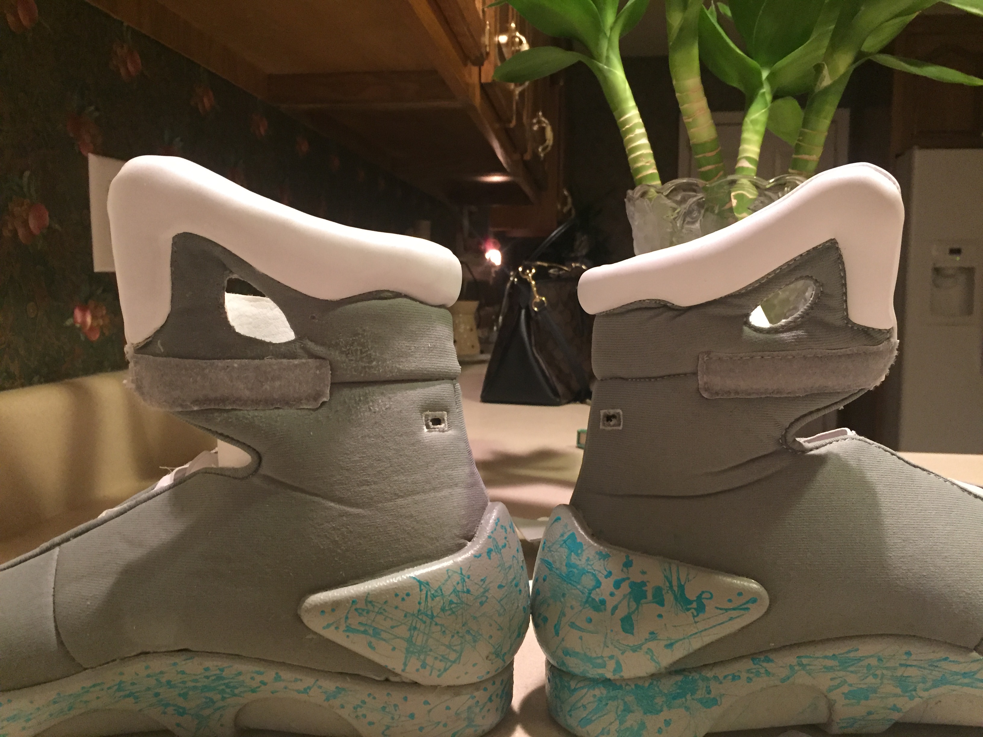

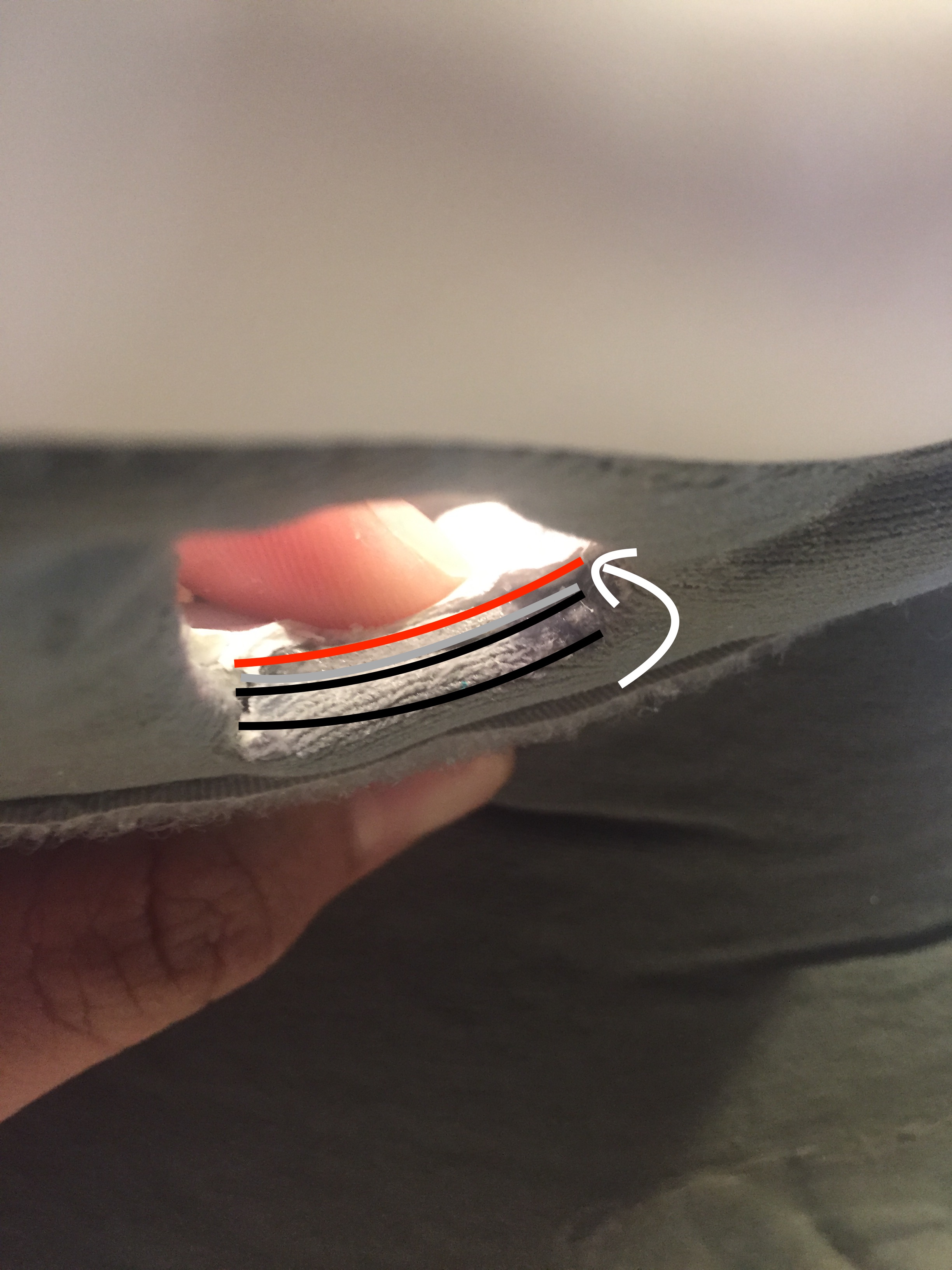

(Key for 3rd photo)
Red is start of second foam sheet
Black is the first foam sheet
Grey is fabric folded over first foam sheet
If you guys can see its basically just tucking the fabric and glueing it down with some superglue and glueing the second foam sheet on top of that but glue the edges of both triangles to match usually I pull and sift the first layer of fabric and foam to match the contours of the triangle shape to get that rounded triangle.

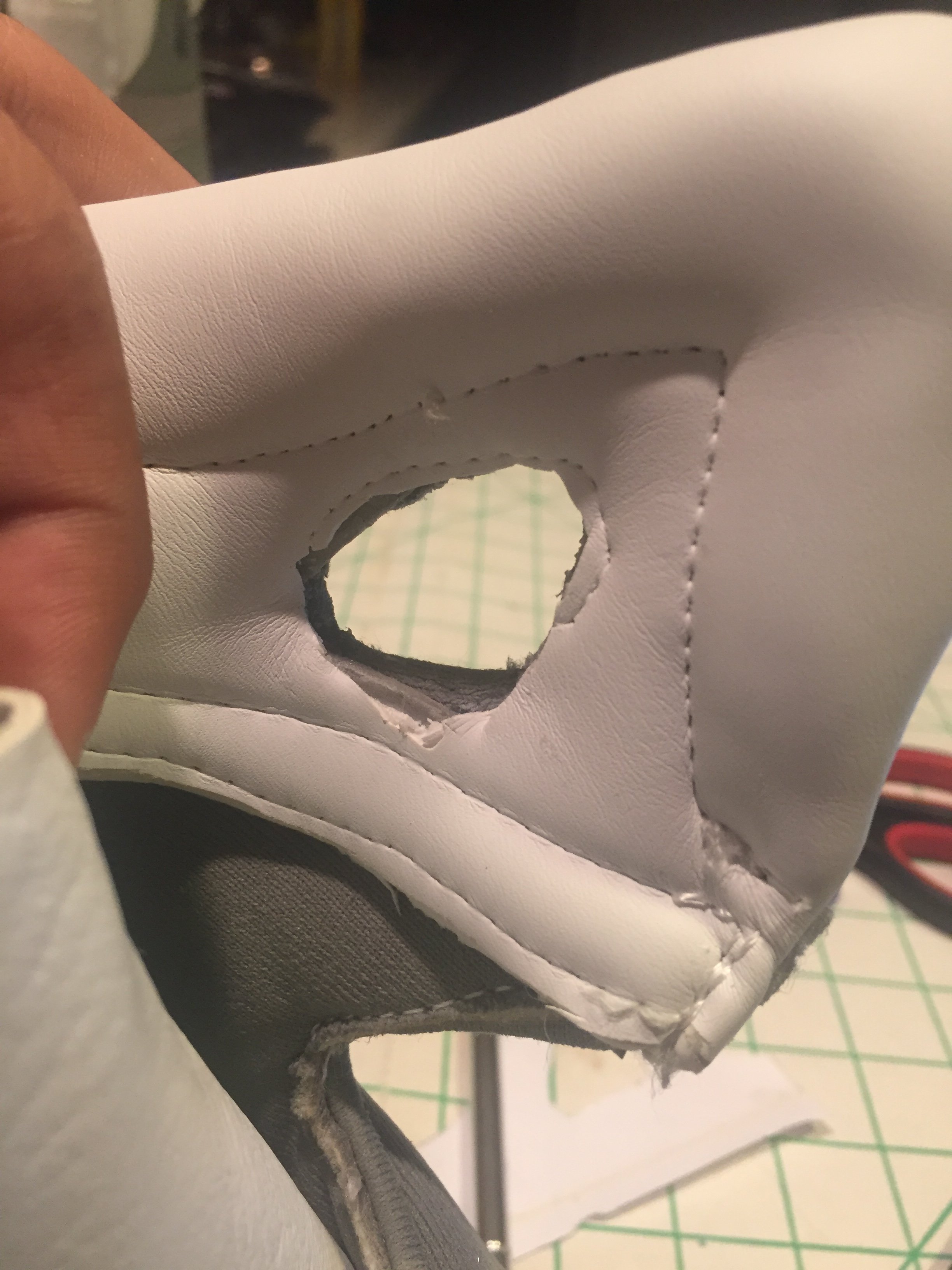

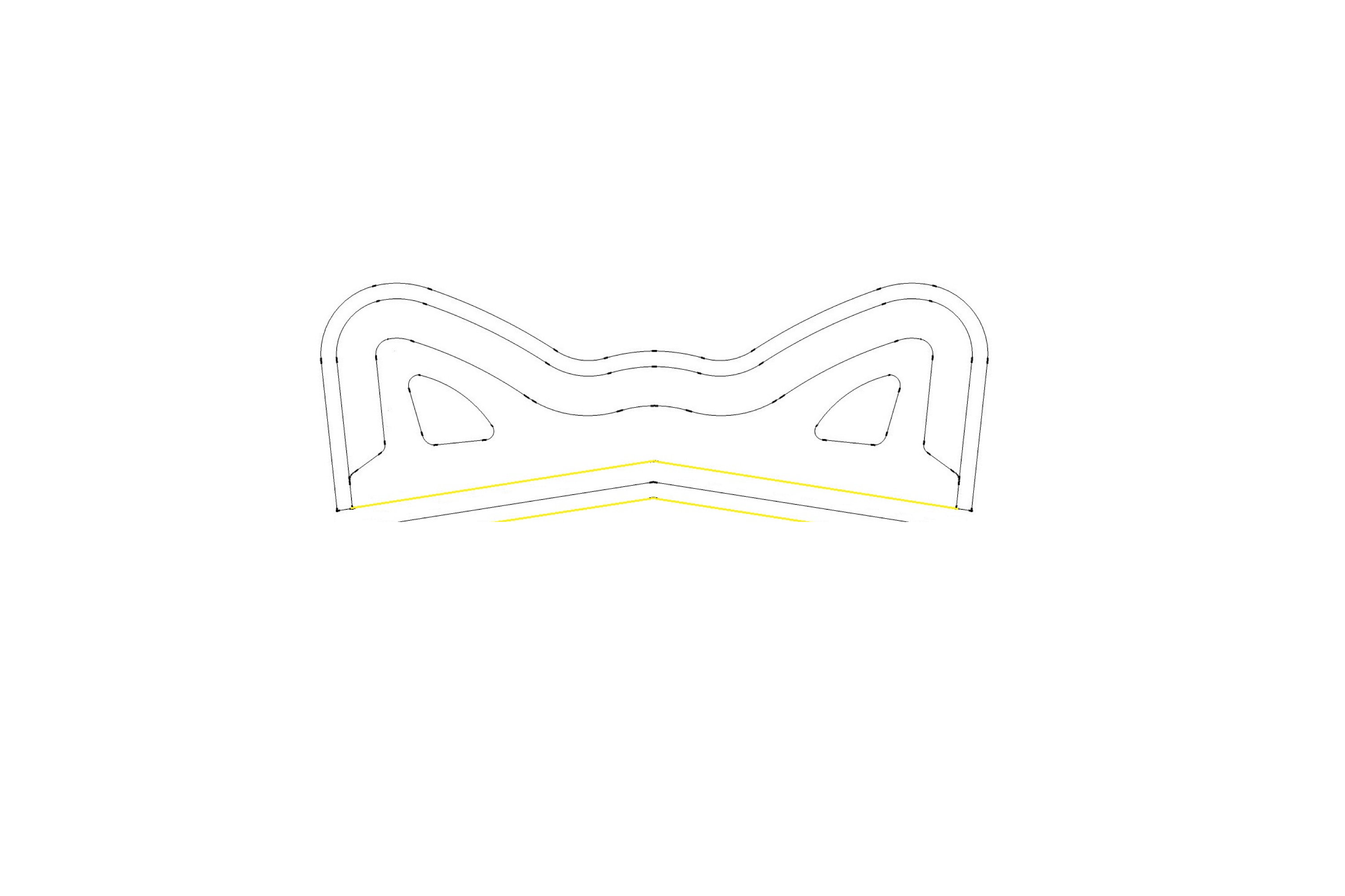

I basically cut the stitching where the white cuff was around the bottom, sides and pull holes are I had used a template that cavx gave me a long time ago for my tongue mod and had a upper template so I sized it to my shoe and cut it out onto foam about 2 sheet for one side. First I undid the stitching and removed the foam in the collar on the upper. After that I cut the foam upper in half so I have two and placed one in the upper trying to match it with the oval pull hole. After fiddling with it to get to where I can cut the oval fabric and pull it over and glue it to the edge of the triangular pull holes I cut the white leather upper on the inside so it can match before glueing everything back together I used the other half and glue it on top of the foam inside and gluing mainly around the triangular holes so the shape will stay. on the template I used there was excess at the bottom of the foam so cut it off. After glueing both foam sheet together I glue down the white leather on the road so it looks like before the stitching was undone. I don't think this process has been done before by anyone else so I'd give it a try. The main goal of doing this mod was to preserve the fabric of the original shoe so I don't have to make a whole new upper and find matching fabric. For the collar keeping it straight I cut some coat hanger wire and superglue some foam at the ends and placed it into the collar BEFORE glueing the white leather back and bent into shape. (the upper template is from cavx when he was making homemade mags I just edit it for the upper by cutting the upper portion off and printing it off.)

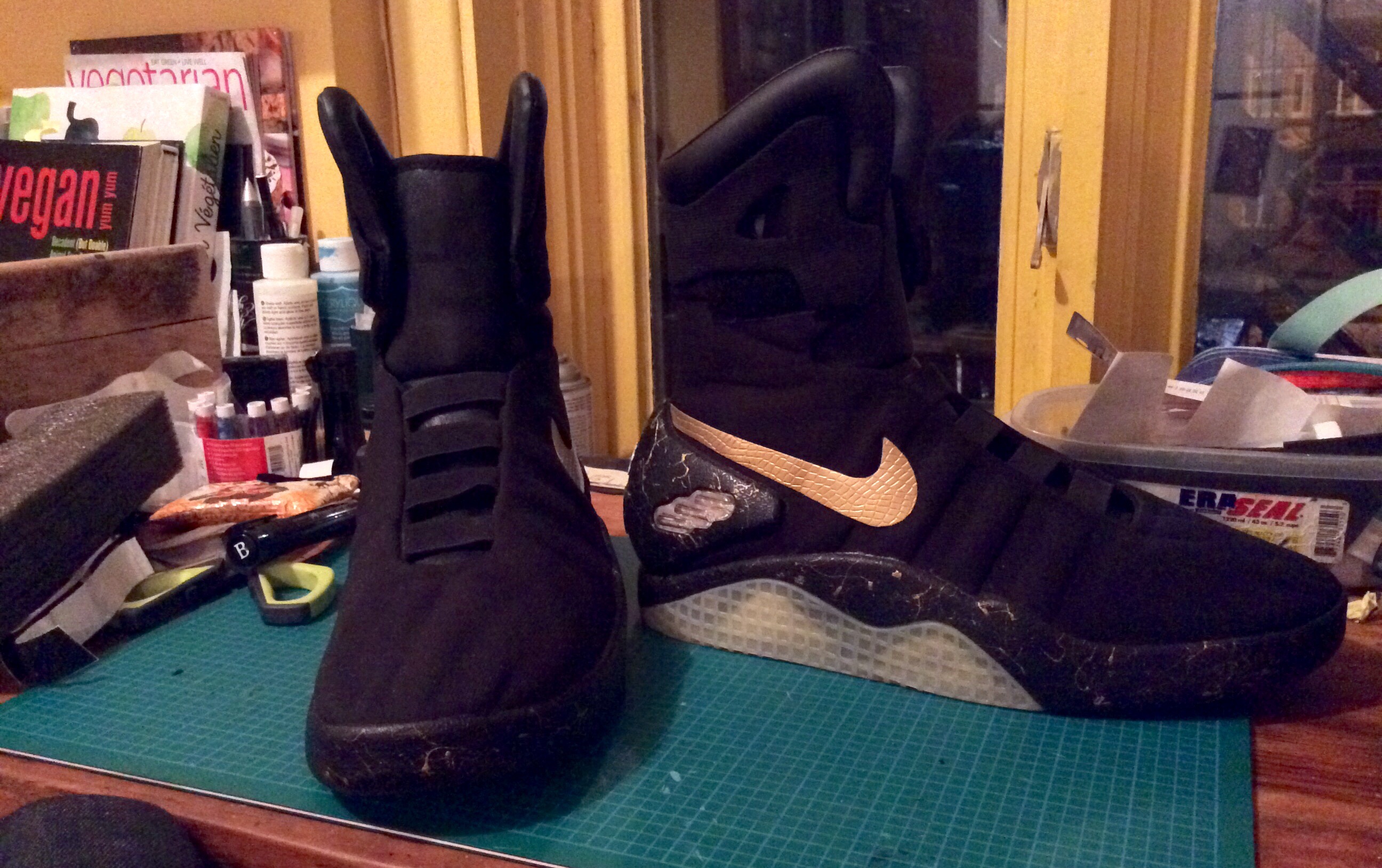

Btw, here is the thing i wanted to show you guys :
They are self standing and "shapeable" (to a certain point) now :devil

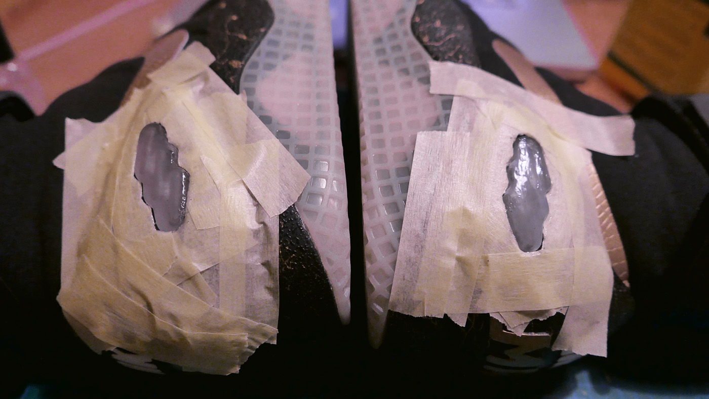

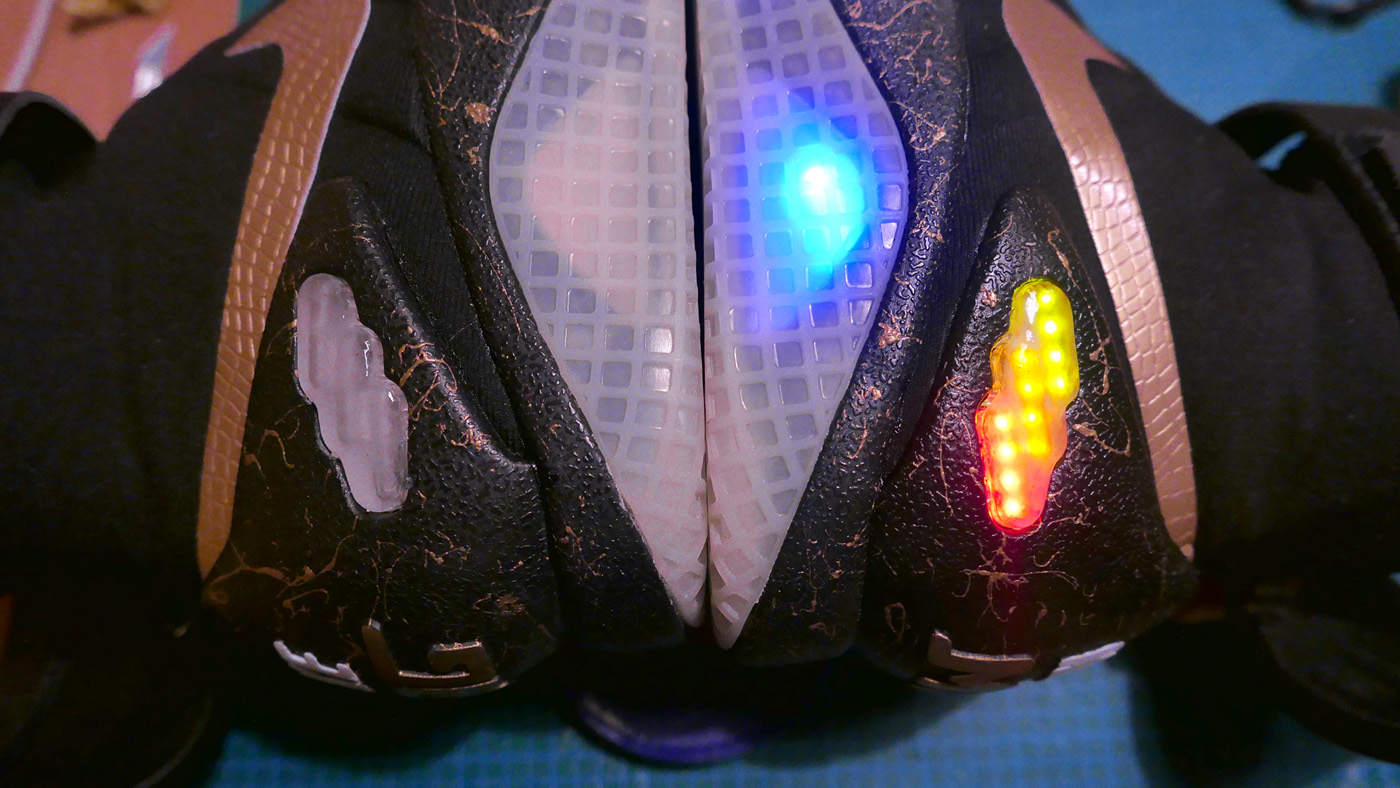

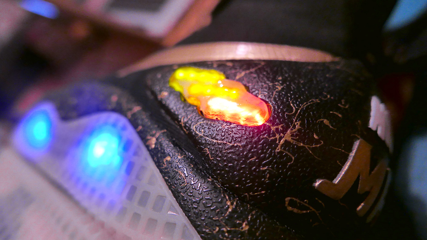

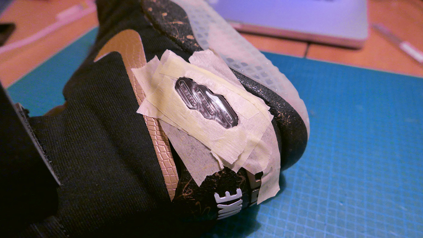

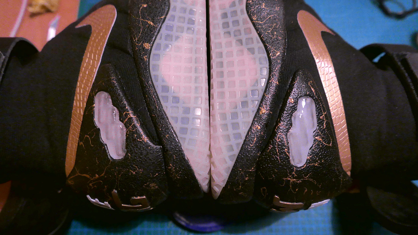

New mod : Frosted bubbles :)
1 - Put some masking tape :
View attachment 567709View attachment 567708
2 - Apply the varnish :
3 - Get rid of the tape :
View attachment 567711View attachment 567712
Only 2 layer of varnish + white pigments and voila ! No more visible GYR text :) :

great, now don't forget to put it at heat with hair dryer or heatgun after it will finish to remove the glossy finish like mine.
ok, but actually, i did add a glossy varnish on the frosted coat to get a better finish. But if you say that will make this less glossy, i might give it a go.
thanks for your help on this Monsieur

What varnish?! Any? Or a certain type/brand?!
No special brand, i used the nail varnish of my girlfriend :D and mixed it with some white pigments (just a tiny bit) and run some tests on a plastic bottle.
