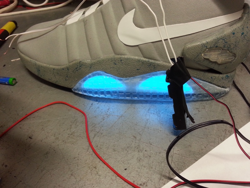

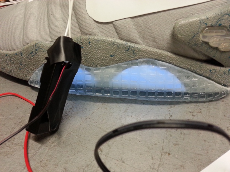

@cavx you seem to know about electronics I have a 12v inverter and I have a 6v wall pack, I have a el splitter so I don't have to solder but the more I hook up the dimmer they get am I not pushing enough volts threw ?? Do I need to go to a 9v wall pack or a 12 wall pack ?
Yep more voltage.
3V per shoe
attachment.php
9V per shoe
attachment.php

12 for each shoe.
It will be bright. EL needs higher current/voltage for larger areas, so a 3V system is perfect for lighting just the strap logo. Add the sole lights, and you need to step it up to 9V due to the increase of surface area or run the system dimmer.
I want to do a full TRON style suit and and thinking I am going to need between 18V to 24V to light this nice and bright. Lucky the TRON suit has a big thing on the back to house the power supply and larger inverter.
thanks ! I think I will run on 12v for each shoe. I'm running an all el system much like yours.
What batteries are you running here? I was looking at A23 because it is small and 12V, but these have just 55mha, so might not last very long. Mind you, I have not tested this and it would be awesome if these could replace the 9V I am using now.
