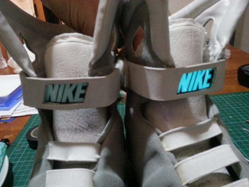

I am still working out the bugs on how I want to wire the shoes. I think a clip system needs to be in place so the strap can be removed completely if needed.
I have three different EL panels on hand -
2 x A5 in white (they actually look light blue when powered and pink when off.
1 x A6 is blue/green (more blue than green)
Tabs for the straps in CYAN (which is the correct colour) but not enough to do the entire shoe.
I want to experiment to experiment with adding filters to the panels to change the colour. So far, adding the white contact adhesive had worked to change the A5 sheets from pink when off to white and still allow them to glow quite bright. Not as bright as the raw EL, so maybe I need to ditch the filter from behind the fake LED panel.
I am hoping that by adding a thin green to the light blue of the A5 sheets, that I can make the colour more close to the correct colour. These sheets are quite affordable, about half the price of the A6 sheets for twice the surface area, but they are pink when off, so the white filter is needed from the get go.
I have found myself a local affordable source of 12V inverters. These will run with voltages from 12V down to 3V, so versatile.
Just for giggles, I will break out the colorimeter and measure the amounts of RGB each produce as well as an FL for the brightness of each.
