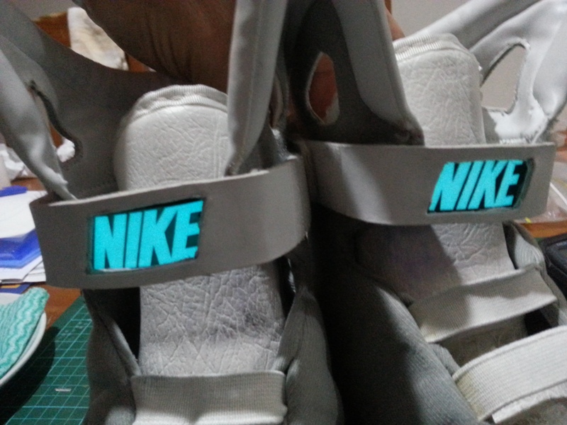

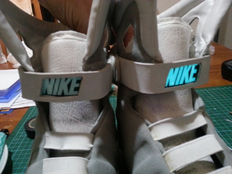

Can someone please tell me what is going on here?
So yesterday I gave these a good wear test and all was good until I got home and noticed the right logo was dimmer than the left. When I pressed on it, it became brighter. I checked all the wiring and connections and found that the solder joint on one of the tabs was broken, so not making full contact. Why it worked at all is beyond me, anyway...
So I repair that and then I got this
http://www.therpf.com/attachment.php?attachmentid=548756&d=1446366992
Really dim.
Again pulled it part, no sign of any breaks. Swapped the batteries just in case power was an issue. Nothing, still the same.
Pulled out the multi-meter. Even though there is only 3V going into the inverters, the output measured 12.8VAC (is that right?) but only 0.23amps.
So I pulled the batteries out and gave it a "jump start" with a near new 9V battery and suddenly the light is super bright.
Put in the original batteries back in and this happens.
http://www.therpf.com/attachment.php?attachmentid=548757&d=1446366992
NB: The logo looks wonky because I have not glued it back in place yet.
WHY DOES IT DO THIS???

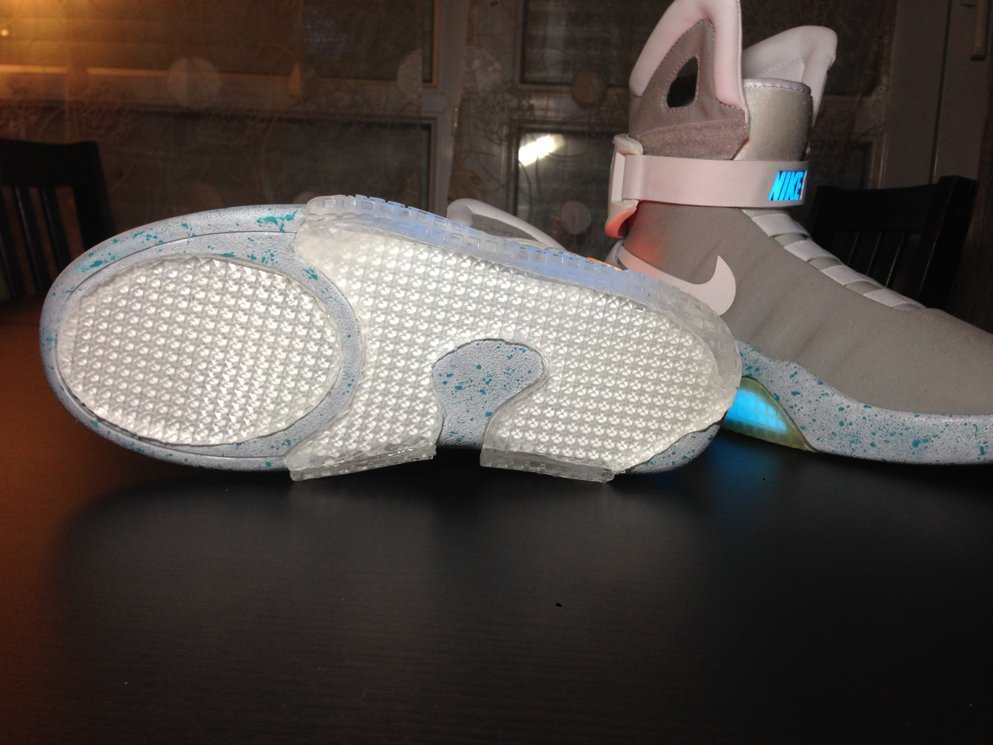

Hi guys,
I just wanted to share my progress on my ultimate V2 mod : cavx clear soles.
Left shoe done :
The EL sole look like more bluish on pics but it's the exact same color than strap logo.
Vormz did you paint under the soles or is that just how it came out from the gluing process? It looks great.
Thanks!
I put some Angelus white paint under before gluing, I wanted to have the screen used look :)
And you have done that :) Do you use the velcro on the collar to hold the strap when you wear these? If not, maybe you should unpick it? I like the way strap sits down. It does give it a screen used look even with the standard tongue.
