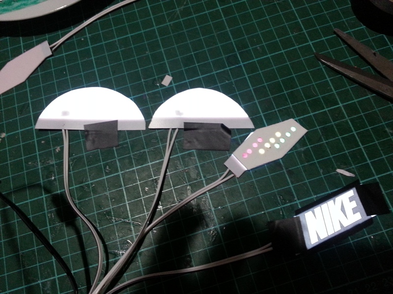

Just made up my new EL test kit for an all EL system.
attachment.php
This EL is white, so can't be used in the final system. What I want to test is exactly how long a system like this can run.

How bright are the "leds" in real life ???
Sent from my SM-N920T using Tapatalk
I've never measured the light brightness even though I do have a meter and the software here to do so. The thing you don't want is to have the LEDs outshining the EL or so dim you can hardly see them in any light. You want them the same brightness as the EL. You also want both colour and brightness uniformtity across the 3 colours.
Here they are the same brightness as the EL (because they are EL) and the two real pluses are -
1. no single light can fail in the array
2. massively extended battery life.
The only mistake I made with this set up today is how I attached one of the stick on terminals. When I did my first test this morning, I placed tape under one of the adhesive strips, then figured it would be OK to not have to run a long strip for the 2nd connector. Big mistake because now you can see the patch where the soldering heated the EL sheet.
I actually like the stick on tape. It is quick and easy to use and easy to solder to. My idea with the white contact was good too. Be really good if I could find a green/blue one.

One guy lets his shoes run completely flat from a full charge (I'm sure he had rechargeable, but not sure what voltage) and the EL kept running for a long time after the LEDs died out. This got me thinking an all EL set up would be the ideal set up. I only had time today to glue the filters in place and run some tests. Overall I am impressed with the results and sure the template needs some work to neaten it up, but the concept is solid.
I accidentally left a shoe on (EL strap only from a 3V volt set up) and it ran over 24 hours. Sure it was dimmer than the other shoe by the time I discovered it, but bright enough that the camera in my phone could still pick it up quite well.
Loving this idea! - Are you just using coloured filters for the 'led section'? does it work well?
Yes it does work well as the "LEDs" are the same brightness as the EL panels, just coloured. I've used 1.6mm polyprop for the cluster board and the filters are bits of plastic from coloured plastic A4 expandable folders that I found at the local Office Works for about 1 each. They just happened to have green, yellow and red folders.
