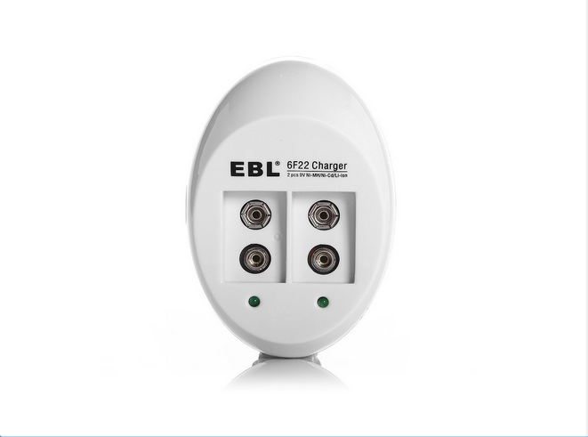

glasses Cheers for the battery info, is the charger you got like this one? charge.png

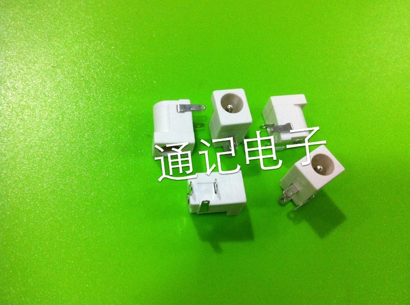

I've found some white DC jacks online, do folks think they look right?

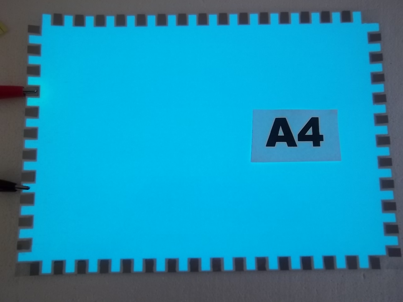

And one other thing. I'm trying to figure out how many shoes can be done with one A4 piece of EL. What would be the most optimal way to position the pieces?

@glasses Cheers for the battery info, is the charger you got like this one? View attachment 466687
An A6 sheet i have can do 1 pair of shoes. It has 4 connection pins in total and no other tabs.
If you are using A4, then you may want a sheet where there are usable tabs all around the sheet like in your picture.
Those type of sheets come with some connection pins, but you can also use the other tabs with wire glue.
