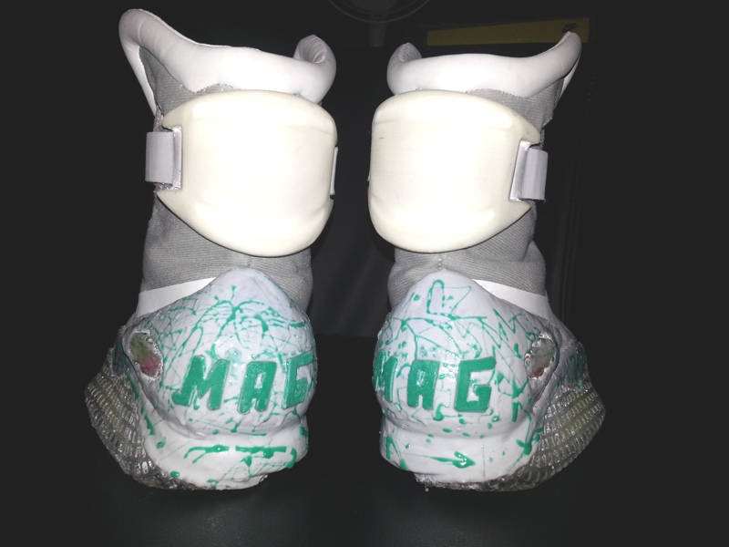

Seems a tad bit high in comparison with these pictures you and jedifyfe posted.
The bottoms of the letters should just start curling under the cup.
I agree, thanks for that.

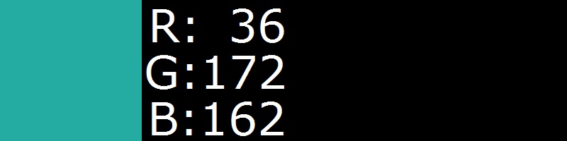

Based on a daylight photo, this is the actual colour of the splatter that tends to look green under lights.

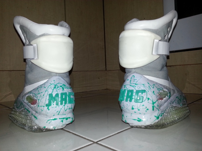

This morning I mixed, vacuumed and poured some more aqua rubber and made up a new set of MAG letters.
Tonight I then removed the set from last night...
attachment.php
attachment.php
...and fitted the new set slightly lower and slightly wider spaced.

@cavx
That new letter spacing looks much better.
Thanks MrSouthpaw for the positive feedback. At first I wasn't sure. It does seem to fill out the surface a bit more.
I just spent the last hour playing with a tiny bit of grey and pushing it into the gaps with the blade of a scalpel so when this cures it will look like the letters have been made as part of the original cast and not just glued on. Of course, being made from aqua rubber means the colour won't ever scrape off.
attachment.php
I had to wait for it to go into gel state so it didn't just run and make a pool. I took the time to make a spill guard just in case. It is setting up now and should be solid by the morning. I don't feel like mixing a match white tonight. That can wait for another day.

And I checked on them this morning and they are done.
attachment.php
Now to mix some white for the NIKE.
