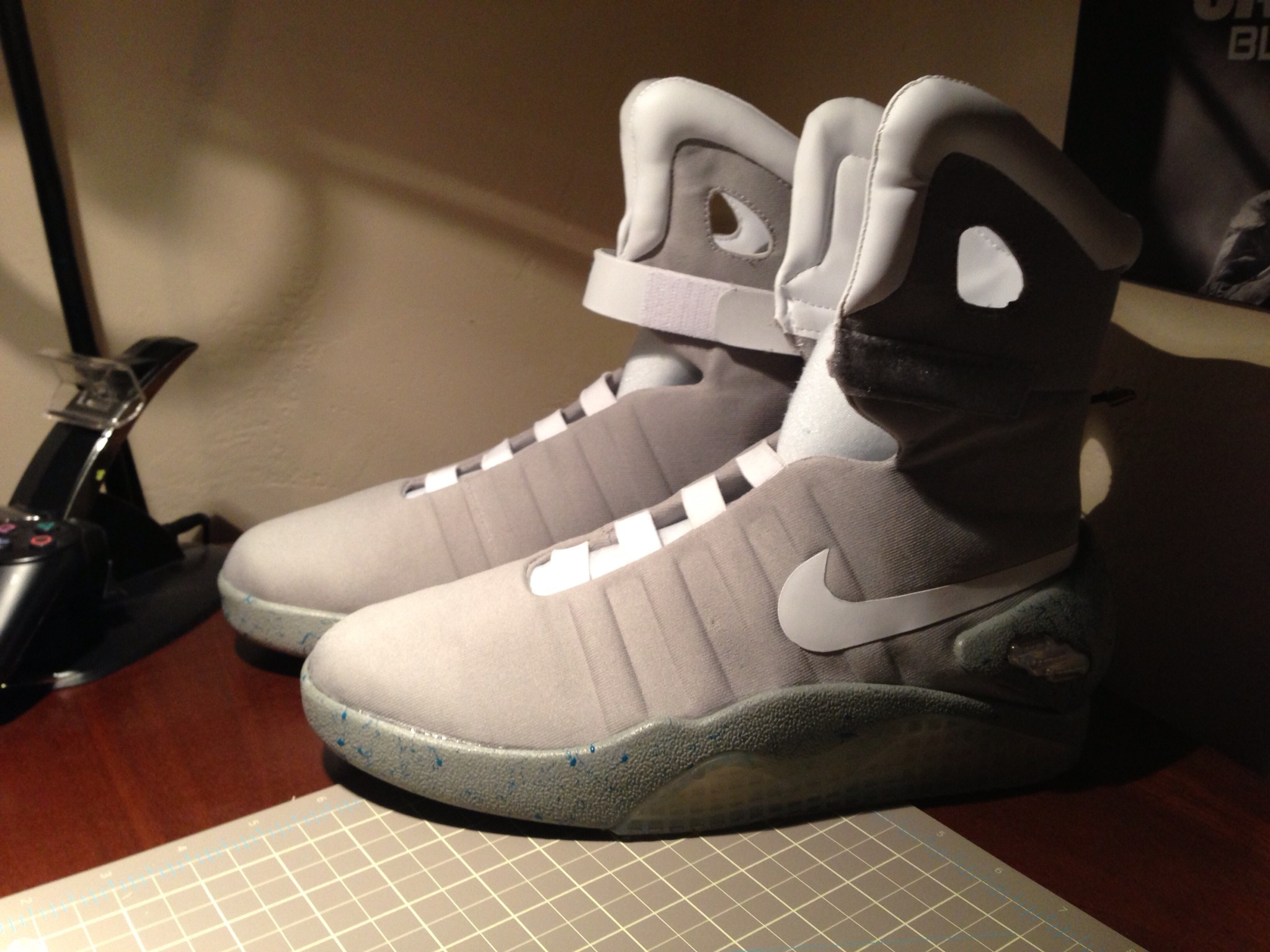

I was messing around with a new template today for my "screwed up" v2s, and I think i've almost got it spot on to the RD/Movie mags.
I can even reuse the existing v2 heel cup as its actually bigger than i thought. The heel cup is actually longer from the bottom and that bit is glued just behind the back of the sole.
So now after removing it, I can reglue it more in the RD style. I just need to skin the uppers with grey fabric and then should have something really cool soon!

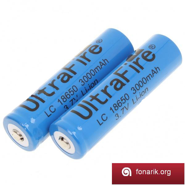

hey airair, sorry for my bad english)) I want to offer you to make your MAG more energy efficient. Have you tried to connect two batteries in parallel to 3.7B by 3000 mAh? I think the inverter must cope with this) Ultrafire_18650_3000_2_big.jpg
hey airair, sorry for my bad english)) I want to offer you to make your MAG more energy efficient. Have you tried to connect two batteries in parallel t o 3.7B by 3000 mAh? I think the inverter must cope with this)View attachment 194096
Hi
Unfortunately AAA size is the biggest that can fit in the soles. Those ones you posted up are too big.
In the ankle buckle like cloneprops it may be possible. But probably flat batteries are the ones to aim for as the won't stick out like normal batteries.

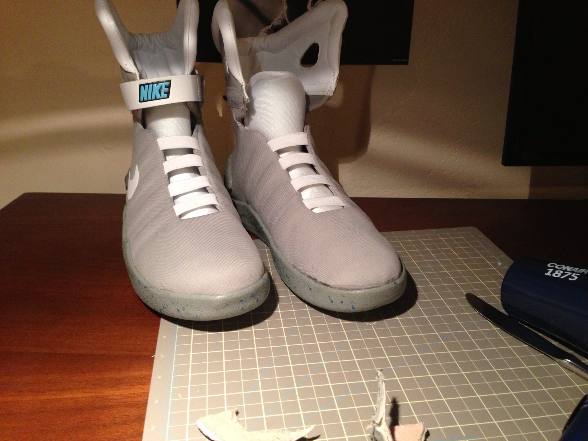

I really kind of screwed up my first toe mod on my left Mag. Everything was fine until my old friend mr. superglue (aka mr. drys too damn fast) entered the picture! Take a look...
Now, in the picture the glues not even dried yet, but I guess for my first mod of any kind it's not too bad...I may end up needing to use my first pair as display pieces, hopefully the right shoes toe mod goes better. Honestly though I suck as super gluing stuff!
Also the first picture makes my mistakes look a lot worse than it does from looking at the shoe from the side...
Ouch!
I hope people now look at those pics and realise this is not an easy shoe to mod. It takes time patience and very careful hands.
I screwed up one pair so you're not alone!
Ouch!
I hate to make light of your situation, but you can finish the mod and have a throw-away pair. You can wear em anywhere and not worry about em getting messed up. Take em to the gym, to play sports, out and about....whatever.
Also, don't forget, guys, there are other glues out there...ones with longer drying times.
Brad has done a great service by putting his method out there (He's one of the few guys out there who when he says, "Don't like my price, try it yourself" has also given those people all the instruction they might need at actually try it themselves) but that doesn't mean everyone has to stick to it. Experiment and see what works for you. There is always more than one way to skin a Mag.
If you want more drying time, you might want to consider Shoe Goo or E-6000. (The latter having TERRIBLE fumes but basically able to glue anything to anything else) You just have to find someway to hold the pieces in place for a few hours while they set up. But if you're more the type that likes to be more slow and methodical and a 30 second (or less) drying time is just too fast for your personal taste, see what might work better for you.
After that you can still use the other superglue to finish the edge where the upper meets the sole.
Happy Magging.
