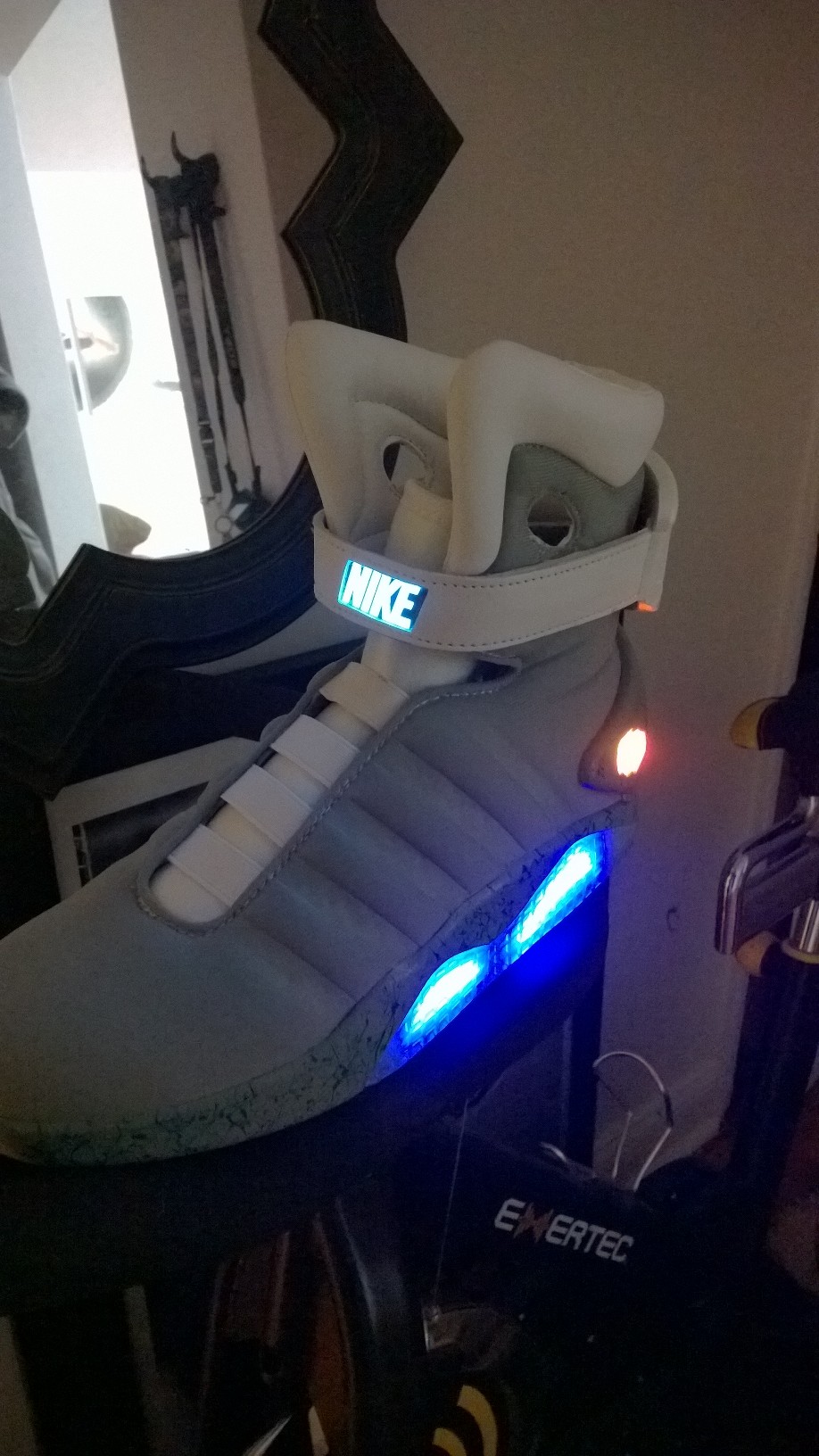

looks great! is that a HC MAG?
Yes they are the HC Mags.

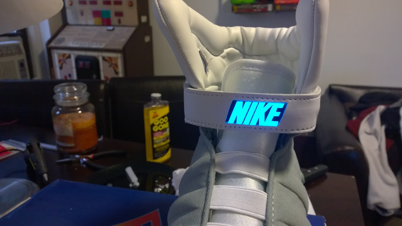

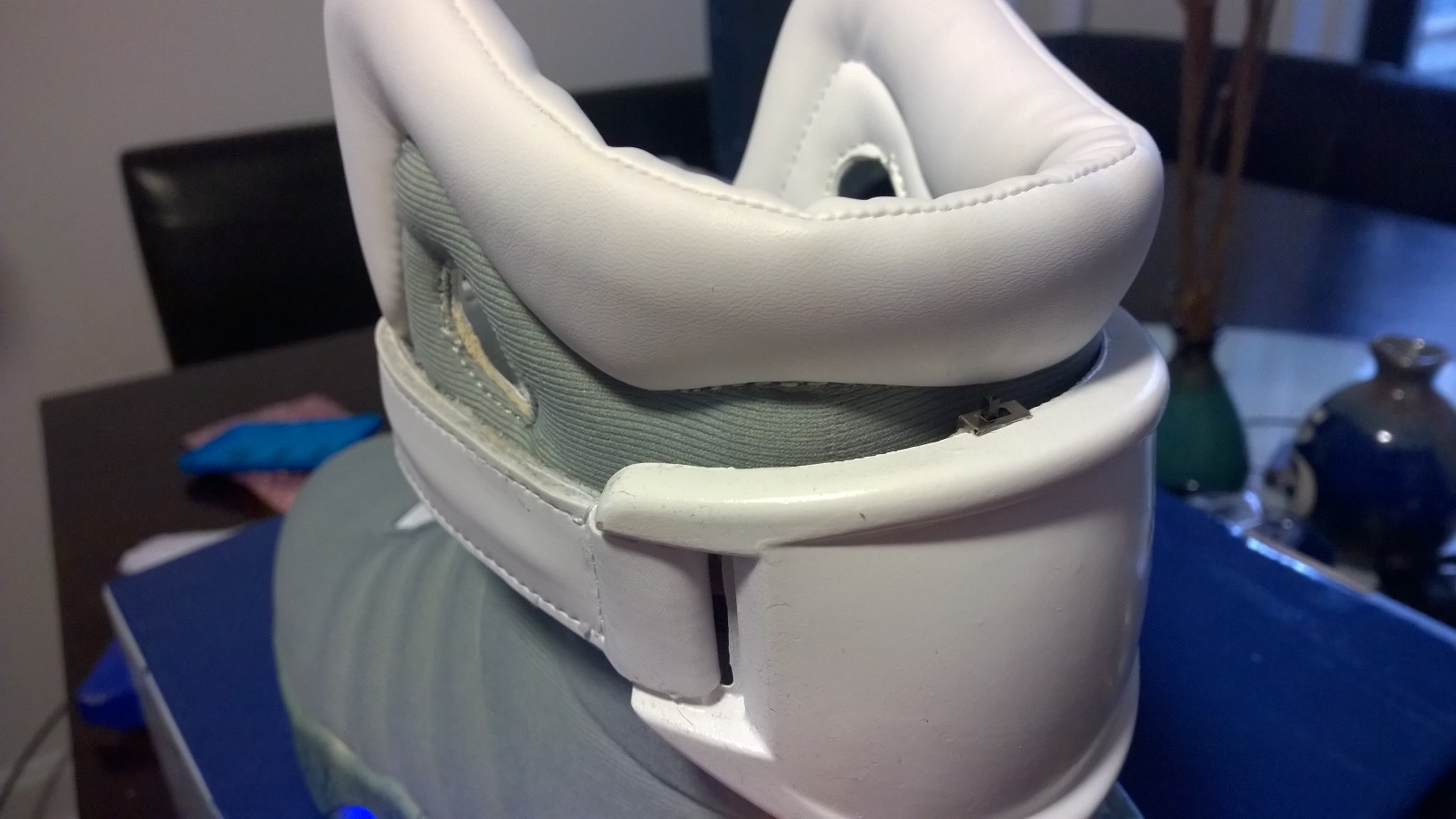

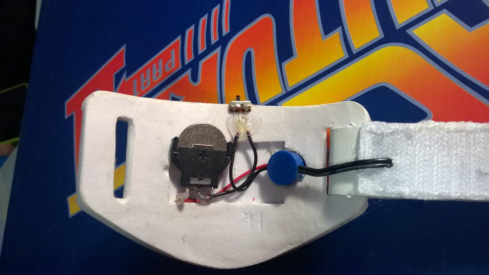

I soldered all the wiring as @markpoon suggested. i separated the strap stitching from the top and bottom and slid the EL in to the area where i cut out the "Rhombus" shape for the Nike logo. DO NOT DO the soldering of the inverter wire to the EL until you cut a hole in the strap to slide the wiring in (as show in the picture above). This makes it easier for you to hide the wiring inside the strap and slide it out of the hole in the back. Since the stitching is impossible to put back, i was able to use ELMERS SPRAY ON GLUE to reglue both pieces of the strap back together. Regarding the back strap shell, I secured the soldered wires with a glue gun as well as gluing them to the back of the strap shell. I also cut a small hole for the inverter to sit as well as the switch at the top.

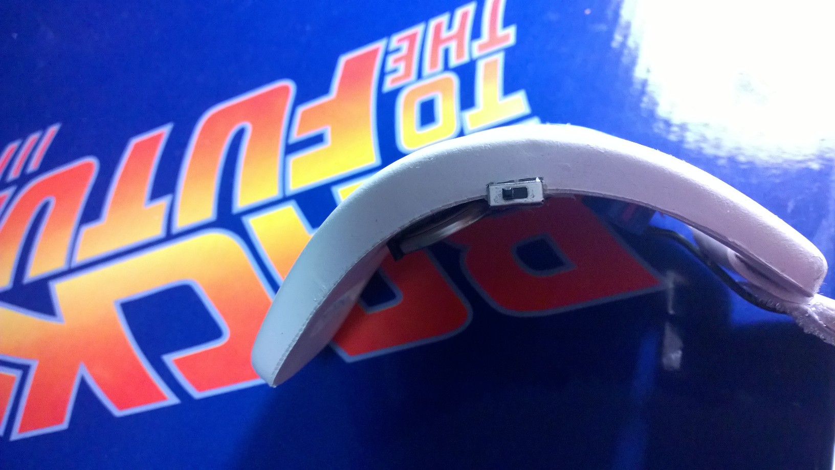

Here you can see how i cut a small box for the the switch as well as using a glue gun the secure it down. Easy access for turning it on. Even with all the components, it doesn't seem to take up much room in the back of the shoe.
It doesn't look too bad from the back and is hardly noticeable.
Overall, i am satisfied with the results.
