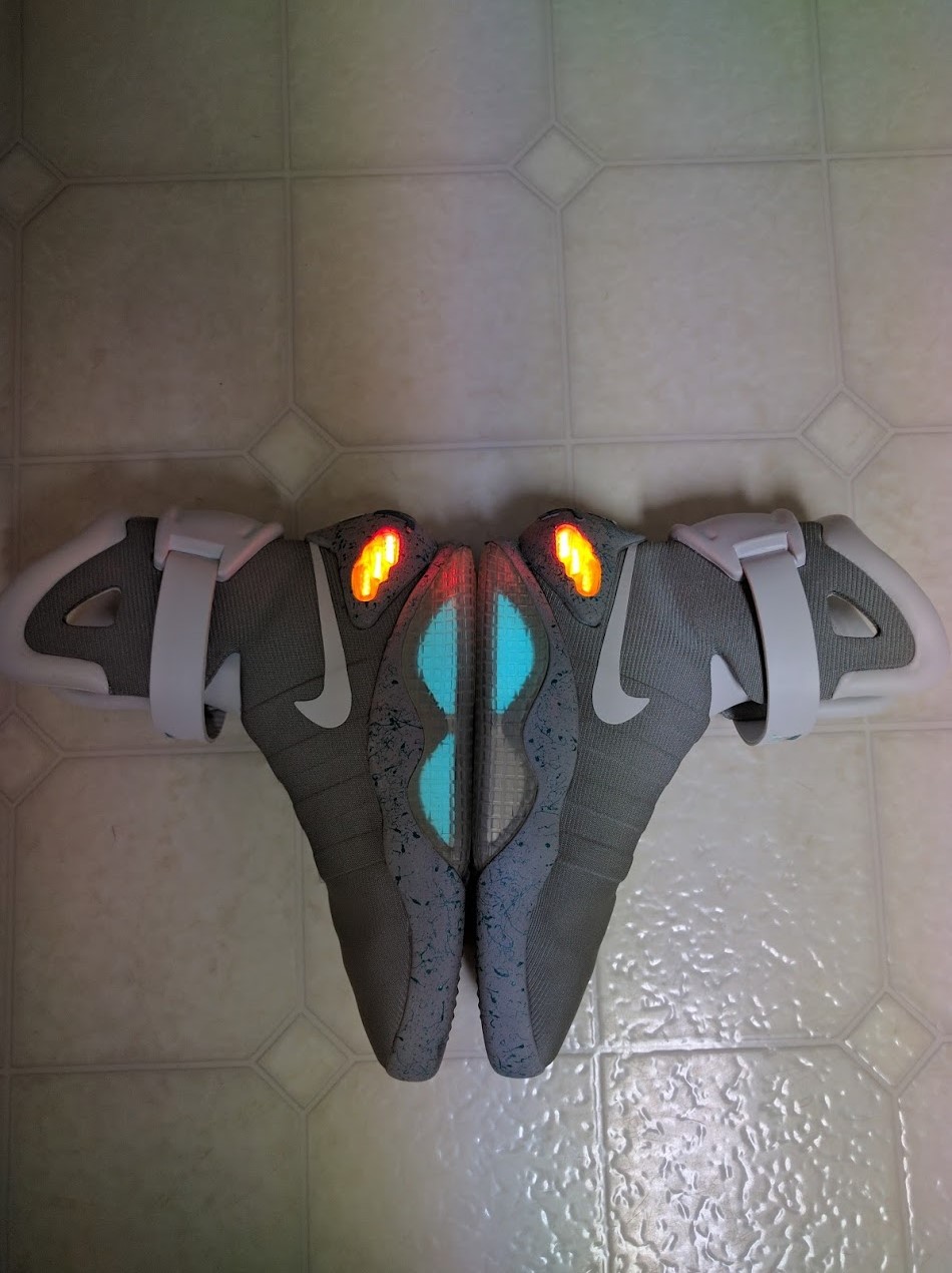

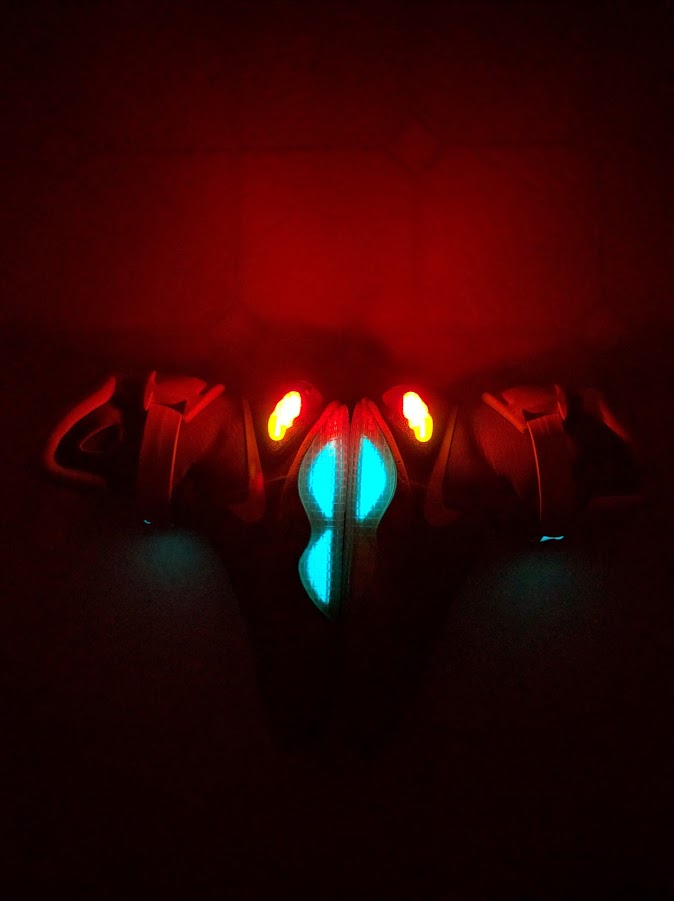

Well my EL finally failed last night while in the mall. Kinda upset but I knew it was going to happen eventually. That's why i bought a display pair and a wear pair. Now just have to cut these soles off and put some @WizardBTTF blue soles on there and get some brain storming going on on how to make these sole EL panels less susceptible to going out. Any ideas? These were worn for about 10-12 hours. It's kind of bitter sweet because now it means I can mod them, but it also means that now I HAVE to mod them.
View attachment 679940View attachment 679941
