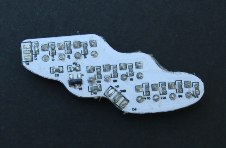

Wrong and wrong and wrong. Diffusion of bubble has no affect on LEDs. The led boards that come in shoes cannot be adjusted. Your only option would be to use a resister in main line going into board which still keeps the red LEDs too bright. The replacements I'm sure are same. Your only way to make better at this point is to send to me and pay me to replace LEDs with my own.
There are surface mount resistors on the back of the board already. You can simply use a different value resistor to lower the voltage, effectively dimming the LEDS.

Red is so bright because they only used 100ohm resistors for red. You can still change the resistors to lower the brightness, just because you did it a different way...doesn't mean I am wrong.

The LEDS in there seem to be your typical 3mm 45 degree LEDS. They have resistors, but they are still ran too bright. I think the main issue is still getting the bubble diffused correctly around the LEDS...if you look at the RD the bubble itself it is still diffused...but it doesn't blur the LEDS together like these V3's. Ran at a slightly lower voltage with the bubble slightly diffused...would probably give the exact look of the RD. With the current diffused V3 bubble the bright LEDS just wash each other out.
How are the leds on the v3 board soldered? Are they in series or parallel?
You are absolutely right. Just need to try different resistors to reduce the led brightness I they are too bright.

Like I said you can remove the resin then you can do many things. But I have many secrets for doing things well past changing the LEDs from 100 to the magic number. I can just with LEDs manipulate power. Manipulate el panels. Make them smart and react to sensors or add my light coding I write. It's way past playing with resisters man. I'm trying to elevate you all. Cause after all that work you do then you will realize that rd mag LEDs have their leads showing that resemble nothing like v3. Which makes my light boards look even better.
