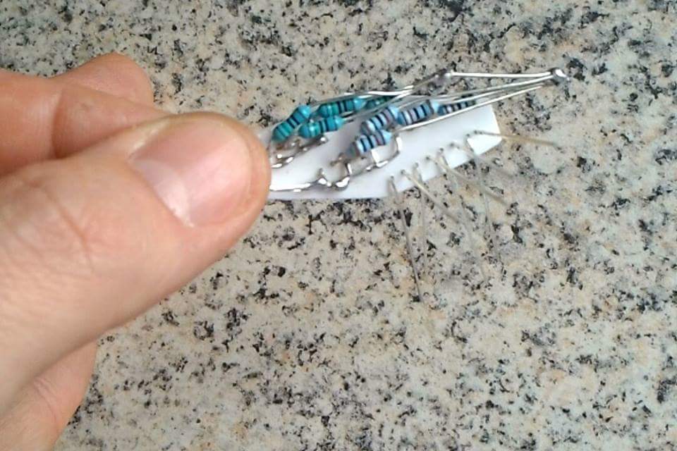

Im quite sure that it is my LED board/ resistors that it's ruining my convertion. Had to solder 1 resistor to each LED!! To get it to work...so total 12 LEDs ...looks like crap, and is to big fit in the heel cup nicely...
The calculator is showing me 3 resistors.. 1 for eaxh color.. In series
22.4mw for 56ohm (Red)...13.3mw for 33ohm(yellow)..60mw for 140ohm(true green)... Thats what the calculator says lol..
Did i do it right?? Lol
