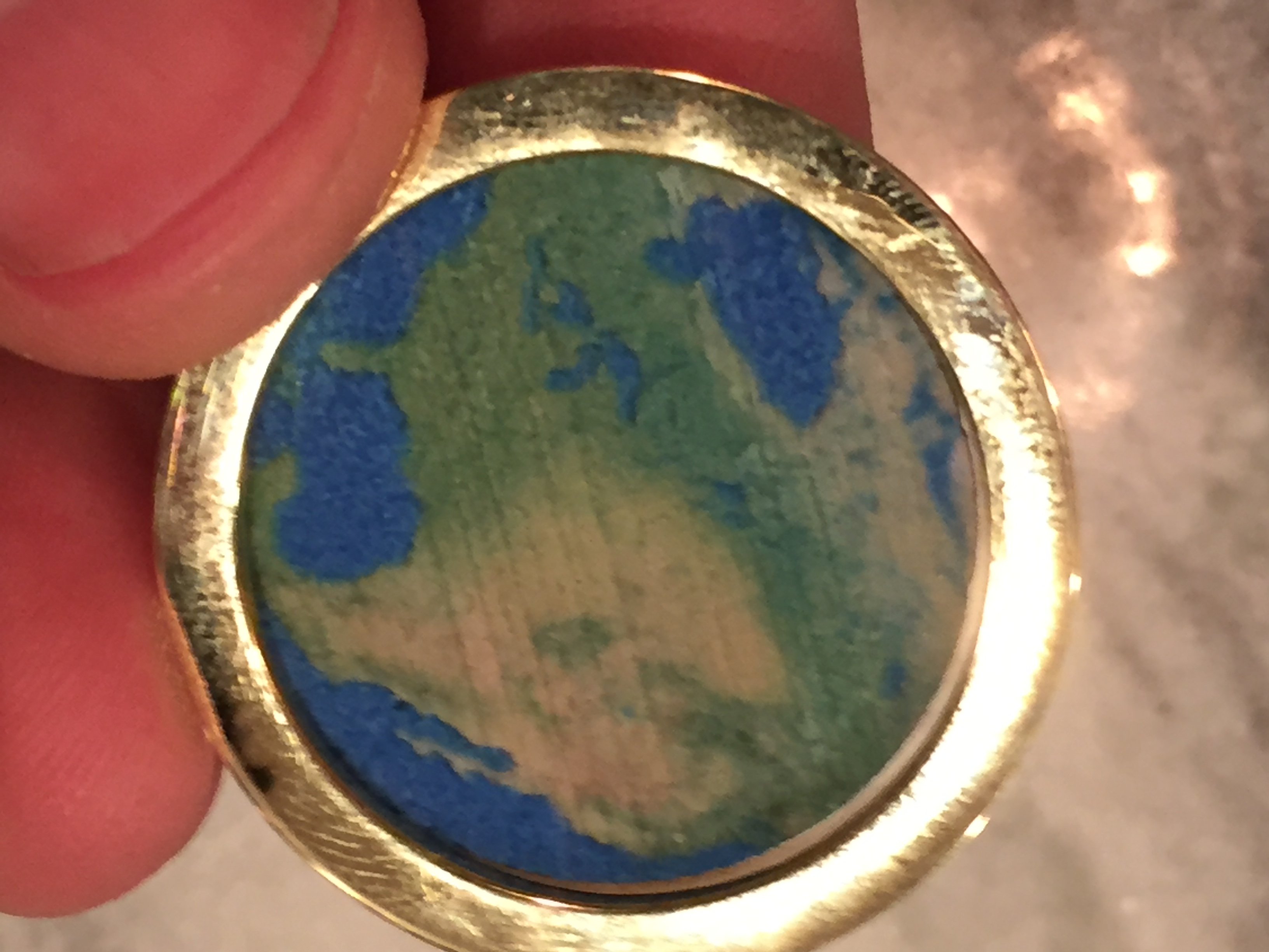

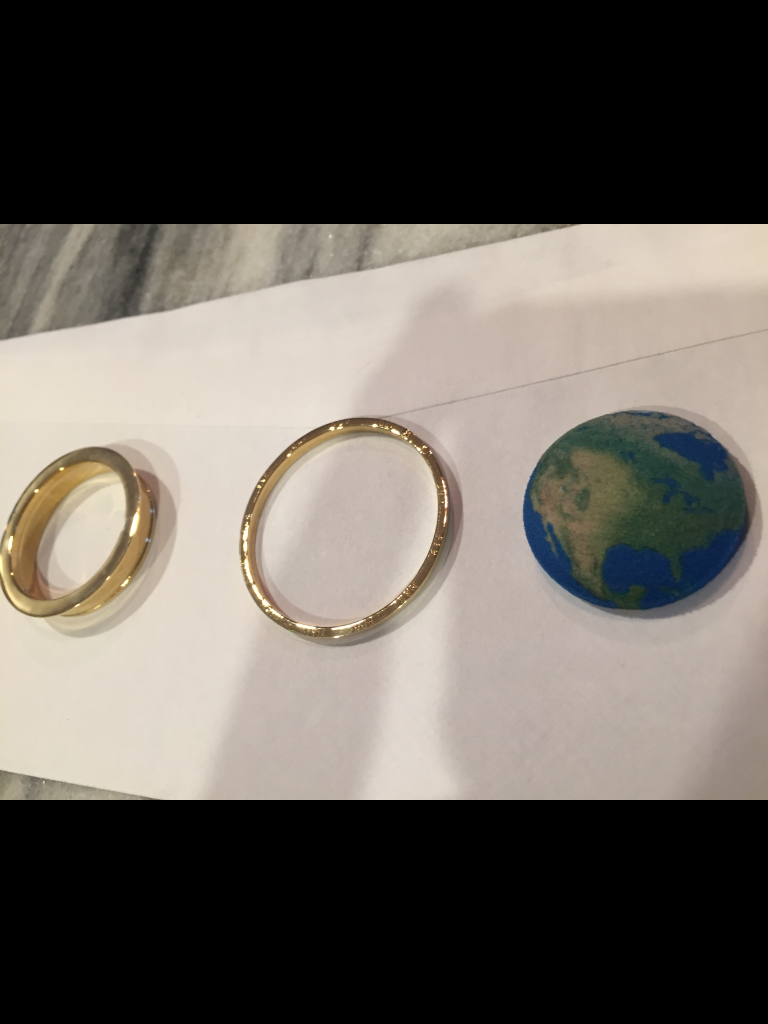

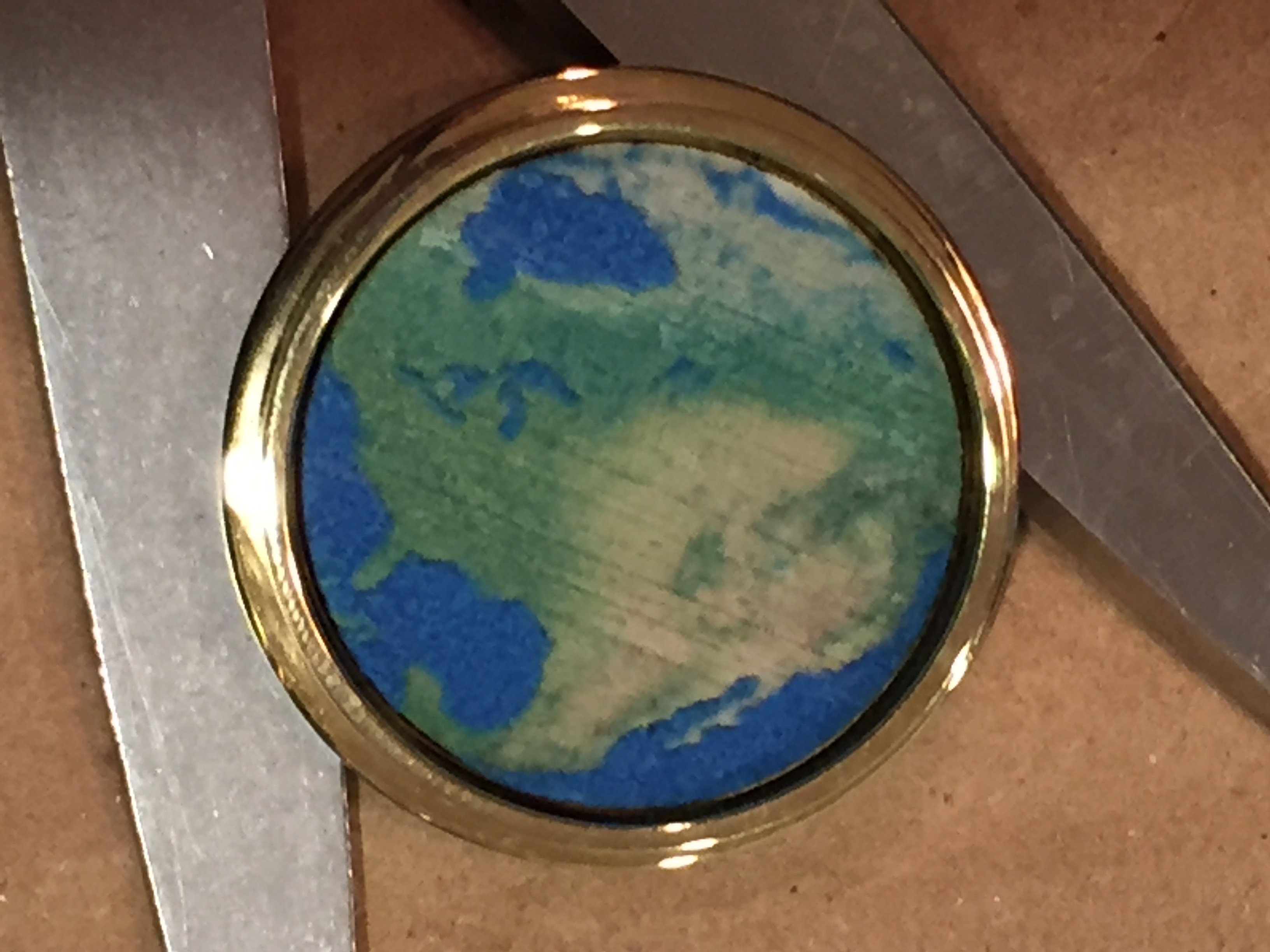

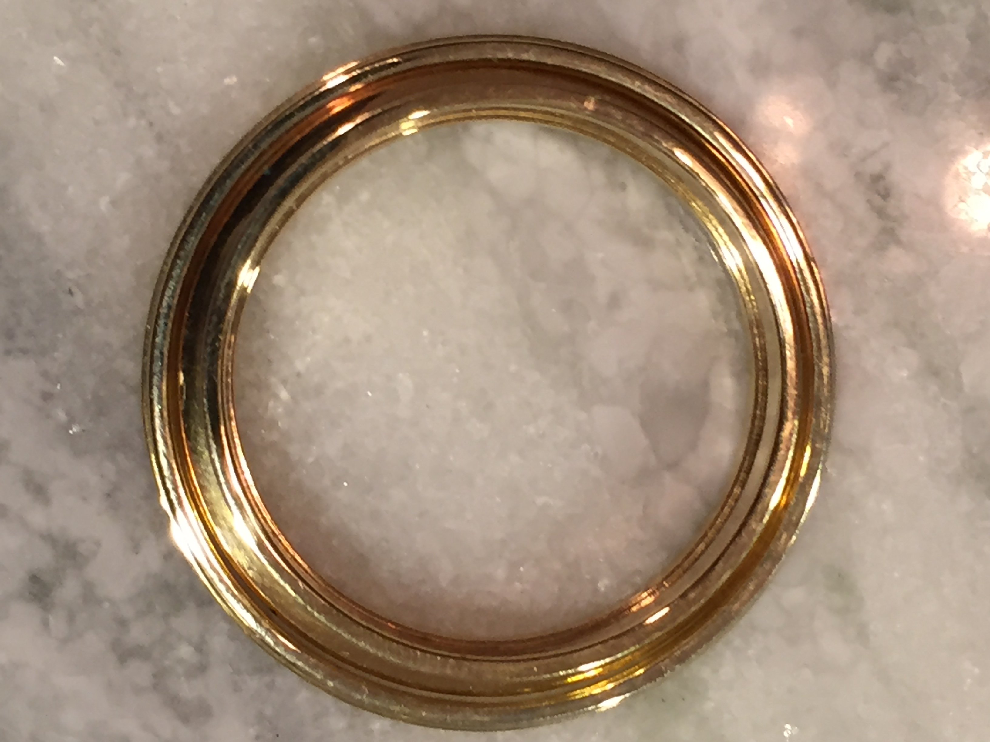

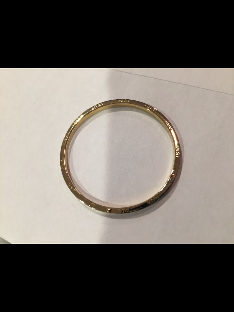

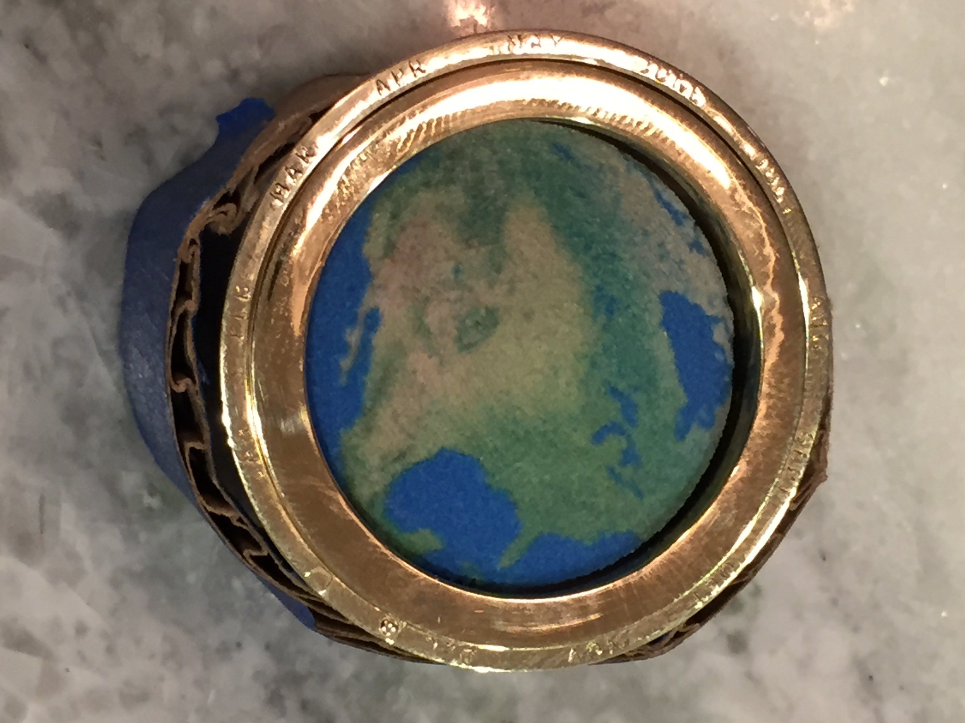

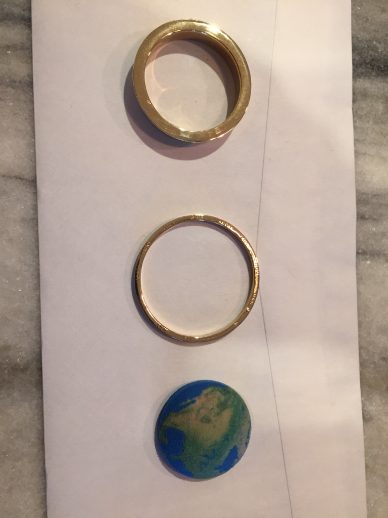

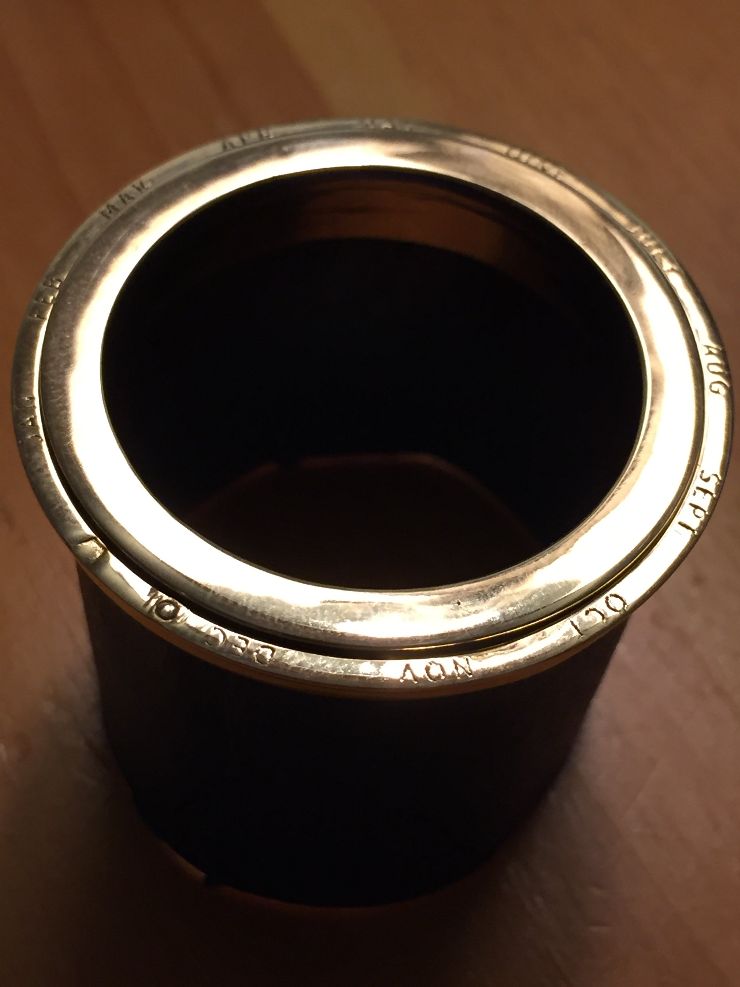

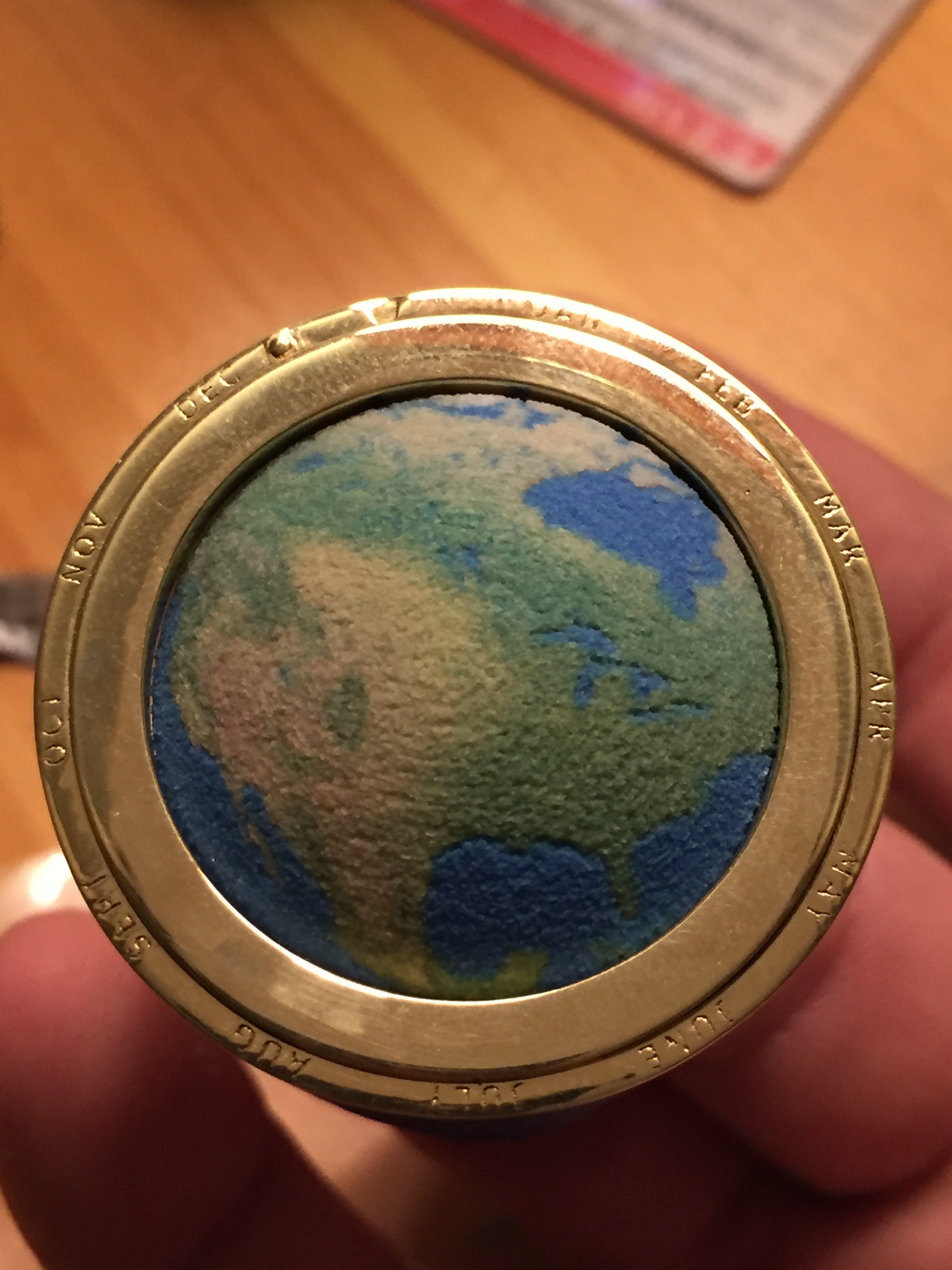

The test prints of the fine details on the dials failed to print on 3 out of 4 of the dials. Only the month dial printed.
Even the test print on the month dial was not up to par. So that is another thing that needs rework.
\ IMG_0549.JPGIMG_0548.JPGIMG_0547.JPGIMG_0546.JPGIMG_0545.JPGIMG_0544.JPGIMG_0543.PNGIMG_0542.PNGIMG_0541.PNG
What is the size of the largest dial that won't print ? Worst case scenario and somebody REALLY wants one, you might be able to print in high def steel from iMaterialise and get it gold plated after printing.
For Shapeways, brass embossed detail has to be .35 mm wide and deep.
For iMaterialise, high detail steel can have detail at .1 mm wide and deep.
Big difference, but high detail steel only prints at 40mm max size width and height.
I know what needs to happen. I have to photo engrave a plate of brass with all the engravings, machine out the dials and hand polish them. The engravings are just too tiny to 3d print in any material. It's not high enough resolution.
What about the silk screening of the numbers and months on the dials is that easier?
Ease is not the issue. Durability is. Printing the numbers is not a good option since the dials are constantly touched with your fingers. The printing will scratch right off. Engraving is the only solution.
