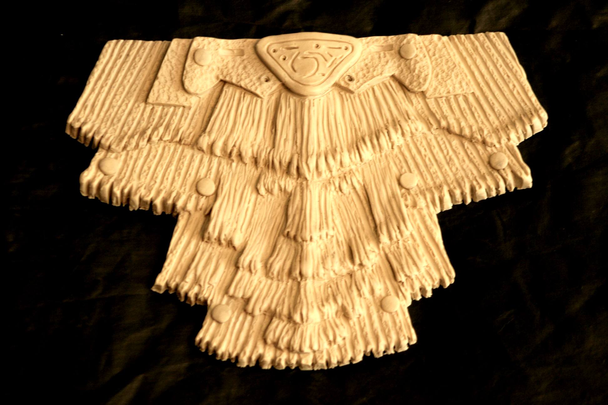

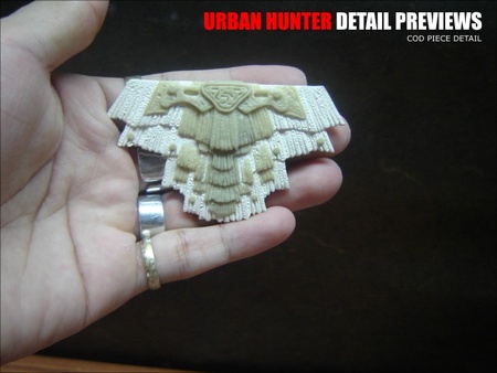

Neo asked me to sculpt up a P2 cod piece based on a particular reference photo (included for comparison). This is the first P2 piece I've sculpted and here's what I came up with... will be molding this evening. Let me know what you think.

That came out sweet MOW

LOL... Andrew, I should have been more clear... it's 1:1... for a suit build... LOL No, I don't want to think about doing it at that scale. At least I hope Chris wanted it at 1:1... lol If not, I guess I'll just have to recast it a whole bunch of times until if fits in the palm of my hand!

Actually, Andrew, I'll be making both resin and latex. A more limited run on resin. I'm going to mold it in silicone first, then do a stone mold. Been toying with this for a while, but am planning on doing silicone molds of all my stuff before stone molding. That way, when the mold's exhausted, I can pour in wax clay and have an exact original to mold in stone again. Talked with Arnie (from Monstermakers) at Monsterpalooza for a while and he convinced me to buy some of their new wax based clay. It melts like chocolate and will be great for reproductions. Been just messing around with it (so to speak) at this point.
