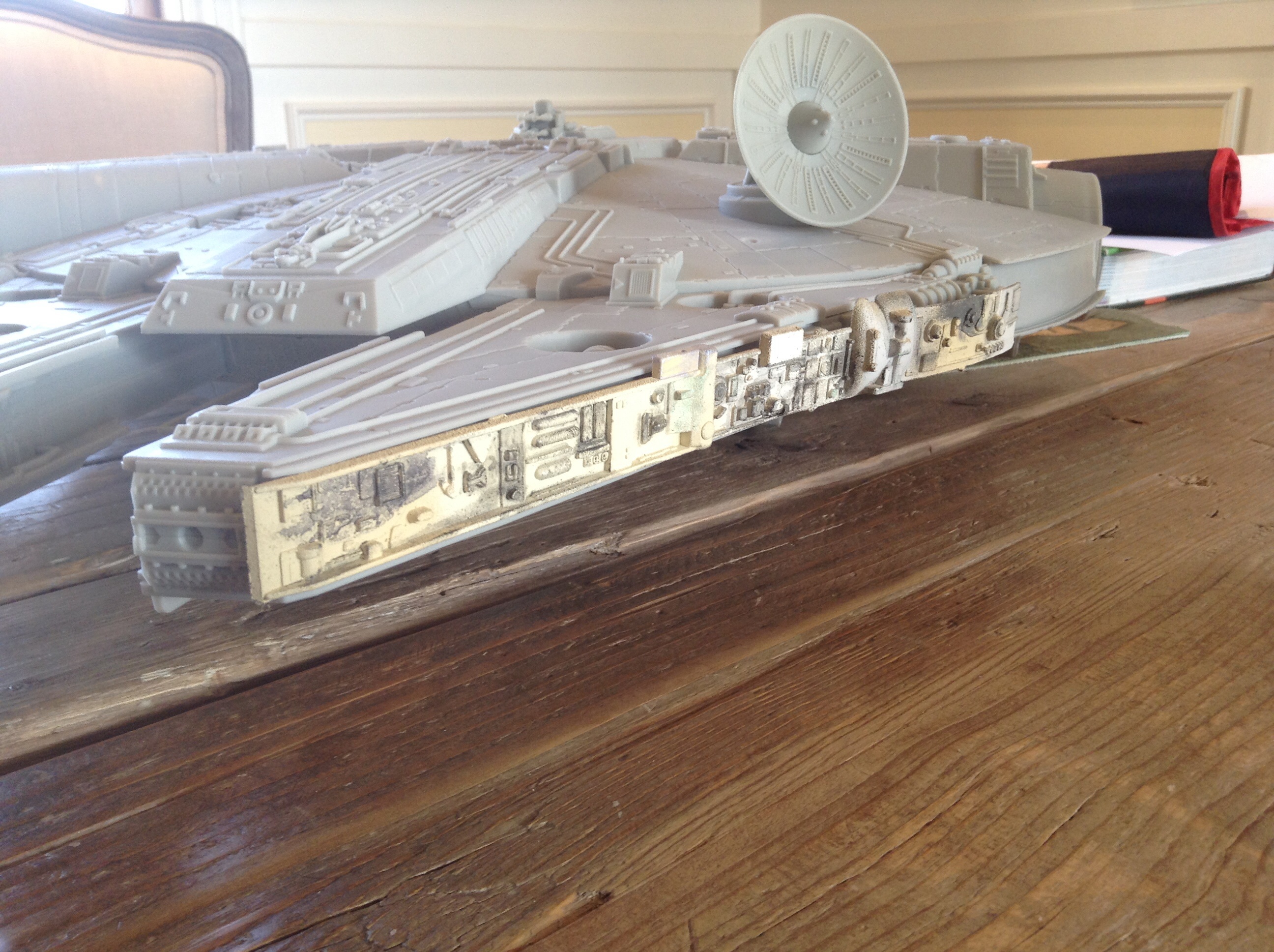

I actually managed to get one yesterday at £29.99 :D I have to say it is very good. After selling my MR Falcon a few years ago , i had kind of resigned myself to the fact that i would never own another big Falcon , so this is very good news. I have built 2 new sidewalls for the front so far. They are both totally innacurate and very much in the spirit of ILM, I just stuck parts from various models onto plasticard and i will secure them with double sided tape. Lets just say that mine was Modified by Han Solo some time after the Battle of Endor! Most modelling fun i have had in a long time!

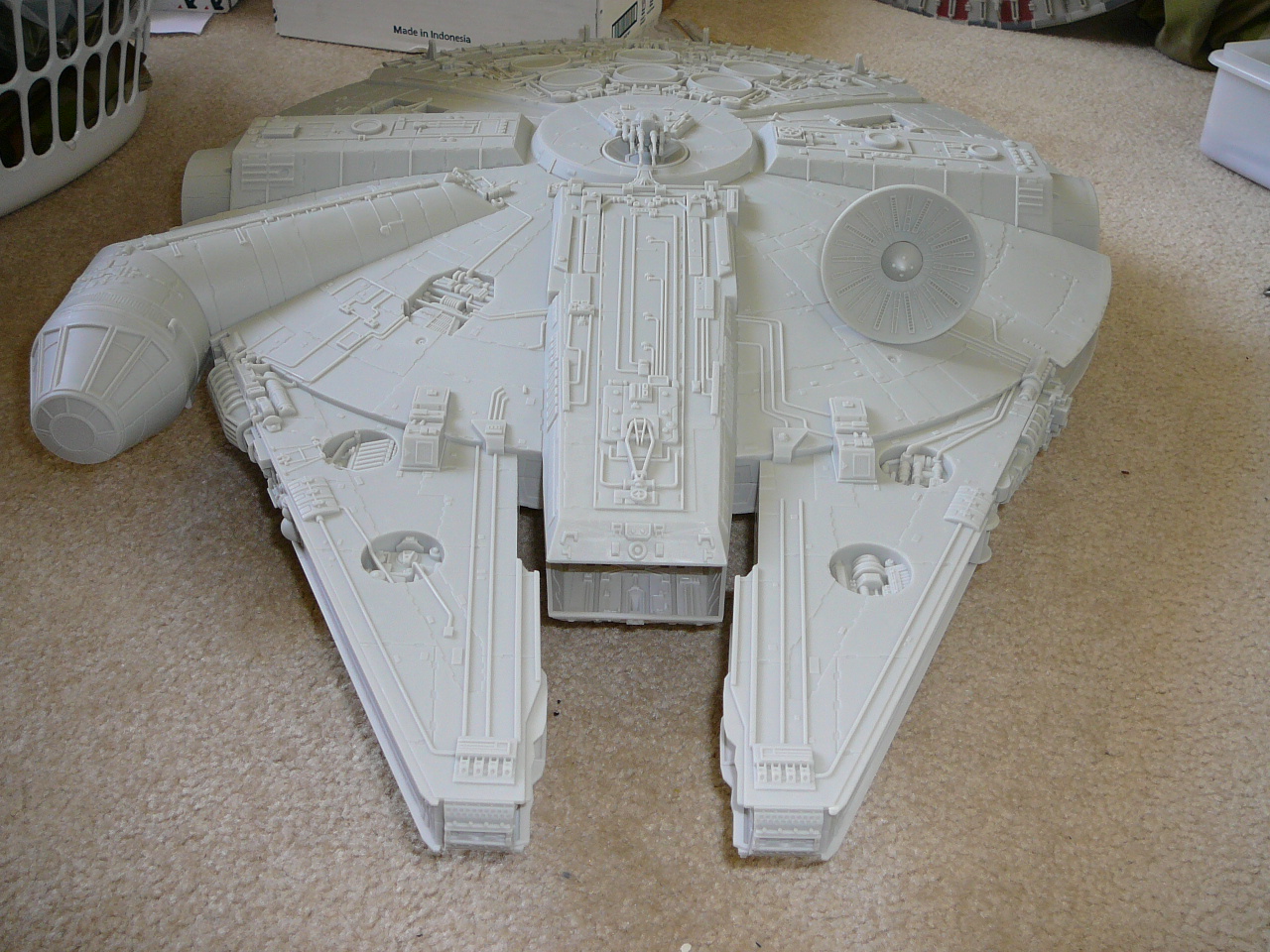

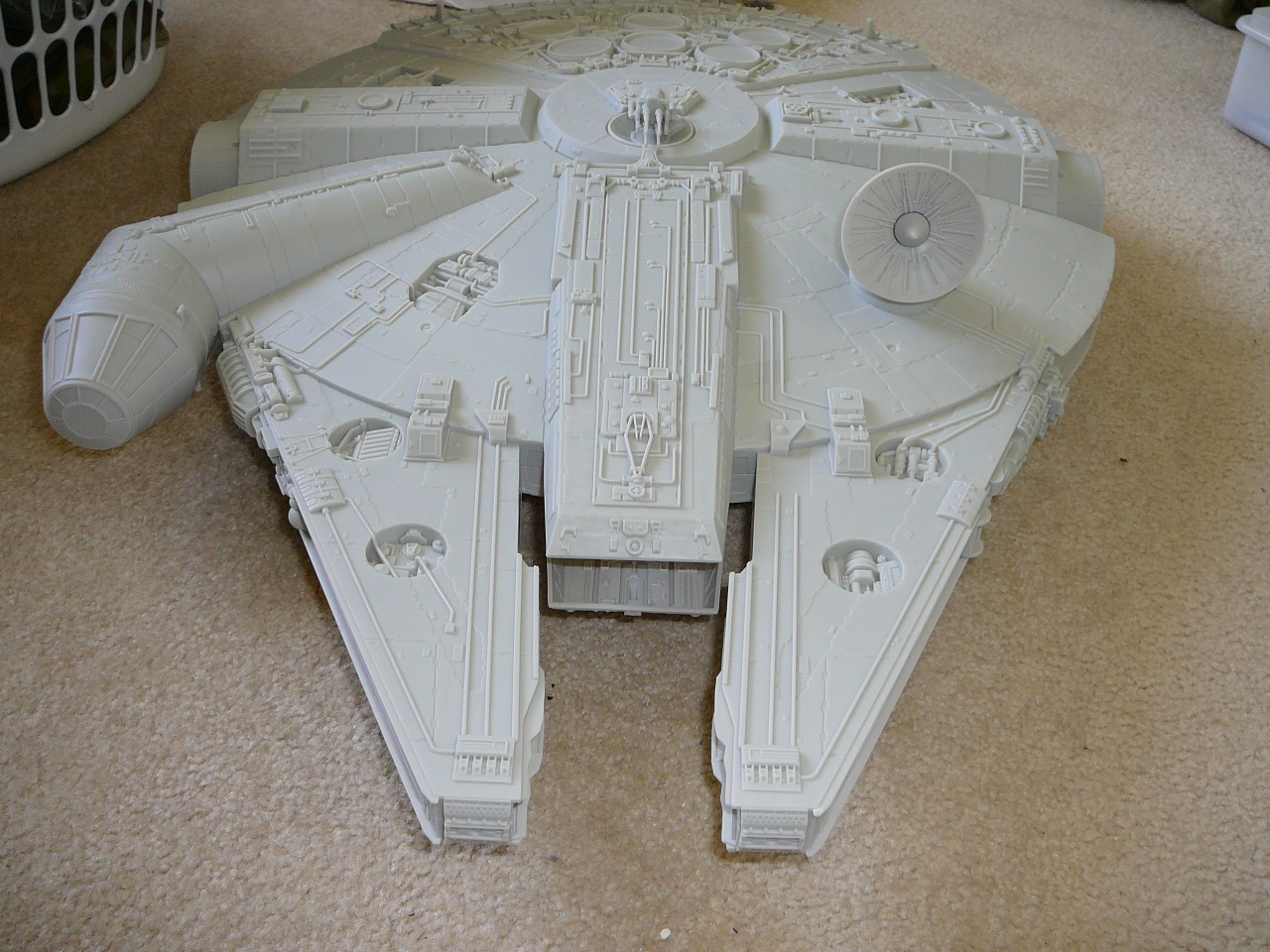

I finally opened my MF this morning and quickly found the difference in the plastic used between this and the BMF. That said I took some photos of the radar dish that came with it then some more with my spare BMF radar and the difference in sizes makes all the difference.
I'll now be using my BMF radar as a replacement.

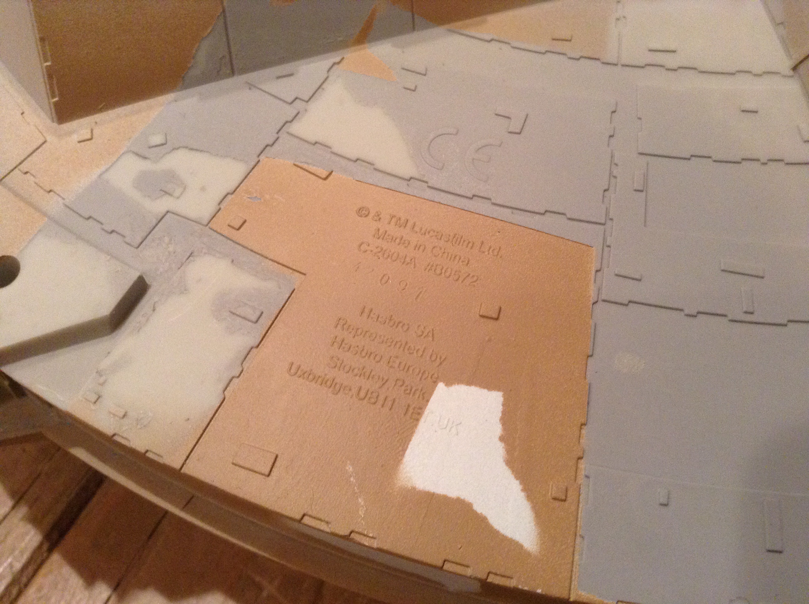

I did a paint test yesterday on mine. Cleaned it like I would a resin kit, with a mild abrasive, then some alcohol, then used standard Tamyia rattle can gray primer, then Krylon flat white and then Tamiyia beige. They all worked perfectly. The white spot is where I tried a tape test to see if the paint would stick. As you can see it did.
