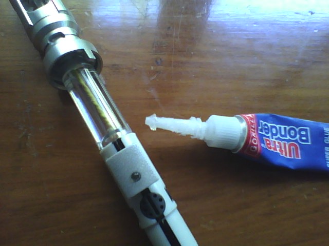

I have a fix for anyone wanting to stop the clear rod from wobbling form side-to-side when it is extended (I think darthriley and a few other people were asking about it)
Prise off the collar with an exacto knife. this will allow you to pull the whole slider assembly out of the handle. where the clear rod joins with the white plastic is where it wobbles. holding the clear rod straight, run a small amount of superglue all along the seam between the rod and the white. the clear tube is now held straight in the slider assembly, and when you push it back into the handle and pop the collar back, it no longer wobbles.

I'm afraid the quality isn't very good

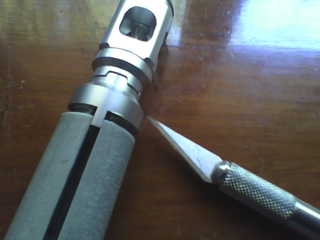

Prise the collar off with a thin, strong-bladed knife (CAREFULLY or you will make lots of unsightly scratches and dings)
Pull the assembly out of the handle.

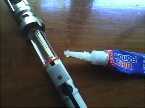

The seam between the clear rod and the white plastic is loose, as it is held in due to a ridge that the white plastic clamps over, but not glued. in order to stop the wobbling we need to rectify this. This fix can also help if the clear tube sits crookedly when it is extended.
MAKING SURE YOU ARE HOLDING THE ROD STRAIGHT COMPARED TO THE WHITE PLASTIC, run a layer of glue along the seam between the two (red line)
when it's dry, push the slider assembly back in pop the collar back on.

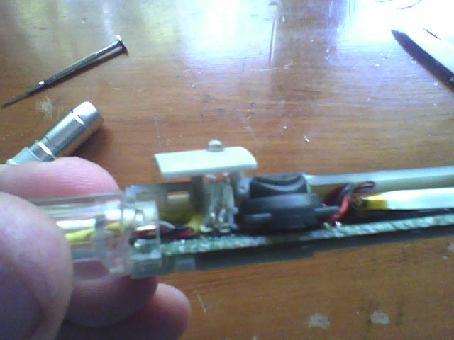

Bonus round:
how the slider button works/is held on
