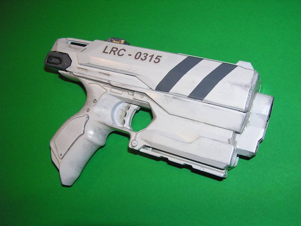

Not yo' mama's Alpha Meson blaster . . .
Clearly it's a different model from River Song's gun. Alpha Meson Mk II?
I'm trying to approximate the Whovian appearance with a near-stock shootable NERF gun. Maybe a Firestrike would look better. Next time . . . .

On the white Firestrike, grunge in the crevices is an acrylic wash; worn edges are thinned silver enamel rubbed on with a nearly-dry paper towel . . . essentially dry-brush techinque with a paper towel rather than a brush.
