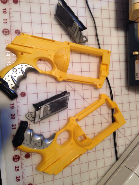

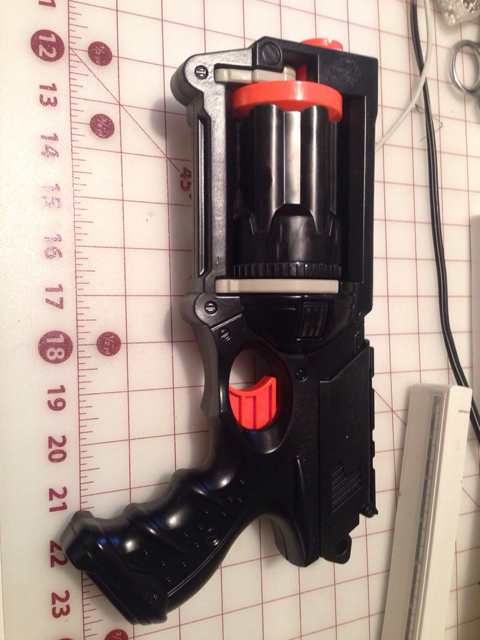

First Nerf prop disassembled and sanded, now for a base paint. Any recommendations for a good gunmetal black?
We'll see how long this takes, I don't get to paint until my daughter's Elsa dress is finished...
The joys of being the only crafter in the house and two kids that want you to make the cool stuff ie hardest stuff.
I'm a leaf on the wind.
I've had good results with this, though it might not be exactly what you have in mind. Looks a bit like worn-smooth cast iron.
I've had good luck with flat black rubbed with graphite dust. Then a little dry-brushed silver to pick out the edges.

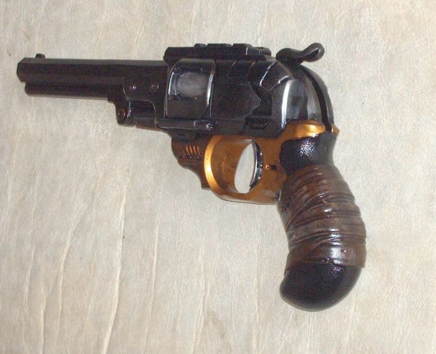

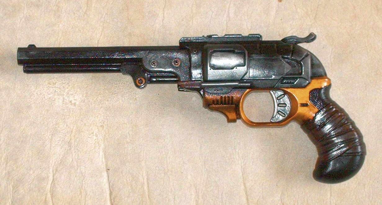

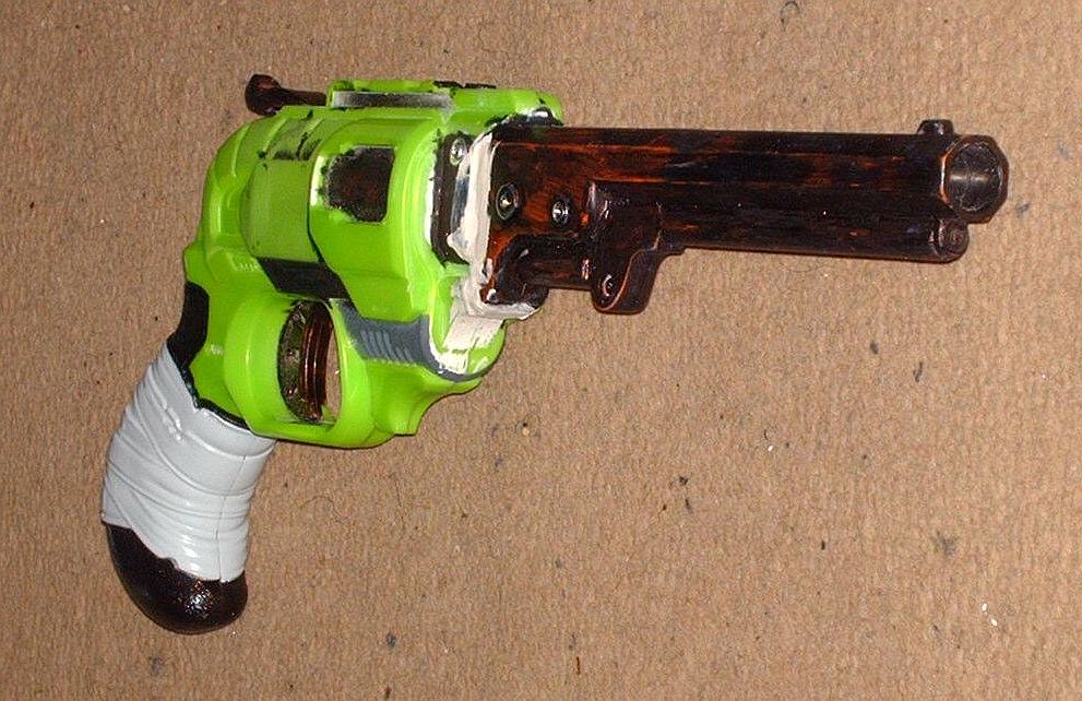

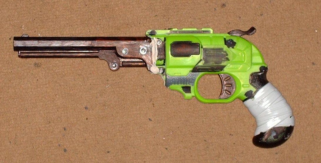

Here's some WIP pics of my 'Definitely Not Mal's Pistol'. The barrel is from a cowboy gun-shaped TV remote control I found at the 99p shop a while back. I had to disable the firing mechanism; but it still cocks.
Holy crap, you finally found a cheap octagonal gun barrel. I've been looking for one of those to use for a Mal gun for so long now. I'll have to see if I can find a remote like that. The gun's looking great too. If I use the same Nerf gun as the base for my Mal's pistol, I'll also probably try to mod the handle/trigger area.
Good luck - those zappers were all over the place a few years ago here in the UK; but now you just can't find one anywhere. I'm not going to touch the grip or trigger area on mine, I'm going for something like an earlier model Mal, or more likely a cheap and well-used local knock-off.

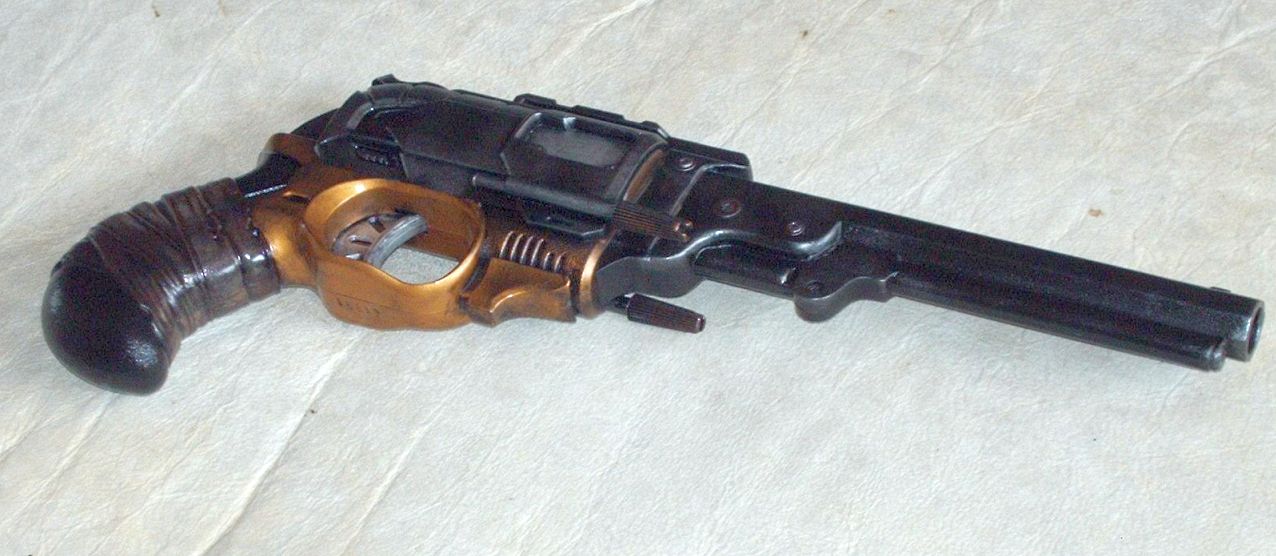

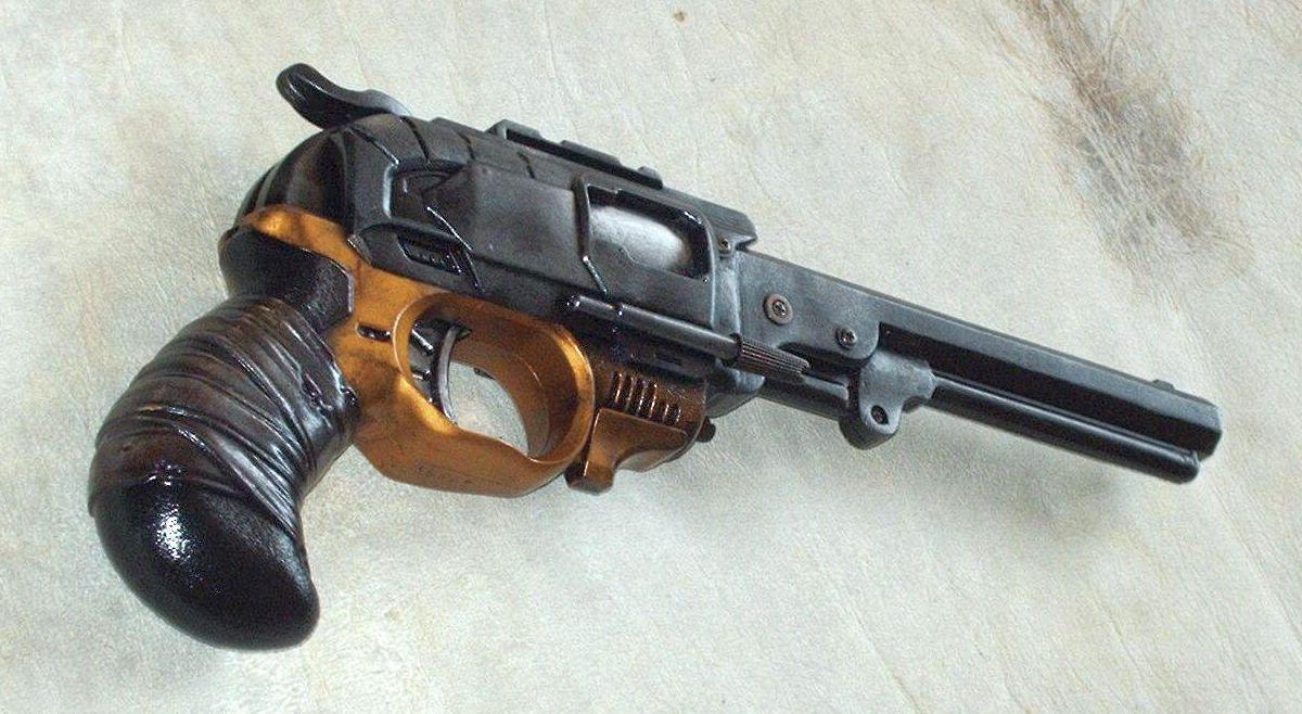

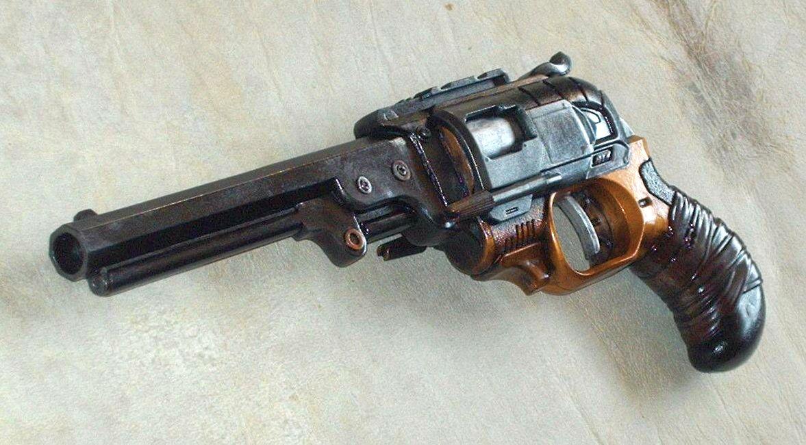

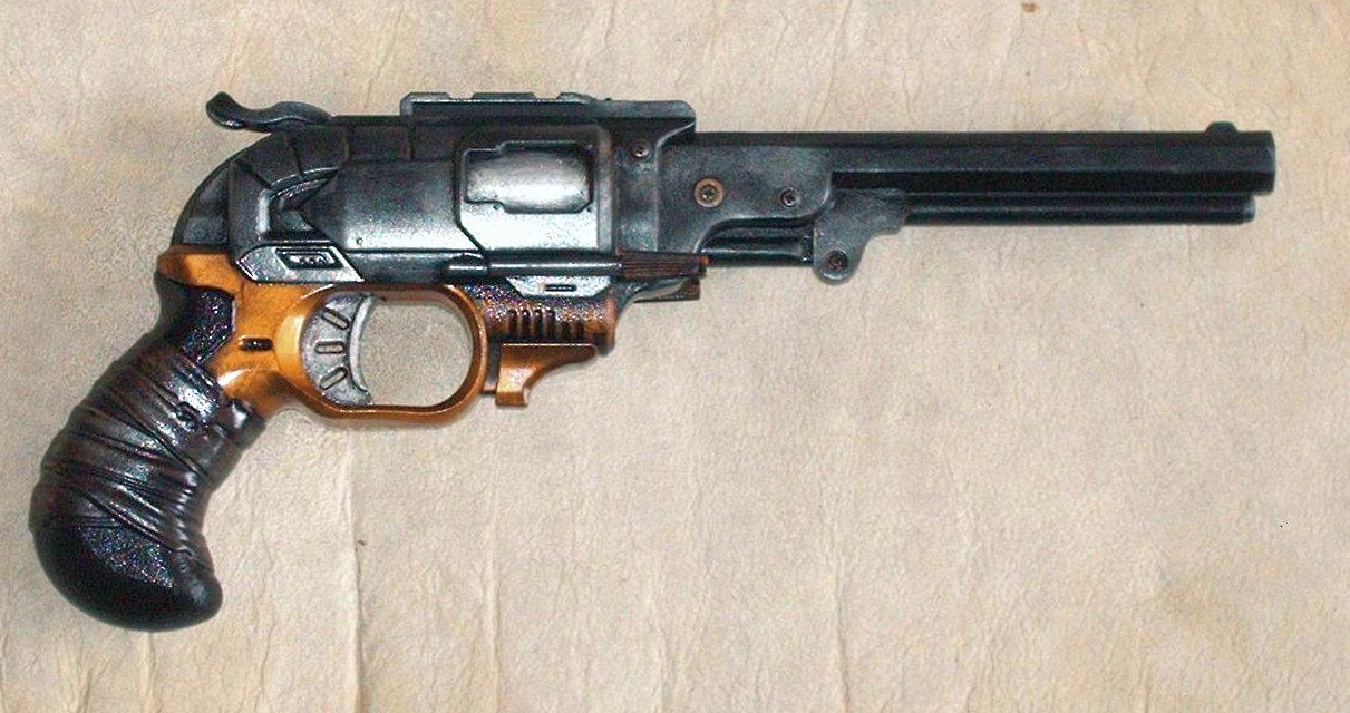

Here it is, the 'Definitely Not Mal's Pistol'. The big finger screws are from an old printer cable. Hope you like it.

Finished my base coat and reassembled. I can see why everyone says this takes patience. I can see where I did not heed those wise words. Thank goodness this was a practice round.ImageUploadedByTapatalk1412995747.305139.jpg
Next step is the rub n buff. Any tips on working with that stuff?

Finished my base coat and reassembled. I can see why everyone says this takes patience. I can see where I did not heed those wise words. Thank goodness this was a practice round.View attachment 387978

I dunno, I'm hands-on with the stuff. Blame coming up through theatrical scenery and make-up. Not a great habit when there's stuff like Bondo around. Anyhow, I've tended to apply Rub'n Buff with my fingers, straight from the tube. With the aid of a (previous ruined) small paintbrush to shove it into the cracks. Apply too much and wipe off the excess -- you can feel it, the excess sort of crumbles off. Then rub. You really can not over-rub. Getting it warm is part of the trick; rub until the friction melts the wax base a little. Keep rubbing; when you think it is as shiny as it's going to get, it will probably get shinier if you keep working.
But that's for a solid shiny metal look. You can also dry-brush with the stuff. I've used both fingertips and paper towel for this (not had a lot of luck with brushes or sponges). Put a little bit of Rub'n Buff on the tool, wipe off gently on a piece of scrap. Then apply the tool to the surface you are dry-brushing, working from the edges you want to define. Basically, wipe as if you were trying to scrape the last of the Rub'n Buff off your tool with the sharp edges and other projecting bits.
It is a subtler technique than using silver paint.
