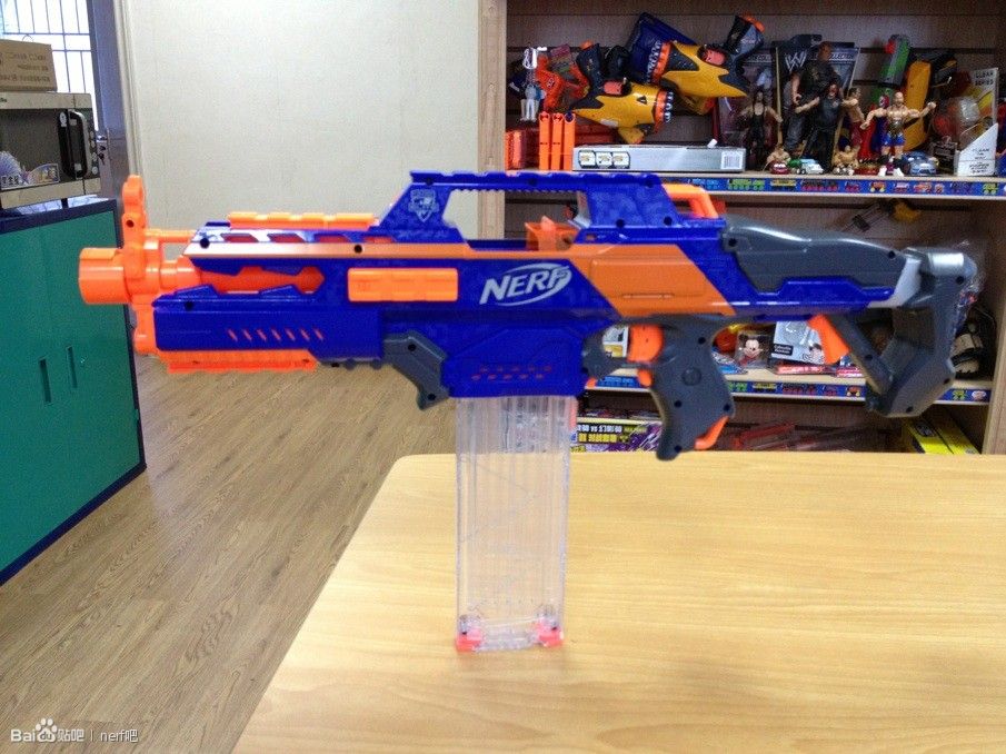

Hey guys, I noticed that the new Nerf Elite series has a 12 dart clip, might save a lot of hassle if it fits the recon blaster:

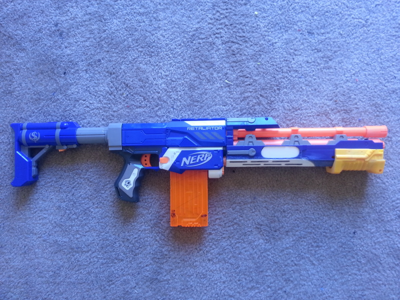

Just wanted to share what I've done so far. I used a retaliator for its 12 round mag & I also wanted mine a little more screen accurate so I cut an ejection port for the grenade launcher (yes, everything is still functional) I designed a SPAZ styled cage for the space under the front gun & I also rebuilt the pump grip part (had to use 2 LS pump grips). comments?
