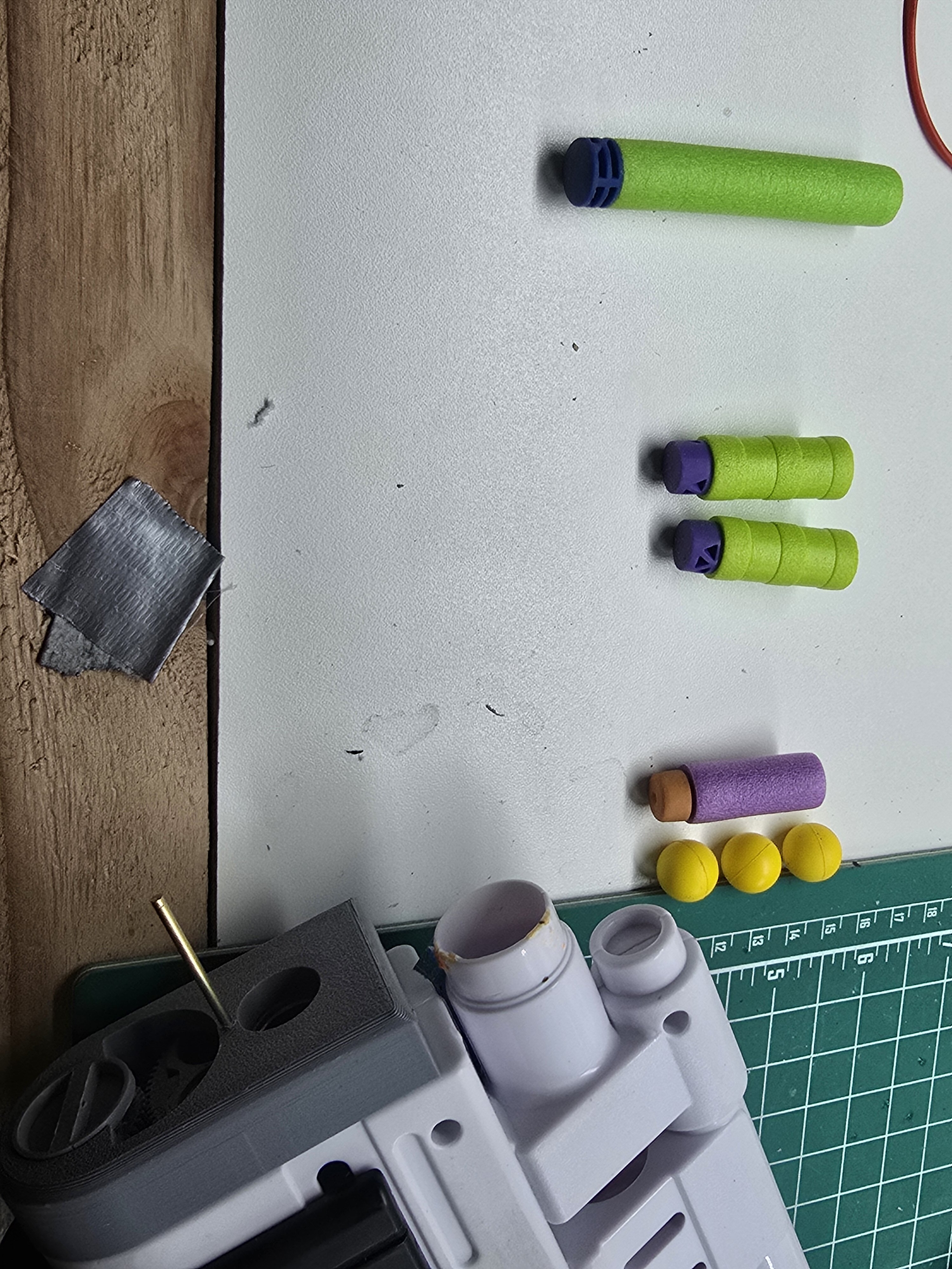

Paintball style loader to push 50cal rounds, uses Monkey Mods 50cal foam balls for the primary. Modded the underslung launcher to a three round auto advancing grenade launcher capable of holding x1 standard nerf dart, x2 short darts, x1 short dart and x3 50cal balls, or x5 50cal balls.

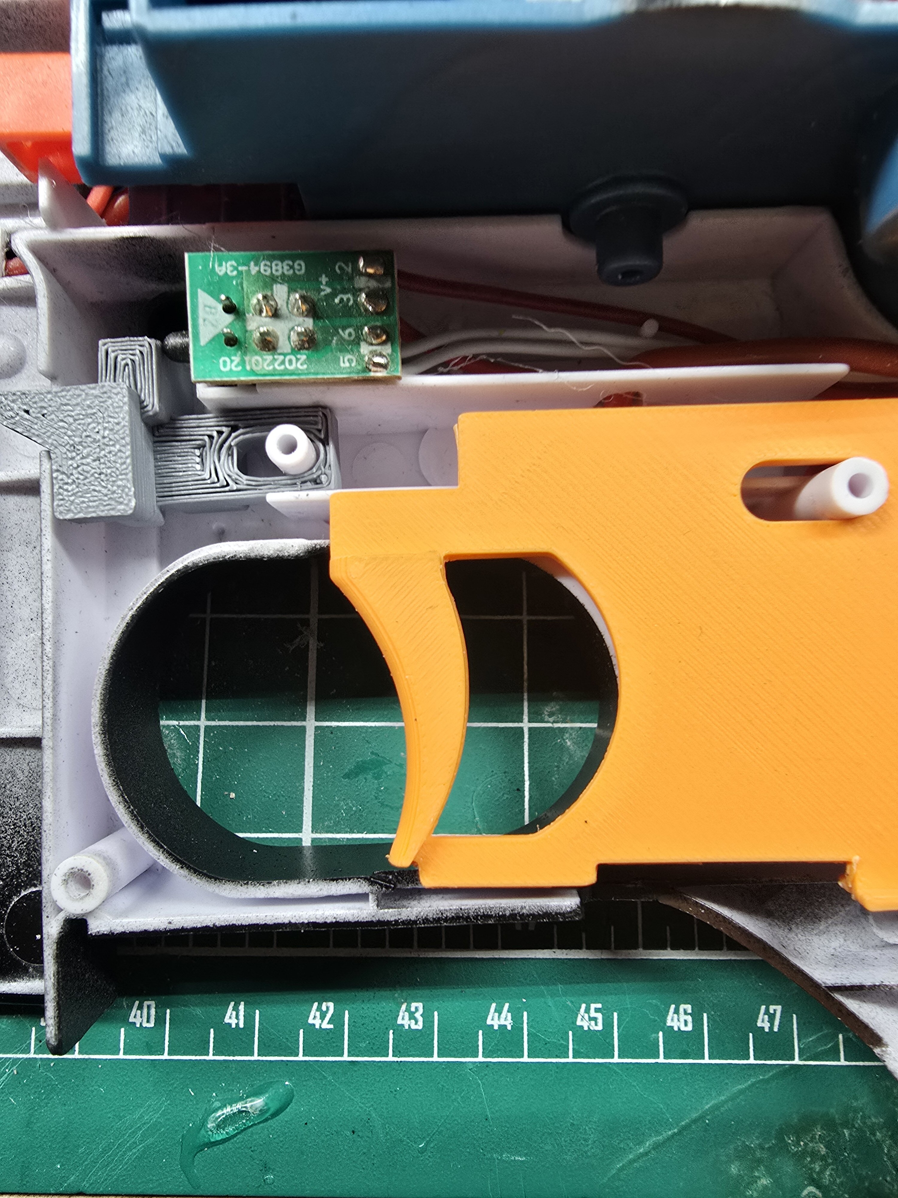

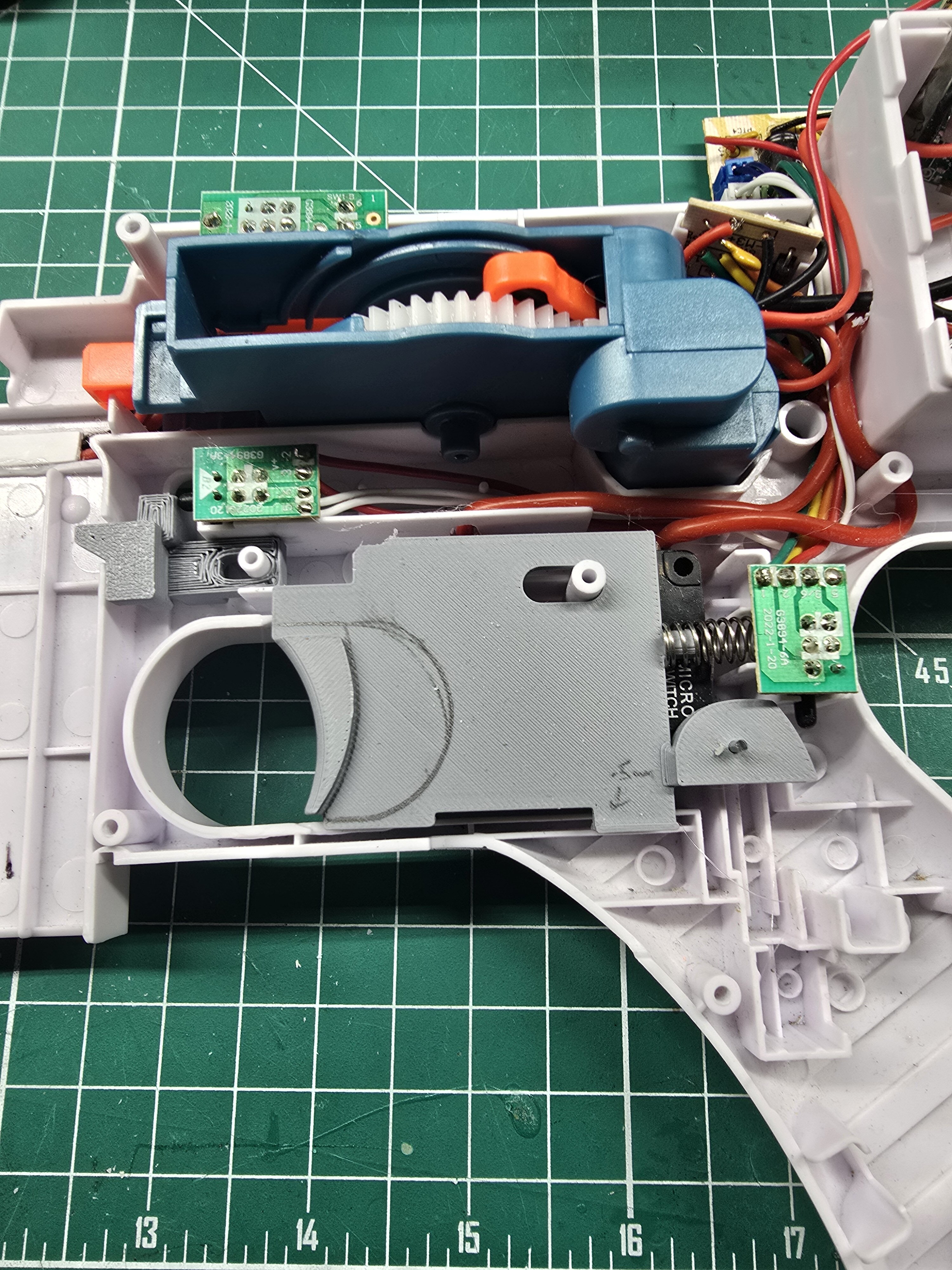

Trigger has been modified to a dual stage eliminating the need for the rev trigger, flywheel motors have been upgraded to Out Of Darts 130 Krakens.

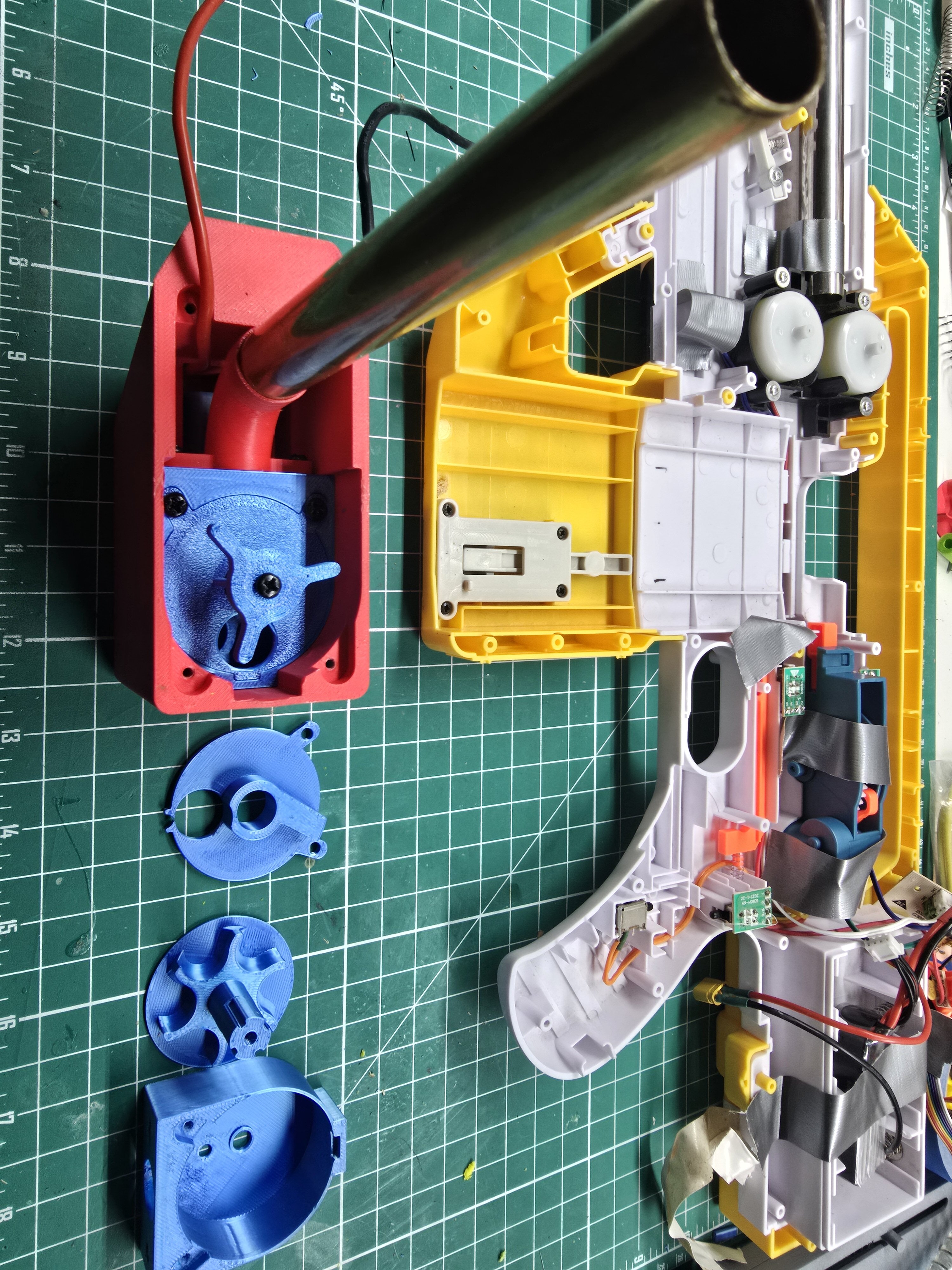

There is a switch that allows for the standard magazine or aftermarket magazines to be loaded and fire the standard length nerf darts. Flip that and it disconnects power to the pusher motor and powers the magazine for the 50cal rounds.
I am working on a 95 round variant of the magazine however this will take more cutting into the blaster itself and might prevent use of the standard full length magazines so I have been hesitant to try until I have a few things dialed in.

(Updated trigger and cut out)
(Dual stage function works with a limit switch under the new trigger and shortened magazine stop switch)
(A few grenade loadouts mentioned above, these are different 50cal foam paintball rounds and not the dimpled 50cal Monkee Mods rounds used for the primary but both work.)

(Early version of the internals though not much has changed minus the brass tube running the full length.)
(Current magazine again holds/fires 60 rounds not including non expendable rounds in the vertical tube.)
