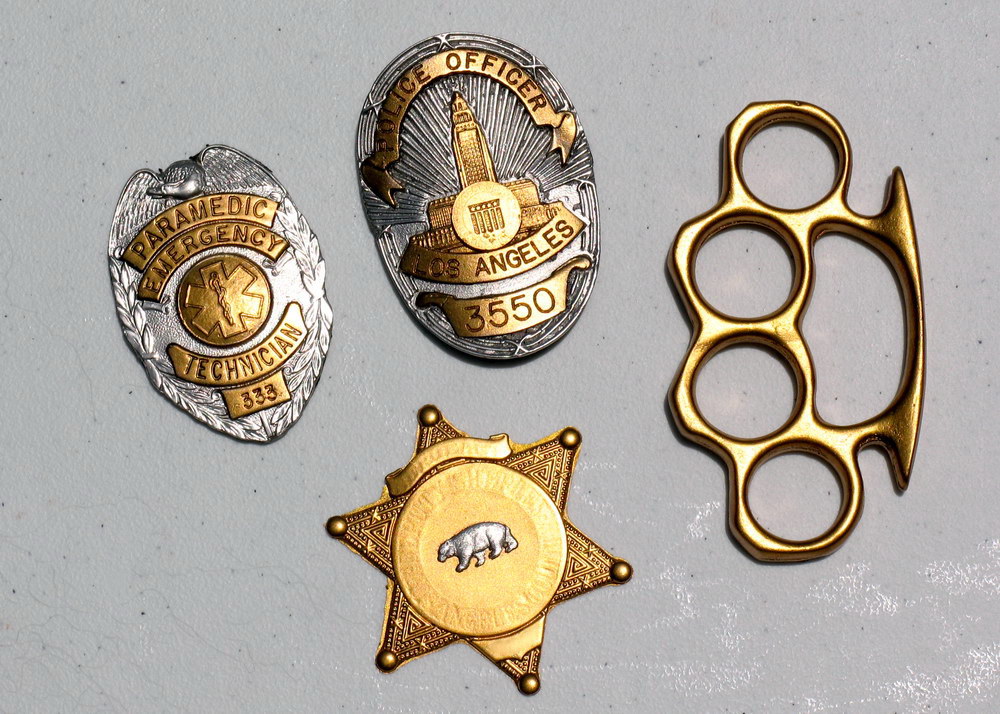

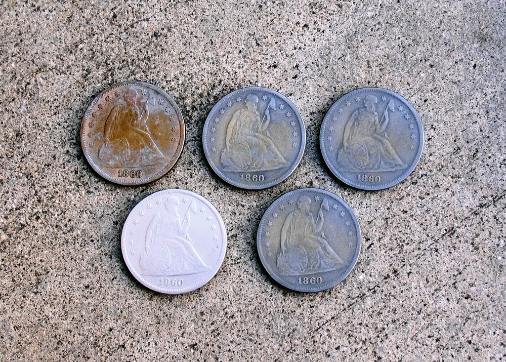

Also I have to add I do not use cheap casting resin but a high impact plastic. Hobby resin is usually full of bits of filler, air bubbles, and has a wave type surface finish to it when cured. As an example, below is a photo of a sheriff star badge that is less than seven grams of material yet the part is rigid and durable. Even after 12 years those parts have not warped, bent, leached, snapped, and look as good as the day they were made even after various usage on projects. Hobby resin, I dont believe they would have made it out of the mould.
These are all parts directly from moulds, as is. Very basic.

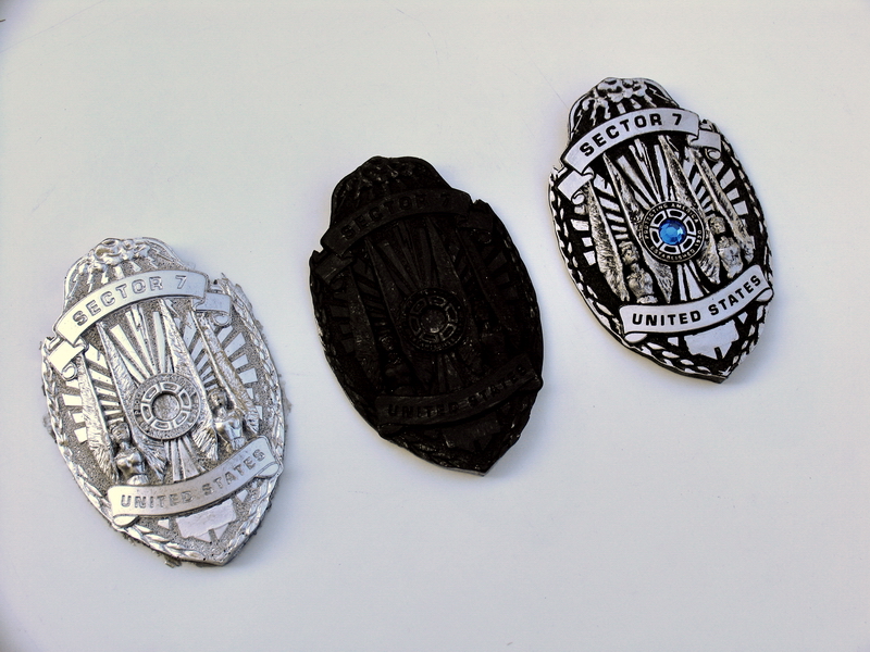

A Sector 7 badge and how those castings were done.

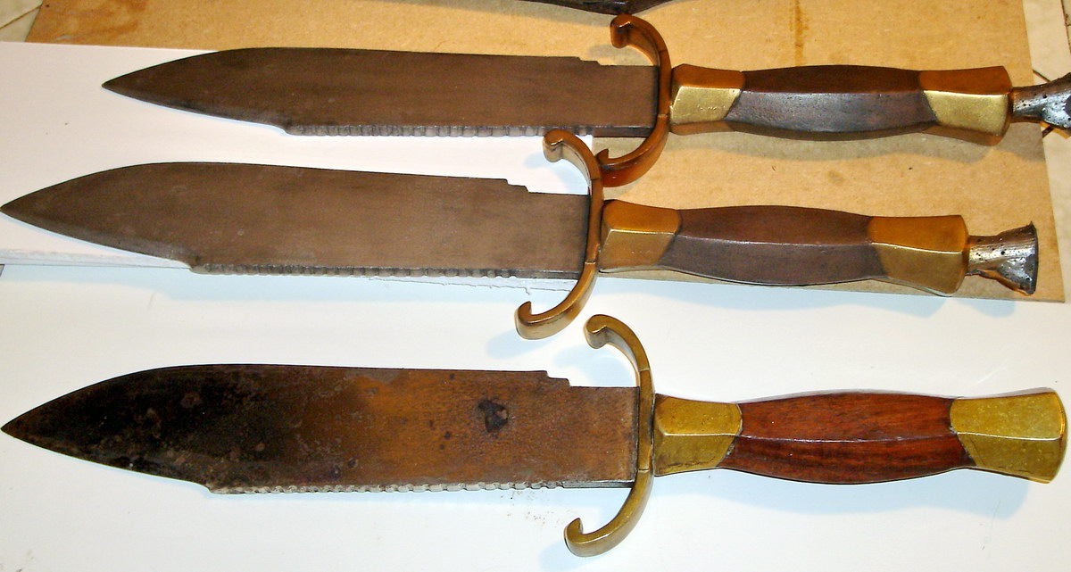

and ive posted this before, when you get good with the materials. These held up during lots of stunt filming and used on a couple projects. Never needed a touch up or repaint. And of course these are directly from the mould. The original knife on the bottom, two castings above.

and ive posted this before, when you get good with the materials. These held up during lots of stunt filming and used on a couple projects. Never needed a touch up or repaint. And of course these are directly from the mould. The original knife on the bottom, two castings above. View attachment 1358004

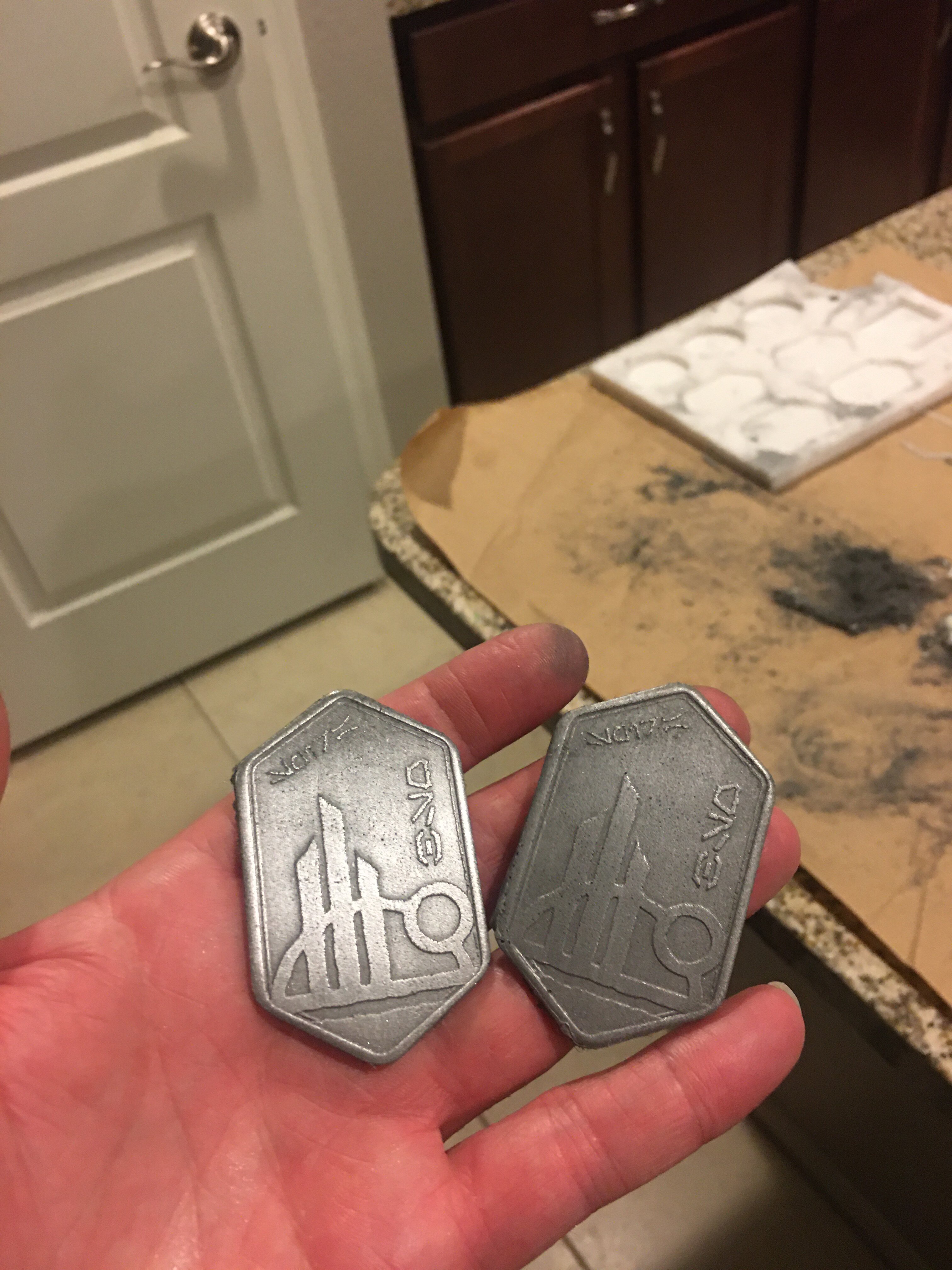

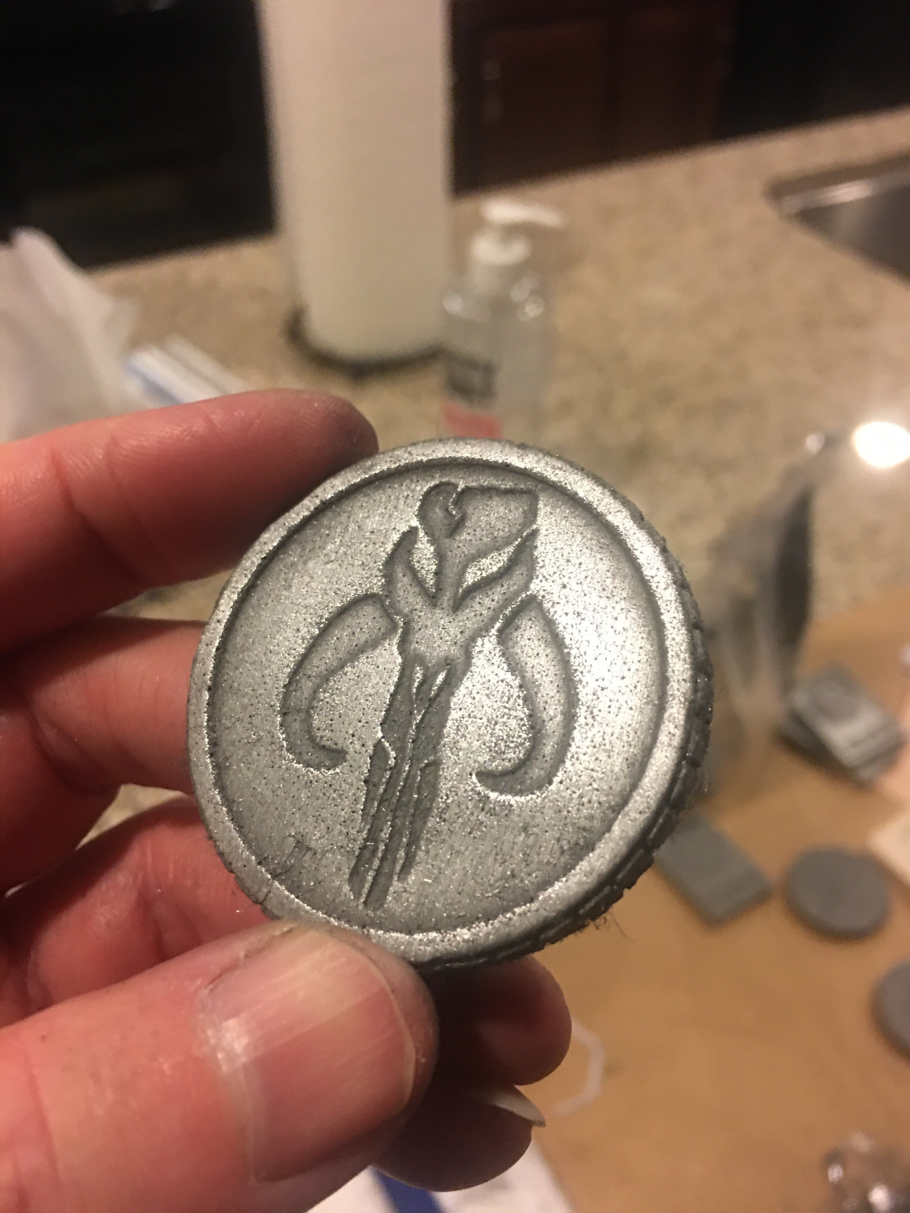

Thanks for that info. I may try to go more professionally in the future and this info is great! For my coins, which are just for my gaming use, I used clear resin with the powder mixed in. I dusted the molds first, used a 350 mesh, and then buffed with 0000 steel wool. I did notice that aluminum buffed out considerably more easily and quickly than copper or brass did.
you can also try a very basic and cheap casting material for coins, Crayola Crayons. The silver ones in particular make great coins with a little silver dusted into the mould.
