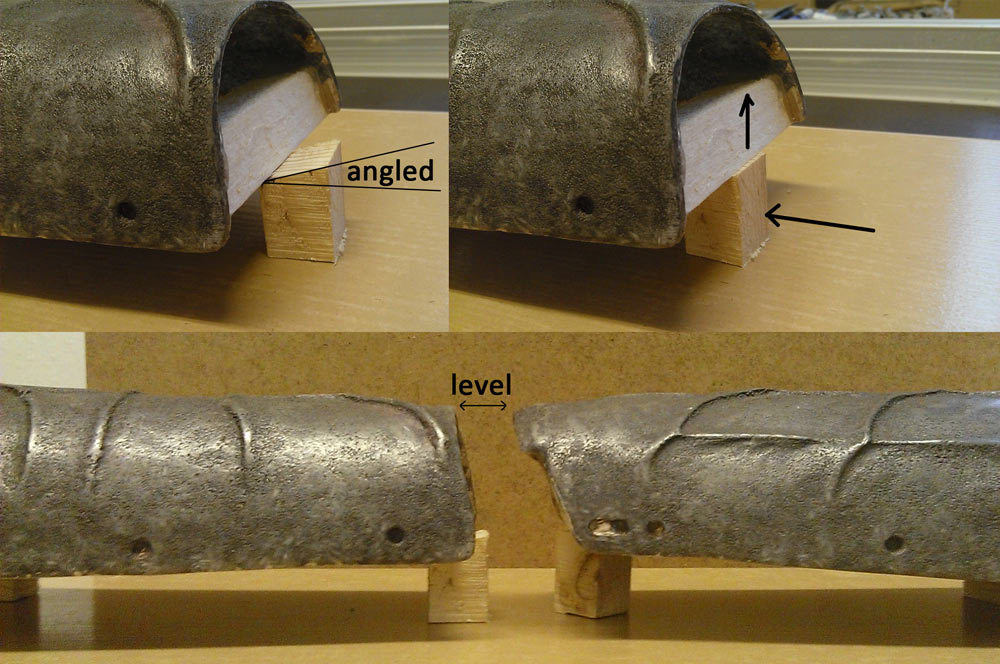

Here are the first pics of the mounting-process. I started with the biggest parts - the armplates
I want to minimize the time it takes to laminate all the parts so I'm combining parts, which go together nicely, into a single mold. Hence I only have to cut big sheets of fiberglass instead of more small ones. The fiberglass will will extend the parts on all sides and need to be trimmed afterwards. Previously I laminated ONLY into the edges of the parts and often had problems with corners not beeing filled with fiber - which was especially bad on the joints.
The clay isn't finished yet. This is just the "see how much clay is necessary" stage (it took 4 small packs of clay).
The cardboard - fixed with hotglue - is just to prevent to much clay to get where I don't need it.
I extended the shapes of the armguards to the left and right to get more room in the mold. This will be helpful when laminating with rectangular pieces of fiberglass.
