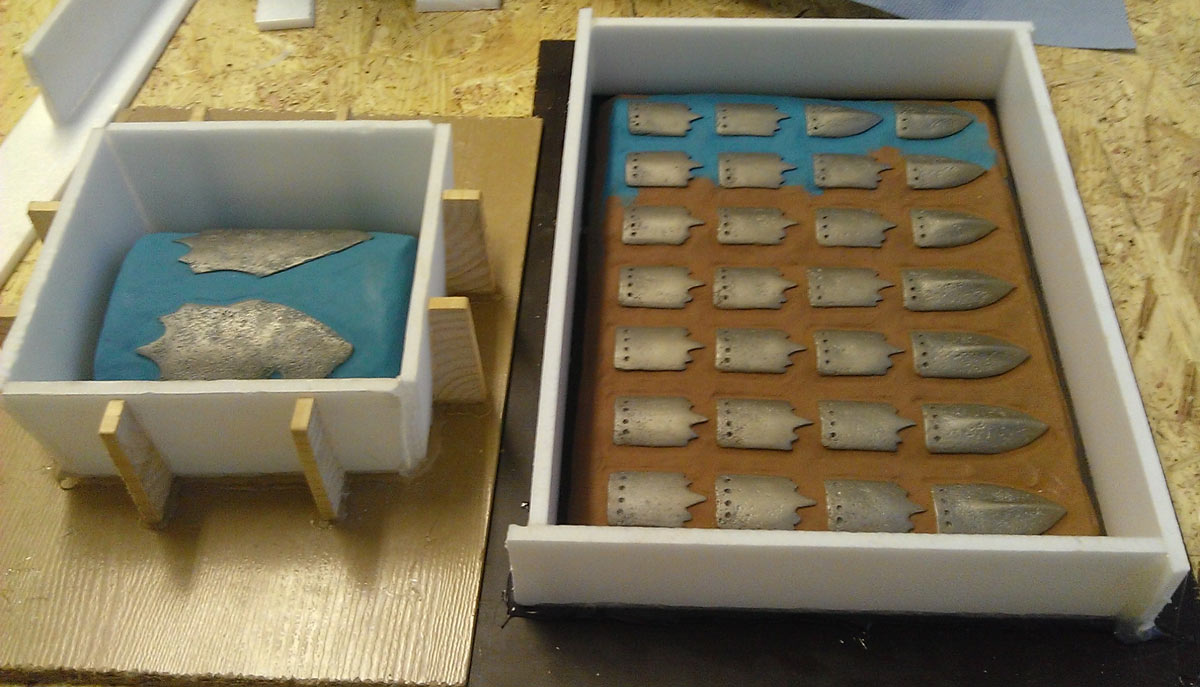

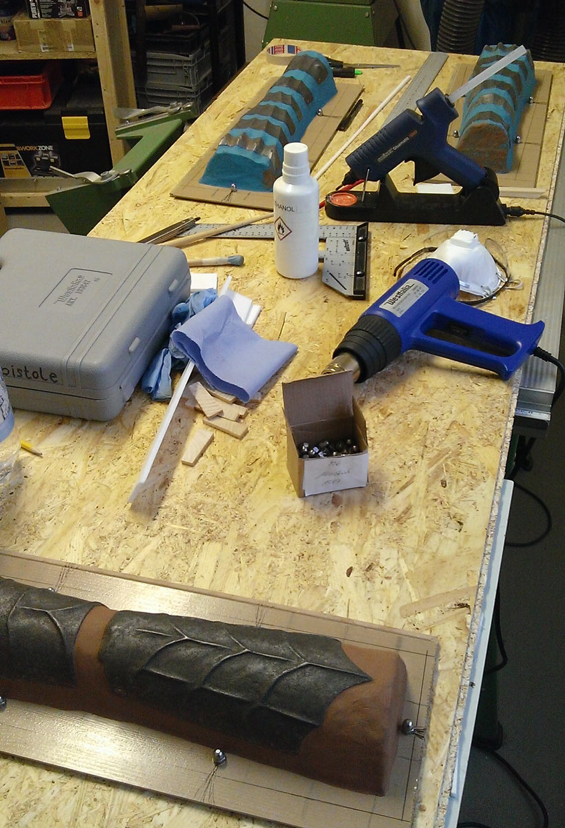

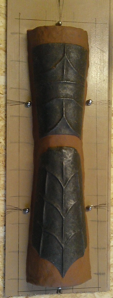

I finished the clay work today. Tomorrow I'll build walls around the parts and hopefully already make the first silicon mold already. To strengthen the silicone, I bought some bi-strech lycra which will be soaked in the silicone. (This tip I got from Brad Cunningham from Weta ... met him at a convention some time ago and we talked a bit about moldmaking etc ... great Guy! :-D )

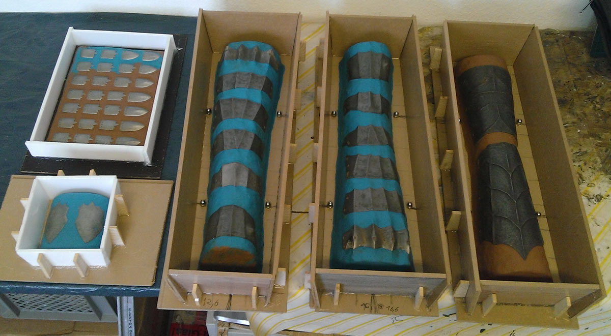

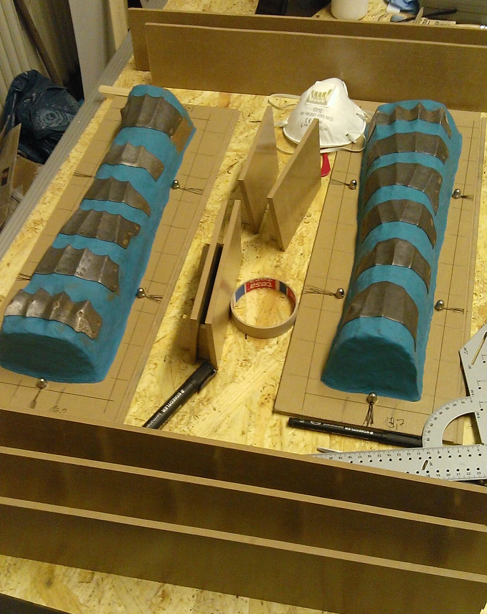

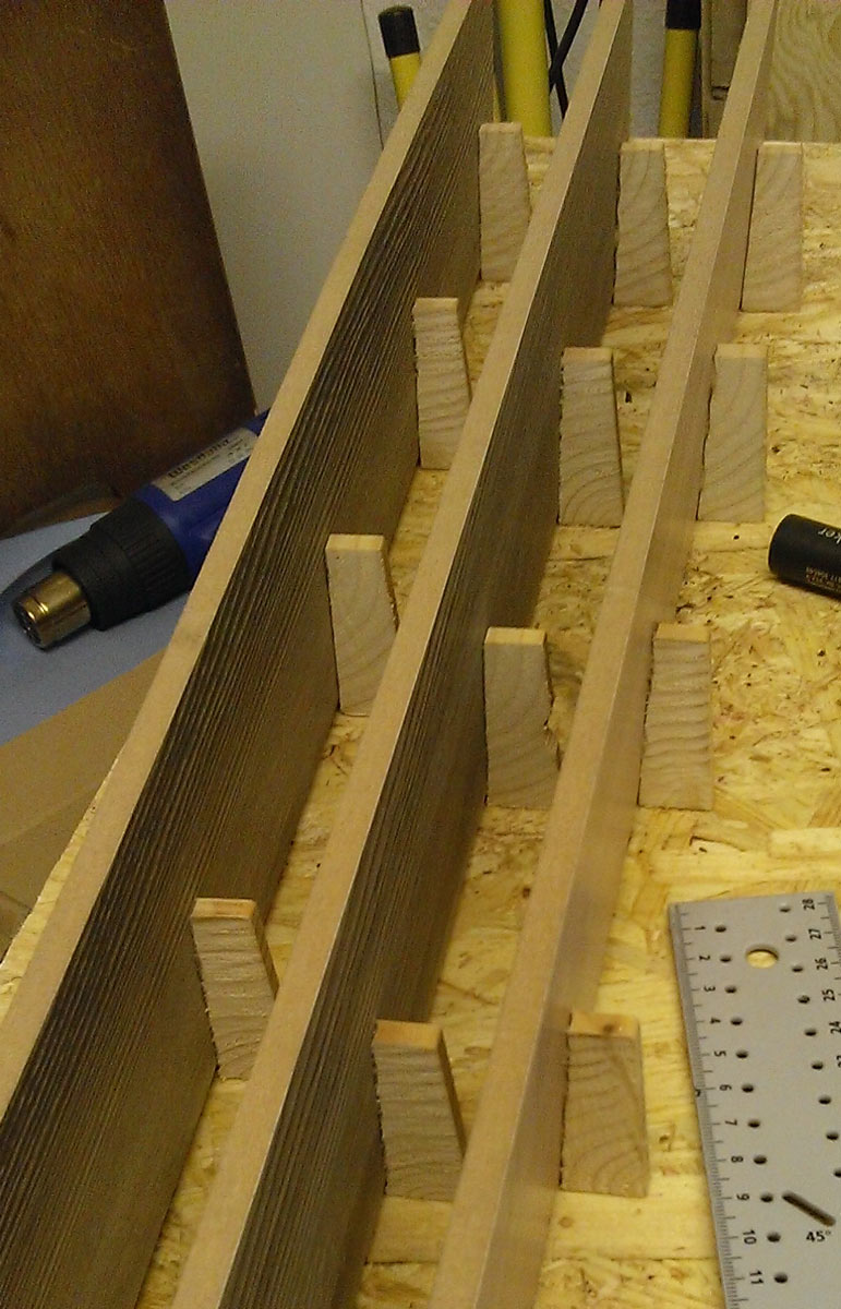

On saturday I got 2 molds ready for silicone and the others just need the walls built around them..which are also already prepared...

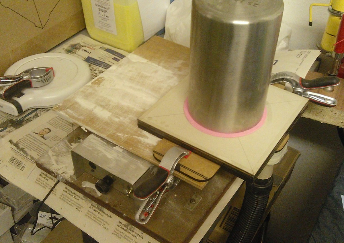

VibratingVacutable.jpgHomemade Vacuforming table on top of my also homemade vibrating platform -> for degassing the silicone

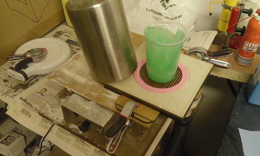

This is my advanced anti-bubble-silicone-mold-device...vacuum-plattform on top of a homemade vibrating table...works quite nice!
Also I clamp the mold itself to the vibration table to get rid of as many bubbles as possible.

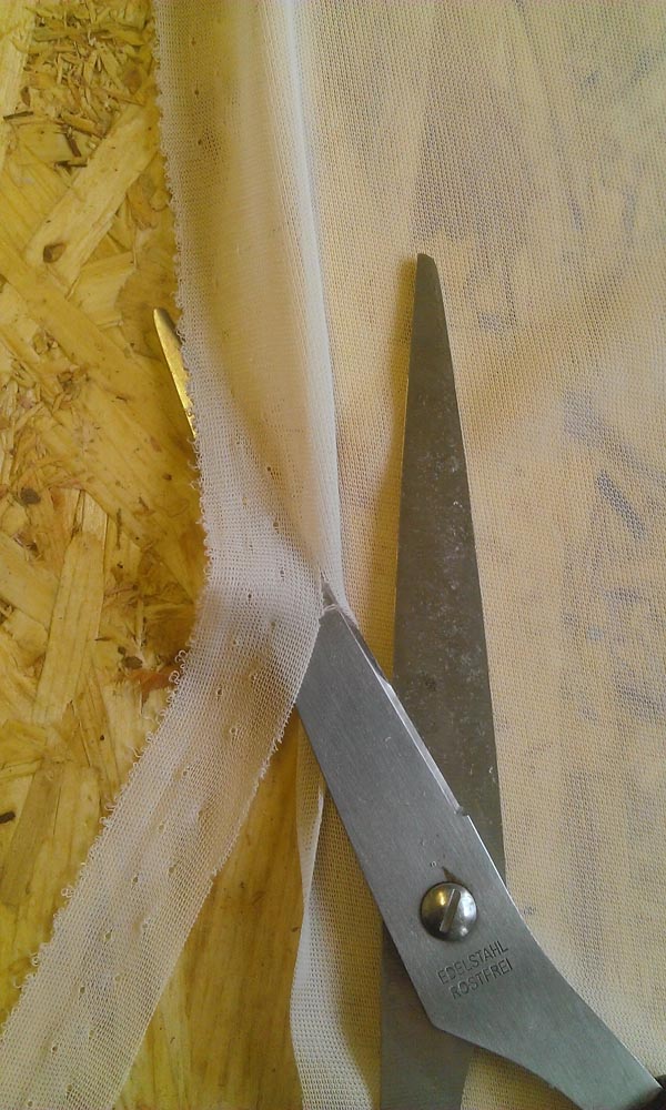

Cutting the edges of of the lycra which I used to support the silicone

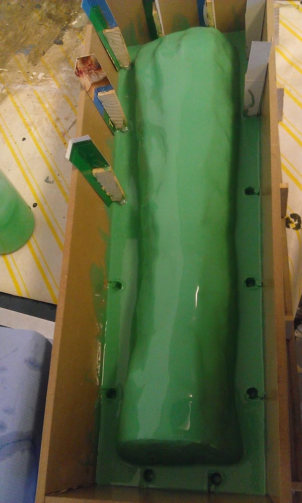

First layer: just silicone.
Second layer: Silicone and lycra

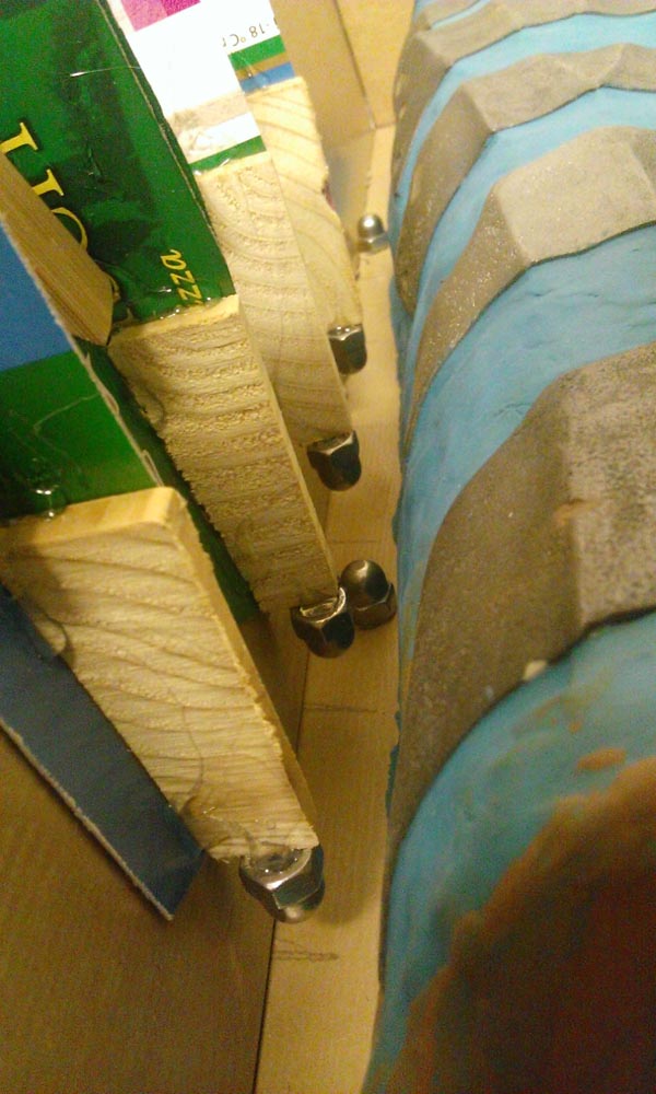

third layer: silicone and insertion of cap-nuts for keys

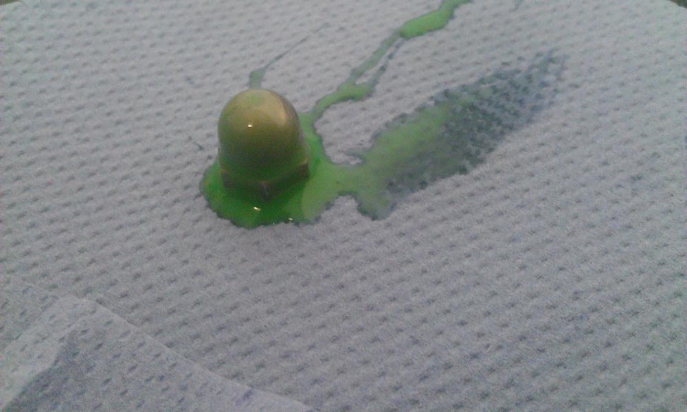

..but they tend to drown in the silicone when you insert them before the silicone is set to exactly the right amount.

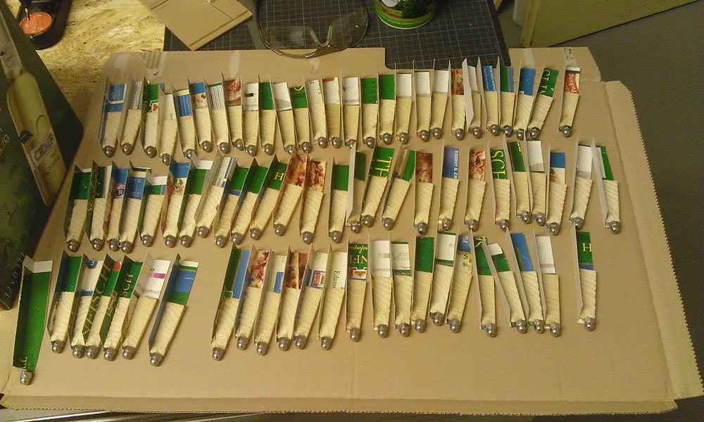

So I built some little helpers :)
With these, you can hang the cap-nuts where you want them to be before pouring silicone in there.

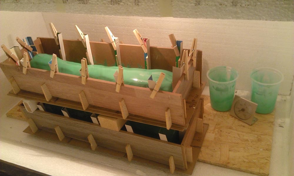

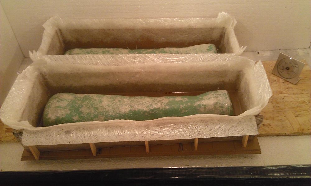

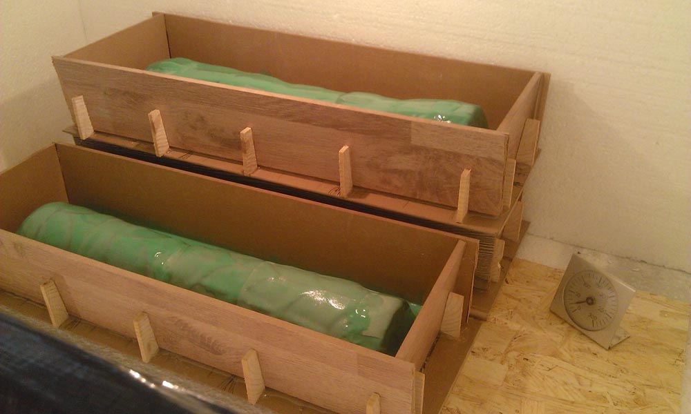

curing silicone! Unfortunately it got cold and the heating would not work right from the start, so I made a crude Styrofoam box with a light bulb as a heating source to get the temperature above 20°C
Keys removed, ready for fiberglass.

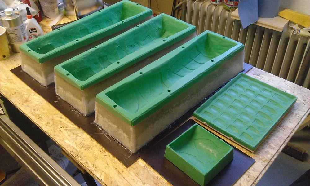

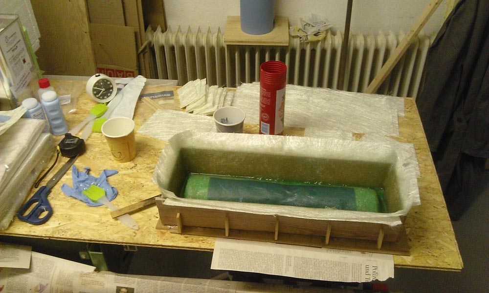

For the Support...or mother mold (did more 3D printing than moldmaking lately ;-) )... I used fiberglass matte and old resin.
The resin was on the edge to going bad, but for the mother mold it was still OK to use.
because of the thick matte and old resin, there are some areas which got not totally saturated, but around the silicone it's good enough :)
TADAAAAAAA :D
well, this took long enough!
...from a slightly different perspective :) That was a joyful moment for me :lol

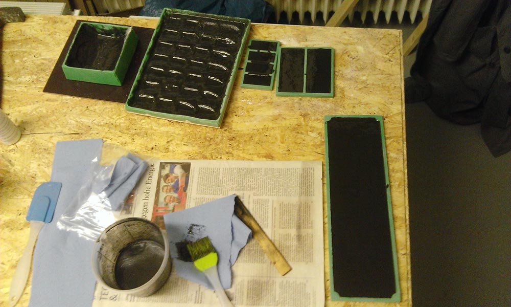

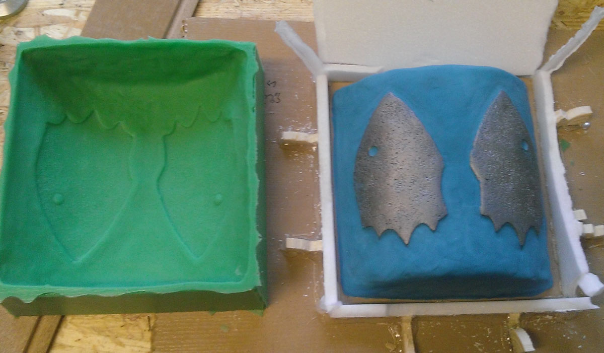

First test. This is just Resin with iron-powder and cotton flocks. Because Iron is a bit heavier than resin, it always sunk down to the bottom of the pot the last time I made these gauntlets. With the cotton flocks added this still happens, but not as fast. (the molds on the right are for Weyland Yutani and USS Sulaco/Saphora signs)
