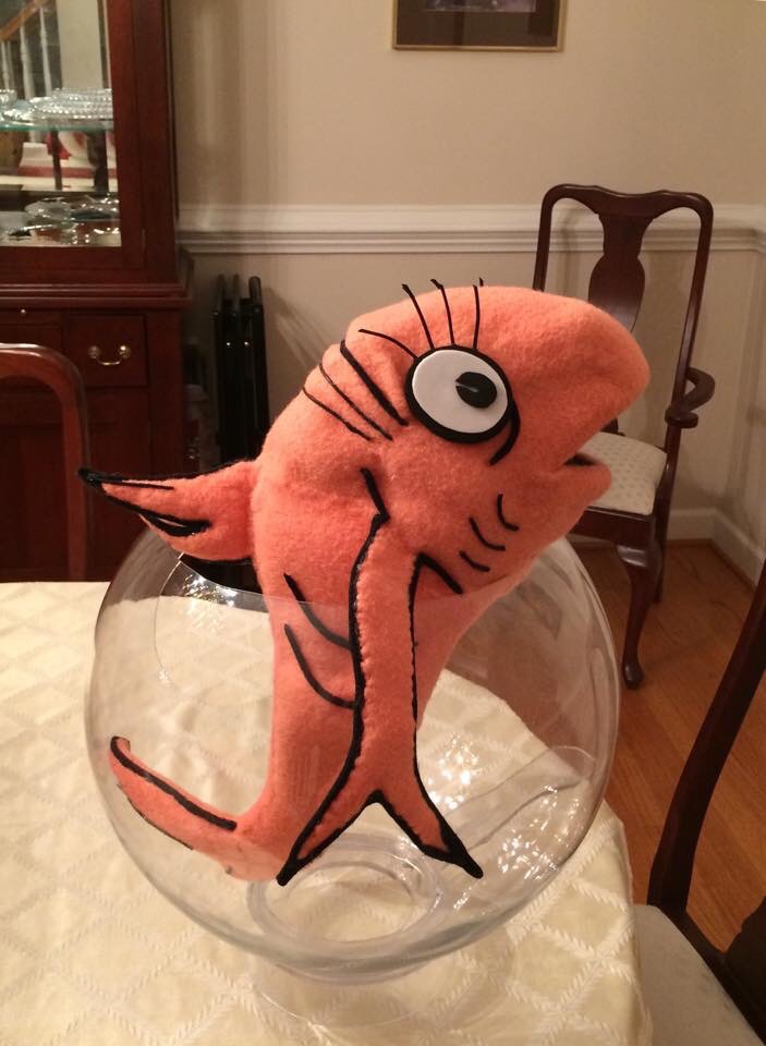

I built the fish puppet, fish bowl and tea pots for our local children's theater production of "The Cat in the Hat."
Nice! That is awesome. Really impressive. Was it a success for the theater?
