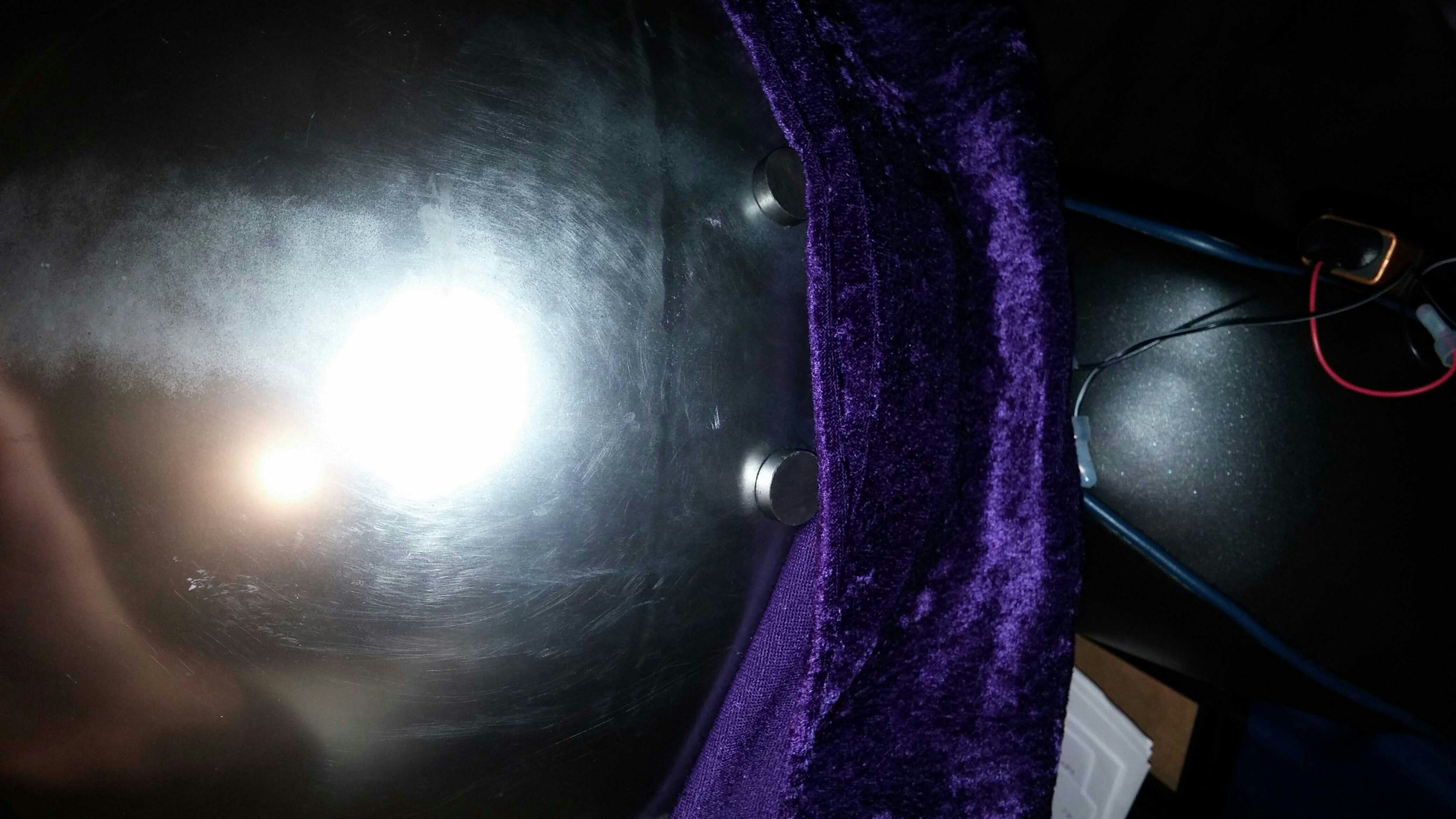

May I ask what solution you're using for the 'oxygen-issue' ?
For example,if you chose to drill holes for airflow,what size and frequency (spaced out over the surface) would they have?
It was a little warm inside. I mounted a computer fan in the back. Used a toggle switch and spliced it with a 9v and wired it to the fan. Perodically I had to take it off too cool down. If I would guess probably about every hour to an hour an half.

When relying on holes for air,what size do they need to be and how many for sufficient airflow?
No holes were drilled. It was solid all the way around. uploadfromtaptalk1410826248465.jpguploadfromtaptalk1410826275582.jpg

Thanks ahoudini! No the paint is on the outside. I did not paint anything on the inside. With lack of ventilation, it could be harmful trying to breath if you have spray paint on inside. Especially if it's like 90 degrees outside or in a convention center. I does get fairly warm in the helmet.
