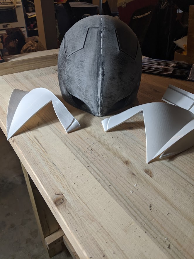

First off the first piece of the helmet I tried to print ended up failing about 12 hours in, which sucked
But I knew what happened and was able fix it and now have two pieces done!
What ended up happening was my build plate adhesion wasn't very good and the print popped off the bed. Easy enough fix though, just re-sliced it with a brim this time and it worked great! Also this was the first time I tried using tree supports, they're great, I saved so much filament using it with this print.
I did have a wierd line show up one one of the prints, not sure why this happened but it should sand off easy enough.

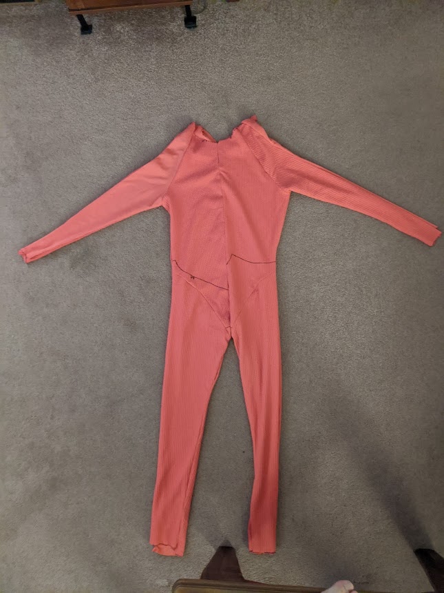

I also made some progress on the suit. I ended up buying some cheap fabric that had the same amount of stretch as the fabric I will be using has. I practiced the pattern with this and I'm really glad I did. I made a lot of mistakes on it and learned what I could from them. But in the end it ended up looking pretty good.
Funky colour I know. I was able to get the fit down pretty good and was then confident enough to use the real fabric. And I did!

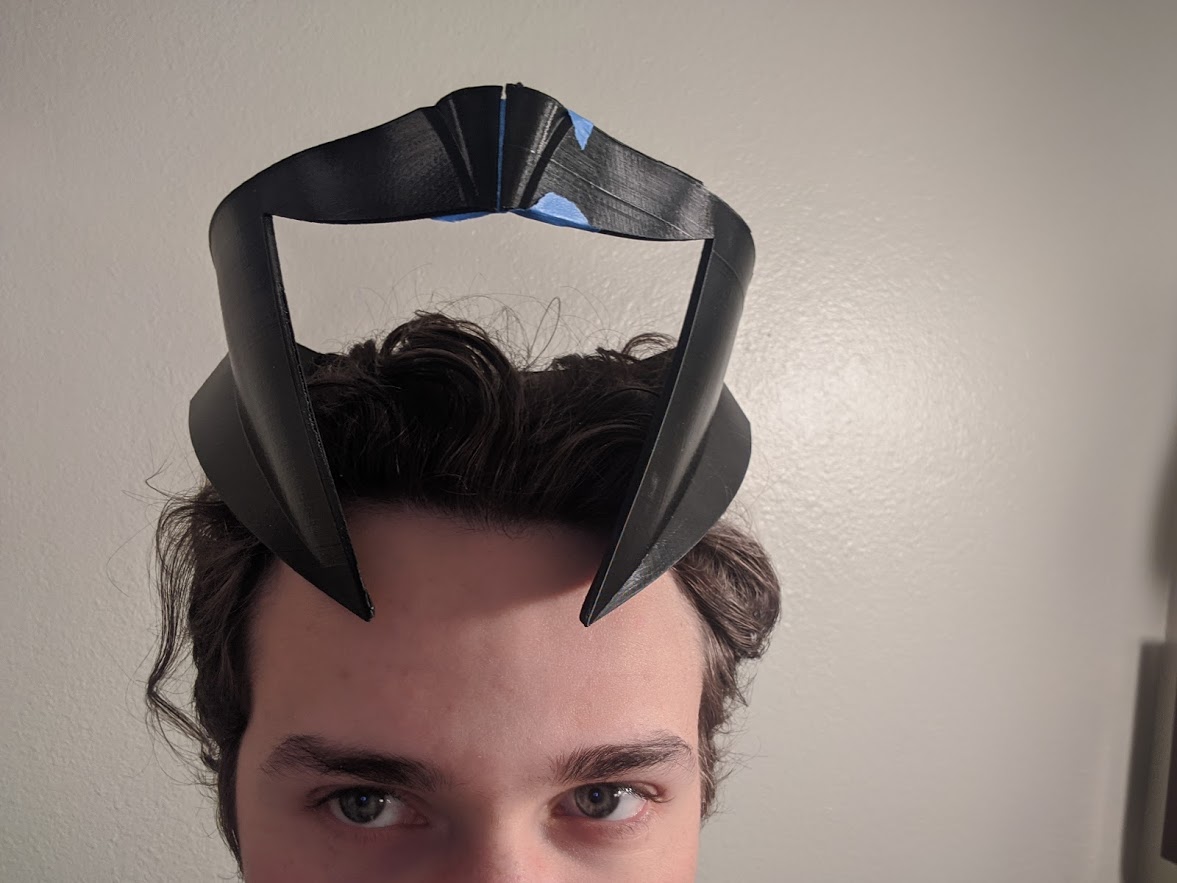

So I got all the pieces printed out for the main body, and it was looking great. There was just one problem...
It don't fit on my head.

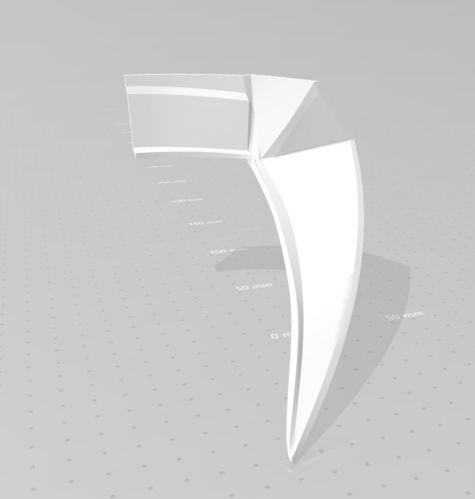

I was able to get all of the pieces to fit around my head, but the problem was the hole to get it on my head was too small. Soooooo
I split the model into two pieces a top and a bottom. The top will be glued to the helmet and my head is able to fit into that. Then the bottom piece is going to attach to the helmet after a put it on. I tried to make there be as few seams as possible and where there were seams make them follow the edges of the model to make the seams be easier to hide. I'm going to try to attach them using magnets, but I have yet to figure that out.
