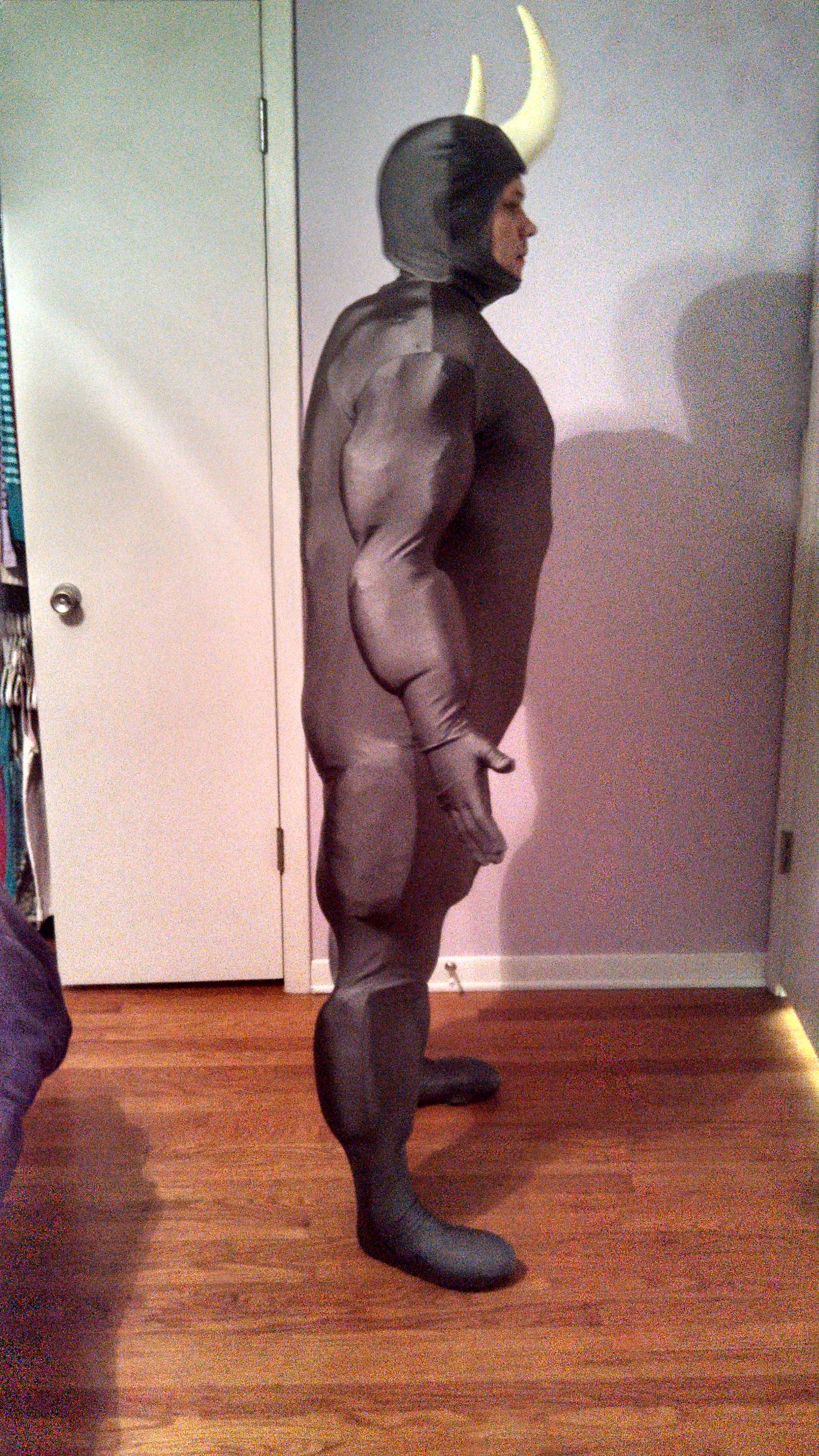

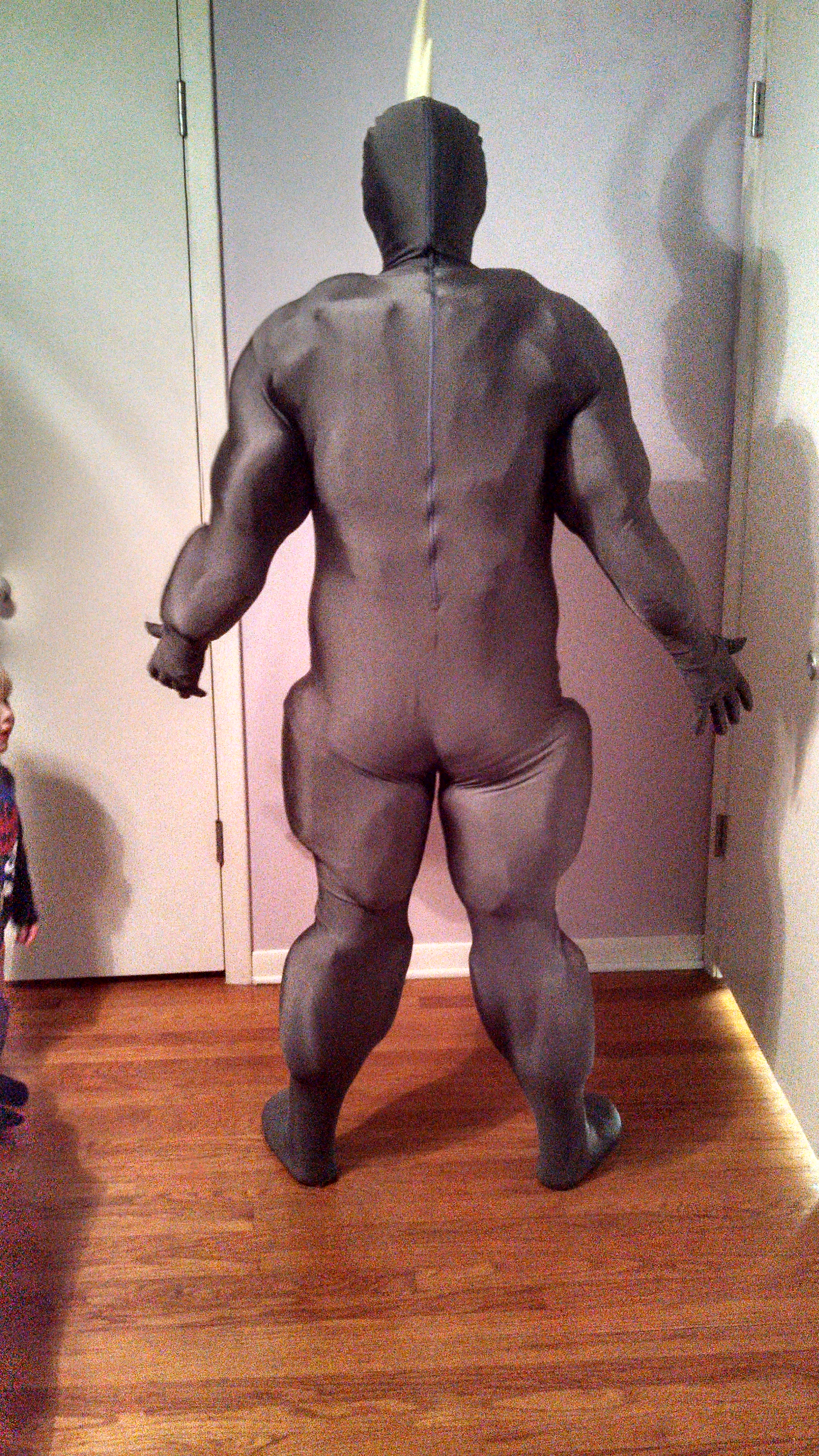

I finally have the time to post the progress of my cosplay Rhino (real name: Aleksei Sytsevich) suit on line. I have been working on this thing for quite tome time in preparation for the 2015 Planet Comicon Kansas City Convention. My Best friend and hetero life mate is working on a Hulk outfit as well. With only weeks to go it is time I get some feedback.
The first set of pictures that I am including are my Costume from PCC 2014, not to be confused with my new cosplay. I got such an awesome response from fans at the con, that I decided to go all in. So far I have well over 48 hours of R&D on this project. But if it turns out the way I am hoping, it will all be worth it.

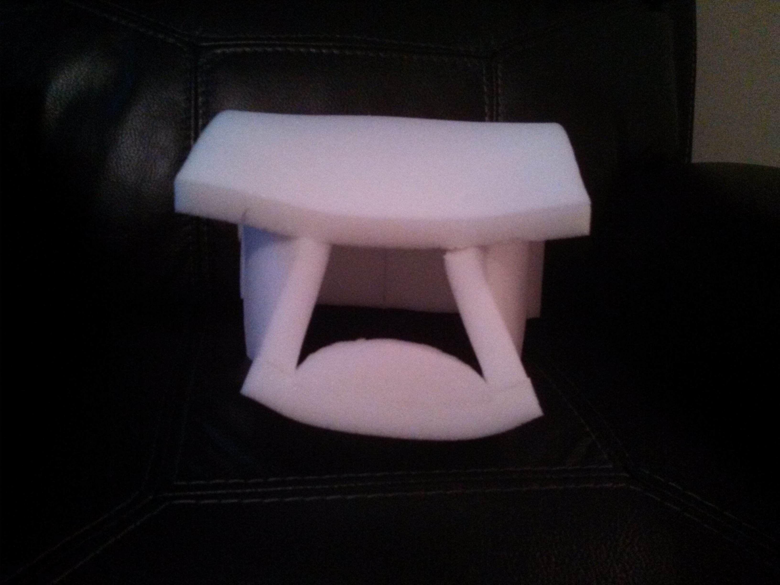

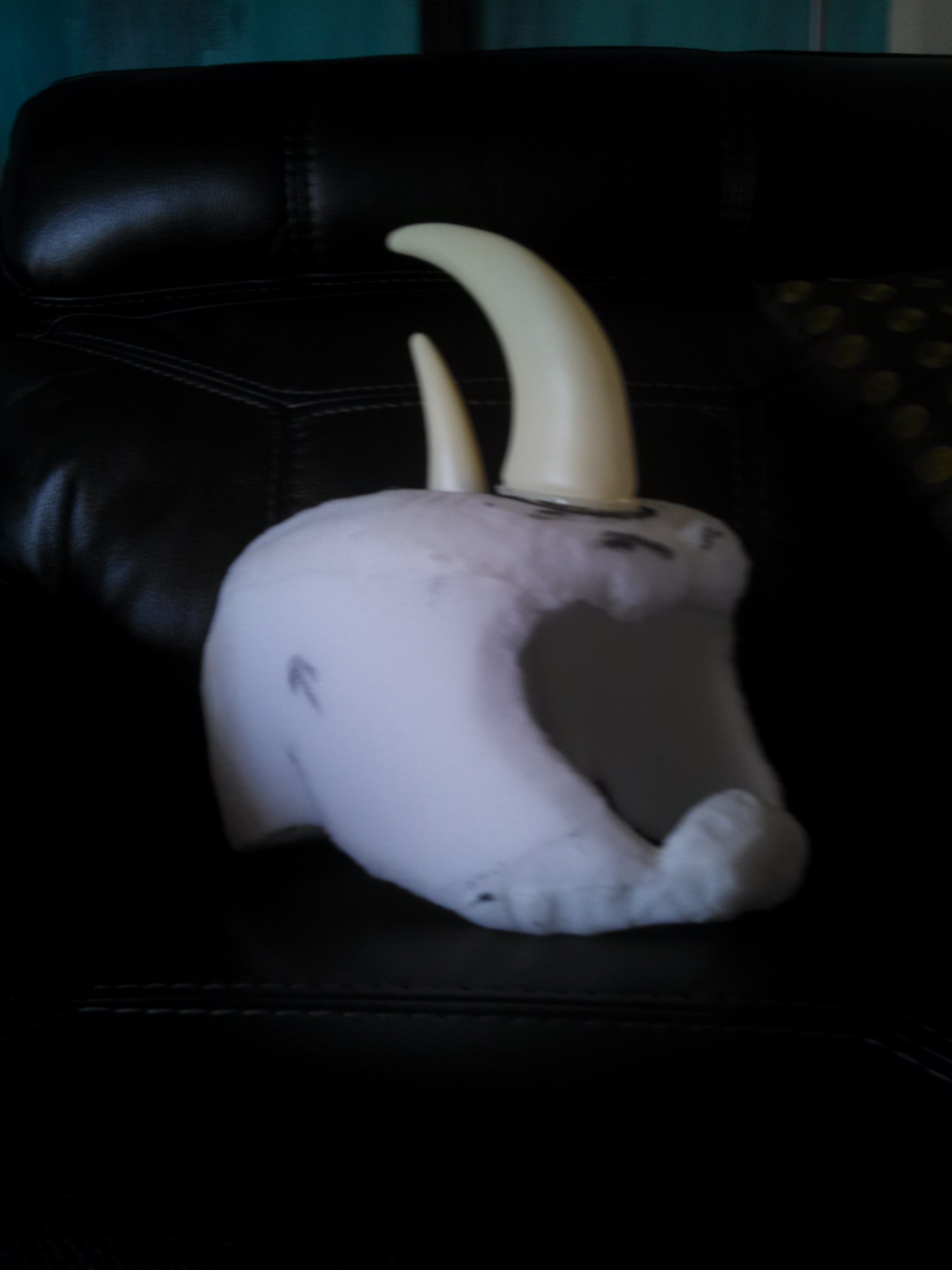

So, I started with making the helmet. This time around I wanted something bigger than just my head. Bulkier, larger, rhinoier (I made that word up), almost Juggernaut-esk. So I used couch foam similar to that of my first Costume. I glued chunks of 2" foam together with hot glue and cut it to shape with and electric meat cutter (yes, like the one Clark Griswold used in Christmas Vacation). I cut and cut until I got the rough shape I needed.

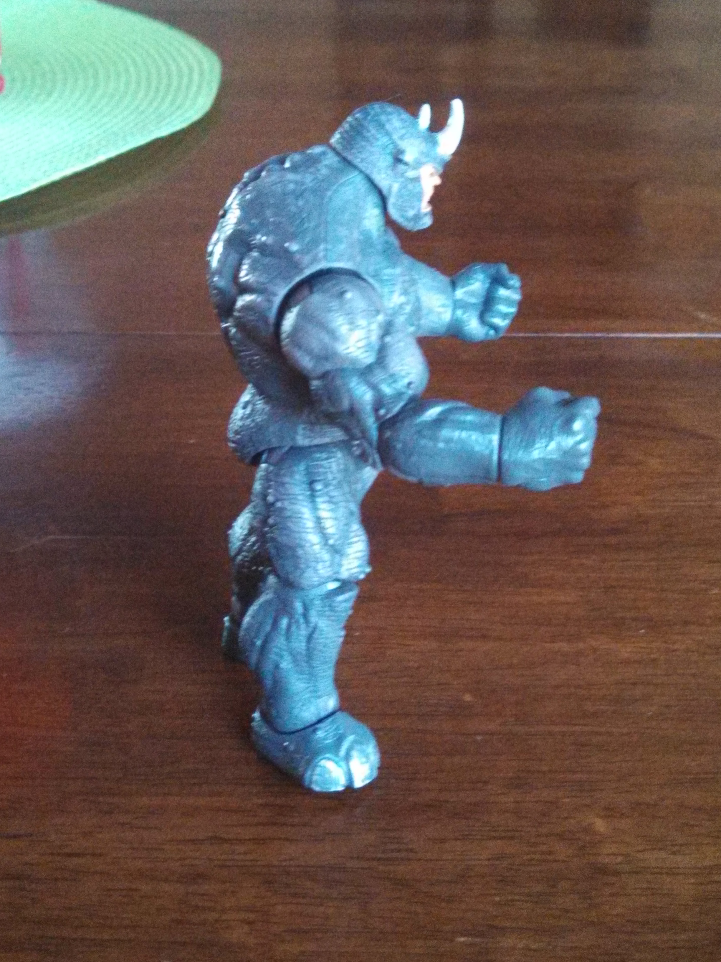

I continued shaping and added horns. I was going for a Rhino action figure / lifelike approach, not the Spider-Man 2 movie that made Rhino look like a Dinobot.

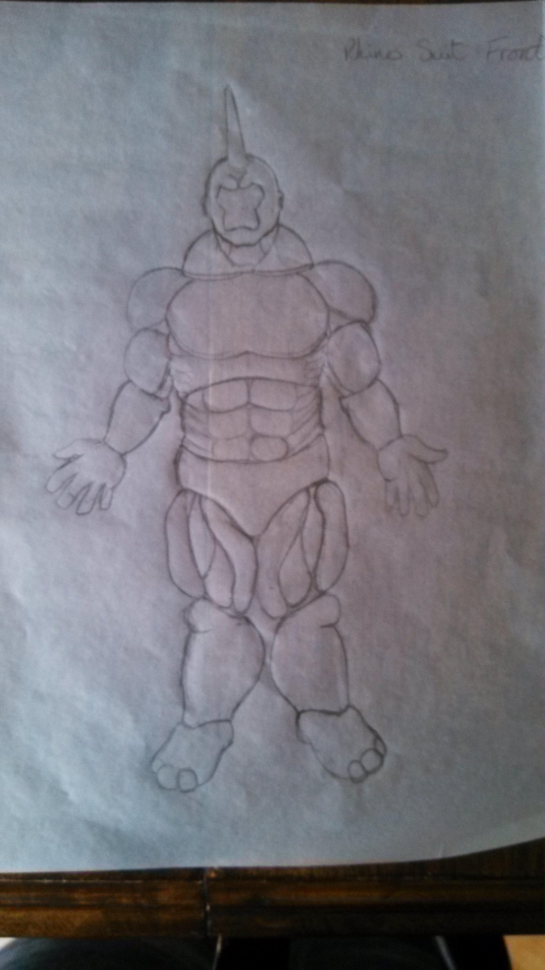

I drew up some sketches about were to go from here and did tons of research, Rhino, rhino skin, and cosplay muscle ideas. There is just not much out there to suffice. So I had to be creative and come up with my own and in some cases altered techniques.

I like where this is going. I would suggest defining the muscles with shading. If you have an airbrush it could do wonders for bringing out the foam muscles underneath. Great start!

Even your first one looks pretty great! I think if you can build out the foam musculature really well, anything you pull over it will look pretty amazing no matter what. Ditto with what Iggy said too, airbrushing the finish will step it up even more without having to get into the whole latex/rubber realm. Subscribed!

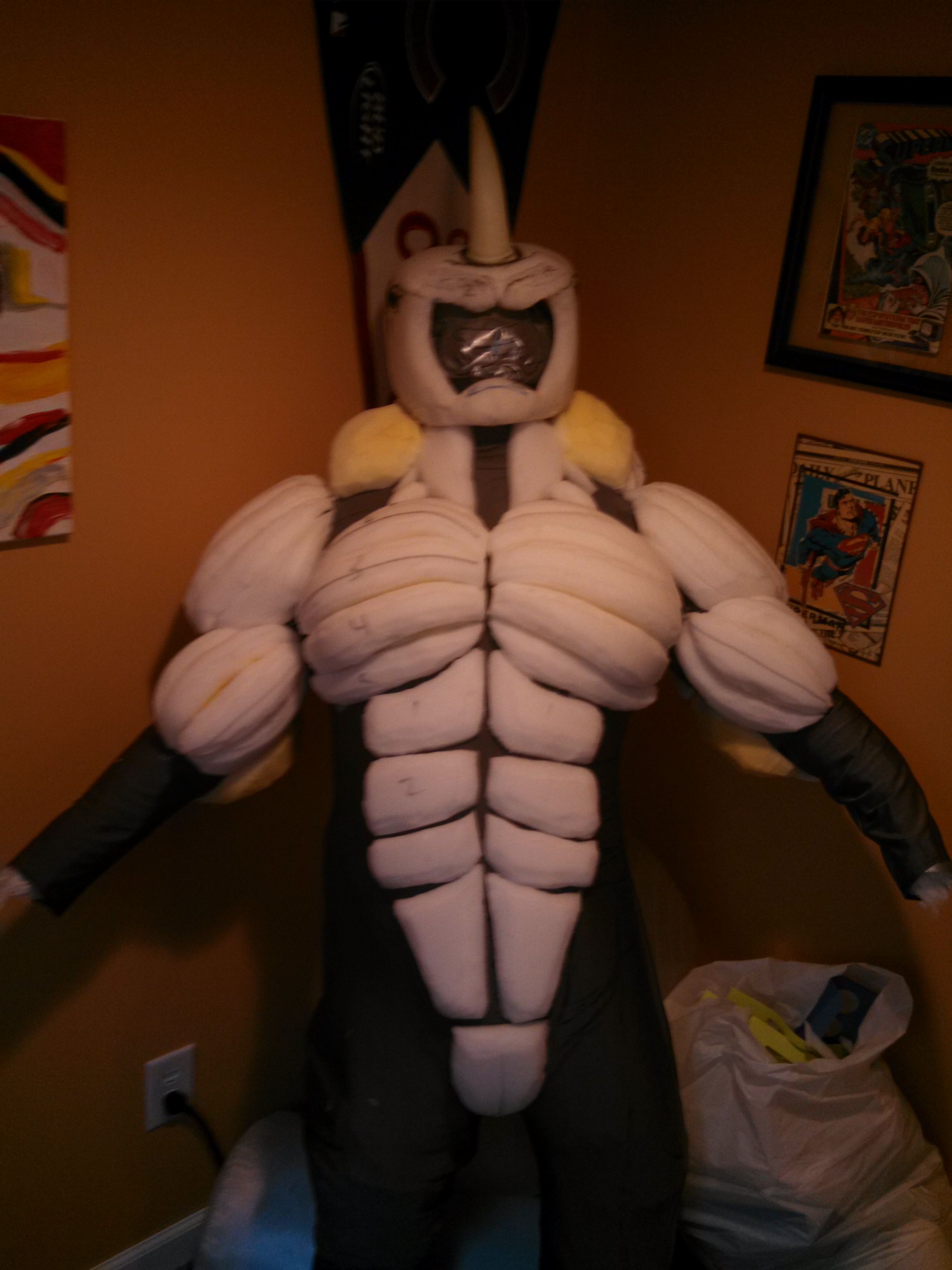

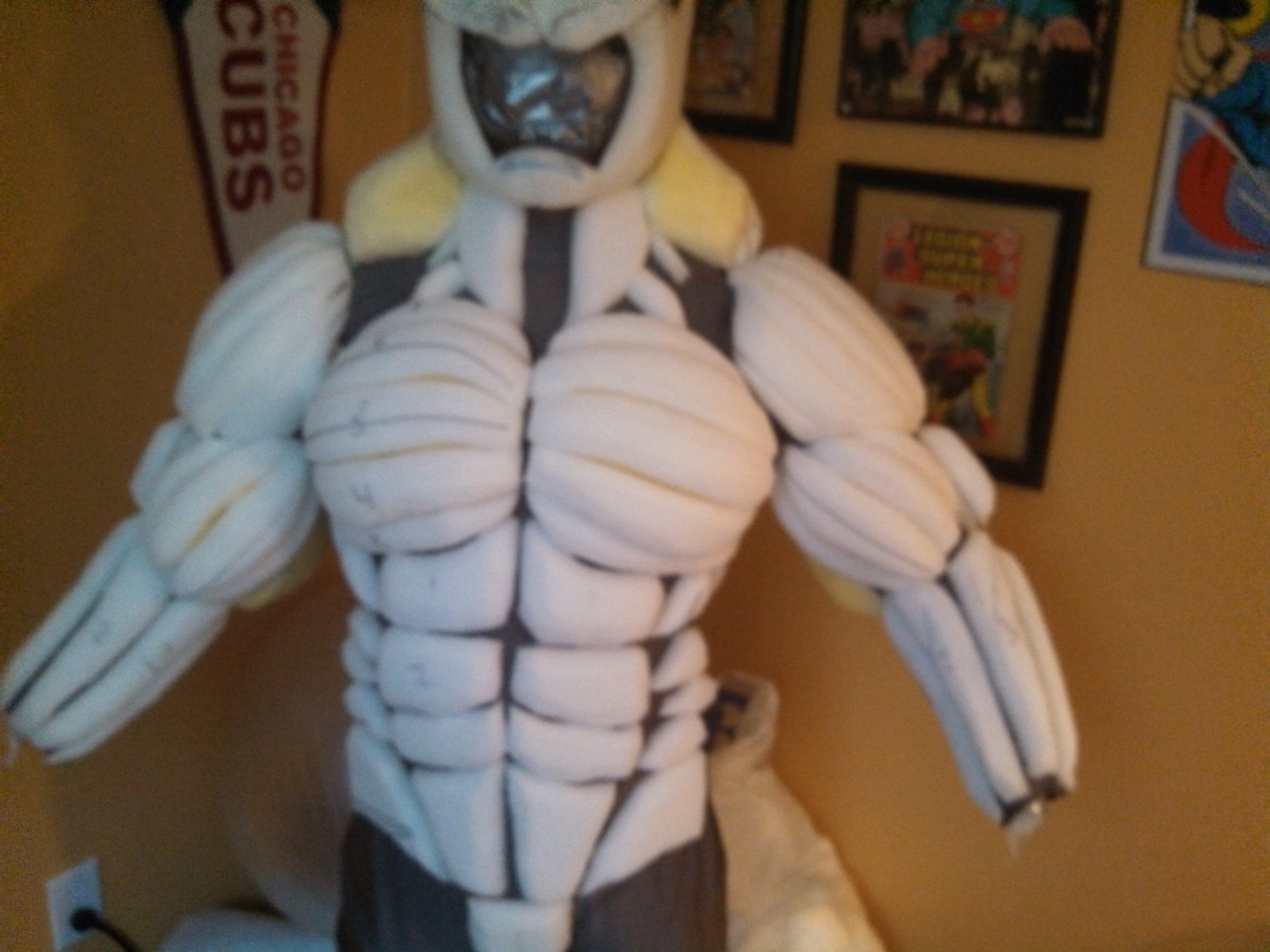

First thing is first.

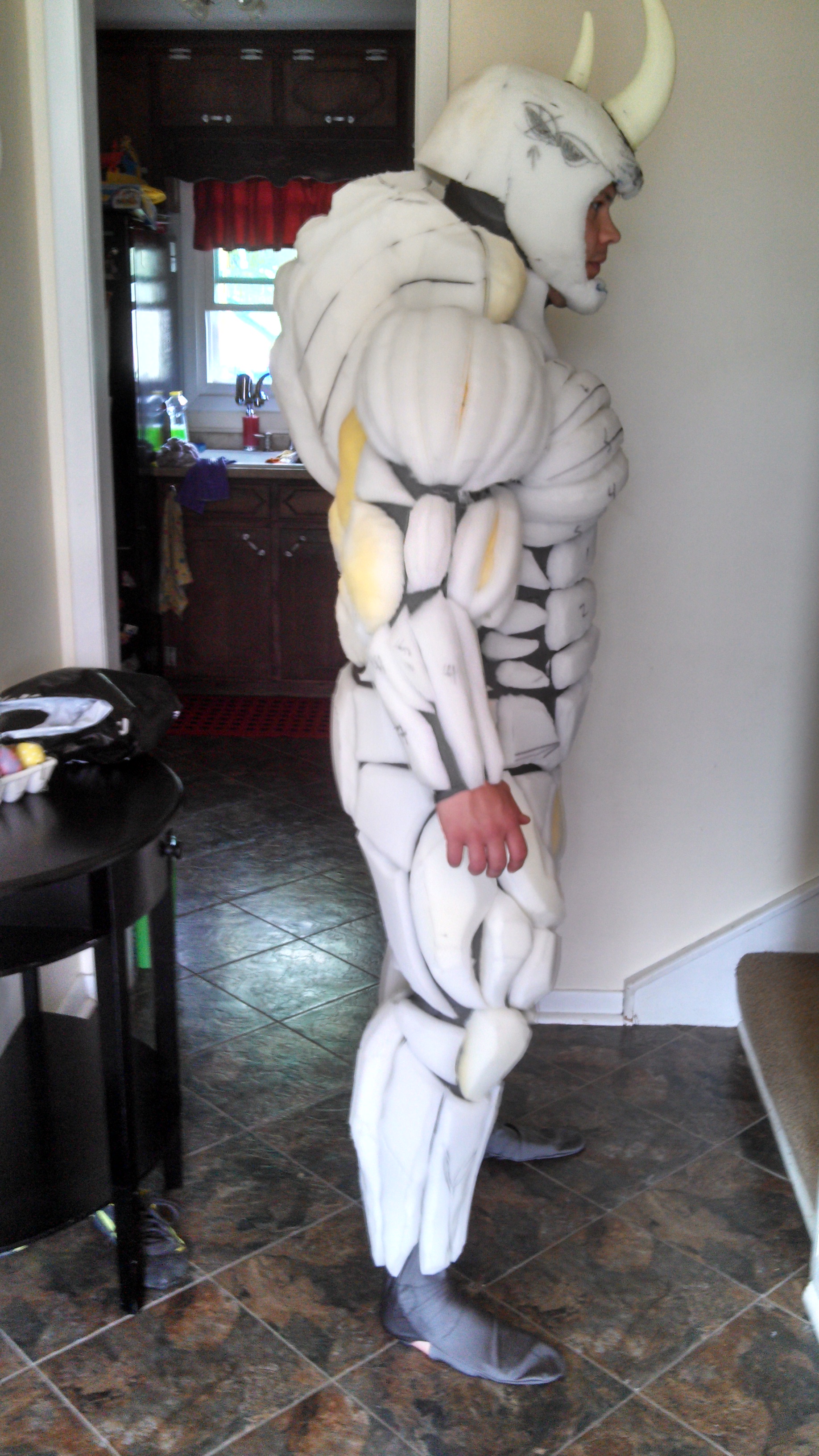

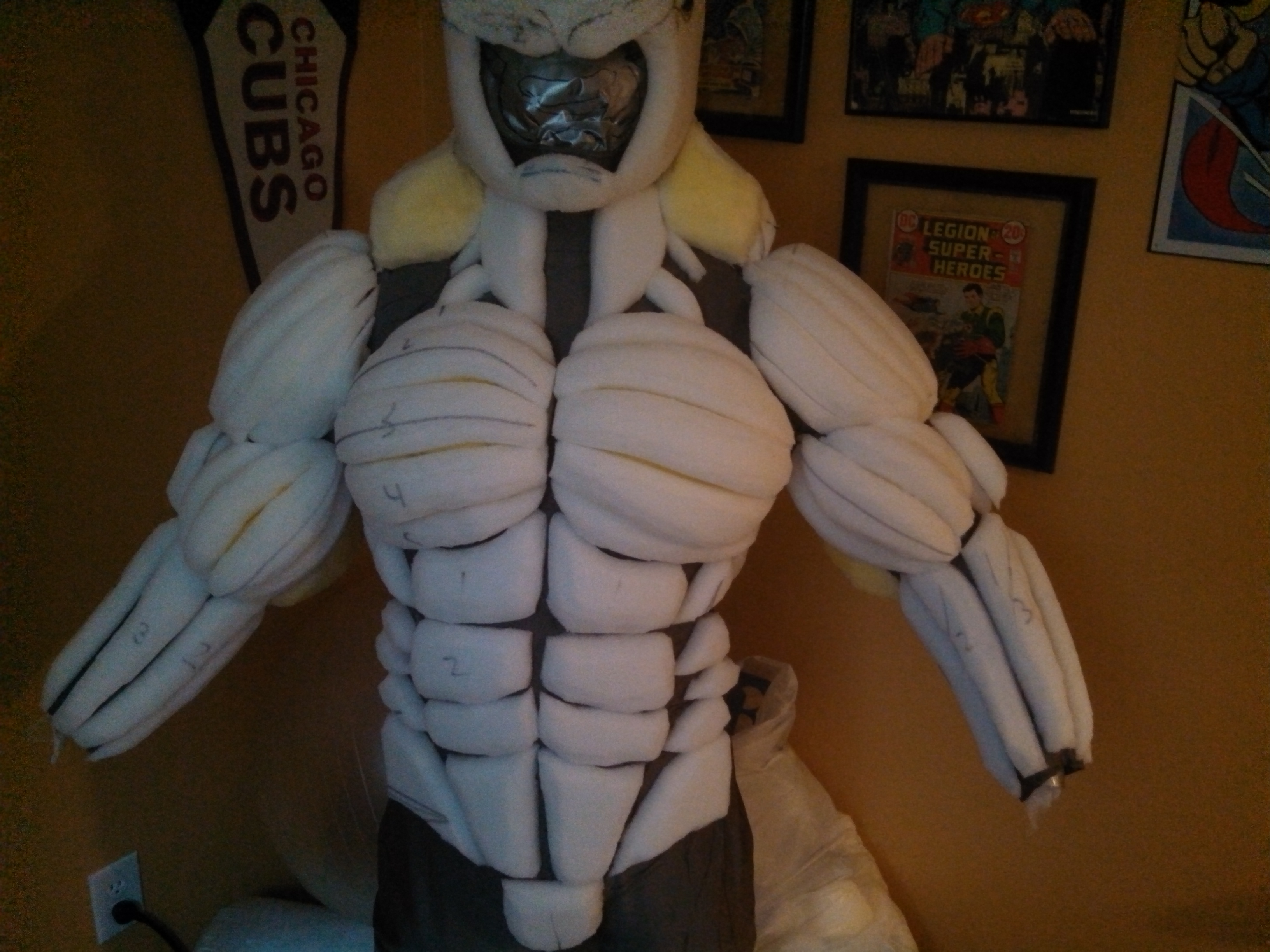

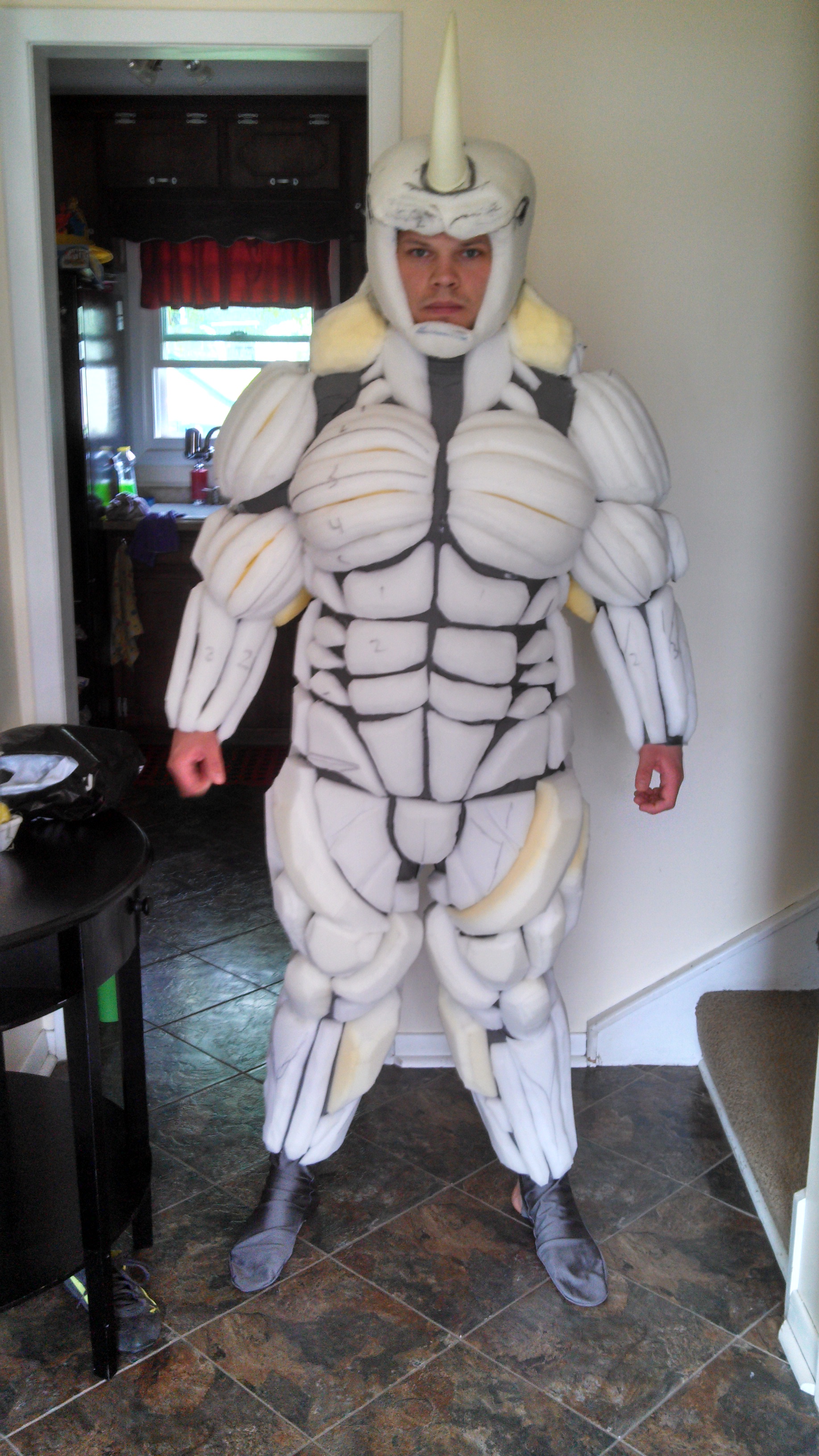

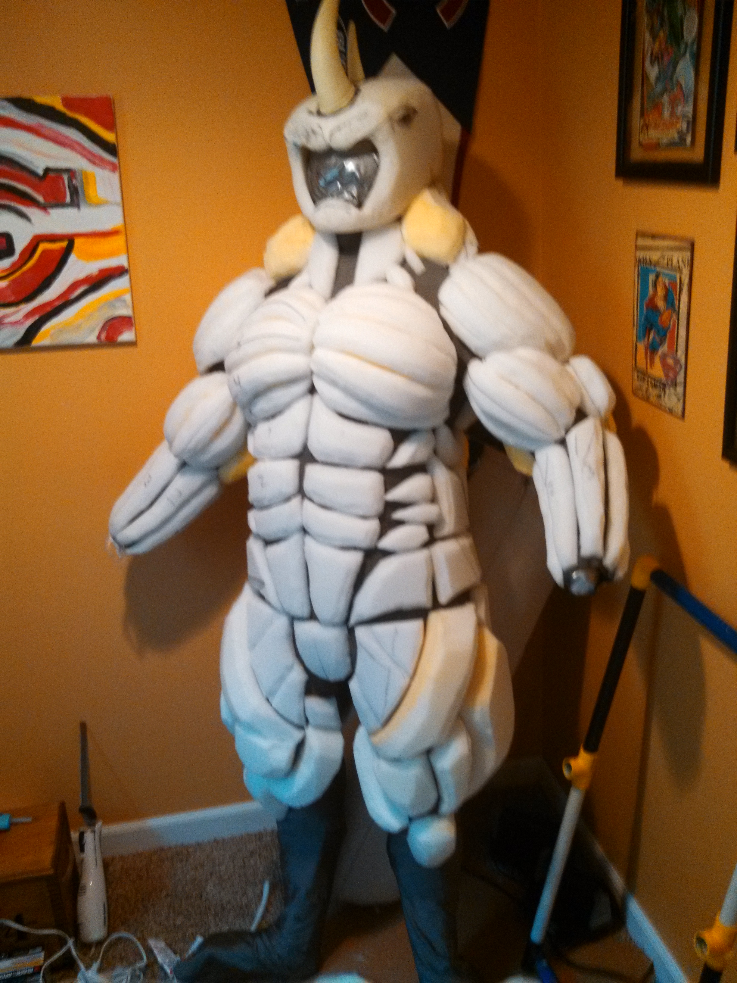

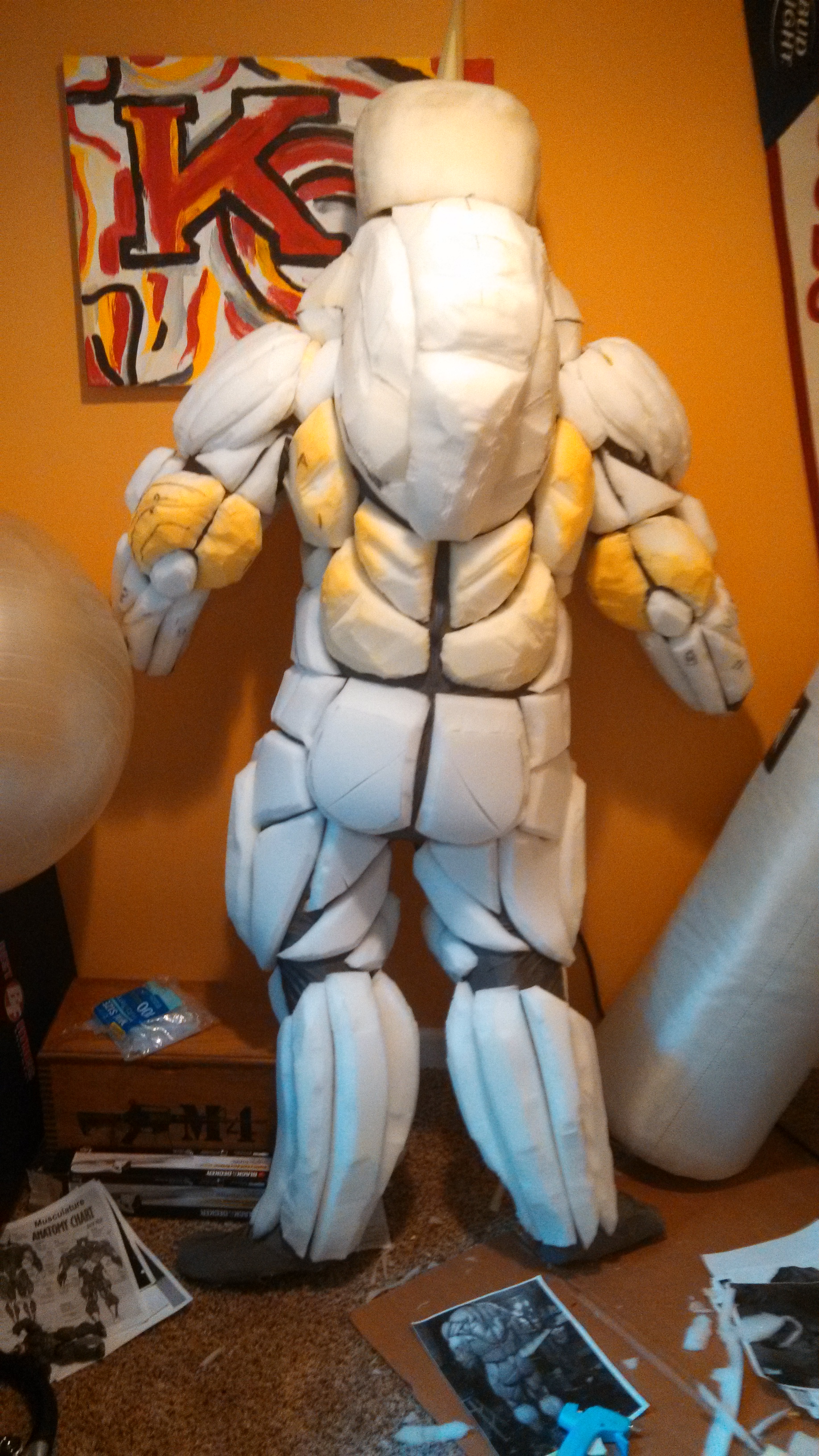

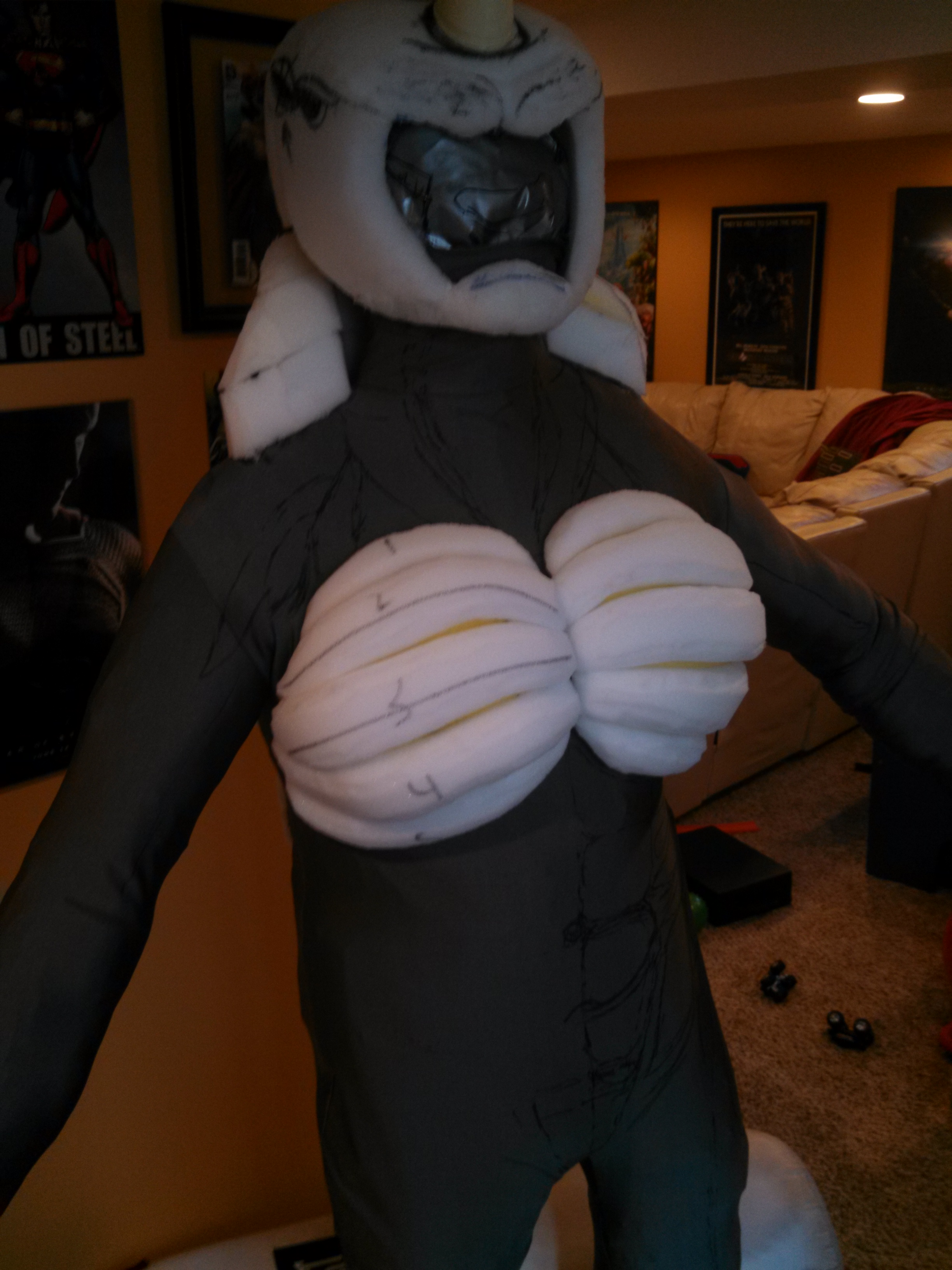

I began shaping muscles out of 2 inch couch foam and layering them on a grey Lycra suit that I had over a duct tape dummy of myself. This one piece suit is similar to the one that I put over my muscles from my first Rhino Cosplay I did. I had so much trouble finding inspiration online. But alas, I found it on Deviant Art http://mongrelman.deviantart.com/gallery/46036482/costumes?offset=168. I have to give props to this guy because we talked for a bit about his unique look into muscular costumes and how he achieved it. I took his idea and added my own ideas, keeping the suit flexible and cost effective (the spray foam Idea did not work at all for me due to humidity)
IMG_20140325_164433_305.jpg IMG_20140325_164427_256.jpg IMG_20140327_162538_498.jpg IMG_20140329_150722_929.jpg IMG_20140329_150750_692.jpg
IMG_20140401_114546_203.jpg IMG_20140401_173354_214.jpg IMG_20140401_173343_890.jpg IMG_20140401_173339_861.jpg IMG_20140401_173415_839.jpg

Iggy
This is amazing. Are you posting months worth of work, or is this being done right now? So far, this looks great!!! If you are covering the body in fabric, I would suggest stitching between the muscles to really pronounce them versus just letting the muscles barely show through. If you are skinning it with a latex then it will look like your muscles but won't breathe as well. A good example of skinning with fabric is flexdesigns muscle suits.
