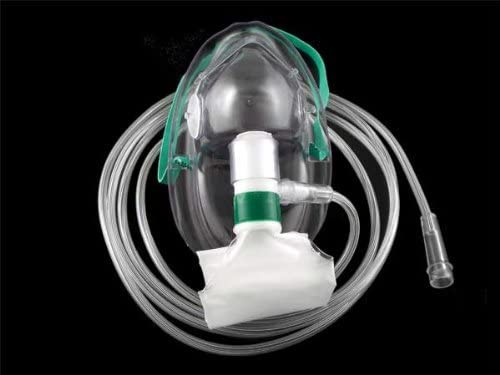

Hello, sorry to resurrect an older thread, but I'm trying to do a close-enough build of this prop and can't find some dimensions I need.
The Buffalo Filter smoke evacuation hose cited earlier in this thread has a listed diameter of 7/8" (doesn't say ID or OD!). Do the nonrebreather facemasks that people were using have a standard size outlet for that bottom tube? That measurement is never stated in the descriptions. Does the smoke ventilation hose fit the nonrebreather facemasks universally, or were people using adapters of some kind to connect the hose? My thanks in advance for any guidance you can provide. Cheers!

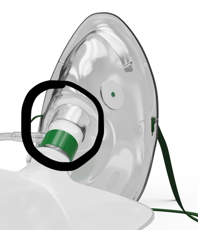

Just to be clear, so the adapter that goes from the bag and inserts into the bottom of the opening in the mask is 22mm? The smoke evacuation hose will slip over that? That adapter has a nipple on it for the thin oxygen tube - do people just dremel that off?
This is the closest mask I could find in the uk. The hose just slips over the top. The part of the mask that connects to a smaller tube can just be pulled out.

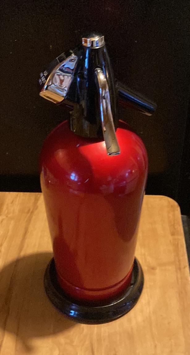

I’ve joined the club
I noticed you can get the original lever to close close to the body if you remove the plastic piston.
The piston kind of looks like the DV6 d ring cap too lol

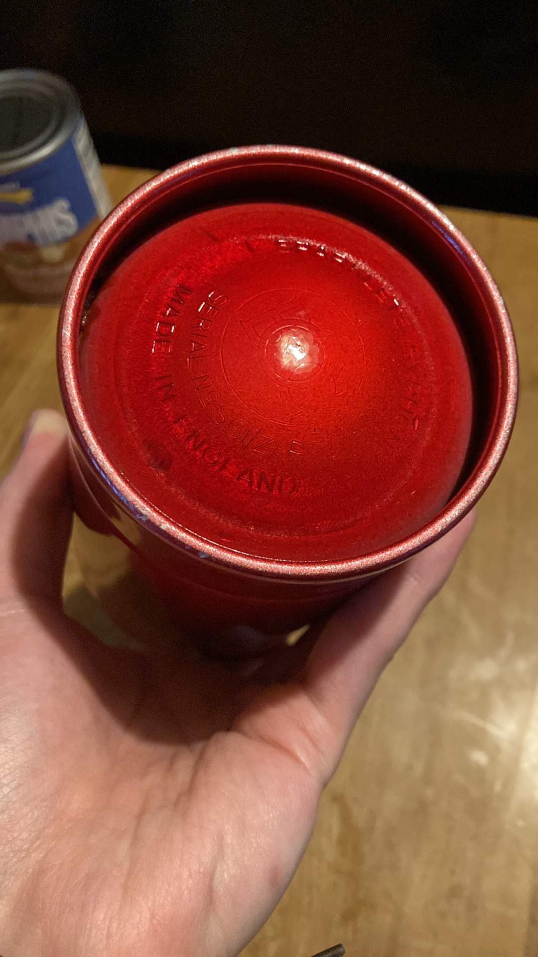

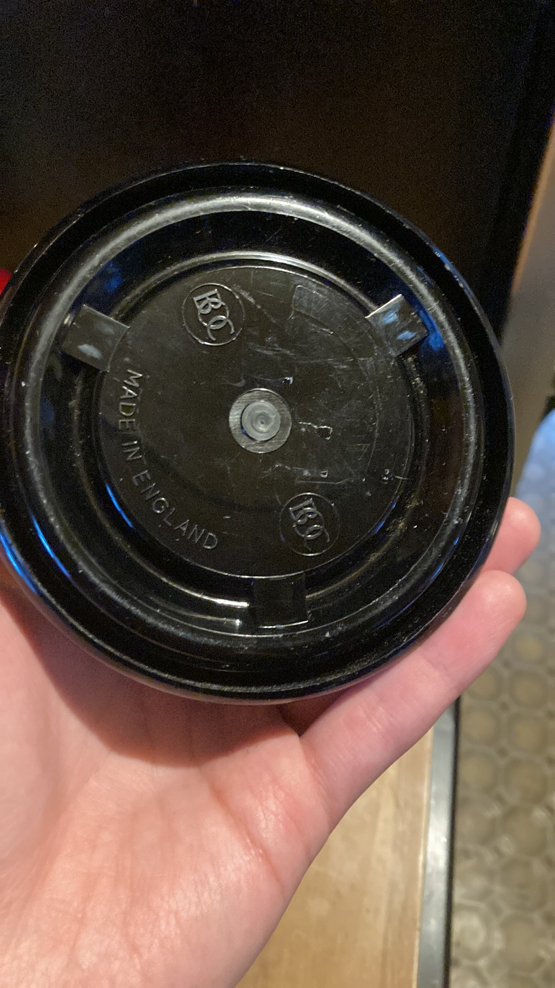

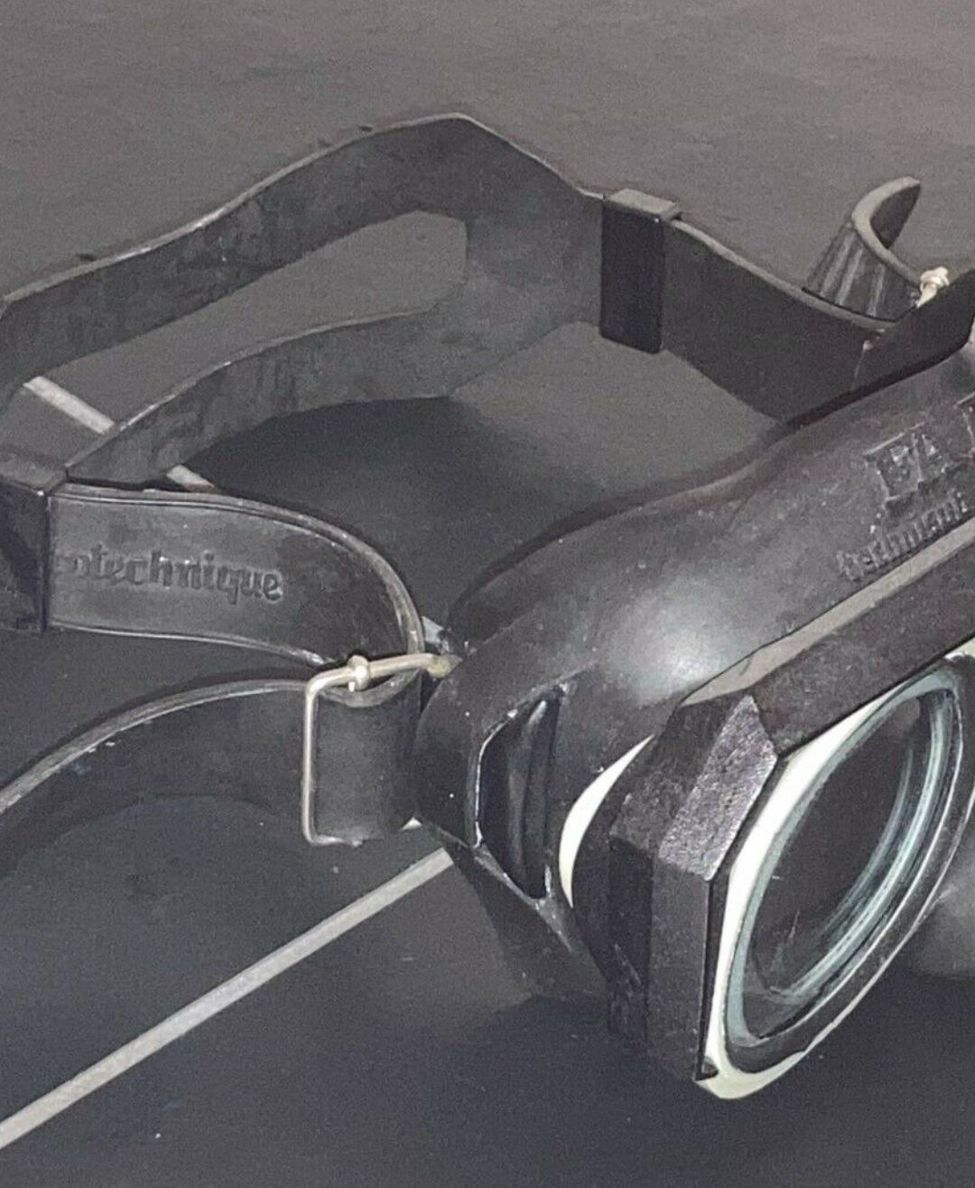

Hi all!
Anyone can help me to find a good cast of the black part?
I think it comes from a scuba mask
( spirotechnique???)
Thanks!!!
