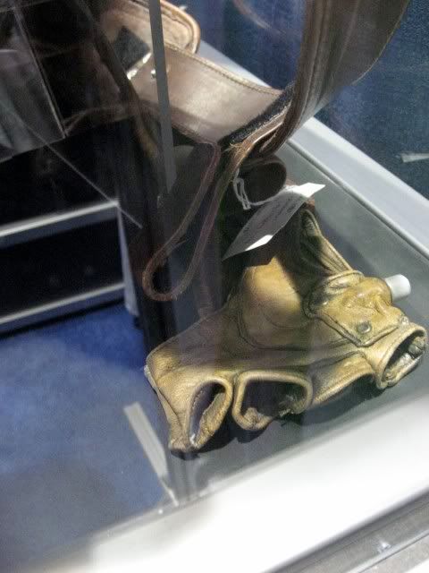

A little tip on the gauntlet buttons, you'll have to choose if you want to run electronics in your pack or not. What I found is you'll need to modify- ie cut the buttom off the button and resolder the wires. Otherwise you get this huge bump in your palm and won't be able to hold on to anything. On my current pair I just cut off the bottom and mounted the top buttons, which still go up and down. I built inner brackets out of metal for strength. The buttons, I cut down enough for the threads to still poke through the bracket to tighten with nut that comes with them.
If you need any more pix let me know!
- Jeff
aw man! i was hoping i could wire it up, one hand was going to be lights the other was going to be the fan!
just to make sure, you modified the button by cutting off the bottom bulk and modified it to still be electronics ready?
As far as I know those are the stunt gauntlets. They don't have a mounting bracket for the buttons, it's more of just a leather pouch. Also has a Velcro wrist strap and not leather with a snap. My prototype's had the velcro and then switched to the snap on my current ones which still need to be redone to get them closer to being accurate.
- Jeff
Mine are not currently set up for electronics. I am still working on a set for Moffeaton, yes they are still on workbench Moff, and trying to figure out the best way for them to be wired up and not bulky. He sent me buttons all wired up but they're still to big for the glove. I'm redoing my top gauntlet pattern soon to fix it.
