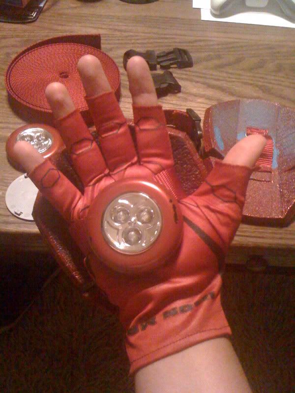

First up is the hands. here's what i was working with:
Strapping, buckles, gloves, foam gauntlets, and LED taplights from walmart painted red.
First i wanted to secure the gauntlet. i took a small strip of the nylon and hot glued it to the inside of the foam, essentially forming a belt loop. Then, i measured out a piece of nylon that would fit around my hand and attached buckles. Very easy, hot glue works great on the nylon strap, just run the strap through the buckle loops, then glue the strap onto itself to close it.
Next was figuring out how to secure the repulsors...aka taplights, to the strap. In this pic you can see that the back of the taplight is a simple twist and lock. Rather than try to secure the light to the strap with velcro or glue, i simply put the strap through between the taplight and it's plastic back, and forced it to close. Secure.
So this is how it all turned out:
MUCH more secure. The strap holds the gauntlet and the repulsor firmly in place, it's comfortable, it just slides down over the glove and stays snugly in place.
