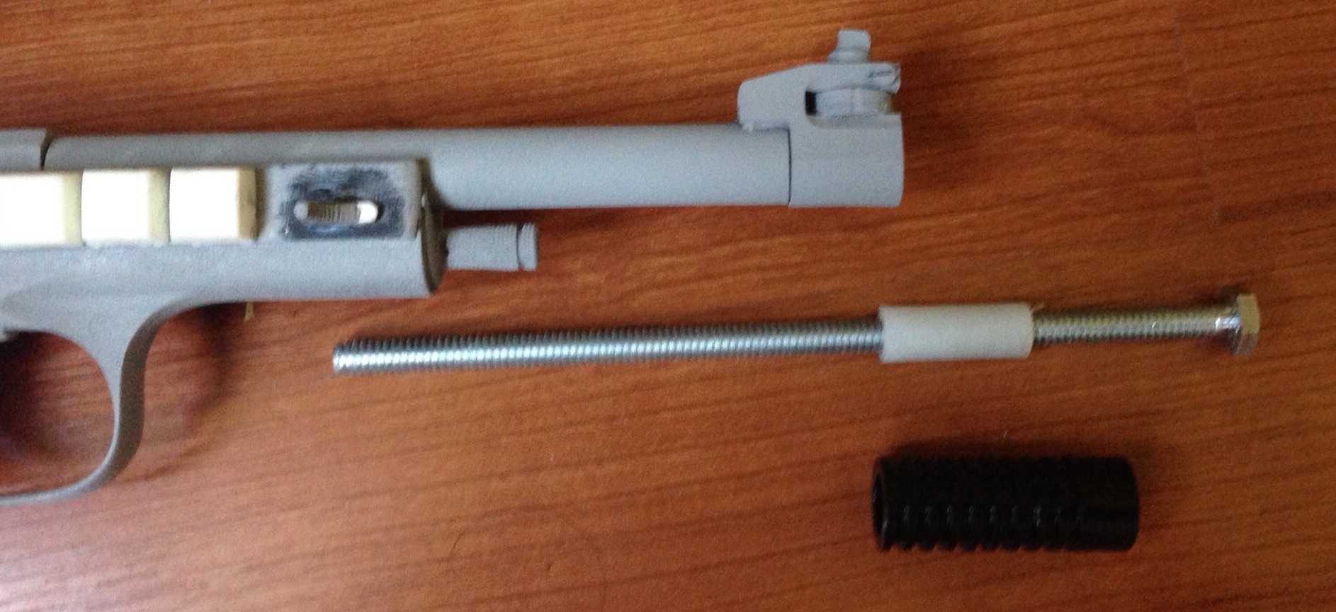

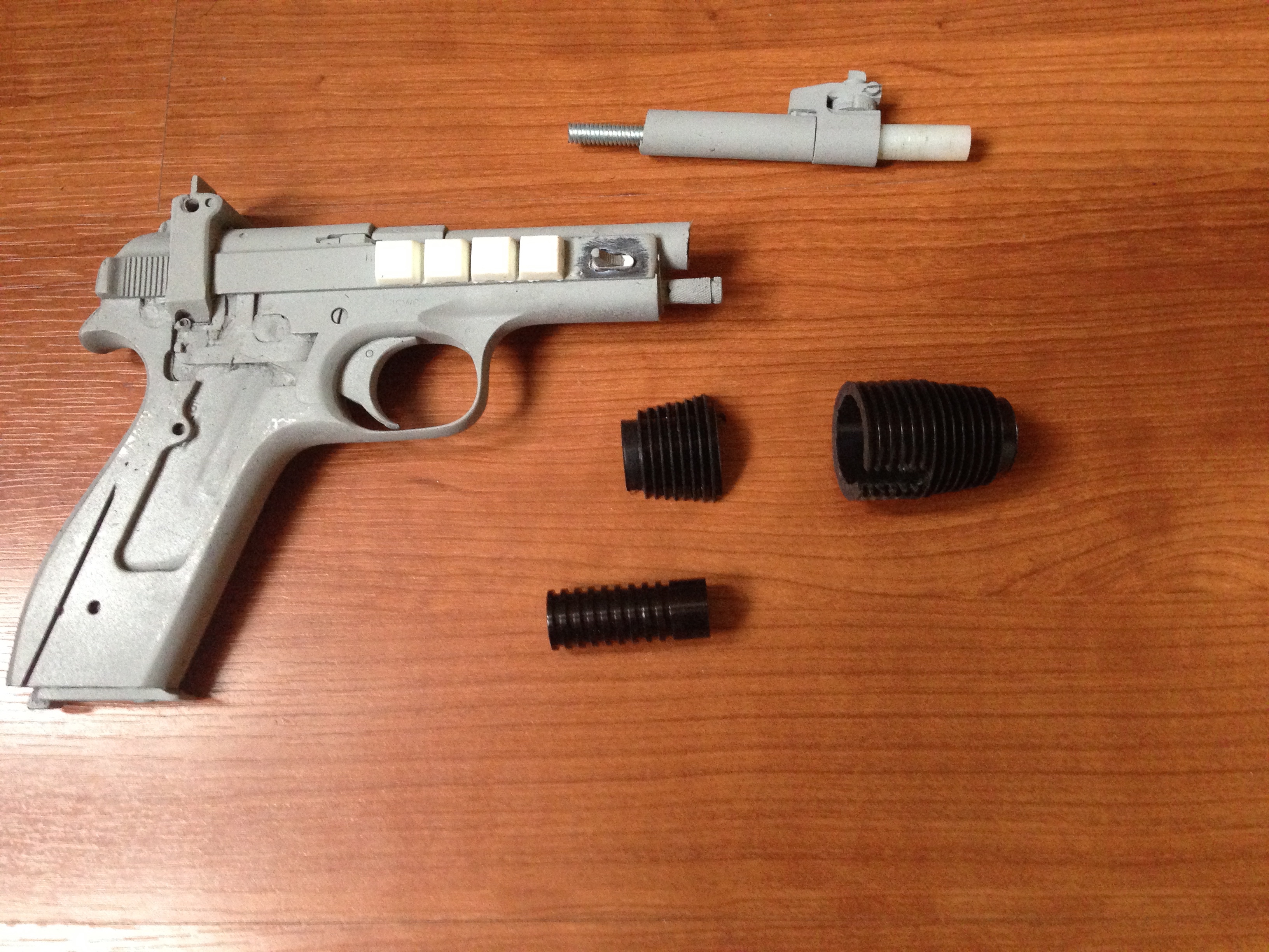

Here is where I am at with the build:
I still need to find some screws for the grips but that will be the last thing I do. Right now I just have a layer of filler primer as i wanted to see how the clean up went. The toughest part was cutting out the area where the hammer is. Its came out pretty decent considering I freehanded it with a dremel. I also had a hard time getting Bondo to adhere to this material. I tried 2 types. I finally just used super glue to fill the small air bubbles.
The little release toward the front went on crooked. I may try and fix it. I most likely will have to slice it off with an exacto knife.
I will most likely cut off the barrel where it meets the body so that I can slip on the grill. the cut will be hidden under the grill so it should not be an issue.
I am still looking for something good to use for an adapter to add the muzzle.
The grips are cast in black plastic so I do not have to paint them.

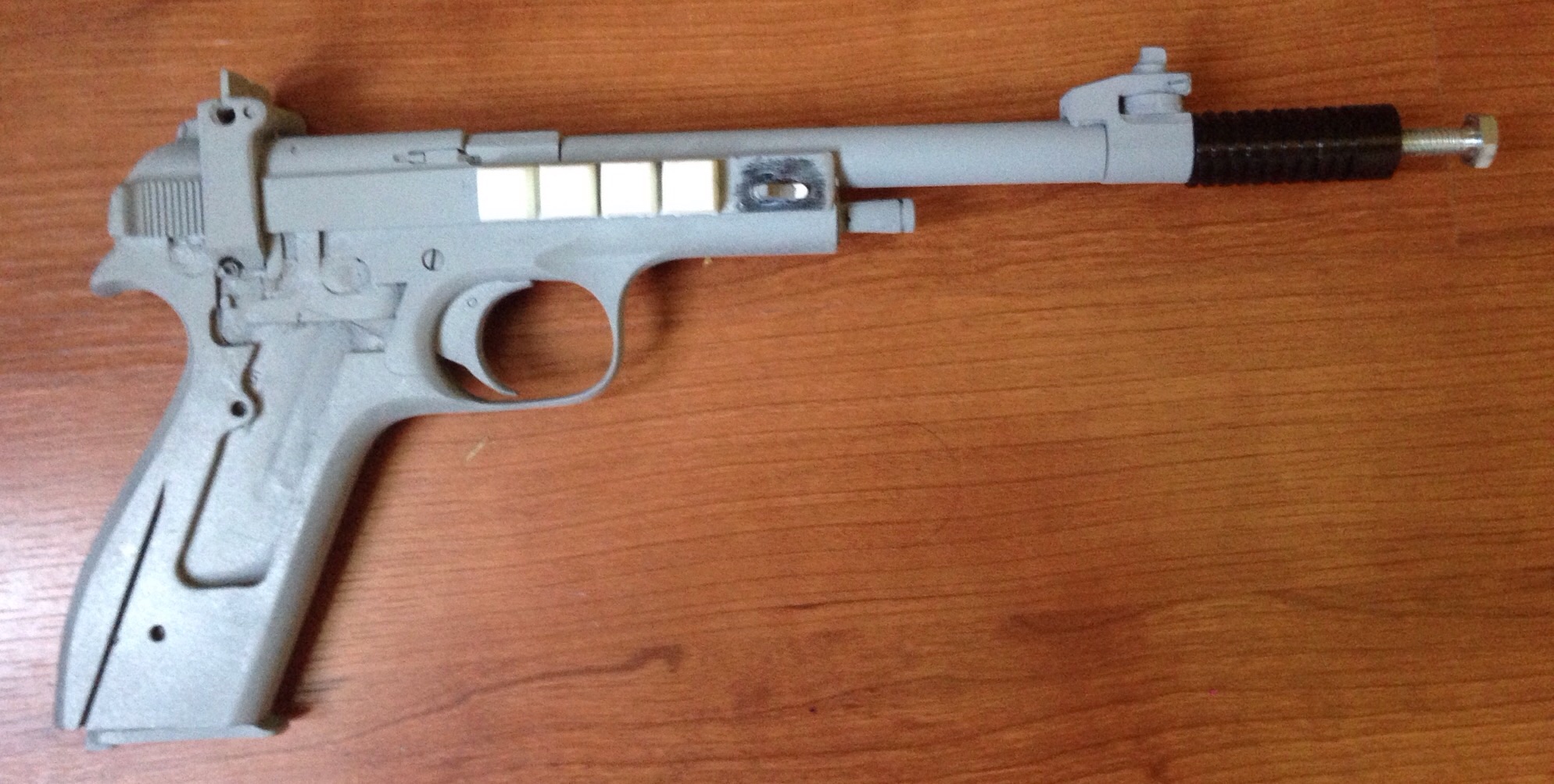

The only thing not straight is the release switch on the front and that's only because I glued it on crooked. Otherwise it is a great cast. However it is quie easy to drill. I drilled out the muzzle and used it on my other A New Hope version. And as mentioned, I dremmeled out the hammer well.
Re: LEIA ADDED! Blasters on the bench: Greedo, DL-18, GK, Droid, E-11, DH-17 more
Maybe drill out the barrel back into the main body before you cut it off. Run some tubing through to act as a spine to keep the barrel from getting snapped off and also to mount the muzzle on at the other end...
--Jonah
Yes, that's a good idea. I am considering some sort of heavy but thin rod down the barrel for few reasons.
1. As you said, it keeps the barrel supported.
2. Added weight
3. With the barrel predrilled before I cut the barrel off to add the grill, the rod will make for a nice guide to glue the barrel back in place.
and you're right, it would also help the muzzle mount.

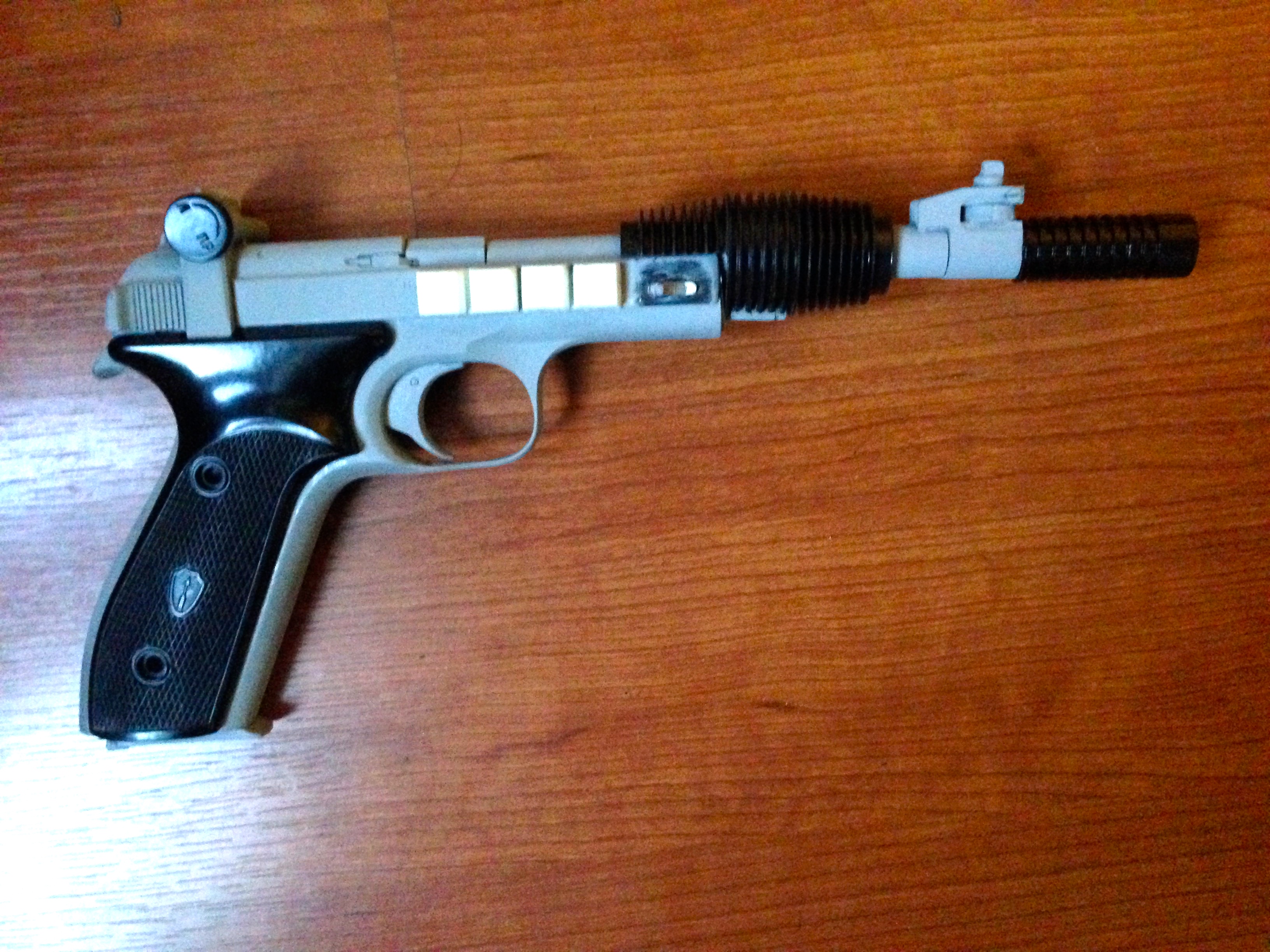

Got to do some painting today. Unlike the A New Hope version, this one will have some battlefield weathering. My preferred weathering technique is to do a base layer of silver which I will later expose by slowly wet sanding the top coat (black) on certain edges. Here it is with the silver coat:

Just a quick shot of the first layer of flat black added with the black plastic grip in place. I wanted this shot so I can compare the coloring of the item after the graphite powder coat is added.
