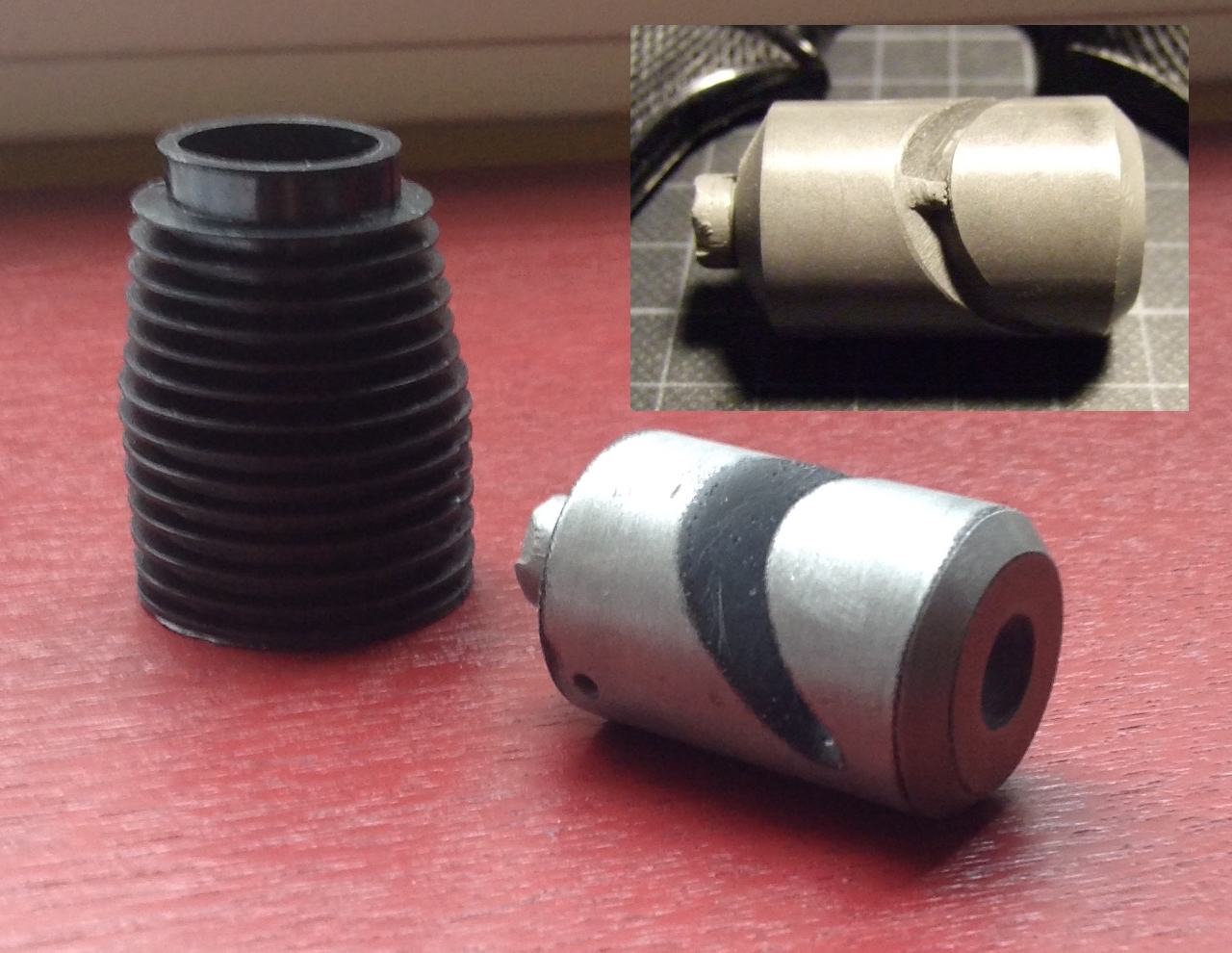

I have parts coming/in work for both Leia blasters. In the mean time, I started working on the muzzle cast that Markus sent me. I was concerned about my ability to clean it up correctly but I am pretty pleased with the outcome. This will be replacing the muzzle on the Rubies blaster.
Re: LEIA ADDED! Blasters on the bench: Greedo, DL-18, GK, Droid, E-11, DH-17 more
Was the Rubies Leia's blaster muzzle that off? It looks pretty accurate on mine.
I don't think so but the grill/tomtit part is and I want to change that out. So I would have to cut that muzzle off. At my skill level, I worry about making the cut clean enough and marrying up to the new grill. This makes it a little easier for me.

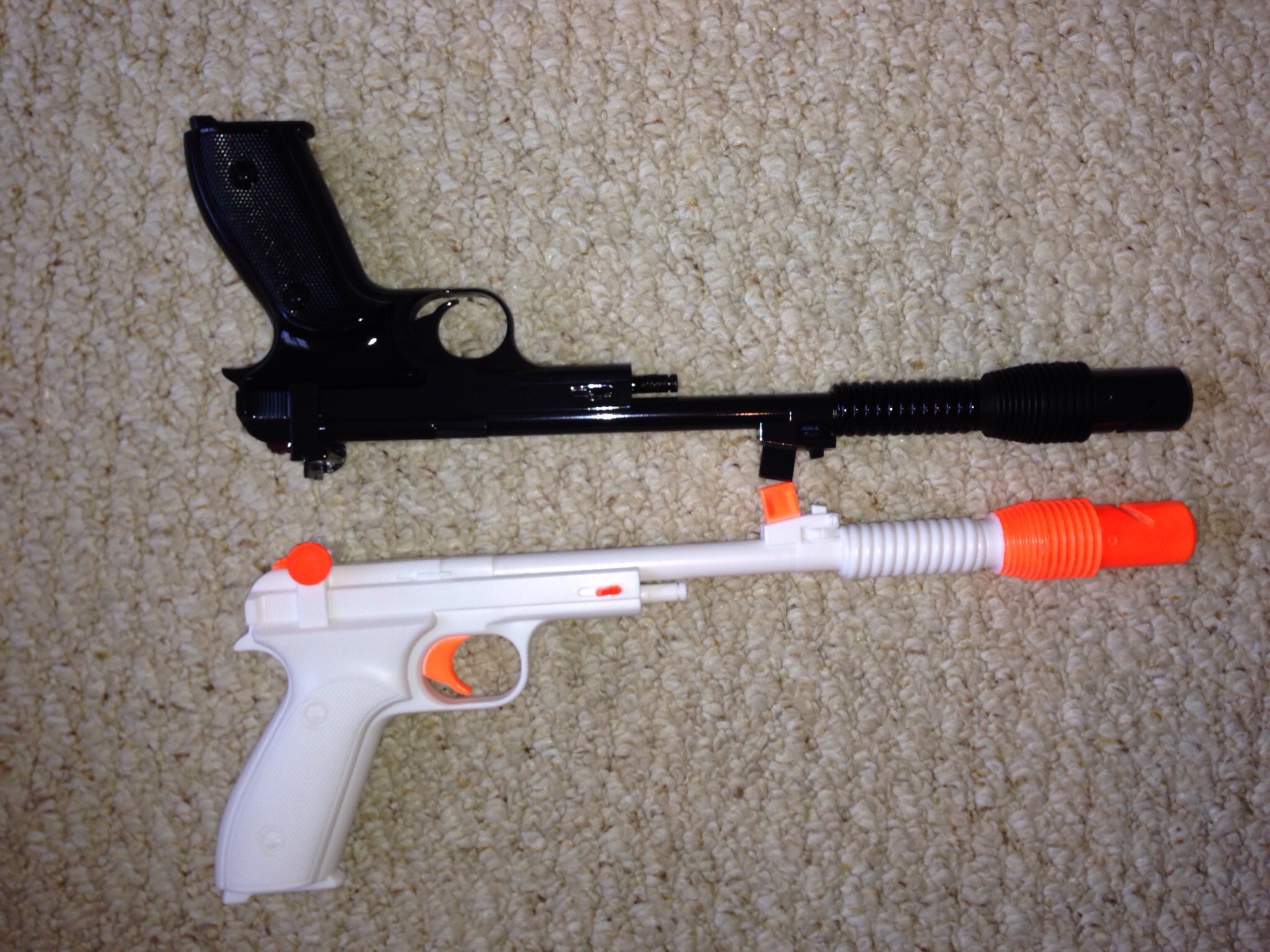

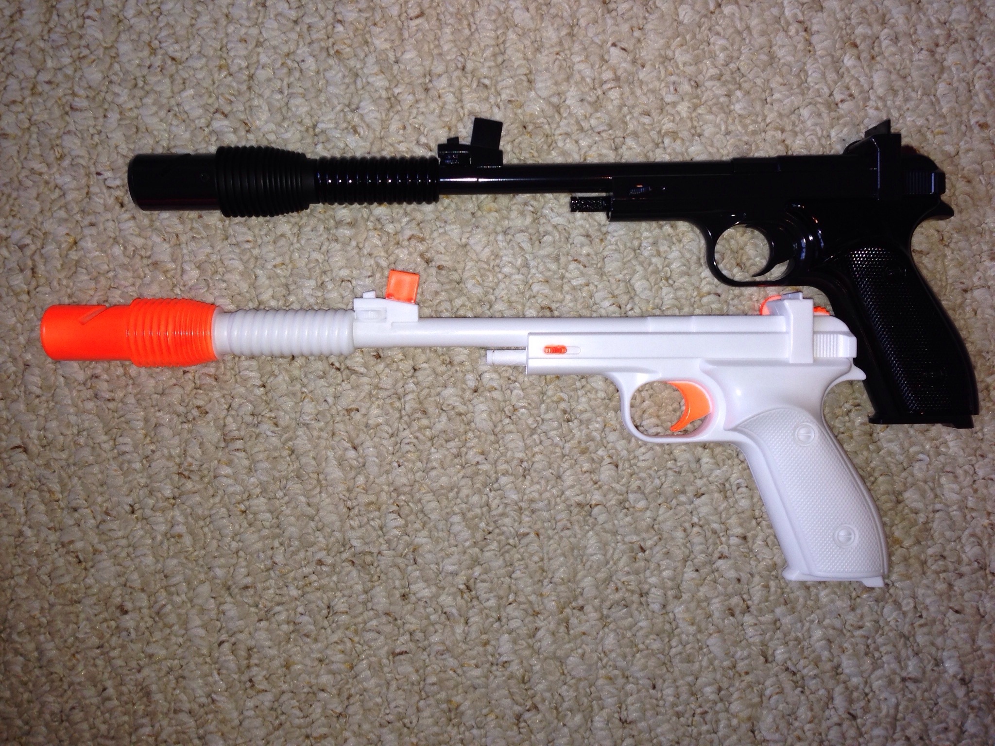

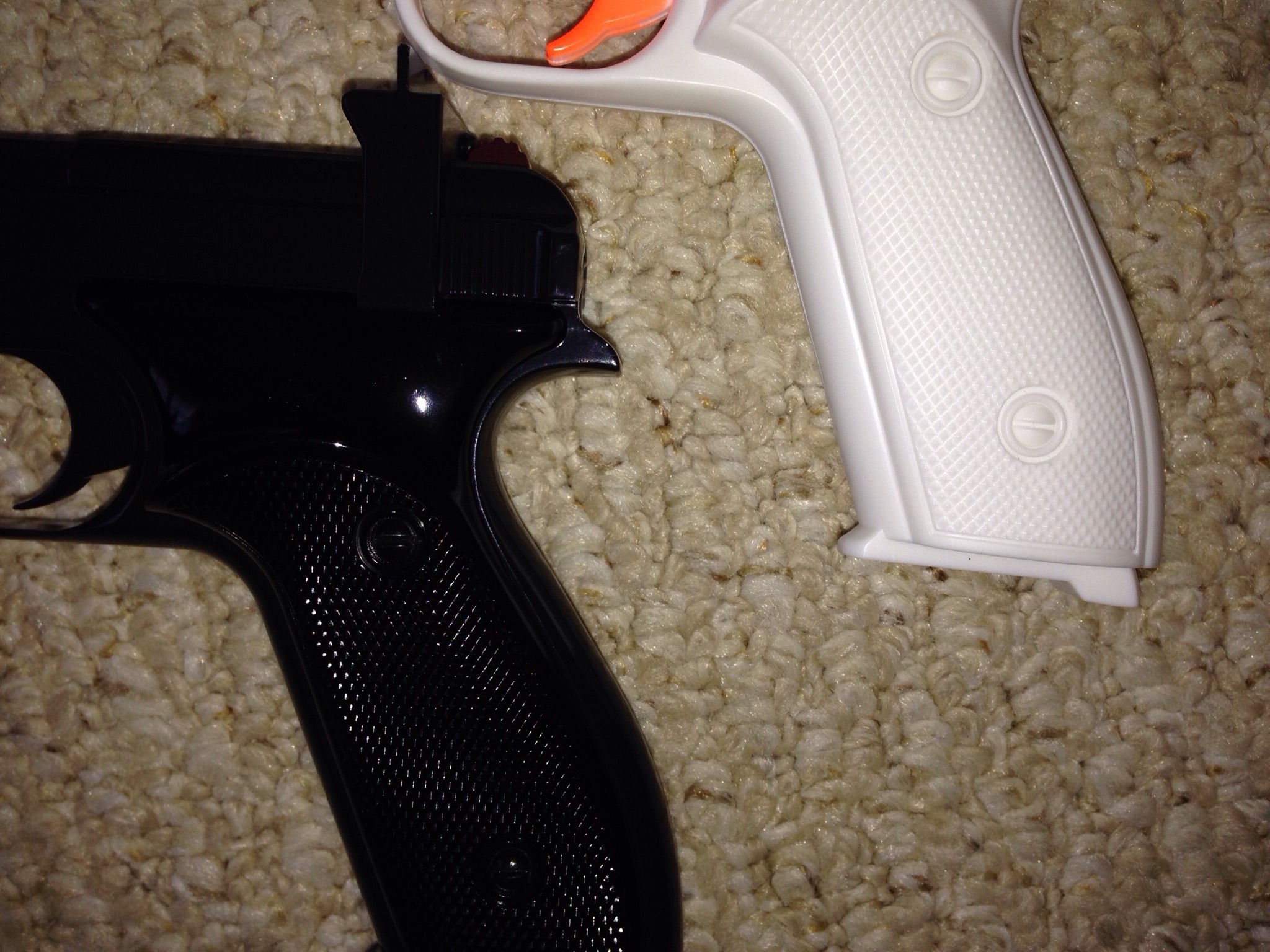

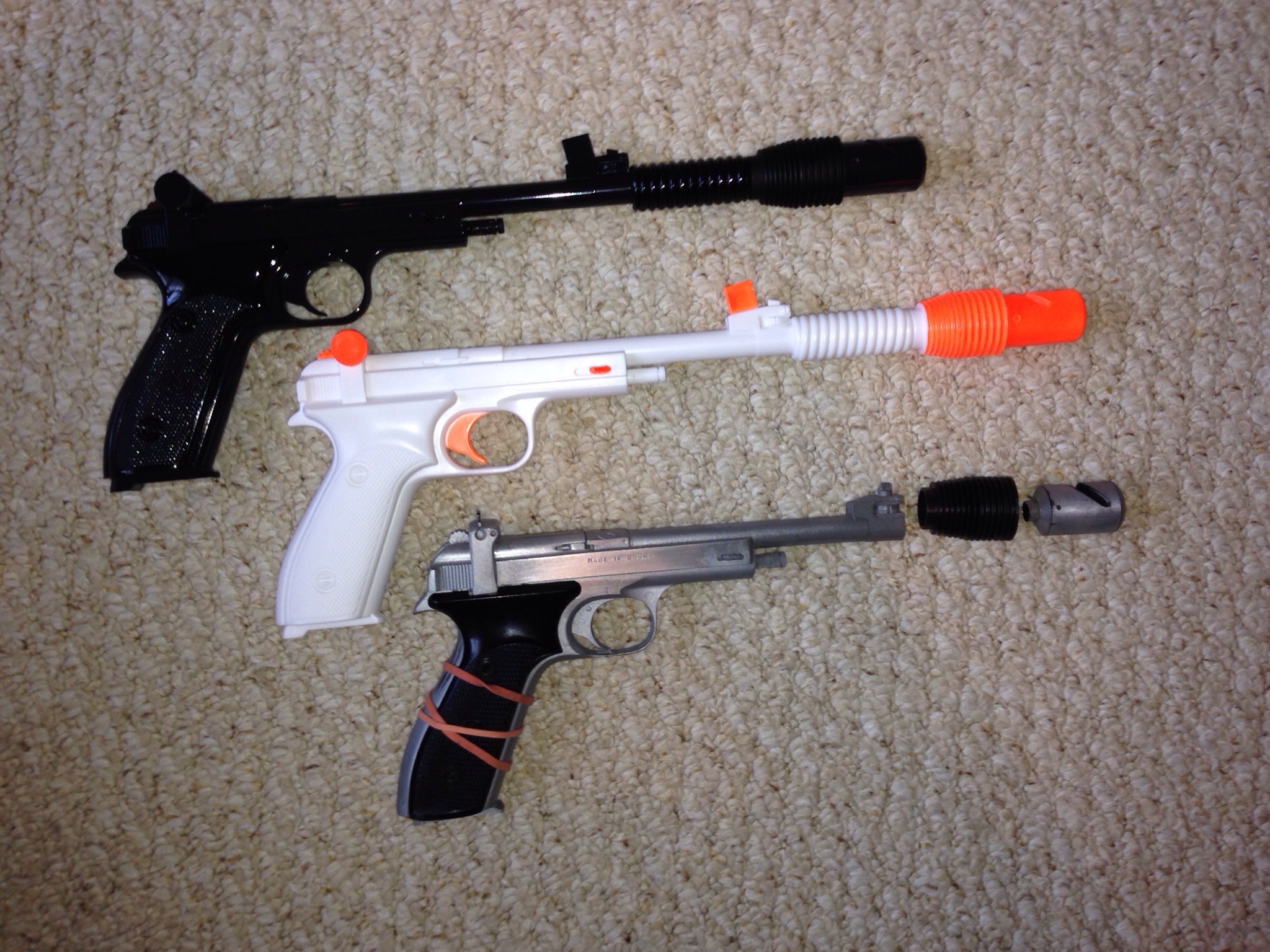

I thought the grill/tomtit looked pretty good too. Shows how much I know about the Leia blaster. I would love to see
a side by side photo of a Rubies and a MR Leia blaster. I'm just going to drill out the barrel opening a bit, sand it and
paint it. Maybe pour is some resin into it to make it a little heavier.

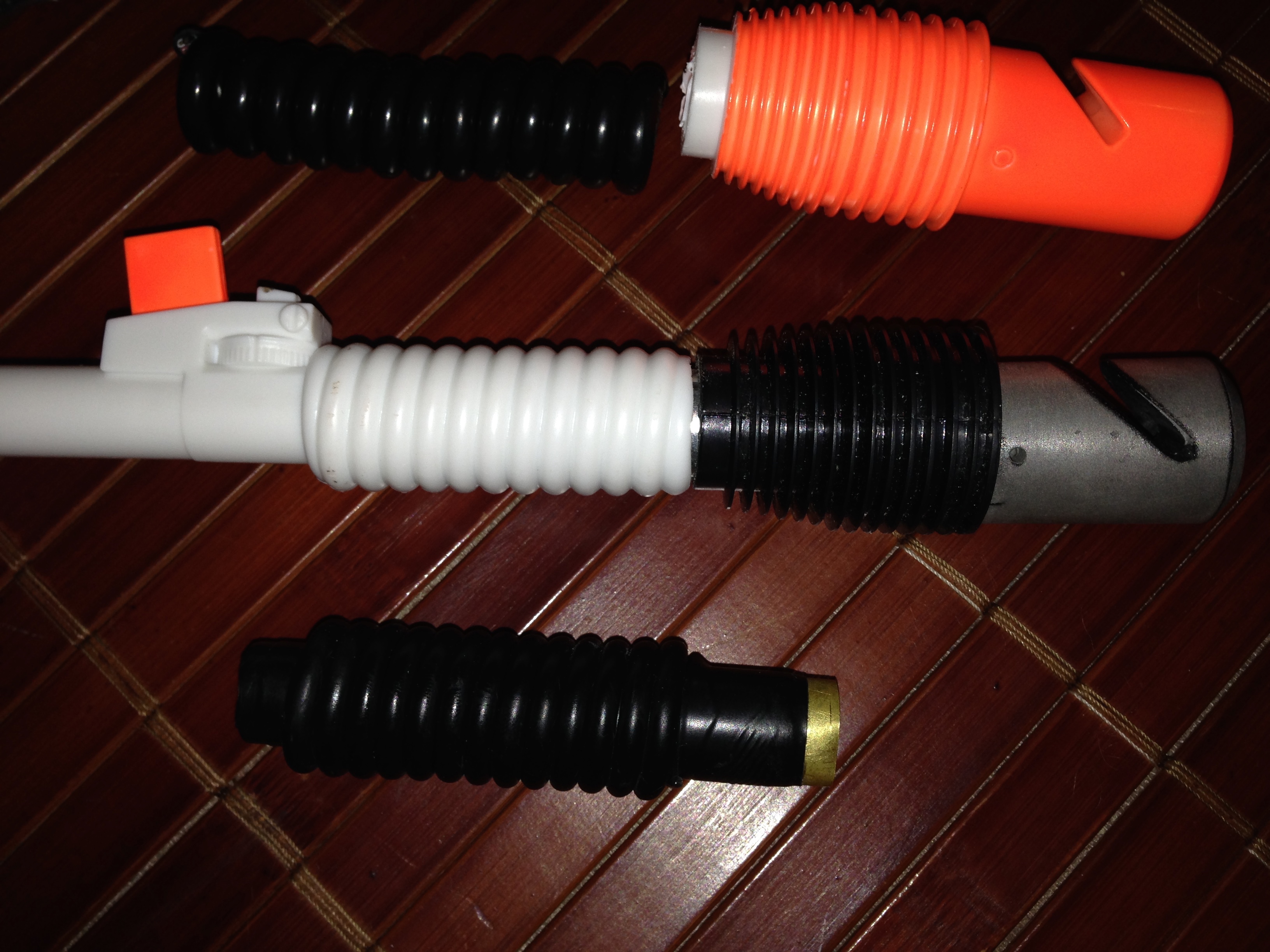

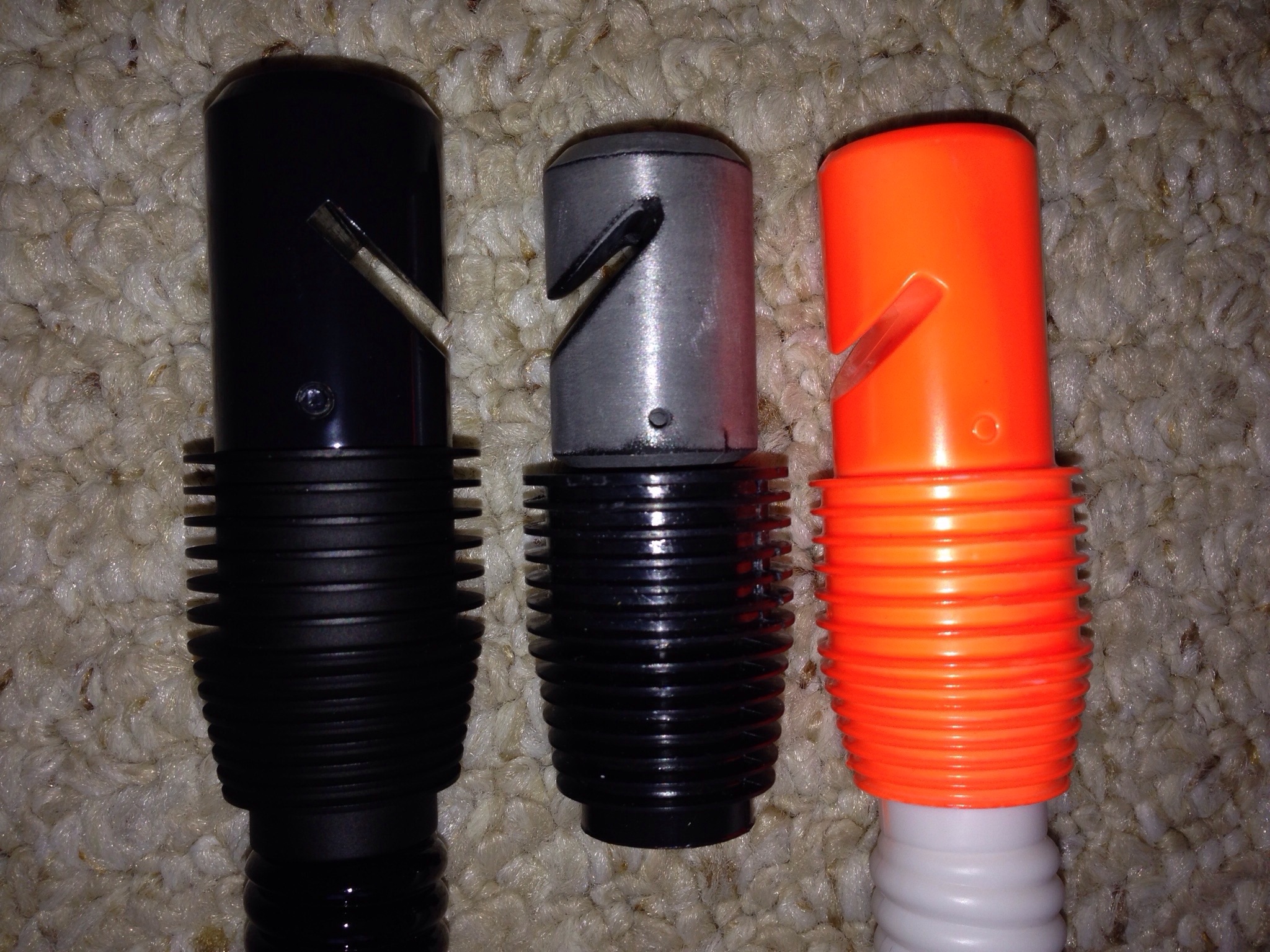

The grill is not that bad, I think they were limited on how deep they could safely recast the fins of the grill. If you compare them, the difference is that the grooves are not as deep. It might look better painted black.
Thank you so much for the pictures!!!

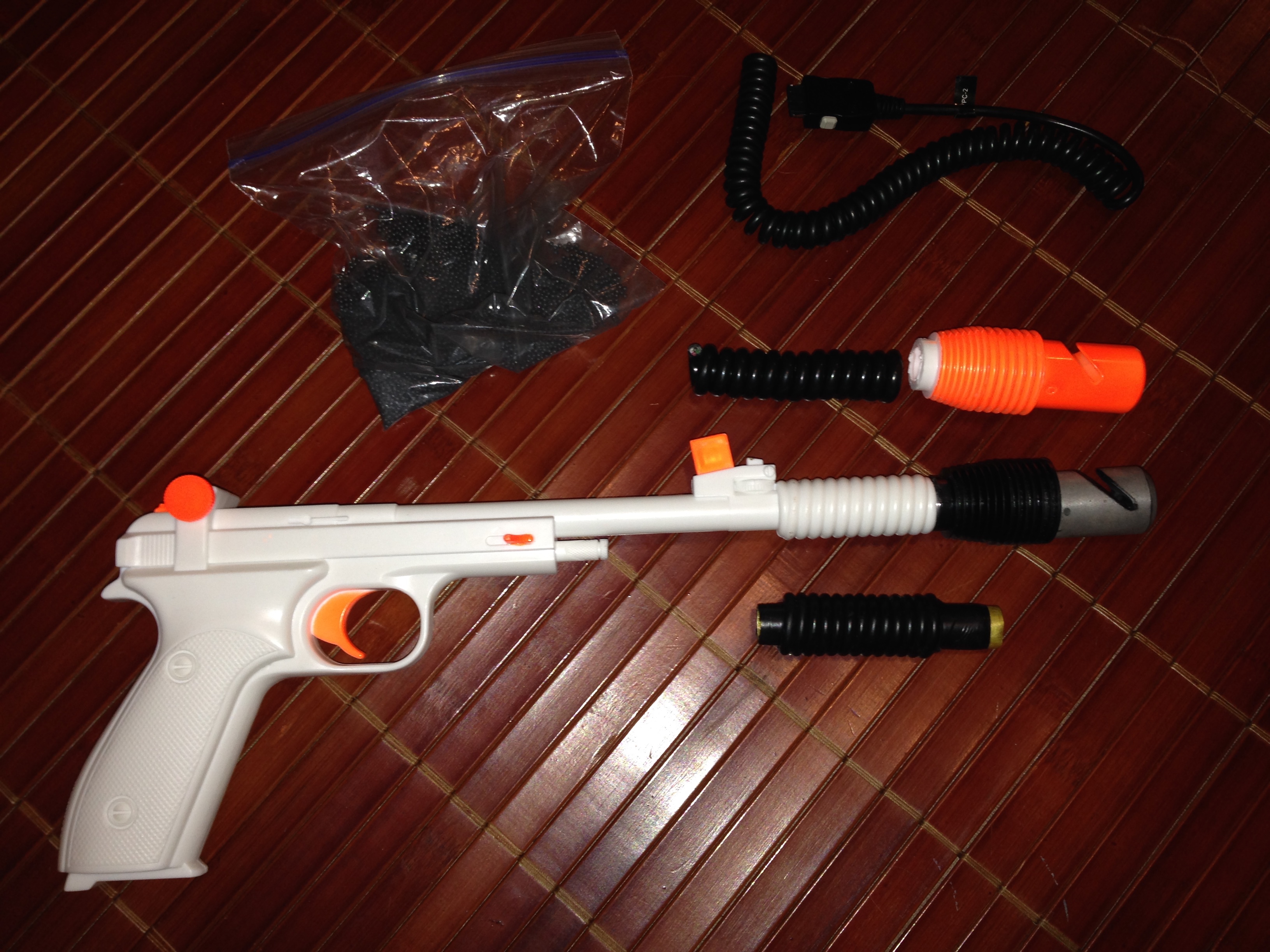

Okay, here is where I am at.
Jonah has been a big help. He sent be a nice adapter barrel for could to fit with the main body and the grill, a piece of coil, and buckshot for added weight.
I had a couple of problems with the coil piece. One was that I had a hard time getting the taper cut in each end and ended up cutting off and ended up with too short of a piece. It also looks d a lot wider than the coil on the MR/Rubies. I don't know if MR sized theirs correctly but it is the look i am trying to duplicate. I ended up getting an old Verizon Apple 30 pin car adapter at Goodwill. Not a 100% match but it looks doable. Took some time to get the taper to a passable look but I did it.
I cut off the grill and muzzle from the Rubies. My big question at the moment it: Do I replace the coil section or just leave the the section as is? While it would be nice to have a real cord wrapped in that section, I am not sure I will be pleased with the work I have done. They is nothing wrong with the coil section on the Rubies, but it is plastic.
After getting a look inside the barrel, I see what Jonah was talking about. There are supports/joiners in the barrel that would need to be drilled out. I would have to do that if I wanted to add some sort of rod support or utilize the barrel as a way to get a glue/buckshot mix into the body of the gun. however I fear that in doing so, i might cause the barrel to separate. What i think i will do is drill out and opening in the area of the mag plate in which I can pour my weighted mixture. Once I am done, i will cover up the mag plate with some sort of sheet plastic, and blend to the body.

Yeah, from photoscaling some nice, high-res pics of Mark Hamill in his celebration outfit and holding that blaster, I can't attest to the MR blaster, but if Rubies is cast from it, the coil section is all wrong. Wrong length, wrong number of coils, that are the wrong size, resulting in a smaller overall diameter. The coil section should be almost (as in, 15/16" compared to 1") as wide as the muzzle piece. Length of the section divided by number of coils is how I got the ~3/16" size of the cord. You've already found that those charger cords are too skinny. ;)

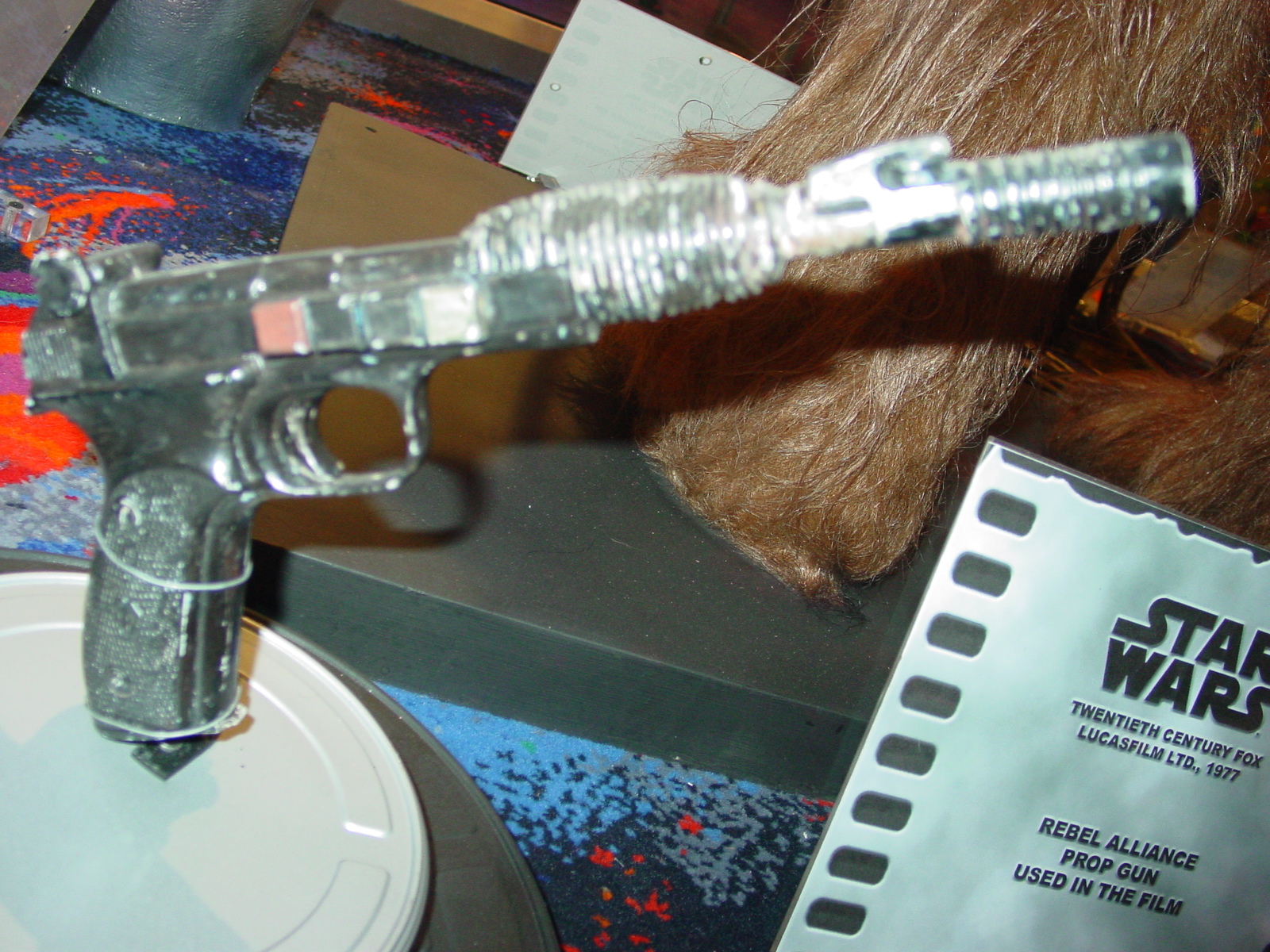

I have been trying to do some Leia Return of the Jedi blaster research.
It seems like most picts that exist of the real prop show at least two variants. It looks like most screenshots show Carrie welding what looks to be a real converted
Then there seems to be images floating around of a resin variant. This is the photo featured on partsofsw.com and the one that has been displayed in the Planet Hollywood collection. The cast appears to be without those little triangular releases on each side forward on the body. Here is a picture I took years ago:
attachment.php
i cannot get a good count of the number of grills on the tomtit pieces on the one that appears to be a real Margolin. But I think I got some numbers from the resin stunt. It appears that the full round part has all 14 raised fins. The half piece that is joined appears to be cut down so only 9 fins remain.
Am i right that one is a real Margolin or are they both resin? Or are they the same just really screwed up over time?
Does anyone one have any insight or opinion to the contrary?

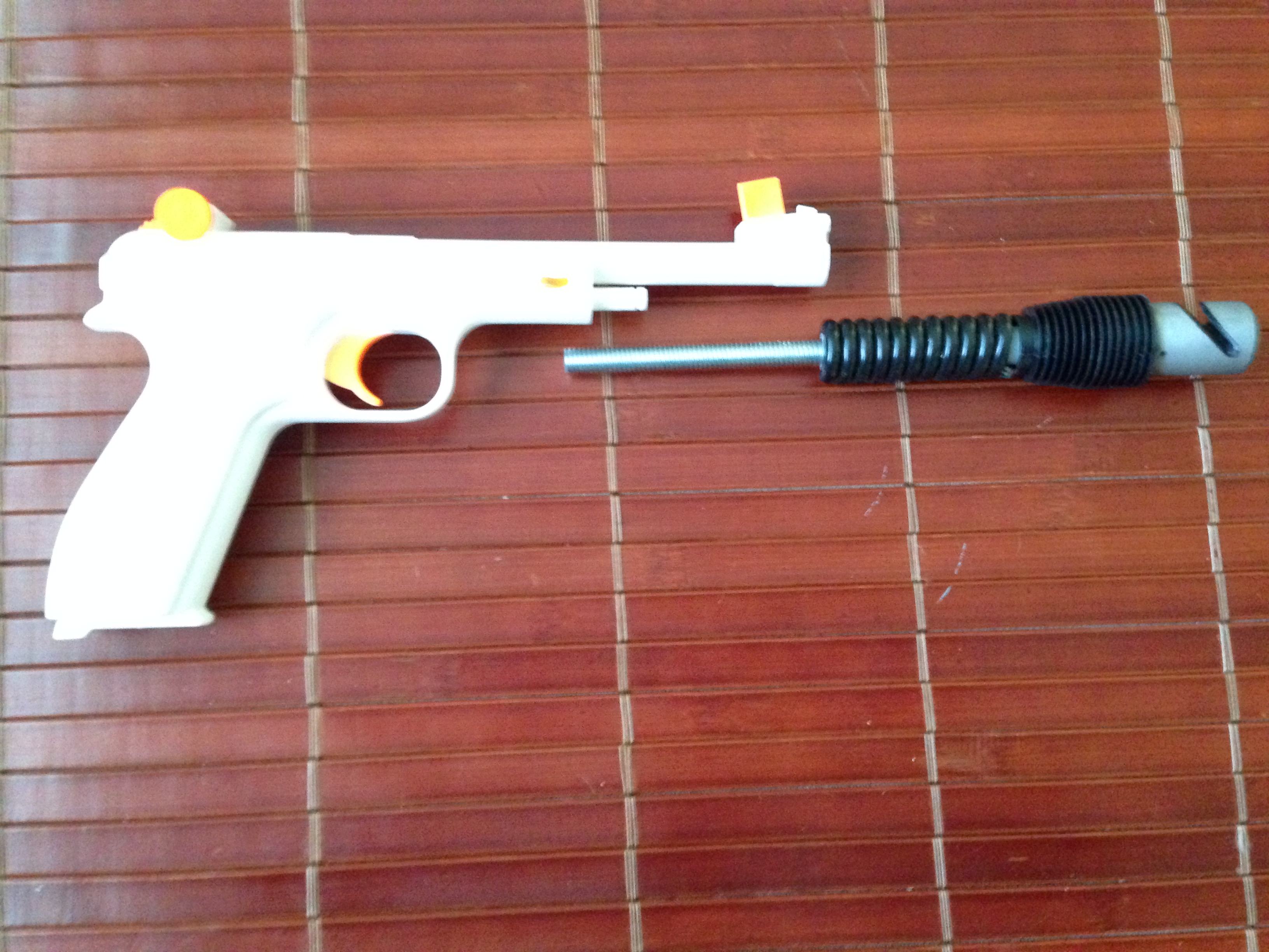

Here is where I am right now:
The base of the extension is a threaded rod. The grill is held in place with two nuts (one on each end). The coil is wrapped around three, 1" spacers glued together then trimmed to size. As you can see, the rod will go about half way down the barrel which adds some nice weight. When all is done, I will add a little glue all around to ensure nothing spins out of place
My next step is to create a glue and buckshot mix and insert it through a hole I drilled in the bottom of the magazine.
Once I get the weight added, I will start clean up on the body, such as seam work, plugging the hole I made on the mag. i also need to add a little bit of barrel at the bottom of the cut end. When I cut off the faux coils, even though i cut along the coils, it still got cut at an angle.
