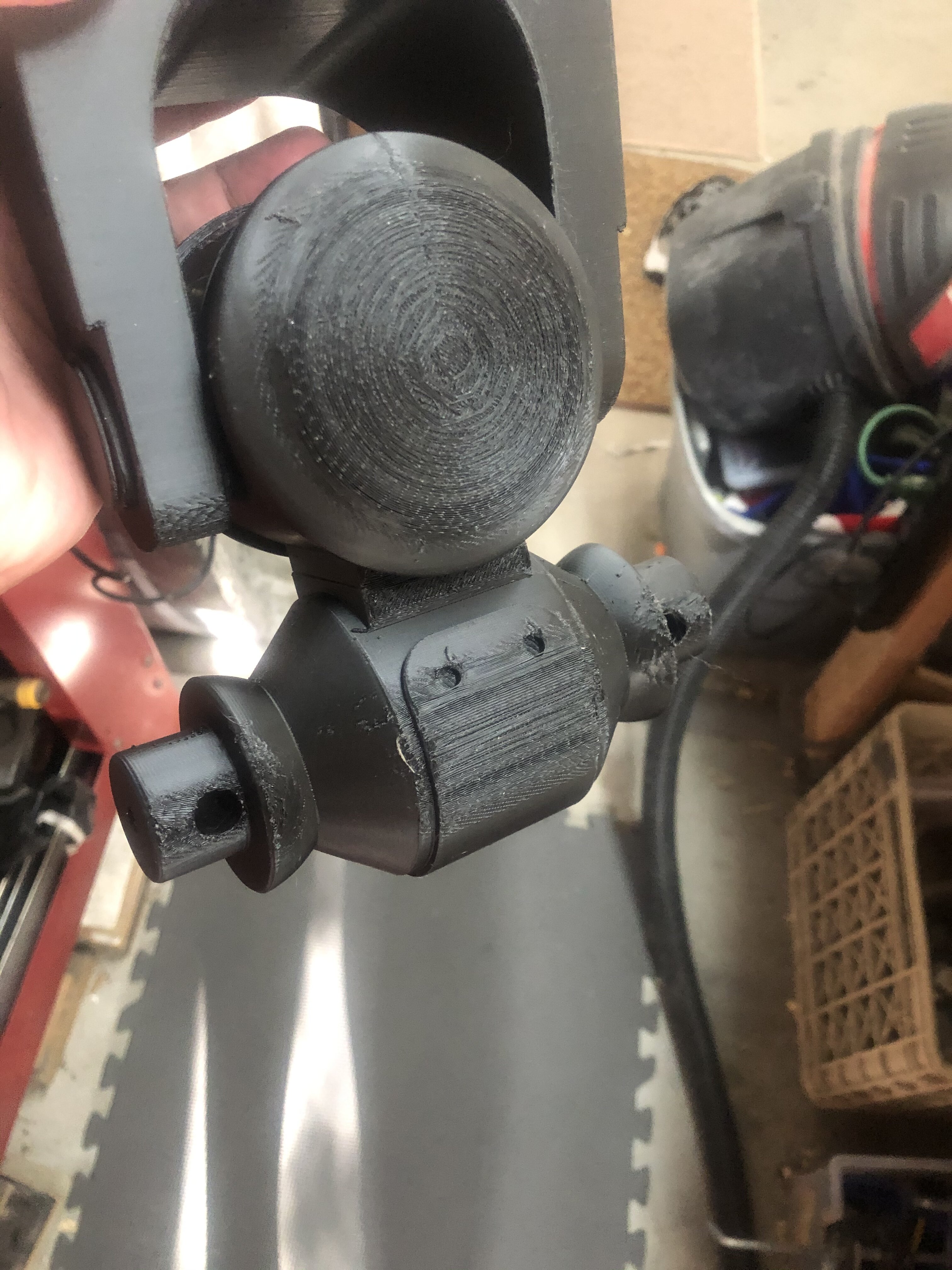

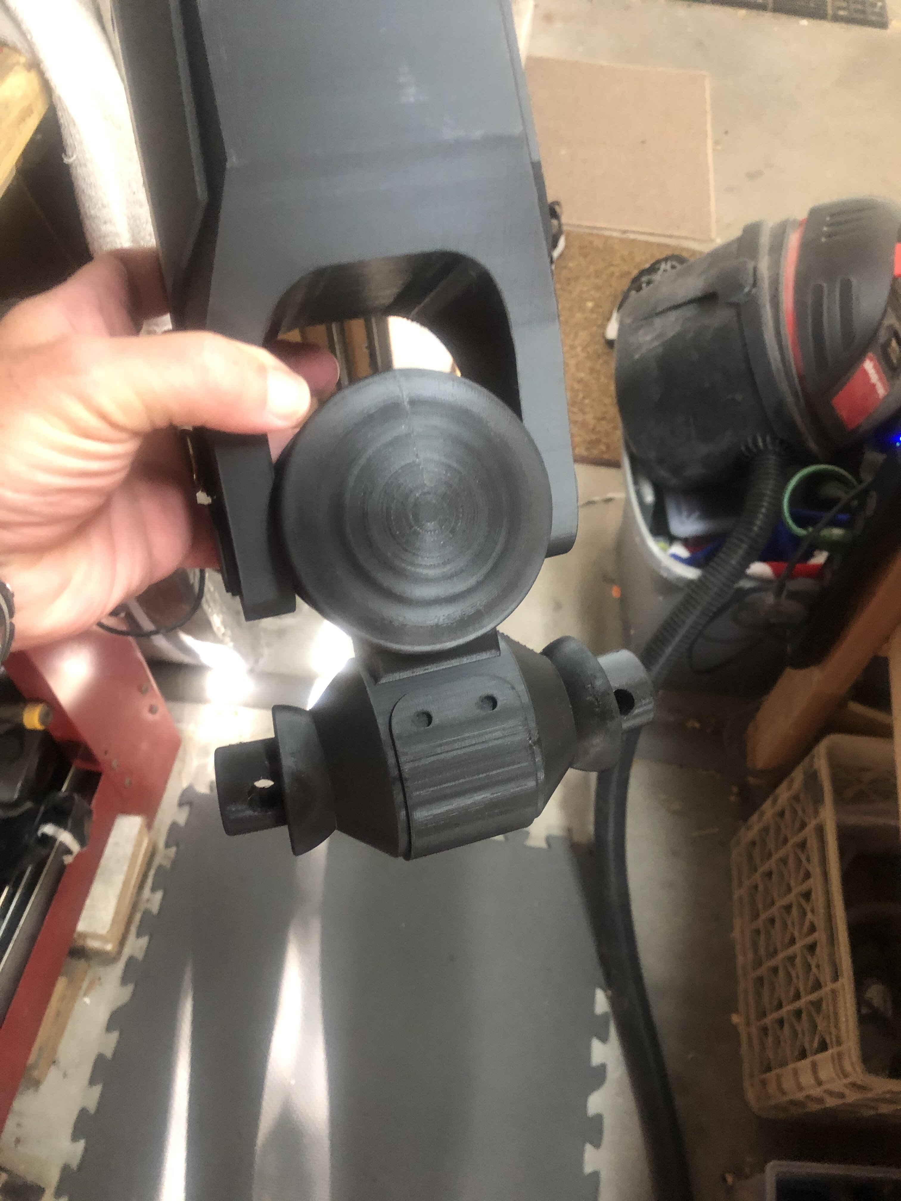

View attachment 1459338View attachment 1459339
Do getting a lot of texture on the bottom sides with supports, can I tune some of that away?
Nope, you can't really "tune" that stuff out. FDM printers, especially where there is supports play into the build, you're always going to get odd textures and stepping. You can try reprinting the piece in a different orientation, and maybe minimize the texturing to one small area on the model. You can also reduce your layer size, I have printed with a layer size as thin as 0.02 and gotten very smooth results, but it takes a lot longer to print the model. Needle files, sandpaper, glazing spot putty, auto body filler primer, and rattle can paint are what I use to smooth my FDM prints out.
