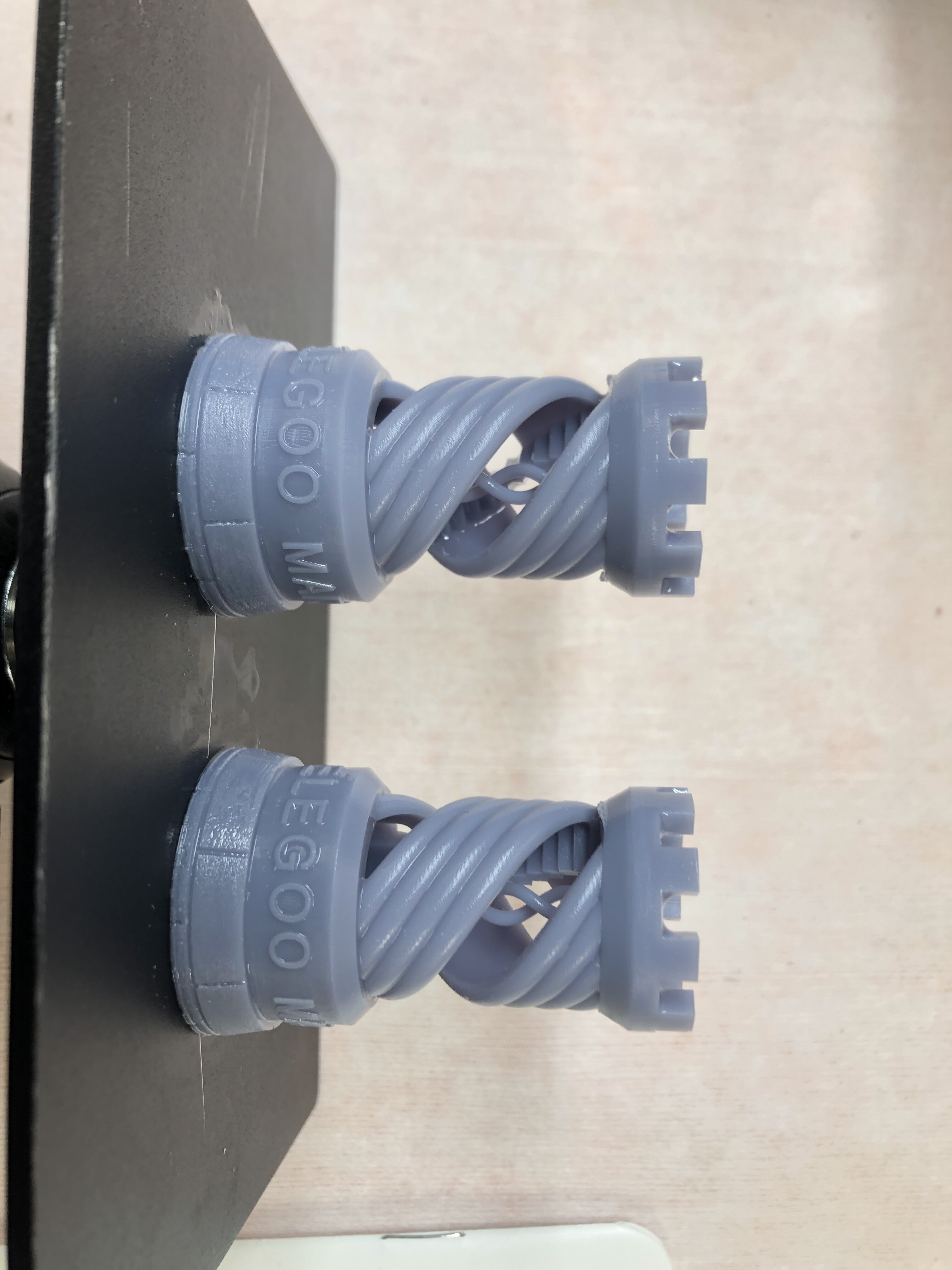

Test prints went well!

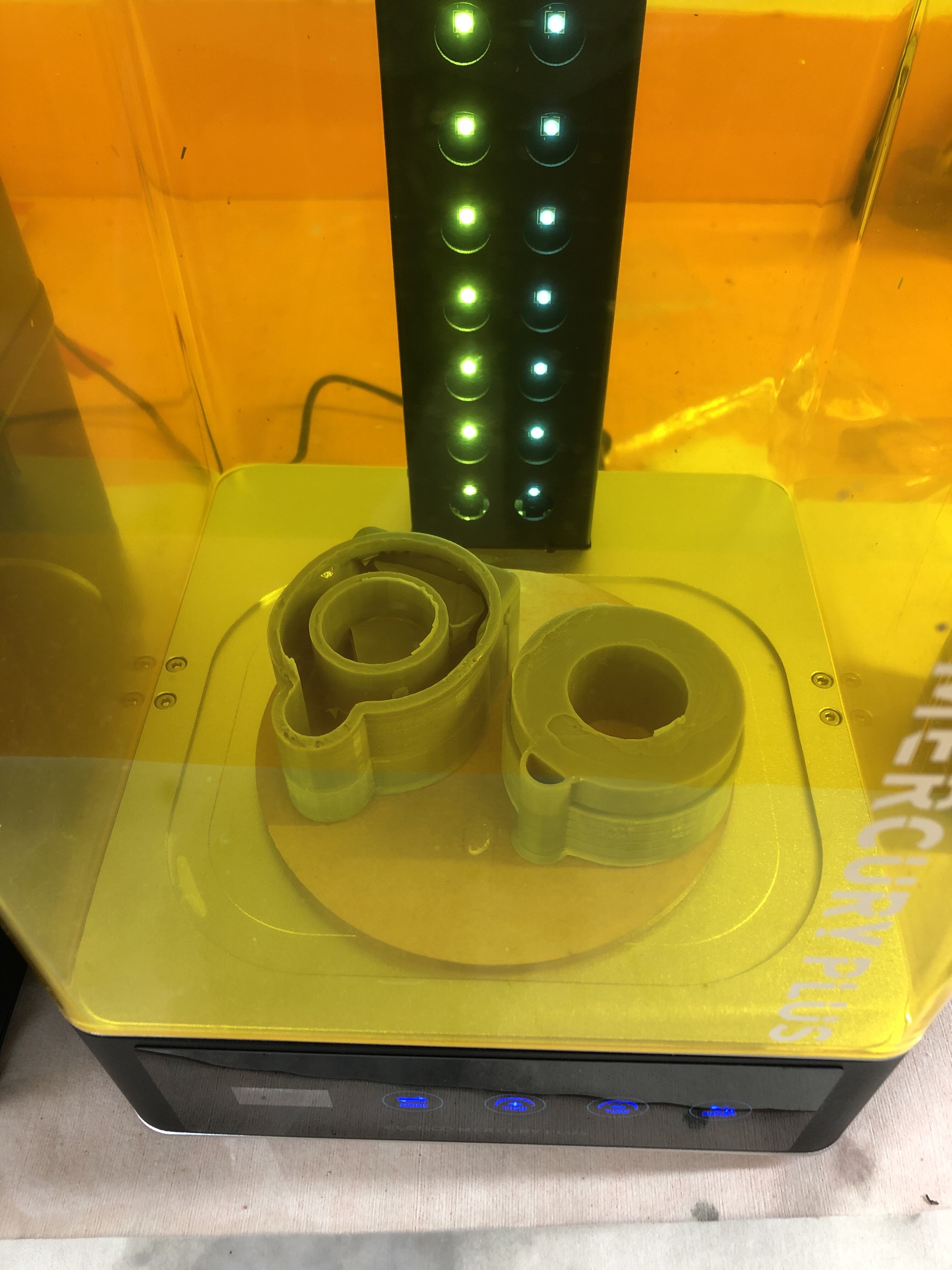

Parts are in the plasma booth curing.

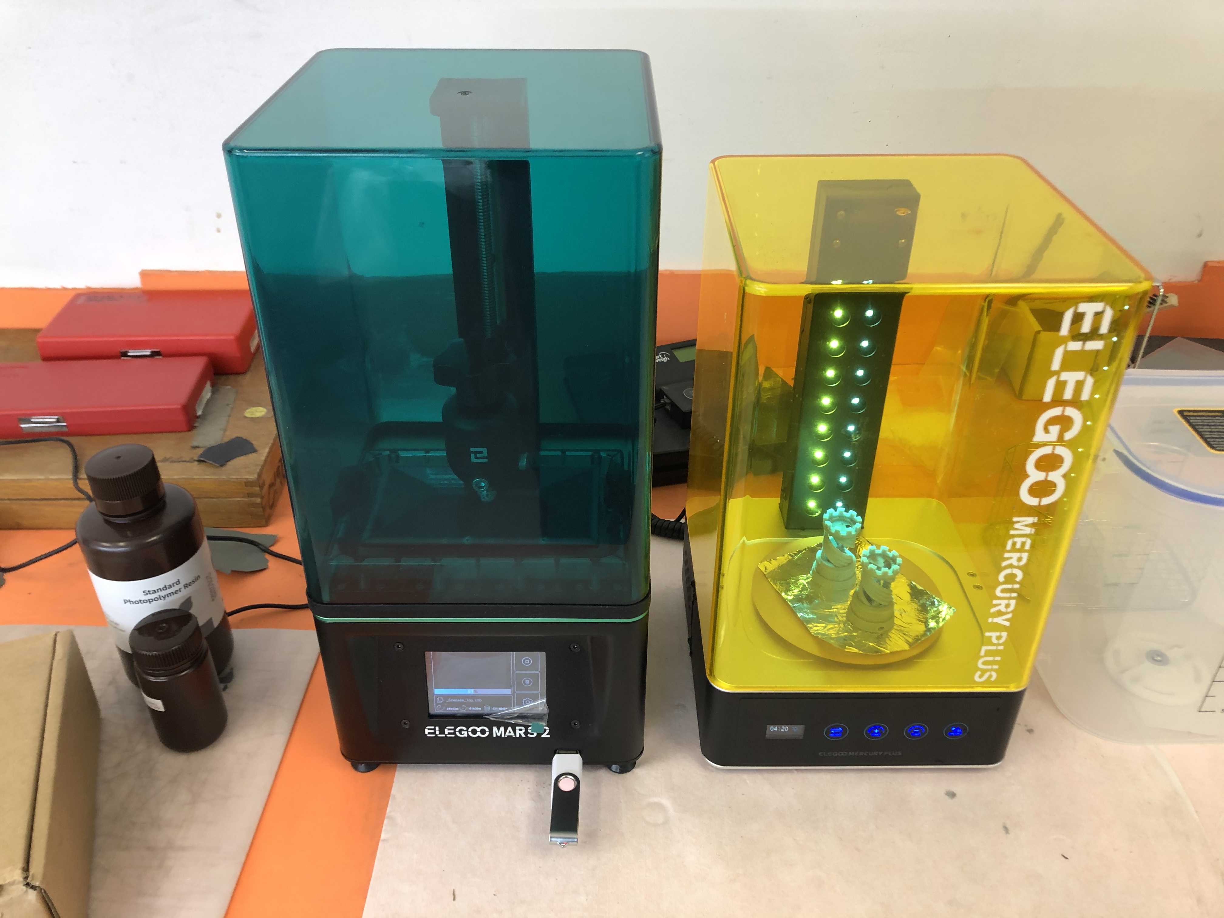

Very pleased so far. It’ll be fun using the wash function on the Mercury too. I’ll get some files sliced over the weekend for the big build...

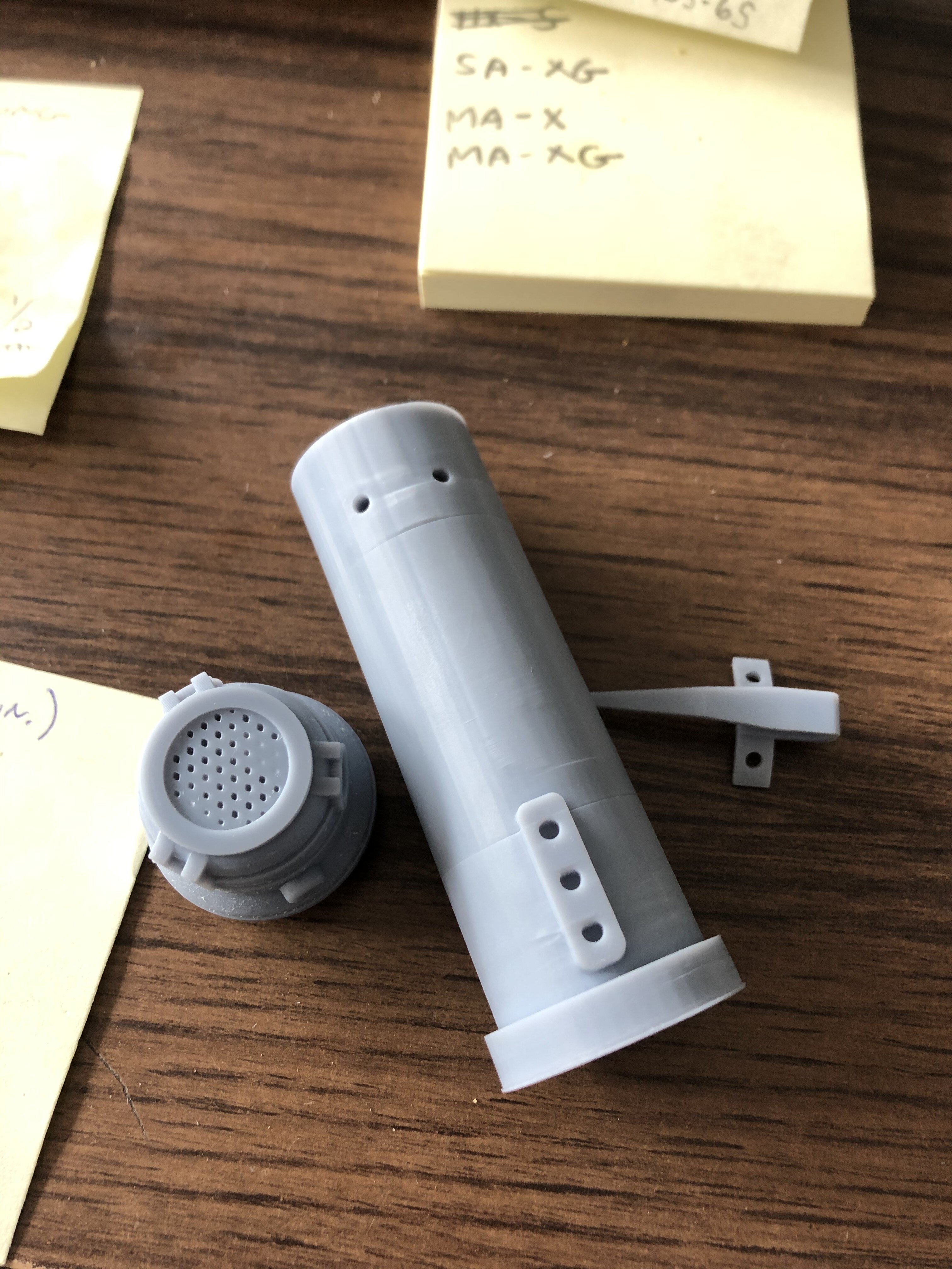

I do have a question for the veterans. I have a com link file and there are three pieces. The tall tube, the “head”and the pocket clip. The tube is on the plate, but for some reason the “head” is off the plate a bit. How do I move that element down onto the plate? I can’t figure that out.

But I did successfully print the com link- not screen accurate, but close. It'll do for now. Just got the silver paint on (need some clean-up); I can weather it tomorrow.

If you go to 'Rotate' on the left, you can select 'Flatten by face' and you can then select a face to be parallel with the build face.
Make sure you don't have 'Select All' ticked above the file list on the right (after unticking it, it can sometimes be a bit of a PITA to unselect them all to get just 1 selected, just keep clicking around).
Bonus tip: If you want to reduce the 'white nastiness' you're getting around the outside towards the bottom, you need to increase your 'light off delay'. The more you increase it, the better it'll get, but also the longer your print will take. You can also make a small vent hole in the model nearer the build plate. The issue is caused because the resin is still settling when the exposure starts, this is because you're basically printing a cup and so when it's lowered into the resin the air is trapped inside and pushes the resin around.
Well, part of the problem was the part I thought was off the plate had a pilot sticking out of it to insert into the body piece. I now know how to manipulate things better to see that.
It printed fine.
I know about “toggling” when there are multiple files on the plate at once, but all three pieces of this thing are in a single file.

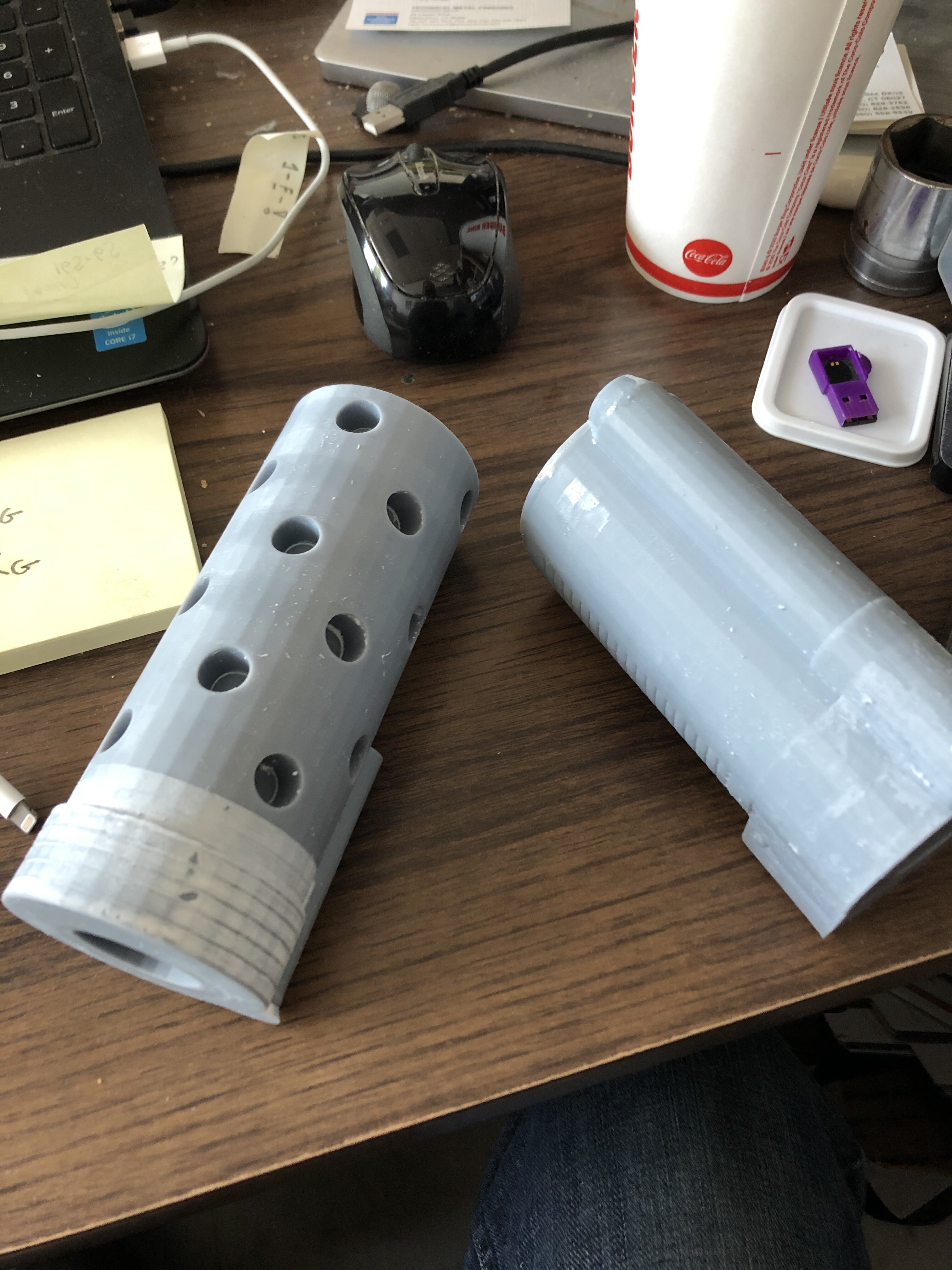

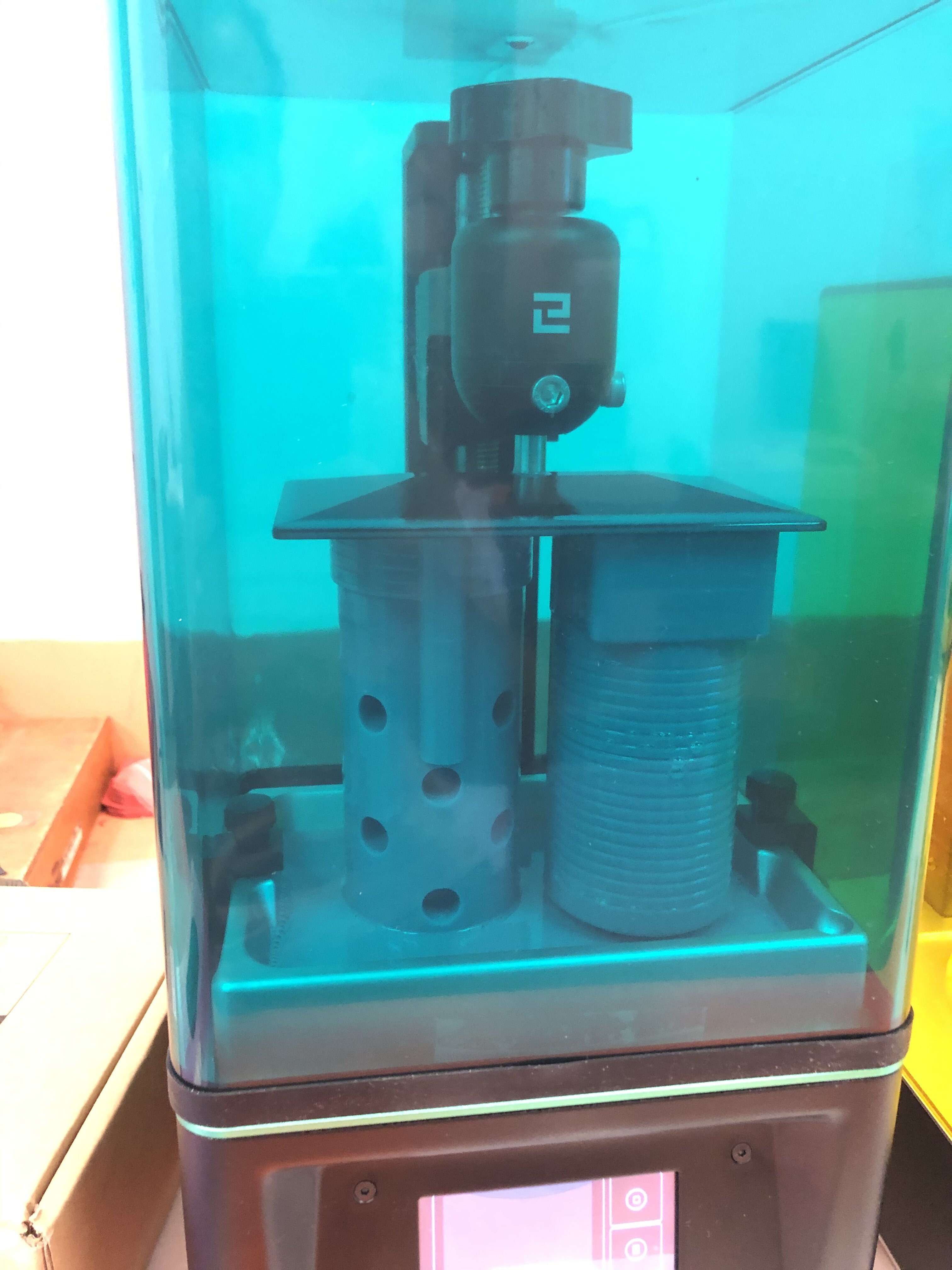

I completed the 10+ hour print this afternoon. Learned a lot on that as well.
These parts really pushed the envelope for this machine. I actually need to reset zero because I jogged to the top of the screw travel (to get the plate out) and I don’t think this has an absolute encoder on it...

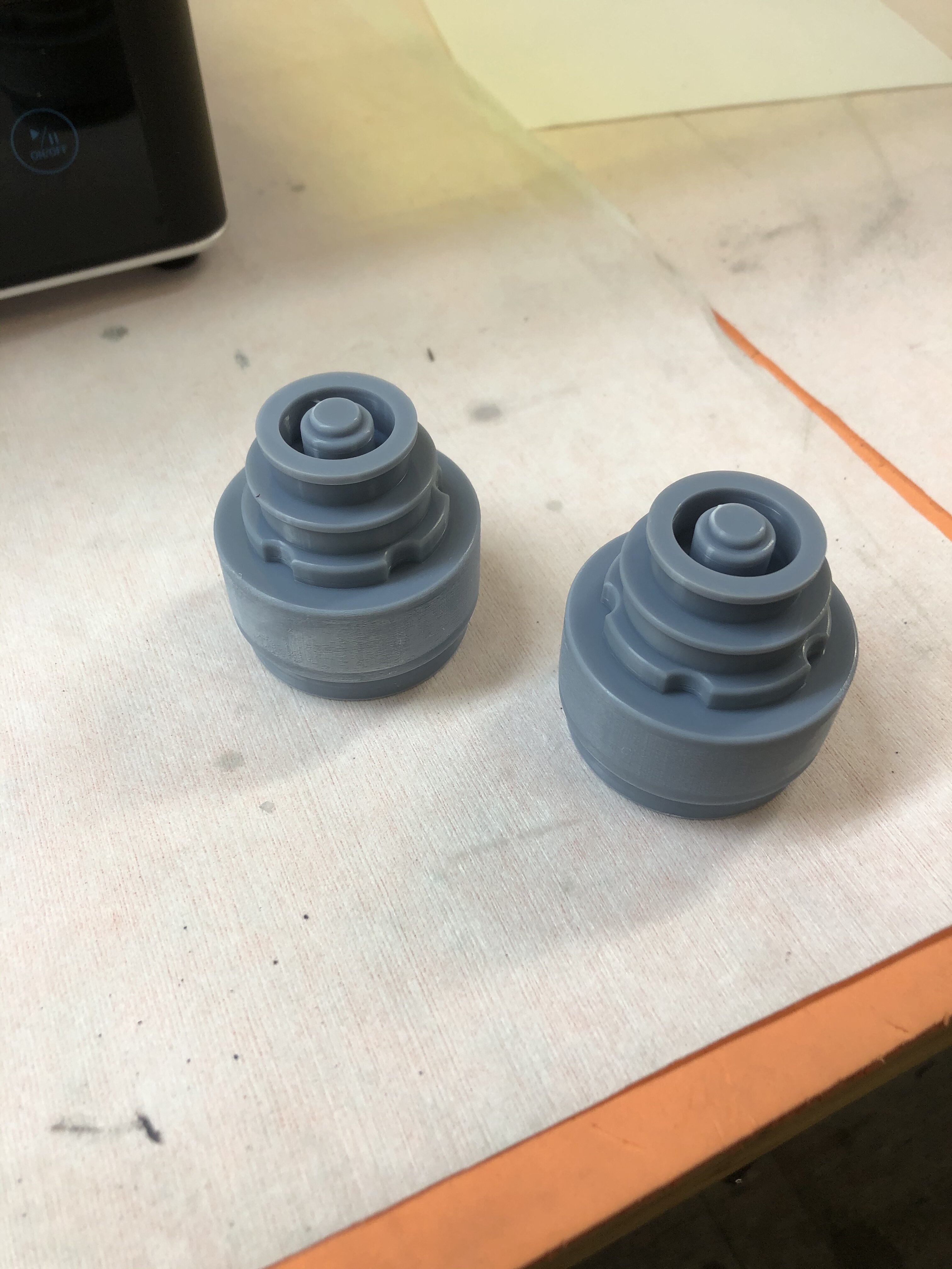

Printed more stuff on Friday but didn’t do another epic run over the weekend. Figured it could use a break.
These are the “new” grenade tops. I’ll probably print the lowers on Monday.
