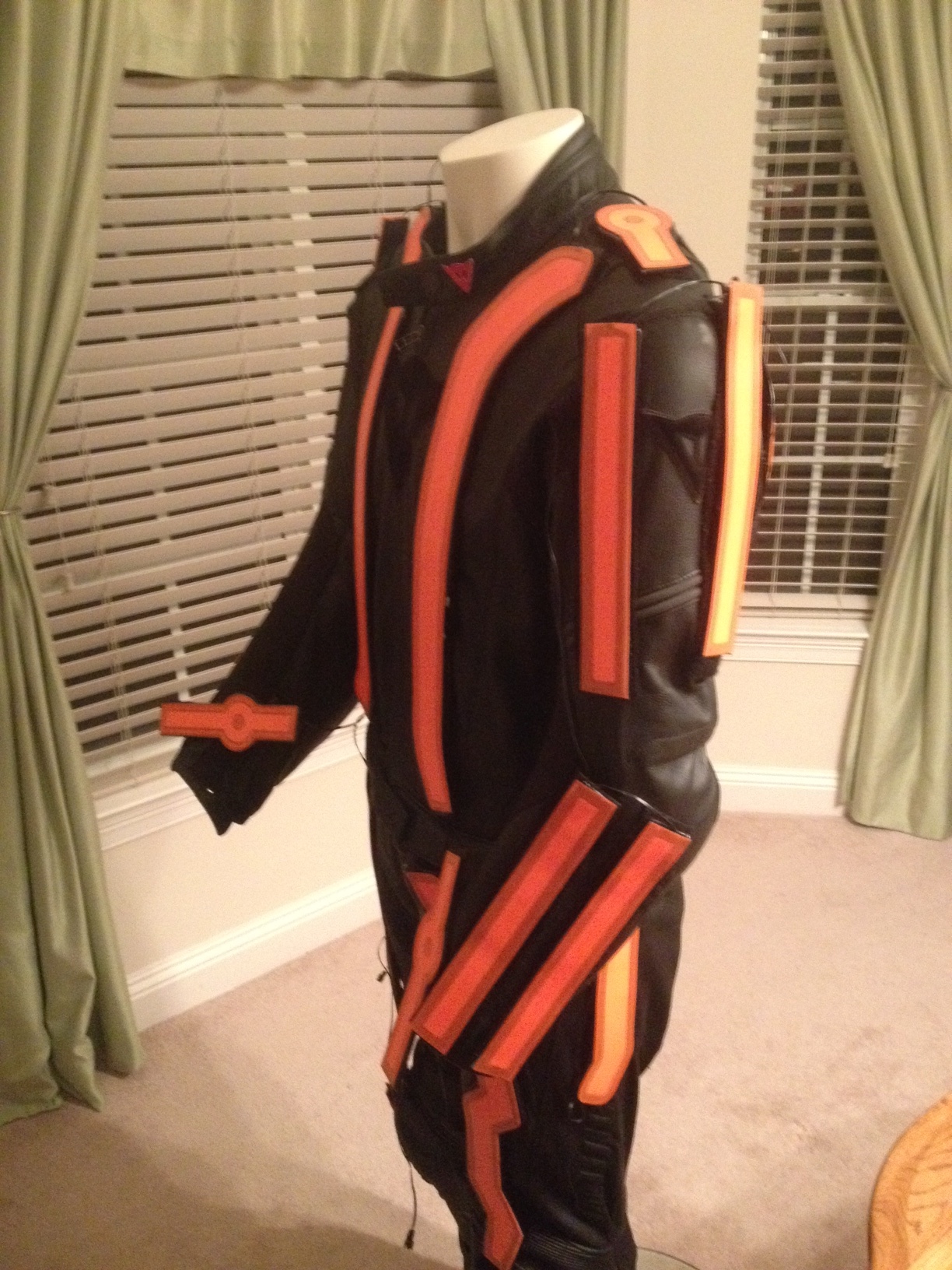

So finally before I decided to call it quits for the night we got some of the lights in place on the suit for testing this week. We made sure the thing would work prior by putting on the suit and making sure that the tiles wouldnt restrict movement or hinder me from sitting... pretty important at dragoncon. ITs coming together and I can't wait to get it on and see it all lit up. I'll post the light up pics as soon as i figure out the wiring of it this week.

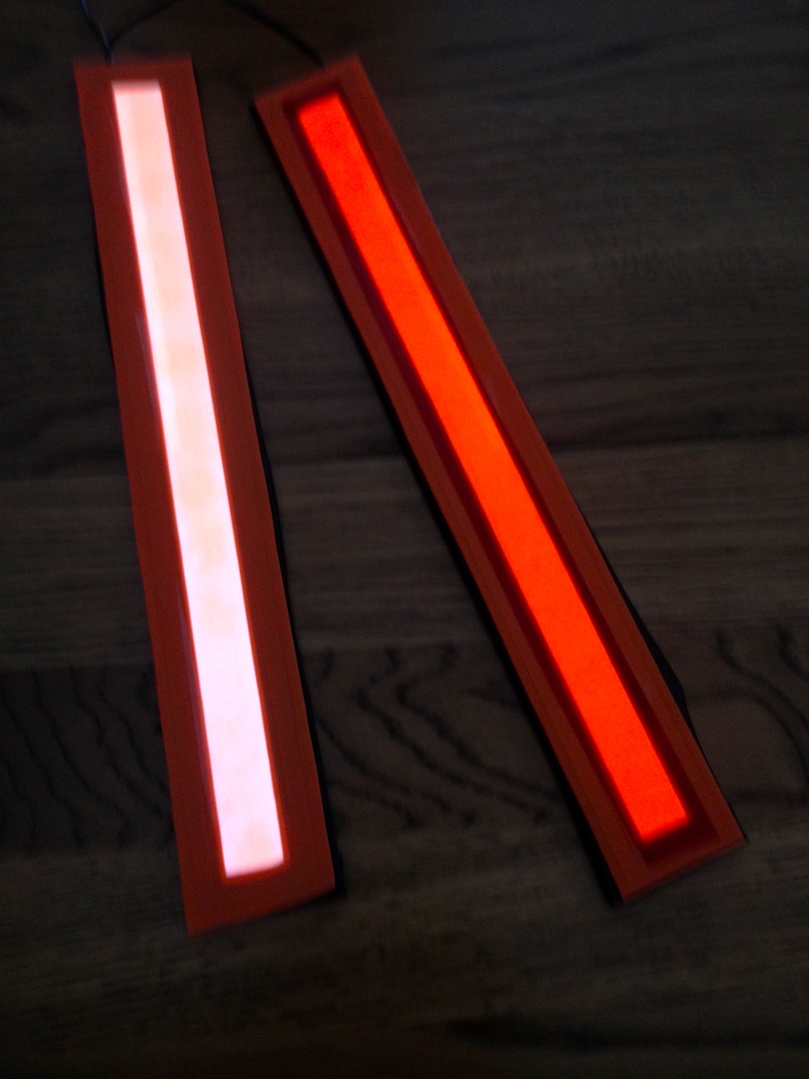

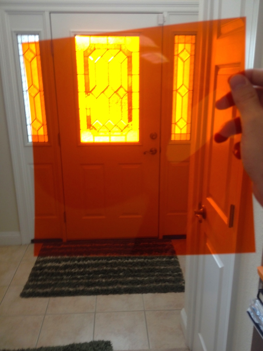

ALMOST THERE. I turned on the suit last night being fully complete, and I need to make a few revisions. #1 being the EL light Color. I'm not really happy with the color of the EL Lights. They look more white than orange when they are on, so I've bought Golden Amber Light Gels, that i fortunately found online for 1.50 for a 10" X 10" square... so i should have those by tonight, then ill cut them out and Post the before and after pictures after ive gotten it how i want it. Its alot of small things, but they'll add up in the final looks.

OK LIGHT COMPARISONS. I am much much happier now with the Golden Amber Gels on the lights. You'll see what i mean in the Side By Side. You see that the ORANGE EL TAPE, is NOT! Orange whatsoever. BUT now it rocks and matches the EL Wire that's in the Helmet.

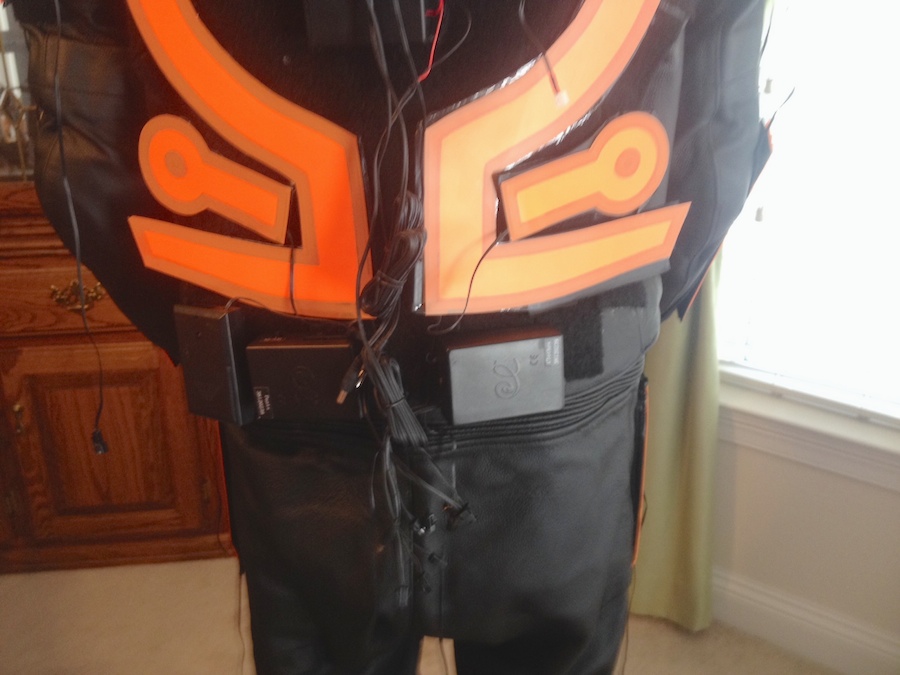

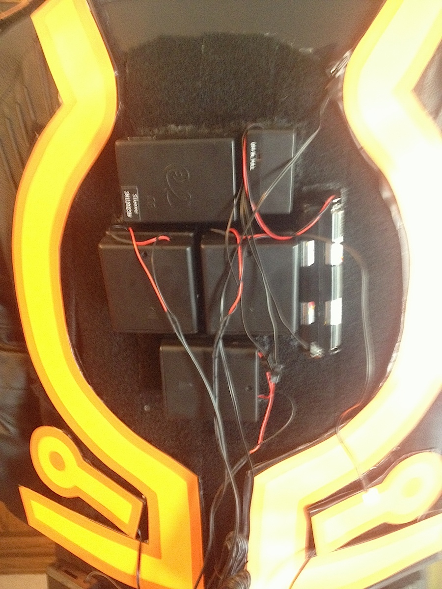

BATTERY MADDNESS has begun. I've finally figured out the right "Tetris" placement to get the back piece to fit over all 6 battery packs (filled with 8 AA Batteries). I'm going to put the Inverters on my back waist towards my spine to have easy Turn on and Turn Off Switches. I'm also going to run all the cables right down the spine in an orderly fashion and put the excess underneath the back disc with the battery packs. WHEW. IT FREAKING FITS AND WORKS!! MORE Progress to come this weekend!

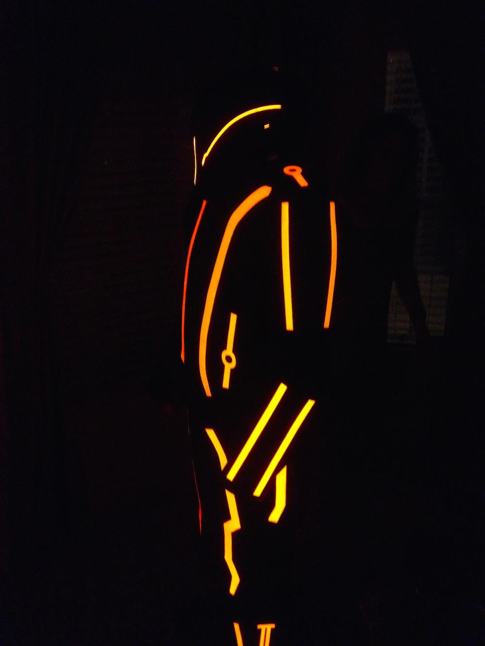

WELP, Here's The First OFFICIAL TEST RUN! Its on a mannequin, but I'll be wearing it tomorrow. I have some cables runs to do in the morning! I'll have the 2 Discs, and Full suit on tomorrow night for the first TEST RUN!! STOKED!

Thanks Brotha! And As for the 9 volt, I'll need to try and get 5-6 hours out of the entire suit, so i made as much room as I could under the disc in the back. So far... No issues. Tomorrow will be the True Test. I'll update it here as soon as I'm done trying it out.

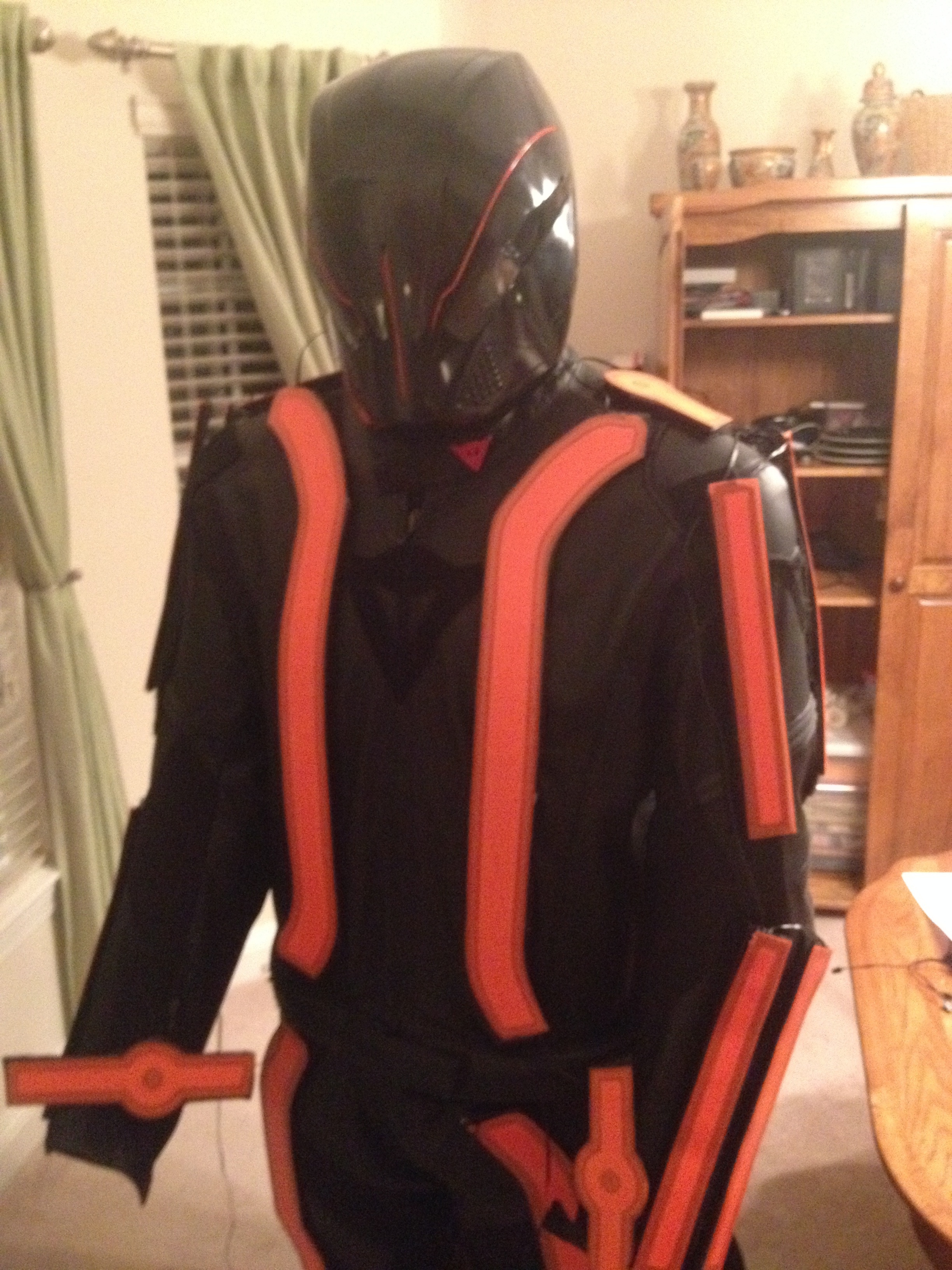

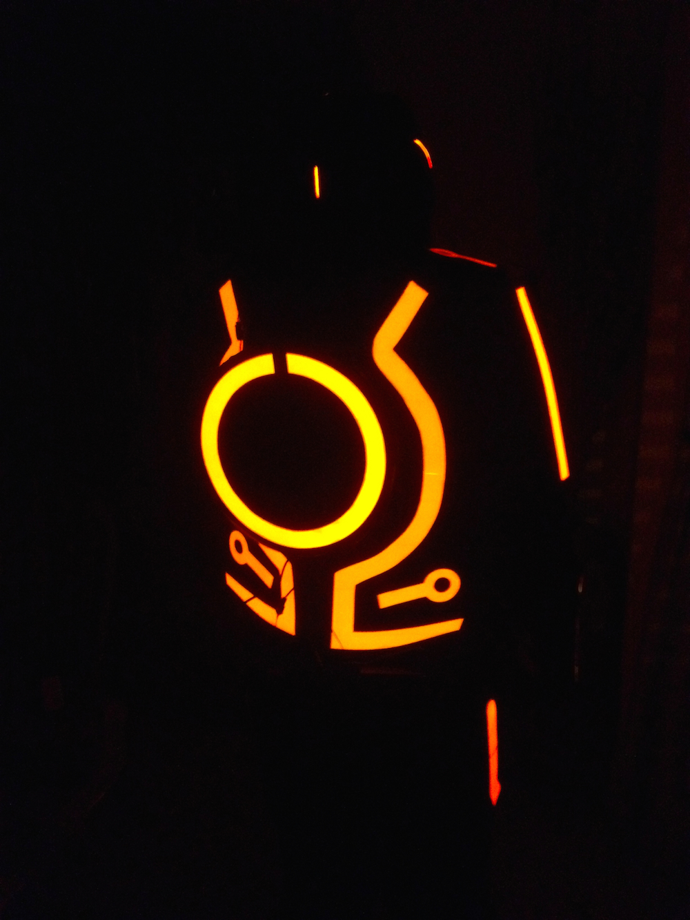

AS Promised, Here's my first time wearing the "Evil" Tron Legacy Suit. The Helmet blew the inverter (Which i have now ordered a new one and a backup) so its everything but the Helmet. ROCKIN!
