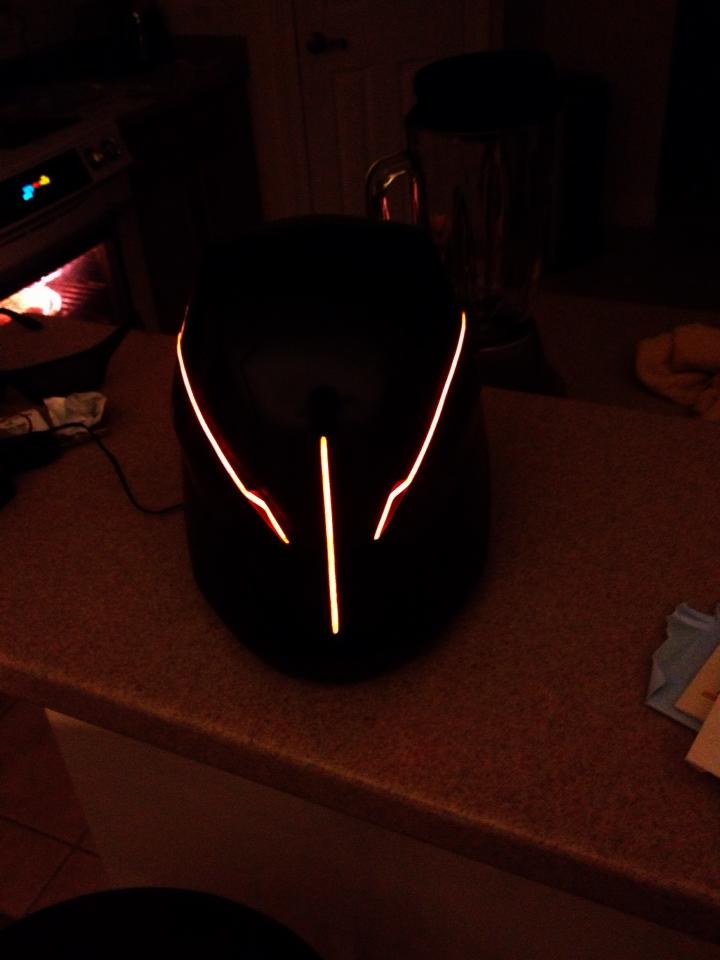

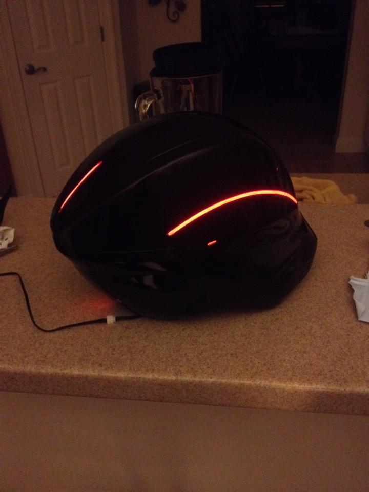

I really wanted that freaking helmet. After 3 weeks of searching for ways to make this happen i stumble onto the RPF and find Crimson Works, after a good chat with him about his work i decided to give it a whirl and see what the end product looked like.....and this guy does not disappoint. Verry Happy With the end result.
So HELMET... FREAKING CHECK!

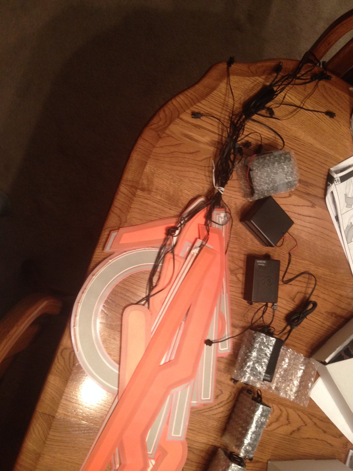

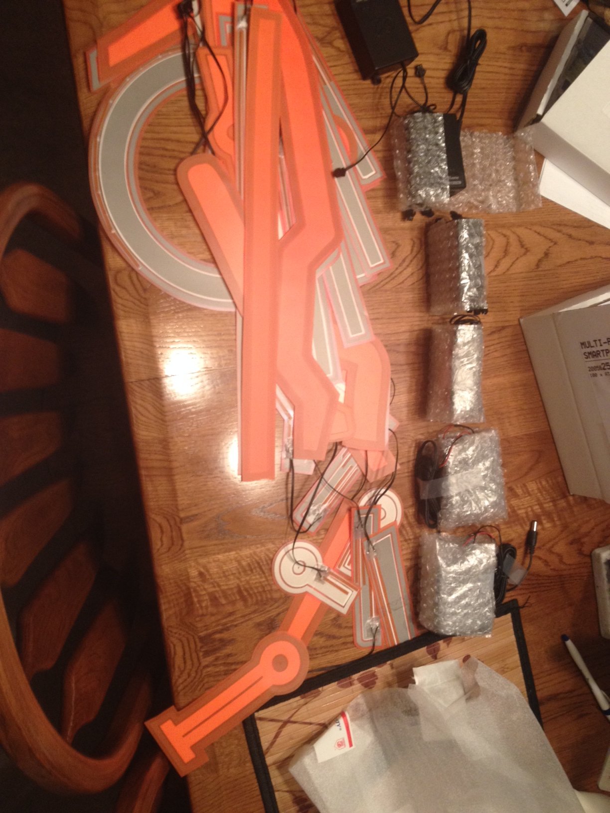

So the lights came in...
DC INVERTERS, POWER SWITCHES OH MY... anyways theres alot to the wiring.

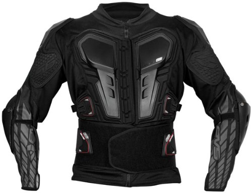

So that started the HARDEST part of this so far... what suit would i get to use the lights on. After 2 months of researching i narrowed down to Motorcross Armor... specifically the ones here
Mainly because the one i originally wanted was no longer made. But i got to thinking about all the wiring and it just seemed like it would end up putting too much stress on the light packs and lights since it was in 2 pieces and wouldnt be cohesive with pants. SO it brought me to Full Motorcycle Leather... and trying to find ALL BLACK full motorcycle leather was extremely difficult, and i refused to pay 1,500+ for it.

The Helmet's visibility is decent. I thought it would be a lot worse than it was. Its kind of like looking through glass with a light layer of water running over it. You can see everything you need to but pure definition isnt there. But i can navigated around in dim light very easily so that is pretty important.

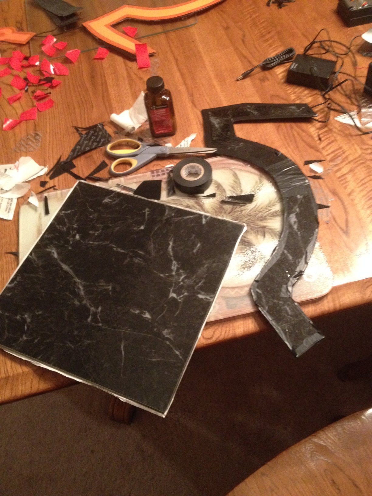

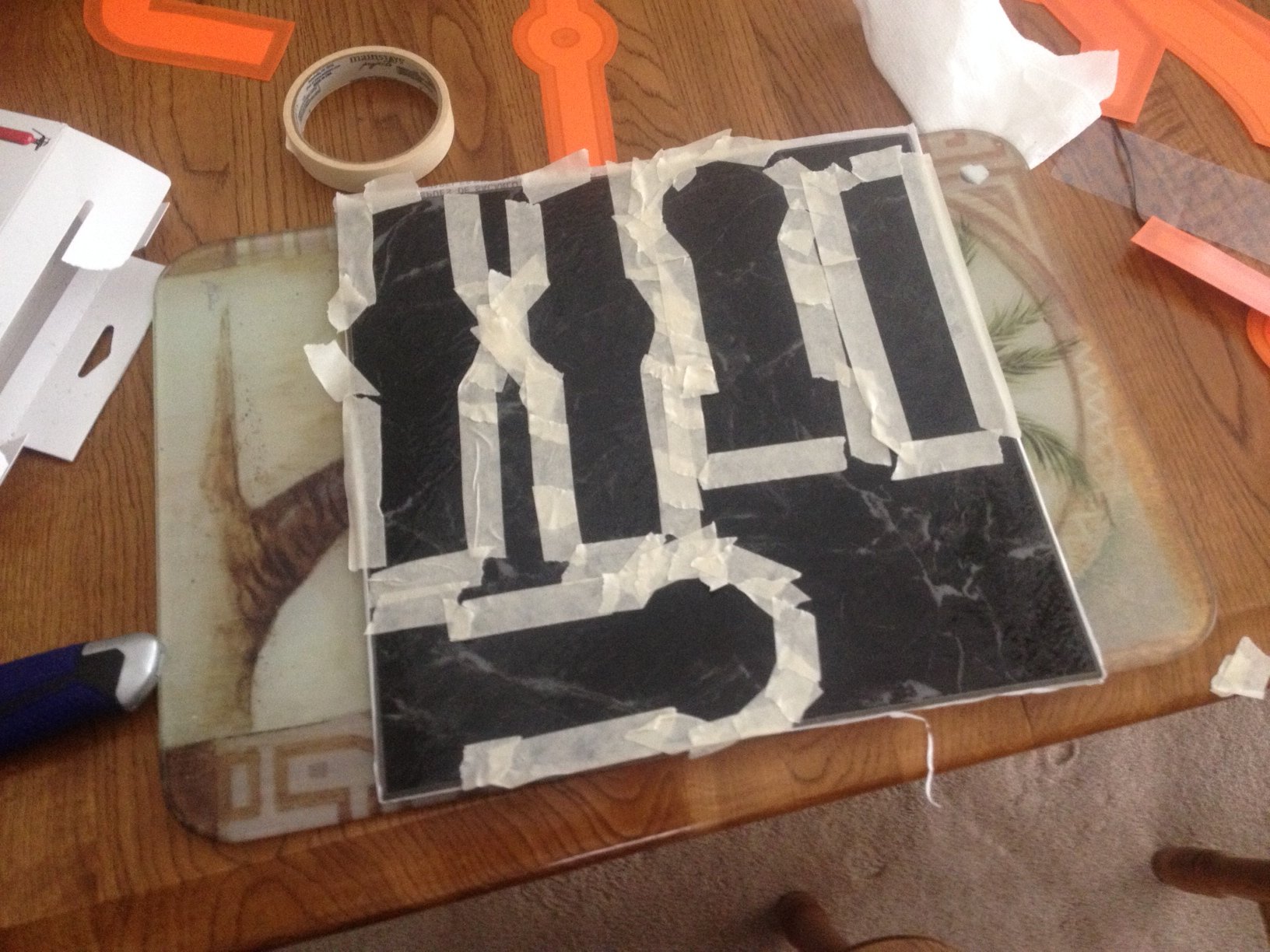

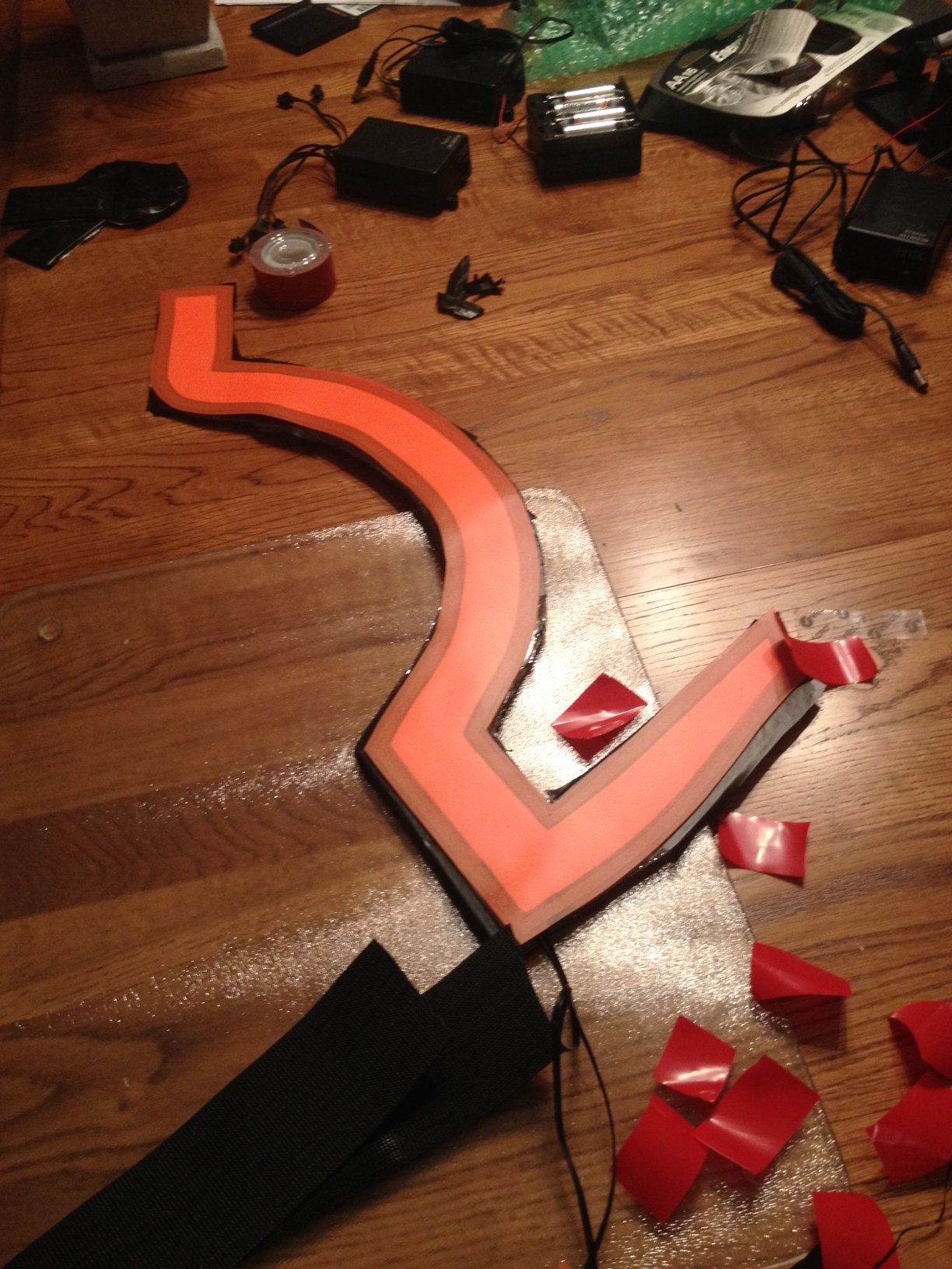

We ended up using the black laminate tile as a backing for the EL Tape.... It was only 88 cents a pop so it worked for a cheaper option as well. All we had to do was tediously cut out all the shapes of the EL Tape, electrical tape the sharp edges for a smooth trim and attach the Velcro to the back side with Contact Cement.
After getting them cutout I've had so many headaches over how to attach the lights to the tile, since you can only use light glue... a problem because of the humidity, or sew them in... and i am not sewing into tile/leather...nor do i have the equipment. After some experimenting I found a scotch holding tape, (supposedly that can hold a stupid amount of weight....it doesnt matter with the light tape weight, but funny to try and see if itd actually hold 20 lbs) ANYWAYS.... It works like a charm!

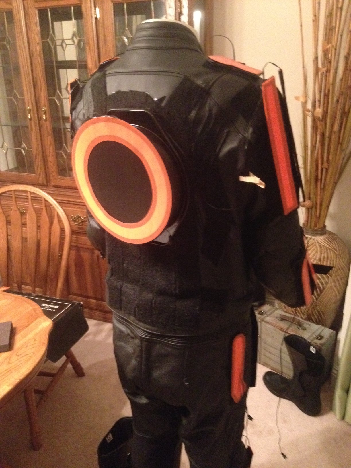

I also retrofitted the back of the leather suit with a simple cake pan, painted it black and slapped some high grip velcro on it. This is where the battery housing will be... it all fits... but just barely. Leaves room for the cable runs without pinching them as well. Here's a pic of the back....minus the lights. As you can tell we used a crap-load of Velcro on the back of the motorcycle suit with the help of our friend CONTACT CEMENT. Only thing that works on getting things stuck to leather other than Bards which is also a contact cement...which I couldn't find.
