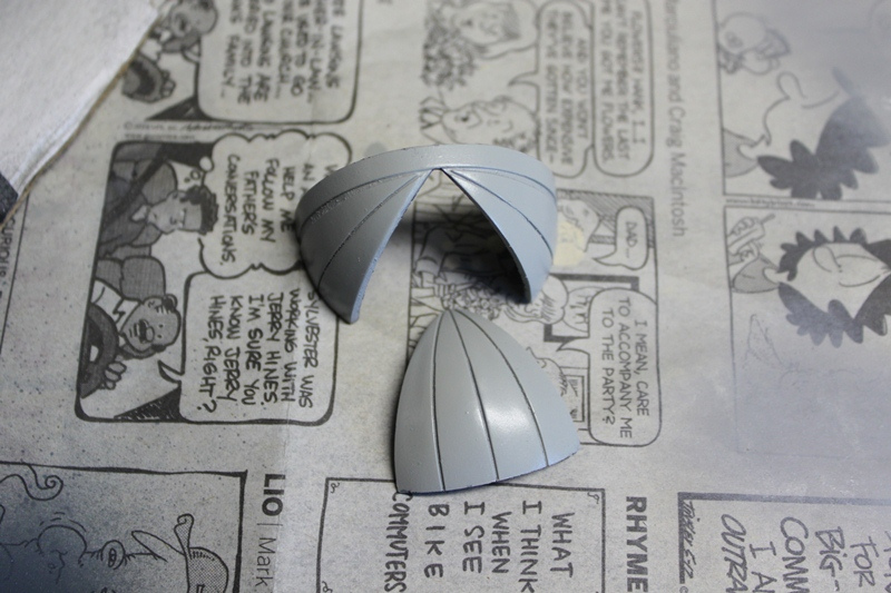

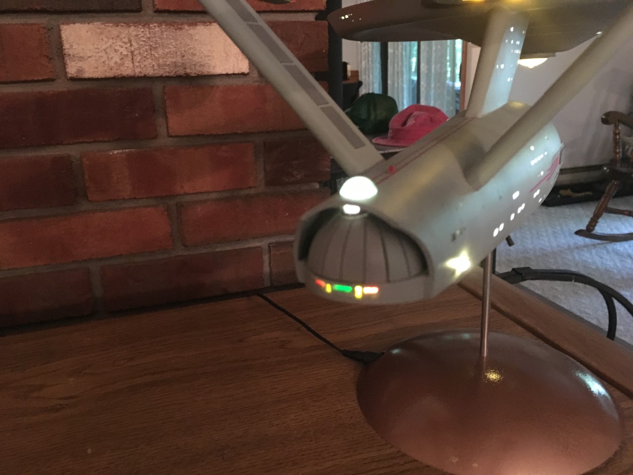

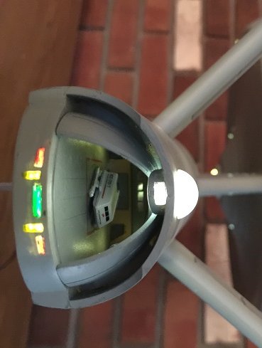

Beautifully done! I'm in awe of this build! I just got one of these and moving past my star wars obsession and had a question. I see from your photos that you are able to display your hanger bay open or closed. I like the mod you did about inserting the cut portion of the closed into the open to have more than one display option. One question. Does your door simply slide in and out, held in by pressure, or did you create some other way to hold it in?
I know this post was from a long time ago (in fact I read it first about 2 years ago when it was hardly new). I finally got around to doing the same thing with my own 1/350 Enterprise which was built with an open shuttle bay, and was very happy with the result. So...belated thanks for the suggestion!
I wanted the option of showing the bay doors open or closed so I cut out the middle section of bay doors from the "closed" bay door part to use with the "open" door part. The closed door part was thicker than the open door part so I thinned it with my dremel, a seam scraper, and sandpaper before light blocking with black enamel and primer on the inside facing surface. The outside of both parts was painted with my custom hull color mix:
